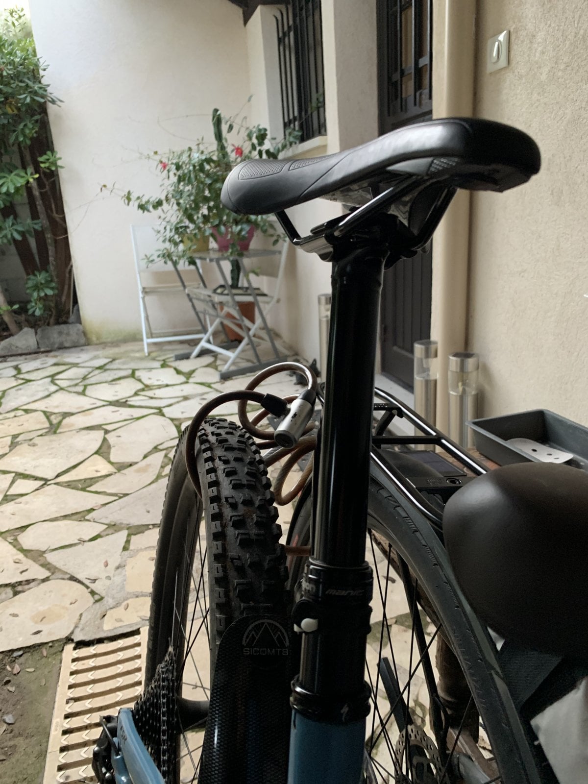

If a new cable (and 359mm total) is number Im looking for then worst case is a new cable and a guy in an LBS learning some new Anglo-Saxon. View attachment 47138
May just be the photo but is the seat pointing upwards? On my bikes I angle it down slightly, so when climbing I'm not sliding off the back of it
Thanks for noticing. It is however an optical illusion. I thought the same when I looked at the image. Thankfully, when I went out and checked it is slightly inclined to the front of the bike where I thought it was !
