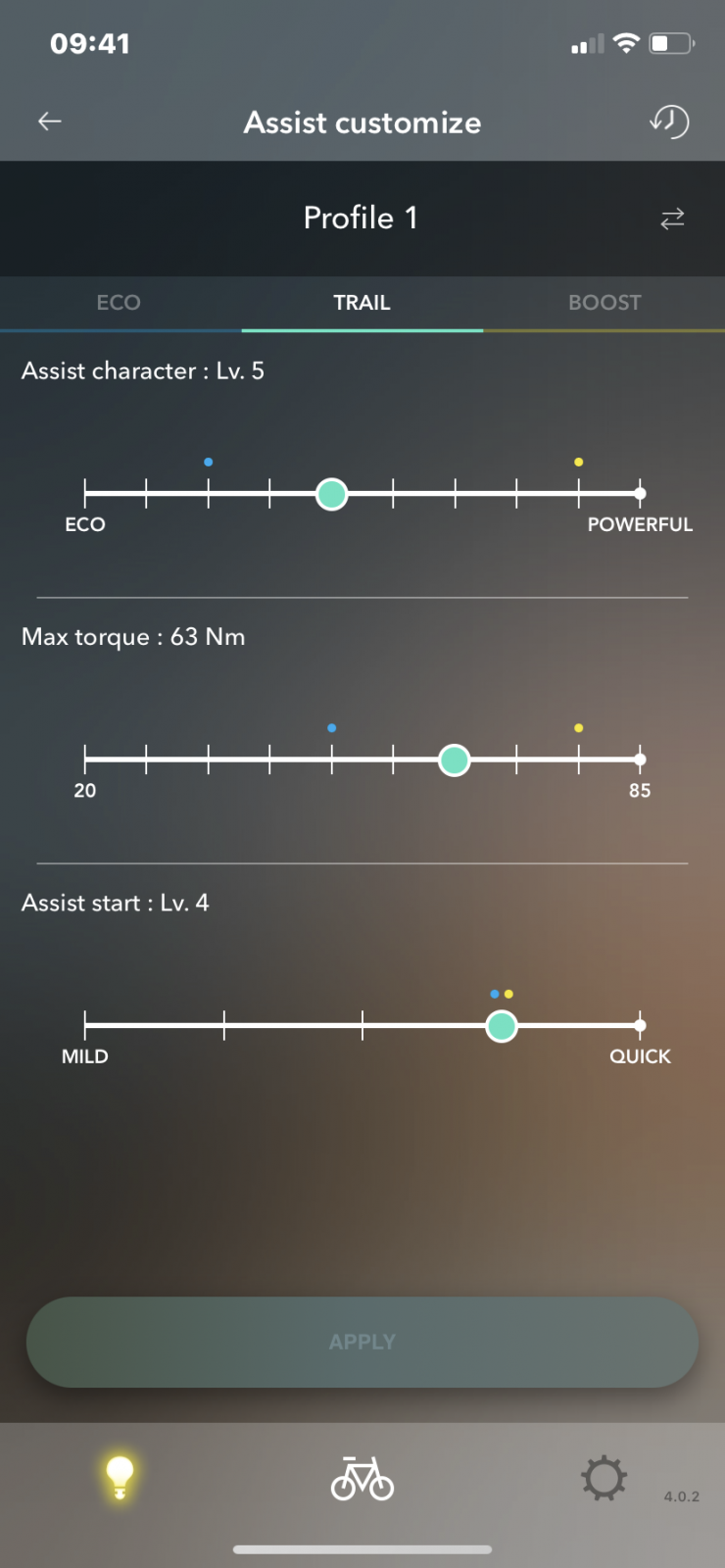

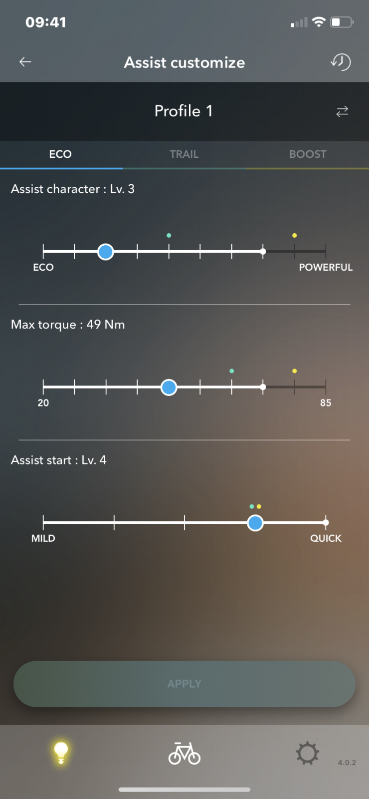

Here are my personal settings for my Heckler MX under "Profile 2":
- ECO mode: increased the torque to 34Nm
- TRAIL mode: decreased the torque to 78Nm
- BOOST mode: decreased the assist character to Lv. 8
I get great range...recently did 13 miles and 3,028 ft elevation gain with two bars left.

I used the profile 1 settings yesterday for a 44km ride. I did 3780ft of climbing and was mostly in trail and the battery died at 39km. I found the standard settings a little overkill so will make some tweaks . I'm 230lbs kitted up.

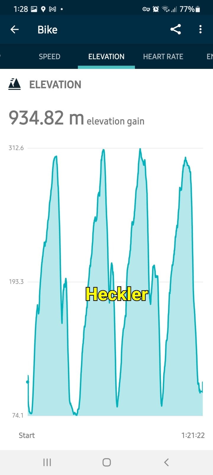

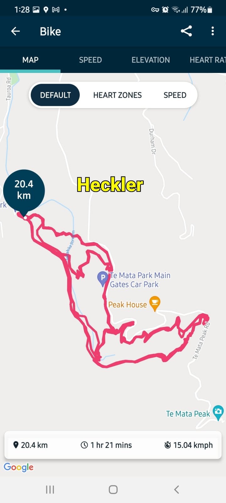

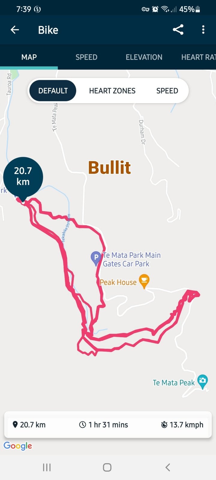

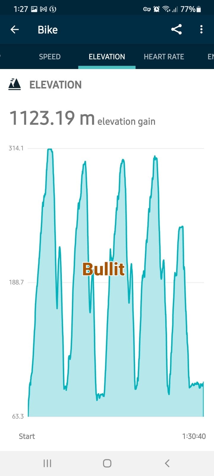

Bac
Sep 13, 2021
45
41
New Zealand
Not sure why, but I'm getting very similar distance and elevation (same trails, same mode, etc) on the Bullit as I was getting on my old Heckler! I would have thought I should be able to get around 16% more?

More power, more weight, heavier gripper tyres?
Shouldn't be any more weight. Tyres, I ditched the Maxxis for Michelins which roll easier. Weird thing is, I can tow my boy 8YO on his Norco with the Bullit and still get the same distance/elevation... 4 runs
