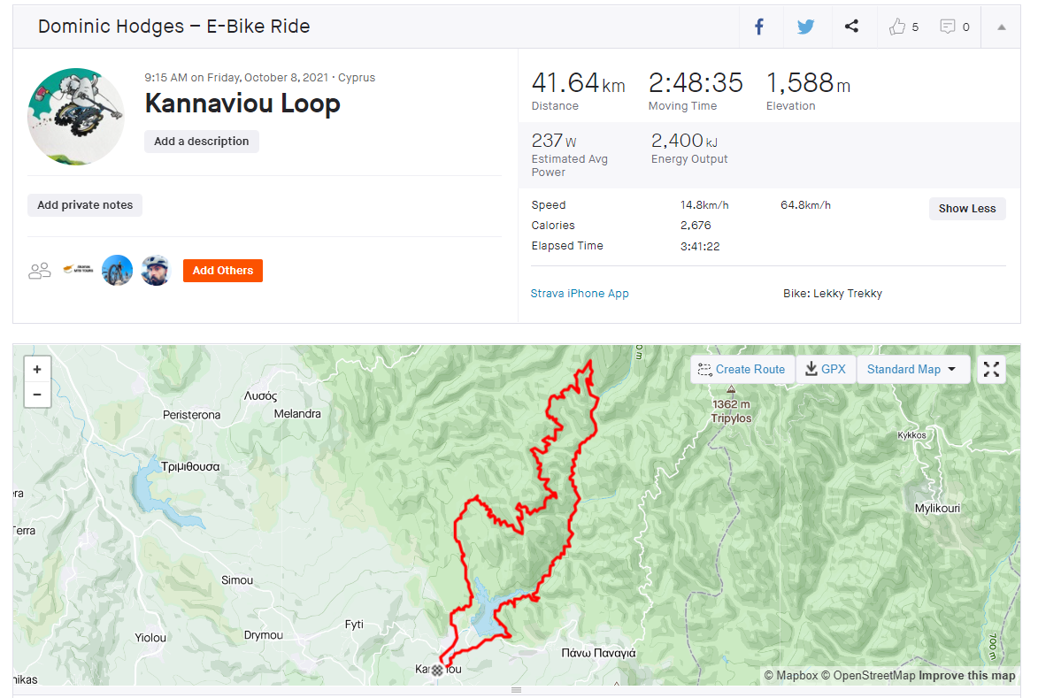

I did this ride on 40-60% of battery last week. I can't be more accurate than that, it was still showing 3 bars on the display but I don't know how close it was to dropping to 2. That was a Commencal Meta with the EP8 and 630Wh battery. Rides was all fireroads and at clockwork pace but I was still impressed compared to what I've seen from my mate's Bullit.

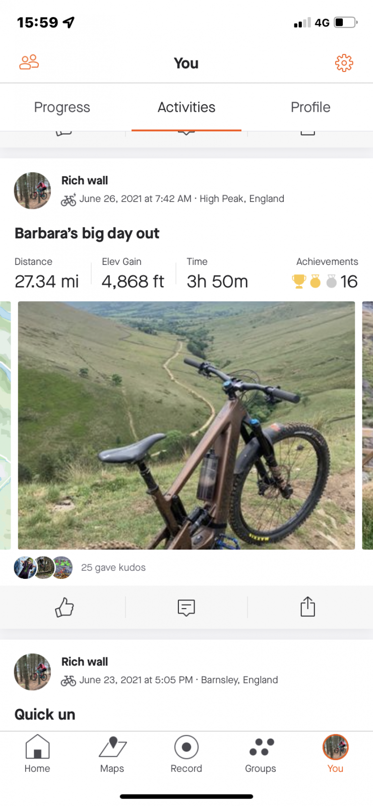

Richwall
Jan 15, 2021
89
100
Uk
Defo need to get in the app & dial things back, i was the same after my first ride on the Bullit. After dialling things down and ditching the Maxx grip Assegai for a Max Terra Dhf I did this ride in the peaks & got back to the car with 1 mile range not bad considering im 6ft & 16 st.

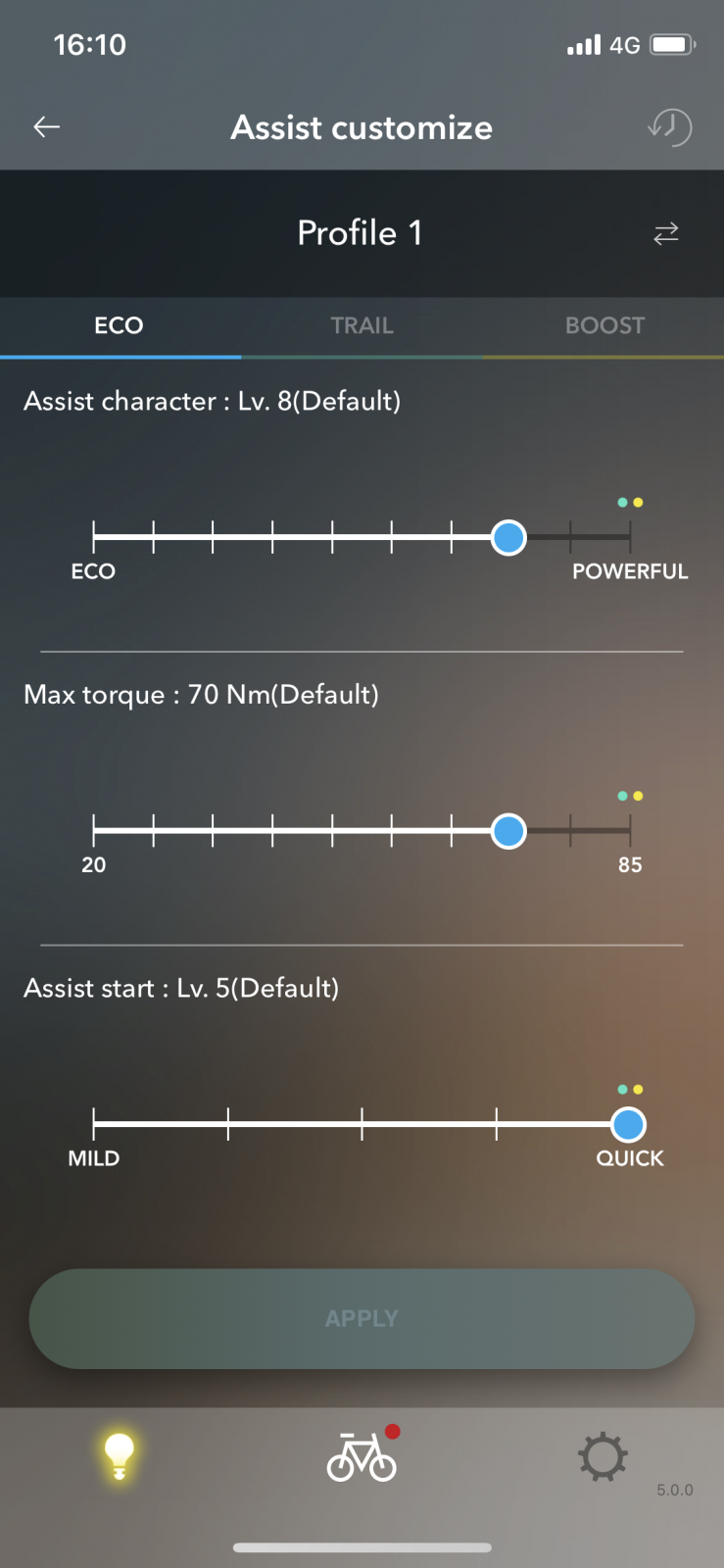

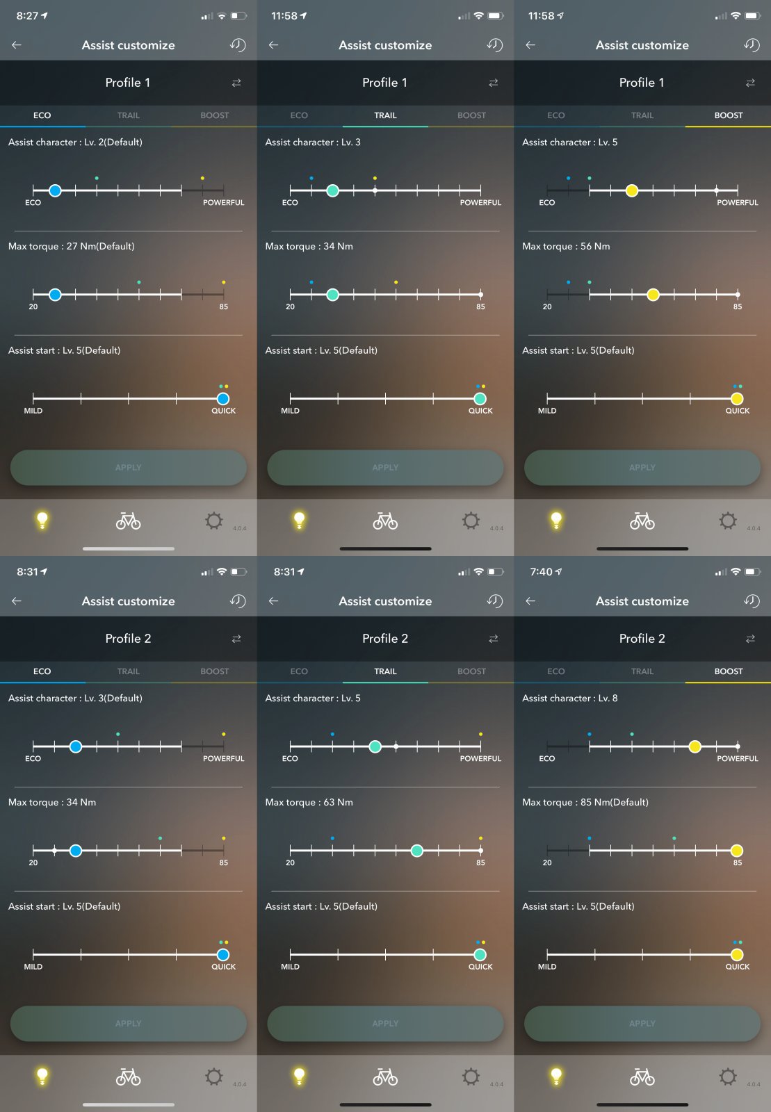

I'm attaching a pic of my assist profiles. Profile 1 is my "Serious" profile, for those rides that are going to be long and in the remote wilderness. Profile 2 is my "Play" profile, for those rides that don't require a lot of commitment, like today's.
Figuring out how to sync your phone to Shimano's eTube app might take 5 or 10 minutes the first time you do it. Actually changing the assist profiles takes less than 5 minutes. You really need to get on this, as everything is just random guesses until you're certain how your assist profiles are programmed.
You should copy my profiles and spend most of your time in Eco mode, until you figure out how this whole eMTB thing works.

Ok, the stock profile 2 that is stock on the 2021 ep8 Santa Cruz bullit has plenty of range period. That’s it.

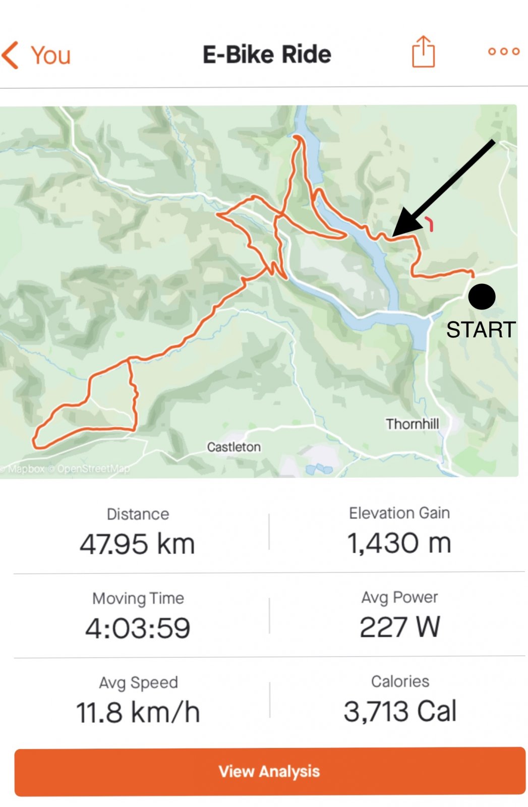

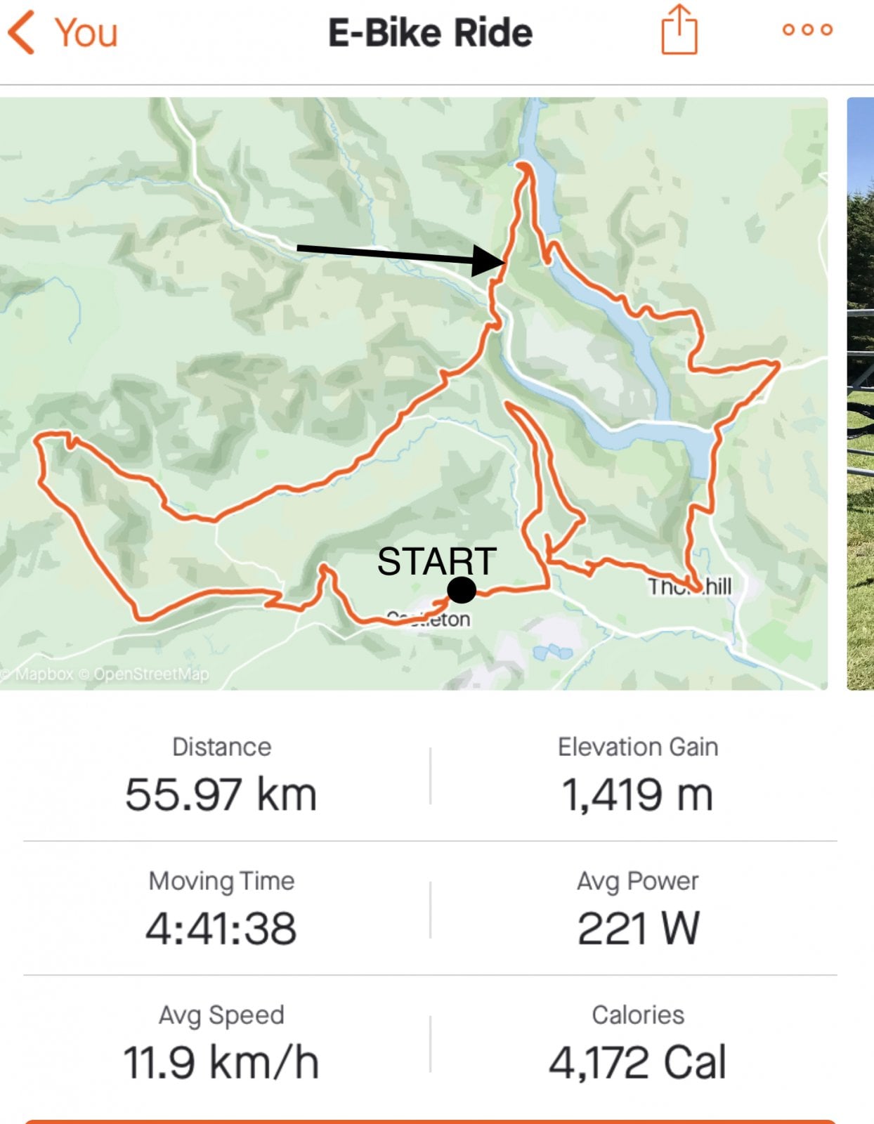

For bigger expeditions, for example Langset over CutGate all around the Edale Peaks and back, I bought a second battery.
Here are two expeditions in the Peak from Strava. I changed battery when the first cut out, which is not good for them 🤣 I’ve put an arrow where I changed the battery.
I changed the battery during the first just after the shepherds shelter at Grindle Clough above Ladybower when I’d done about 40km and about 3900ft climbing (arrow). When I finished roughly 7km later I’d used maybe 5% of the second battery - for example after the battery change, for the downhill parts, most of the time I was at or over 25kph not using the battery at all.
And I don’t race up hill in Boost, as you can see from my average speed, which also shows I ride consistently between the two expeditions over the same trails. Also, my average power is similar between the two, which is intentional and includes trying to maintain cadance by changing gears rather than power mode.
I changed the battery during the second trip at the start of the Lockerbrook run (arrow). I can’t remember how far I’d gone/height climbed when I swapped - you can guess as you know the area. Anyway, there was 60% left after many more Km, including a trip up the steep climb through Grindle Clough, a rather circuitous climb back up to Win Hill and the trip down the Roman road and then tarmac to a field outside Castletown where I started.

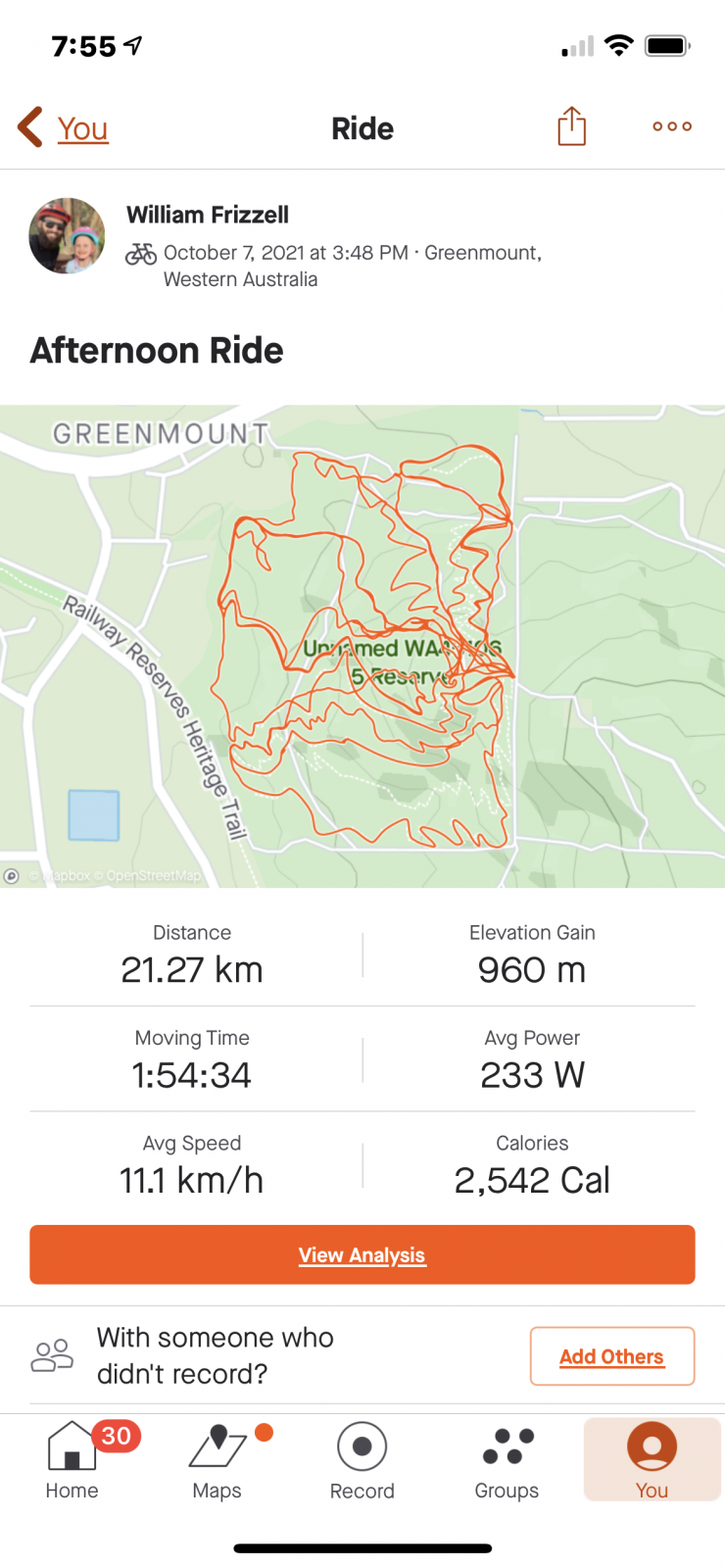

I weigh 115kgs and I recently did this ride. Did the first 700m in ECO and the last 300m in Boost. Still had 49% battery.
I

Heysy100
Oct 17, 2021
High Peak
So this was my factory settings….. what do the coloured dots mean please?? Do you adjust those as well as the blue ‘power’ dot?! Sorry if that’s a stupid question but I’m completely in dark….

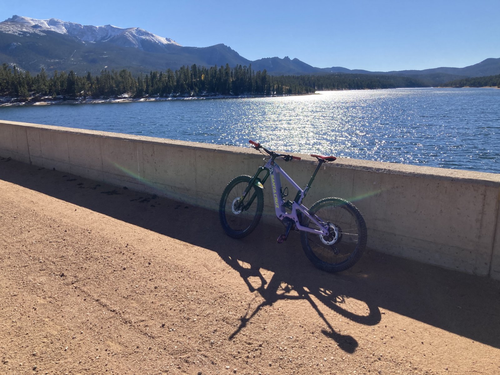

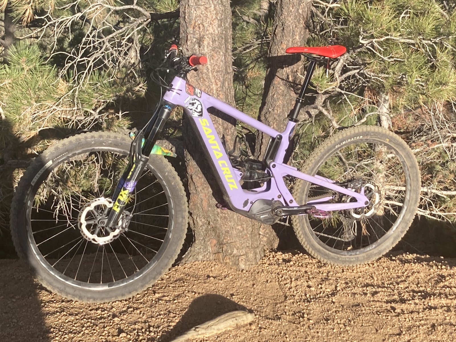

seamarsh
May 7, 2019
350
174
usa
I forgot to mention the biggest battery suck for me is starting and stopping.. especially on technical up hills! That initial burst of energy really taxes the battery.
