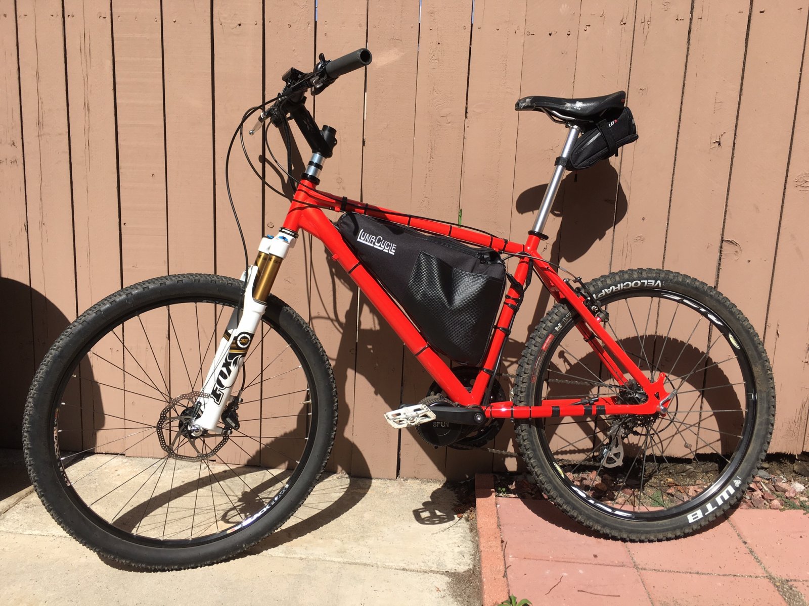

I built a steel-framed hardtail with a Bafang BBS02 paired with a 52V, 10 ah battery four years ago and the system still functions perfectly averaging two 10 - 20 mile, 1,500' - 3,000' ascent rides per week. My friend has had a succession of OEM (Felt, then Bulls) bikes and we ride together although my bike is more powerful. The cost of the system was less than $1,000 ($500 motor, $300 battery, $30 charger). The rpm-only sensor works fine and I prefer this bike to my "sophisticated" Haibike NDURO.
