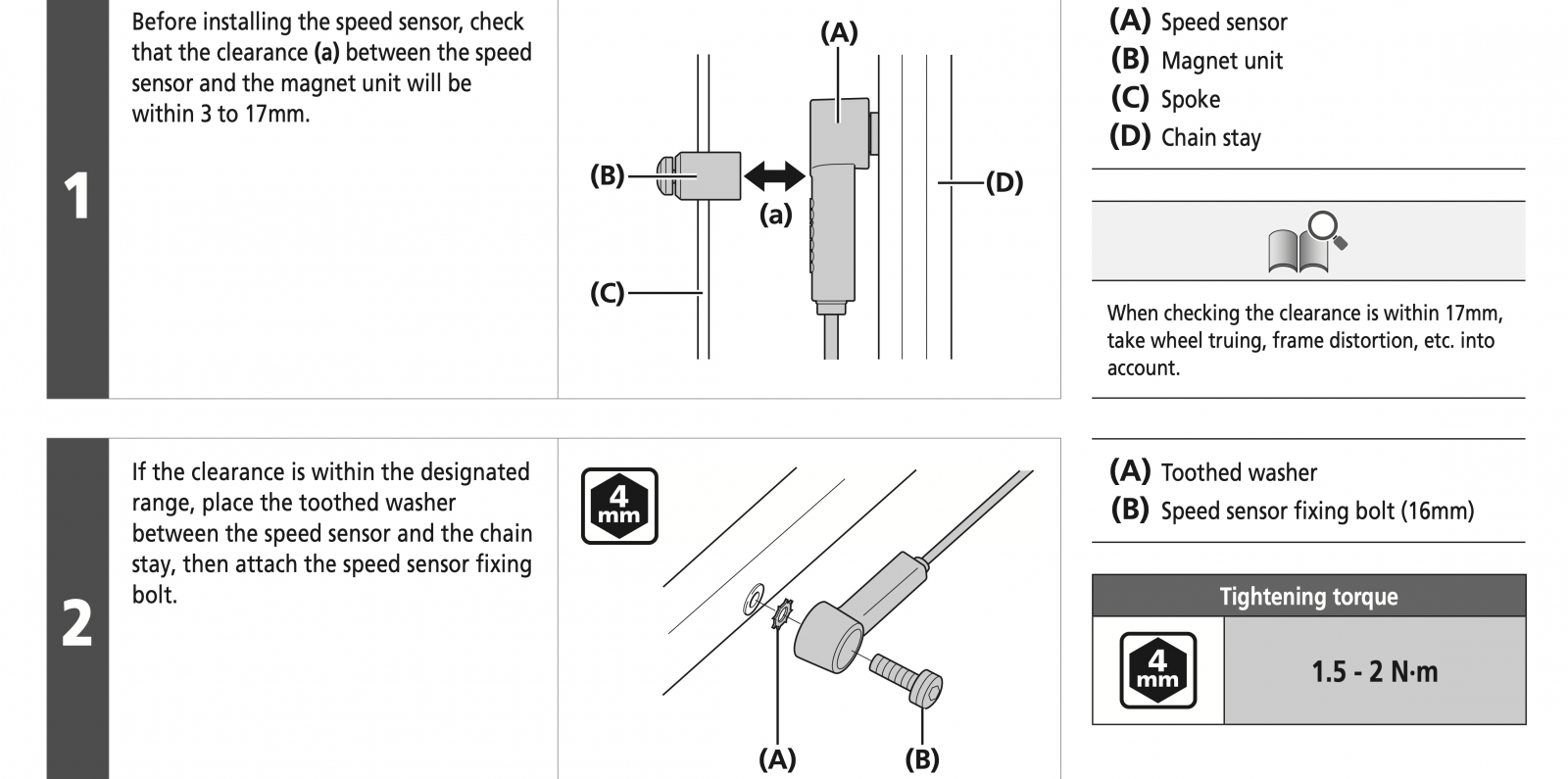

Which model is it, the new one with internal battery or the older one with external?
Edit: just seen you say AL6.0 so its the older model. Check the speed sensor alignment with the spoke magnet

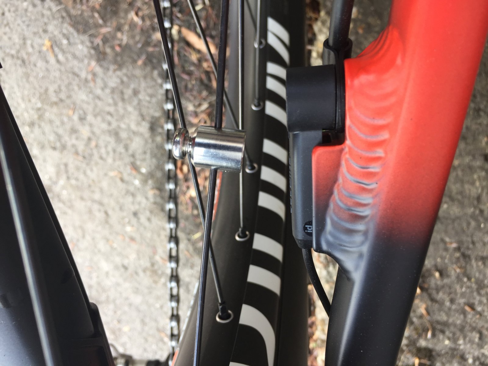

Hi R120, no joy I’m afraid. I got power this morning for a few pedal strokes then the W011 error code and a juddering noise and feeling from inside the motor. Adjusted the spoke magnet several times up and down but no improvement. This is how I found it and how the manual seems to indicate it should be:
