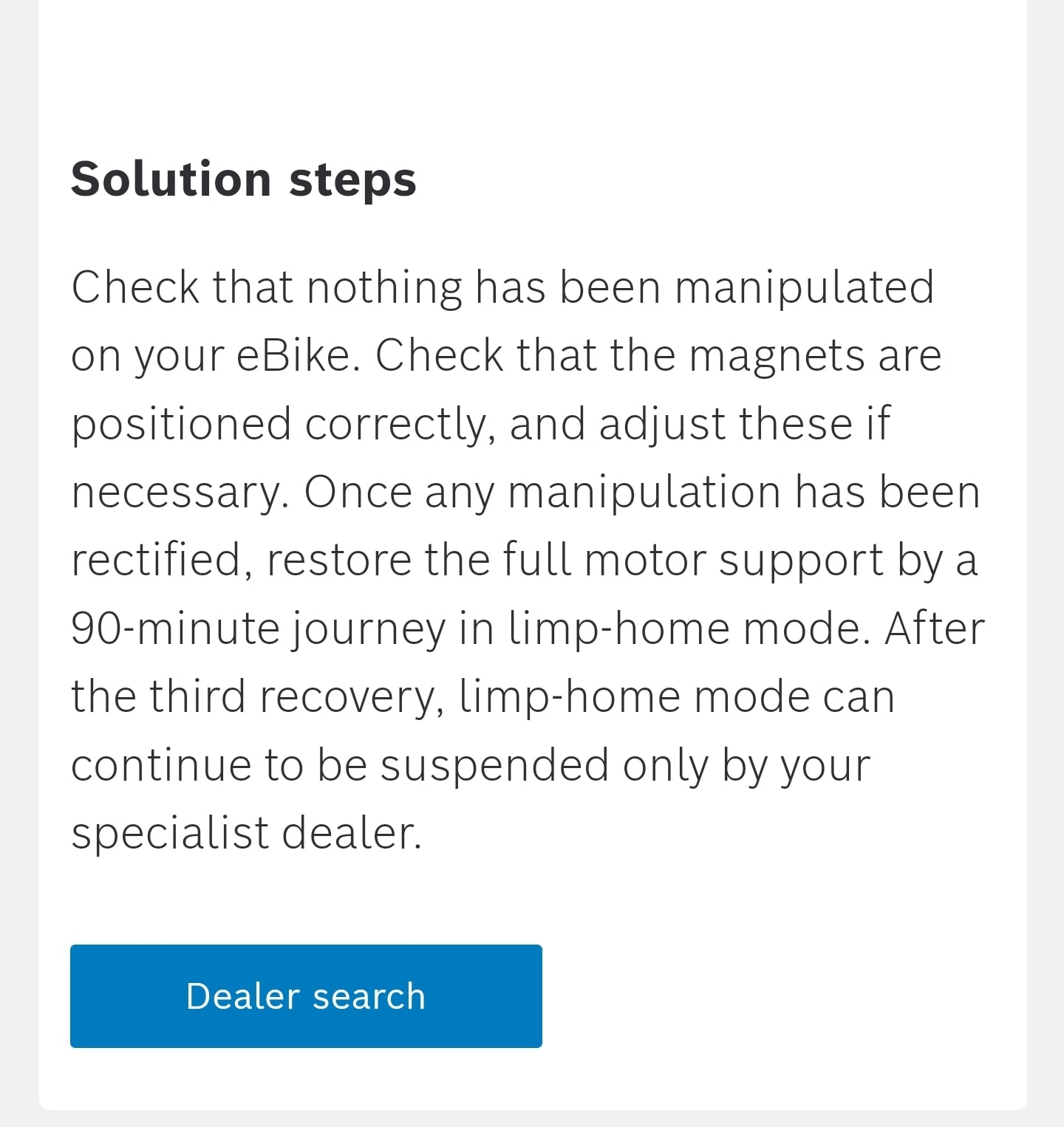

Just found this on the Bosch website, I'm pretty sure my bike isn't in limp mode any more but I did only do a quick test, does this mean I might have to ride it for 90 mins in limp mode?!! I need to go on a ride on Friday and I doubt I'll have time between now and then to do a 90 min ride in bloody limp mode.

Yeah seems my only option is to see if the error and/or limp mode comes back again tomorrow and if it does take it to the dealer and get them to clear it. According to that screenshot from the Bosch website you can clear it yourself 3 times by fixing whatever you 'tampered' with and ride it for 90 mins in limp mode but after the 3rd attempt the dealer has to clear it.
I've known loads of people use walk mode for various things like cleaning and lubing the drivetrain and setting up gears etc without issue, I've always lubed my chains like that and not had an issue, admittedly today though the bike did do 10 miles in the stand which is way way way more than it usually does when I'm doing something with it, so duration or distance must factor into it somewhere as well as probably resistance.

it takes 90mins riding in limp home mode to clear. After the 3rd time it's off to the dealer.
It has happened to me at work, I pedaled around in circles for a while then rode home, note that after 90mins you have to turn the bike off then back on to get power back.
Thanks, it's weird because after a 2 min ride in limp mode yesterday and turning it off and on again the bike seemed to work fine again, I kept it on for 5 mins and it all seemed ok, and turning it off and on again after than didn't show an error. I'll go for a quick ride after work today if I can and see what's what.
