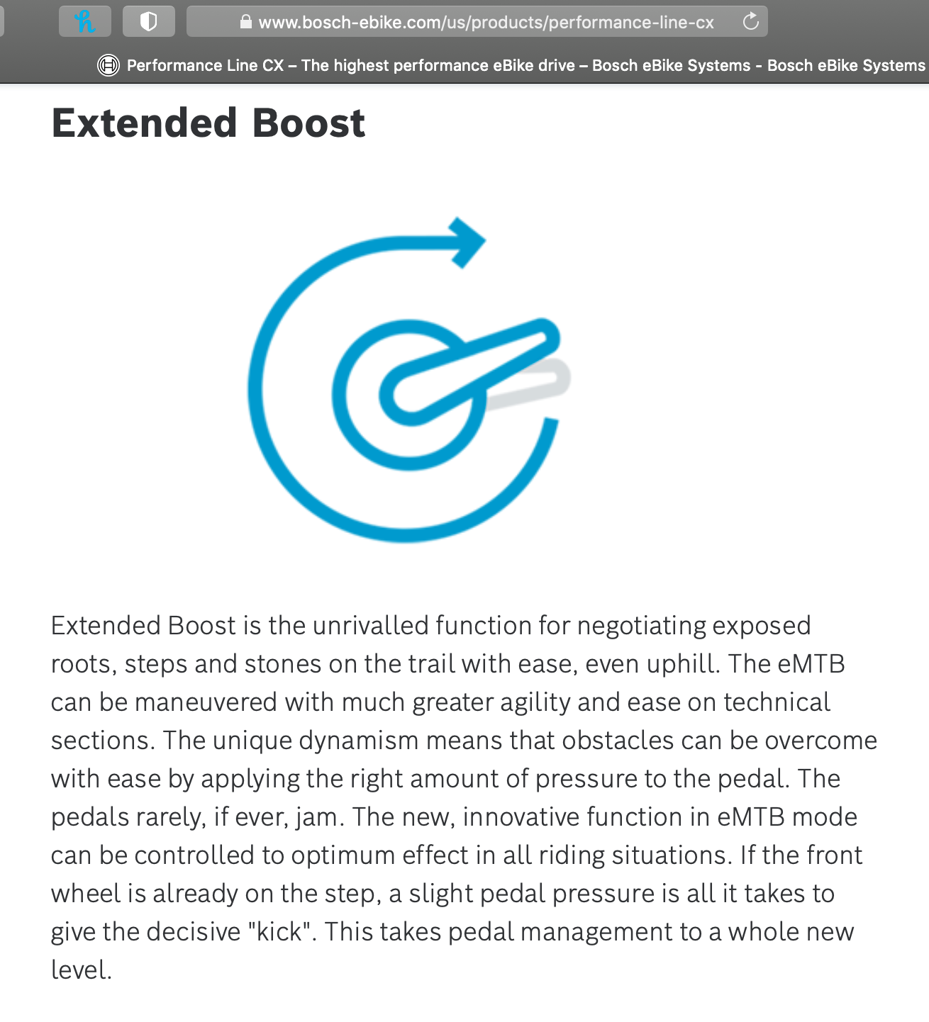

What you're describing sounds like the "Extended Boost" doing its job.
Which is something to get use too, I generally I start in lower mode depending where I'm riding. The only time I find the system over powering is when going downhill and I can't feel pedal resistances (if that makes sense), so I will switch to off.
Do you know which mode is installed, maybe ask your dealer to switch it to one that feels natural for you. Both Tour+ & eMTB-Lite are similar, but IMO Tour+ feels more natural, but still offers the punch of eMTB-lite. While eMTB, doesn't have Extended Boost pedal. And Sports, is non-variable power mode.

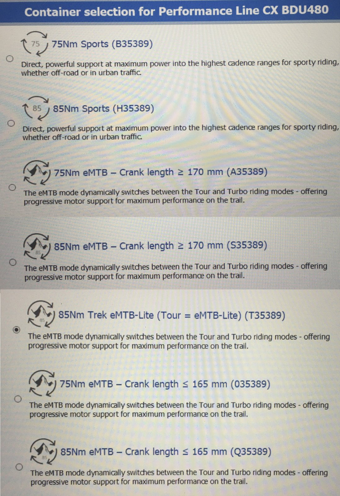

Officially no, not that I know. But from what I do know and what you’re describing sounds like you have either of of the newer mode, Tour+ (Magic Tour) or eMTB-Lite. Both of those modes have Pedal Boost feature. I can’t remember, if the eMTB had it in previous firmware.
This might be confusing, but I’m listing four different firmwares. Where each one had parts of their modes were different.
1. Tour+ (Magic Tour)= 60% - 340% (85nM)
2. eMTB Lite= 140% - 240% (85nM)
3. eMTB= 120% - 300% (75nM)
4. Sport= 200% (75nM) est.
Also attaching an image of the firmware option (which is missing the Tour+ mode). The chart doesn’t explain much, since Bosch has copy & paste text for each description. This is what the dealer will see before they update the bike.
I do suggest trying the standard eMTB mode (still dynamic, but not as punchy as the newer modes) or maybe the Sports (for a static level of power).
