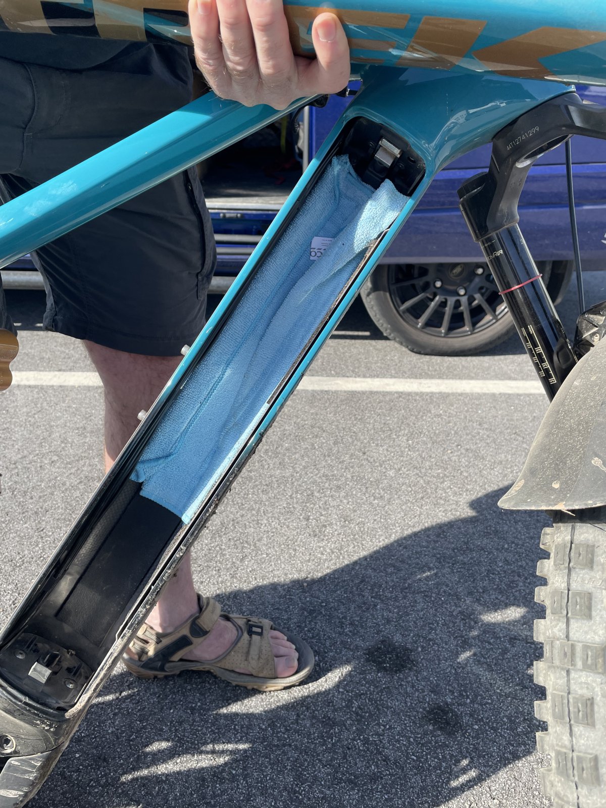

I met a chap today at my local Trek dealer with quite a unique solution….a simple micro fibre towel.
That looks like a good solution for cooler weather riding but I wouldn't trap all that heat around the battery during hot weather. The batteries on our e-bikes don't have active cooling like state-of-the-art modern EV's. Getting too warm will not instantly destroy our eMTB batteries but higher than ideal temperatures will shorten their lives. Of course, rattling around in there can't be good for them either.

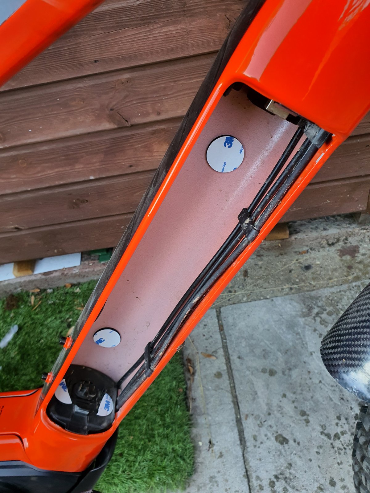

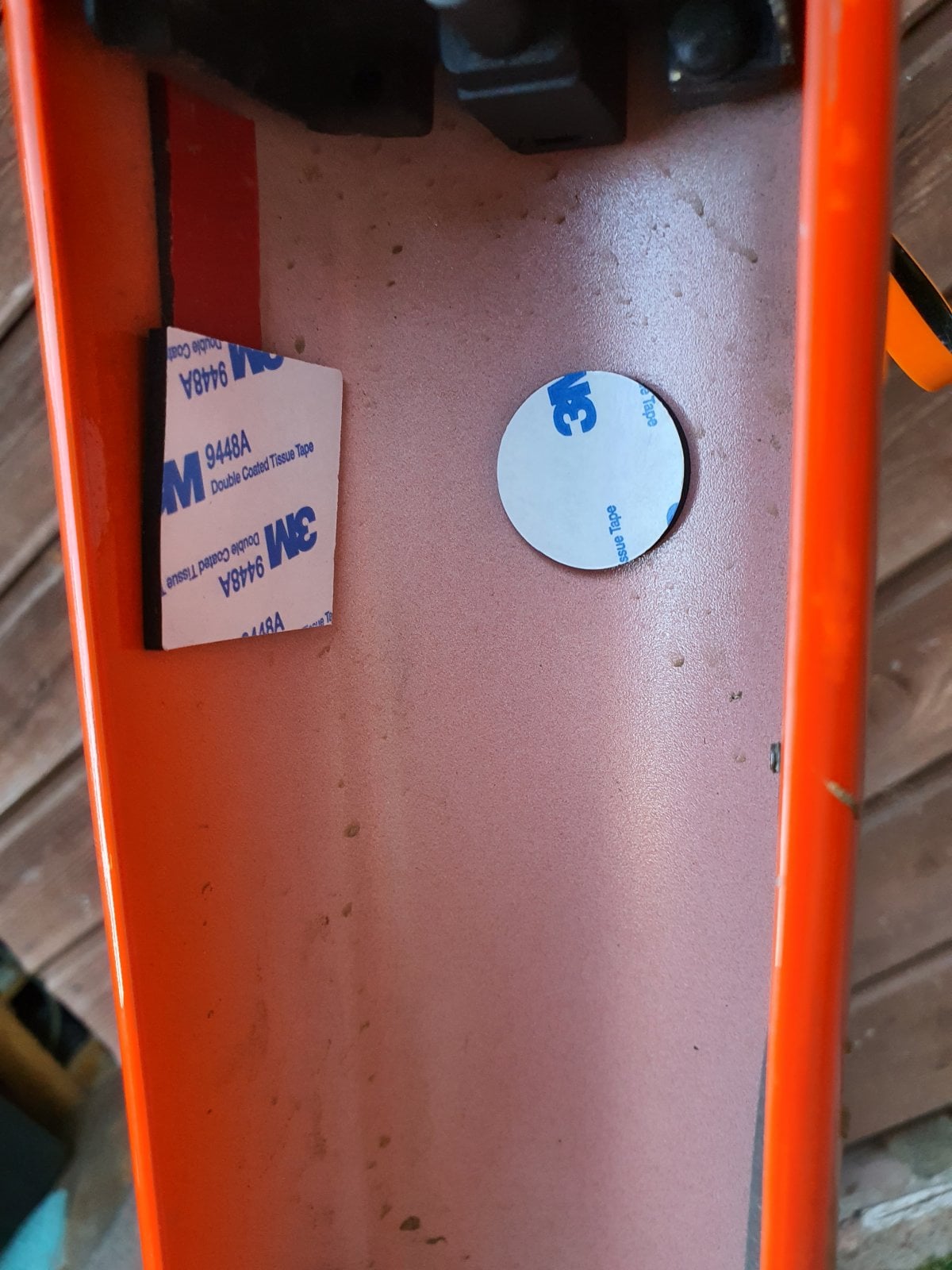

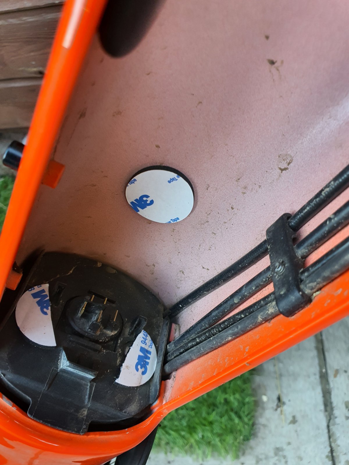

Hi I use some 3M sticky pads does the tick for me 🤗
he rags his bike through all weather and had no issues
I'm not claiming it will give him any "issues" other than a shorter battery life than it would otherwise have if the battery was allowed more airflow around it during hot weather. The longevity of a battery is largely determined by how well its temperature is maintained in the ideal zone which is why every advanced EV controls battery temperatures with liquids and why I would never buy a Nissan Leaf or any other EV without a state-of-the-art thermal management system for the battery.

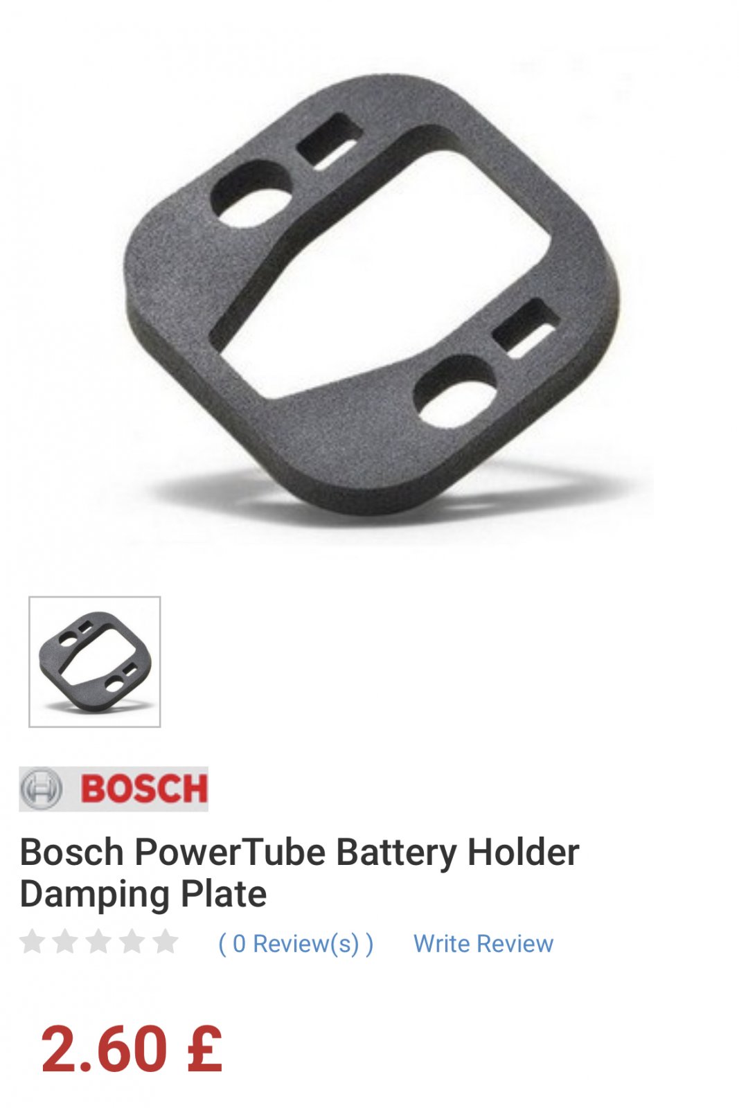

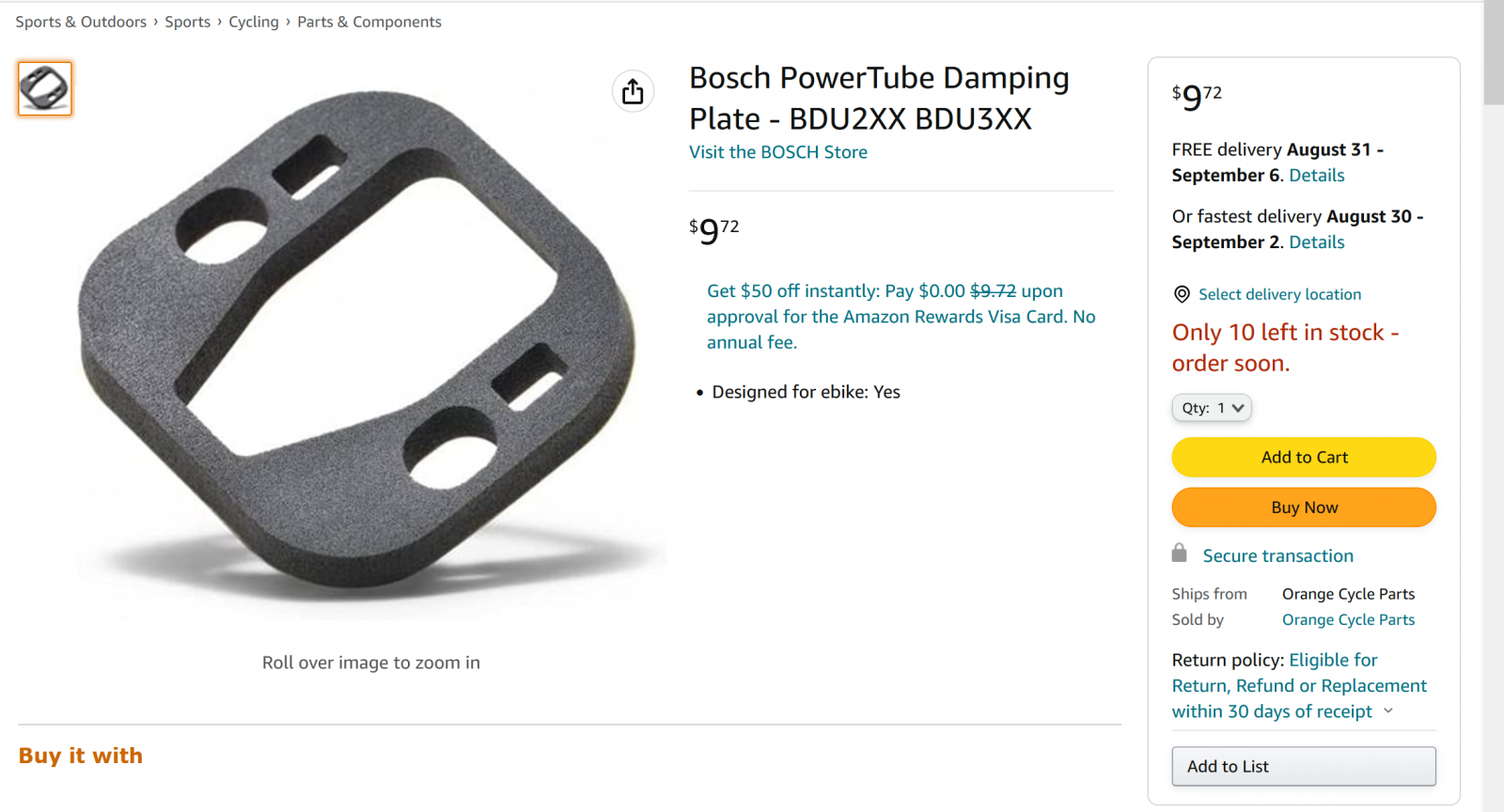

I ordered from here
Bosch don’t really talk about this (prob because they don’t want to admit there’s a battery rattle on many bosch bikes).
If you want to try and dampen / reduce Bosch rattling then try one of these. Cheap and worth a punt. I just fit one to my Rail and I hope it reduces or removes lateral battery movement that can lead to noise.
Bosch PowerTube battery holder damping plate
For PowerTube holder part number 0.275.007.440
I'm in USA, found this on Amazon. Note the description and PN.

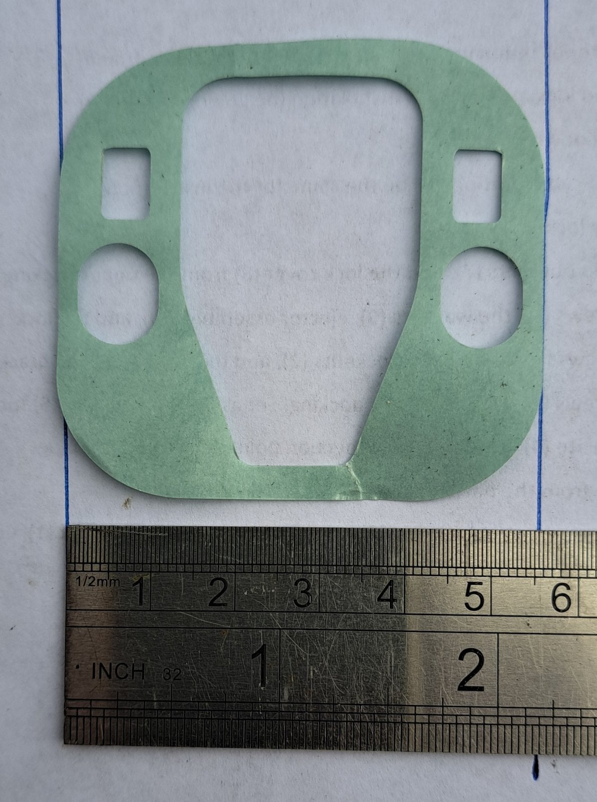

Yea ... I'd try it as well if there was a Canadian online retailer. I think @irie might be on to something.
Just cut out a paper template using my pic. Test it fits on the bottom of your bike down tube where the battery plugs in. Doesn't have to be perfect. Cut out a piece of foam. Make sure it fits OK. Simples.

If you did this Rail 9.8XT first ride review - EMTB Forums you'd probably eliminate all the noise. I did. If not, put some self adhesive foam inside the battery mount as shown elsewhere on this forum.
hth
