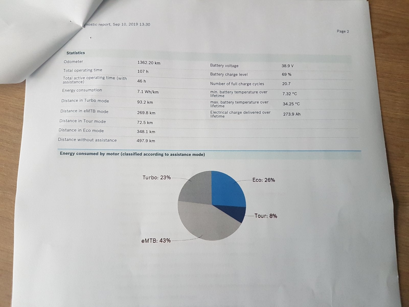

Just had my bike serviced got this for my motor good to c if buying second hand if it's ever been chipped are not.just stop all those people that are deristricted them that it voids us warrany
9,190
Its where it lists distance with assistance and distance without assistance - if it had been chipped it would have minimal distance or none in terms of km in the distance without assistance section

Afraid its not, if they think you had derestricted it they will refuse the warranty, and its pretty obvious on all the major manufacturers diagnostic software when things like 0 unassisted miles show up, or battery drain vs mileage show a discrepancy.
Several people have fallen foul of this.

In distance at bottom on pie chart it comes up with discrepancies on modes.so if bike is chipped kiss goodbye to warranty
I thought they would not be able to tell but but shop said done few bikes now told customers that warranty is void. Glad never chipped mine besides 15.5 mph is fast enough
This is only with bosch motor not sure about rest so it's up to yourself if chip it most motors have diagnostic software so prob can tell on rest my advise is if want keep warranty don't chip it.until it runs out that is lol

I am not so sure about that. Unless they have some other way of proving a motor has been chipped distance without assistance is not a way to prove anything.
I have a friend and his wife with the exact same bike - both with 2000km give or take a couple. They always ride together and the discrepancy in mileage is John doubling back if he has accidentally dropped Jean. When they decided to upgrade last month they got a similar print-out. John showed about 380km without assistance but Jean only showed 30 or 40km.
Why? Because she was always using assist to stay with John.
Refusing a warranty claim based on those charts is a sure way to a decent law-suit.

Let's see some evidence of a bosch refusal. You must be able to cite at least one case. Otherwise its bs
I dont need to site evidence, its just a plain fact that if they think you have tinkered with the restriction or modified the motor they won't warranty it, no company is going to hand over a 1k motor fro free if they dont have to - if they pick up on it or not is a different matter.
With the Bosch system you have to derestict it via tricking the motor into thinking you are going at a lower speed than you are, which means they have to rely on an anomaly in the service record - according to mechanics I know they can nearly always tell if its been modified, but only prove it if the data shows compelling evidence.
With Shimano and Brose (in the Levo) you can change the software with third party apps, and this can be picked up on by the manufacturer as they can tell if the software has been fiddled with/replaced, so I would be wary of doing so.
However its down to the dealer handling the warranty claim to report any suspicions, and as most LBS's dont want to loose business many will turn a blind eye, I also know that in the case of Specilized some of their own riders use bLevo, and I know several of the pros you see round Surrey Hills have derestricted their various brands of motor.
My point is you are taking a risk if you blow your motor and it has been derestricted, but that's you choice, and I believe its up to individuals if they want to do so or not.

My point is you are taking a risk if you blow your motor and it has been derestricted.
None of the various hacks I have seen so-far do anything but work around an arbitary number. Changing the speed a motor will assist to does not make a motor susceptible to blowing - that is bad design and poor quality components. A design engineer working on one particular brand advised me that they can run double the peak output of their motor for several hours with no issues.
Exactly.

Actually when I run a diagnostic on any Bosch motor there is a place where it says Tampering if it says yes next to it, warranty is voided.
The EU handed down regulations to the manufacturers that they must have a way of detecting tampering and derestriction to be in compliance. It’s not just Bosch and it wasn’t their idea. Most Levo motor replacements I have seen in my shop were due to shredded belts. What most of these bikes have had in common is the use of the BLEvo app. The belt doesn’t hold up when the motor is tasked with going more than 30mph.
I check the settings with the BLEvo app first before plugging the bike into the Turbo Studio diagnostic software. I’ll call the customer and ask them if they use BLEvo. They usually lie to me and when I plug the bike into the diagnostic tool, it pops up on the screen that minimum wheel circumference is below the legal limit.
After that it’s a motor swap charged to the customer. Specialized does show mercy in that you can get a motor for half price under their crash replacement policy.

Actually this thread is about bosch motors not levos. I dont beleive this tampering diagnostic flag exists for bosch. Why don't you post up a picture? Someone somewhere must have had a warranty claim rejected if it exists. Smells like more bs to me.
Al Boneta
Dark Rider
Jan 18, 2018
1,351
2,602
California
Actually, I run a bike shop that sells a lot of Emtbs and I perform all of the service. I am a Bosch certified factory technician with all of the Bosch specific tools and diagnostic software.
When I was being trained at Bosch, they told me about the EU regulations while I was being trained. I was also taught the proper protocol to follow if I encounter a motor that has been tampered with. I have never encountered one in person outside of the Bosch service facility where they used one for an example.
I will post a picture when I am back in my workshop tomorrow morning, even though I shouldn’t have to, since you are offering no evidence to the contrary.
I only used the Levo example to explain that’s not just Bosch that has tampering detection. Sorry if you took offense, but that is really no concern of mine, now is it?
But if you like, you could always hit the ignore button on my profile and continue to make irresponsible speculations you have no evidence to support.
I will never understand the mentality that feels entitled to a warranty after it’s terms have been violated and it’s somehow justified for the manufacturer and dealer to endure the costs.
Have I used a cheat app on my Ebike? Yes
Have I used a cheat device on my Ebike? Yes
But when the motor finally shit the bed, I accepted my accountability and never tried make someone else pay for a replacement.
I suspect derestriction won’t be an issue much longer. With the federal government allowing Class 1,2 and 3 Ebikes to be used on all federal land, the manufacturers will be able to update Ebikes to travel at 28mph instead of 20mph. It will be almost double what it is Europe
