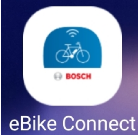

ohampel
Jan 4, 2021
18
israel
thanks for the prompt replay.
i have this app
on my samsung phone
every time when i try to connect the Kiox with my phone i get this message: "an app is required to use this devise" [translation]
any idea?
Mteam
Aug 3, 2020
1,859
1,794
gone
i have this app
on my samsung phone
any idea?
I have No idea what's going wrong.
That is the correct app, so you should just be able to pair it up to the kiox.
I think you need to start the pairing process in the app, not on the kiox.
