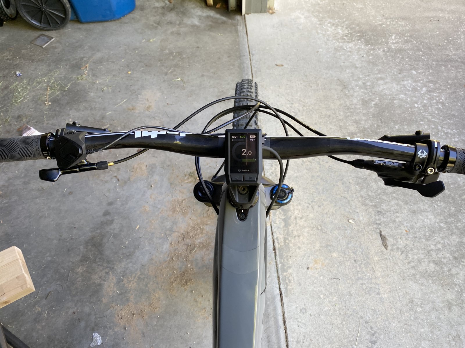

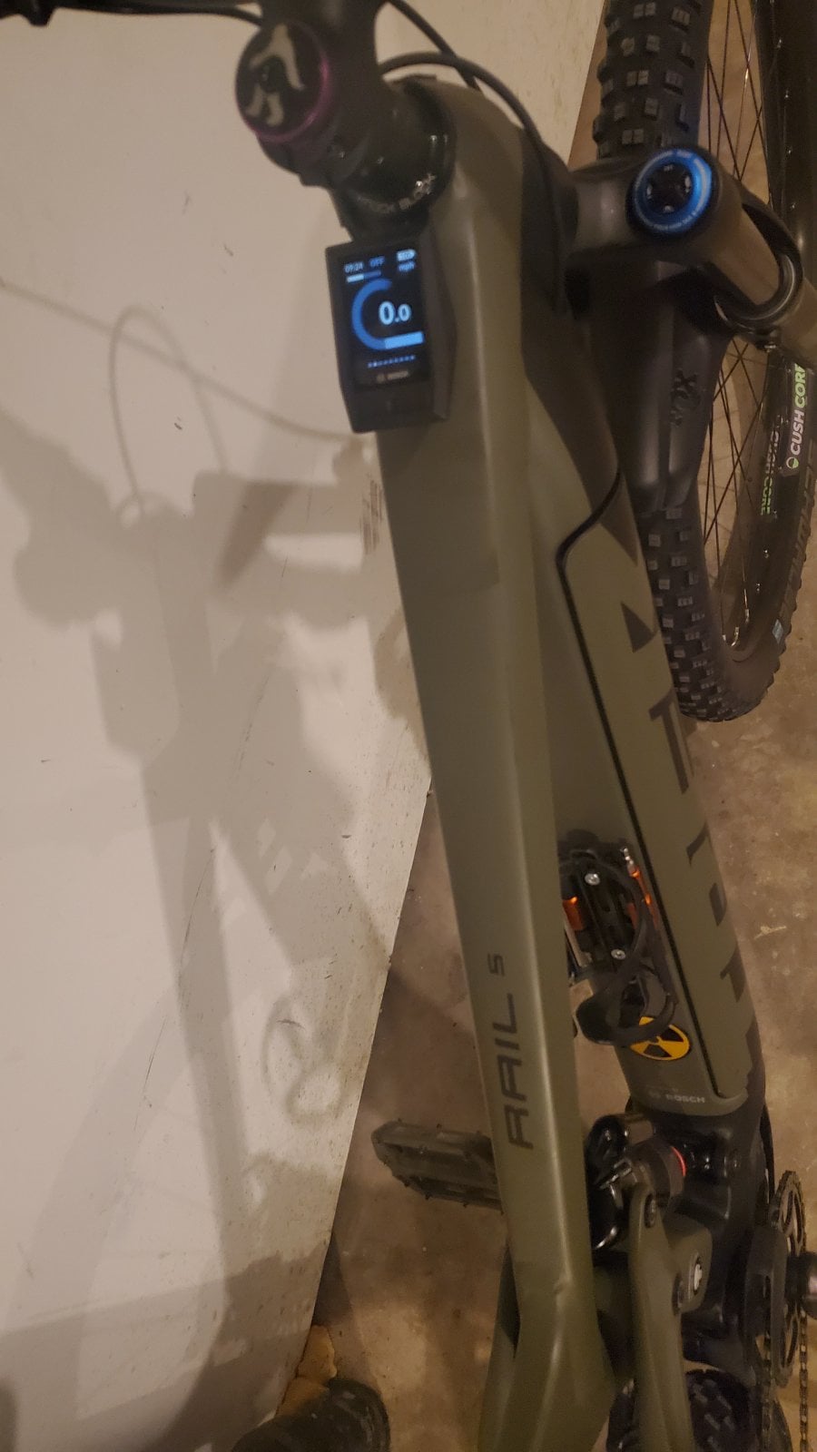

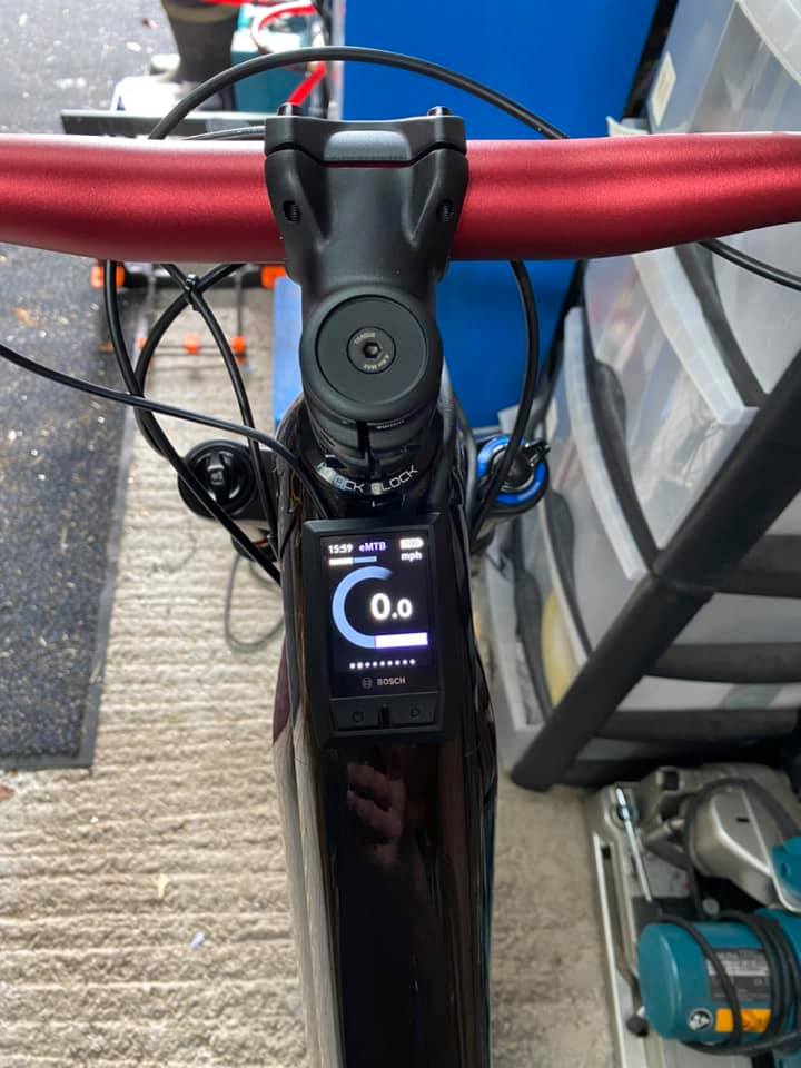

So fitted the Kiox on my Rail 7 today and also decided to fit the MT7 brakes I had for sale. Might as swell as I had to drop the motor!
Overall it was an easy couple of hours work. The motor is 6 bolts and is out. Very easy. Taken longer to mess with the battery mounts than actually doing the whole job lol.
Pretty pleased with the change. The Kiox seems allot better than the Purion in my opinion. But the main reason to change is the Lock security option.
Here some pictures
View attachment 29618 View attachment 29619 View attachment 29620 View attachment 29621

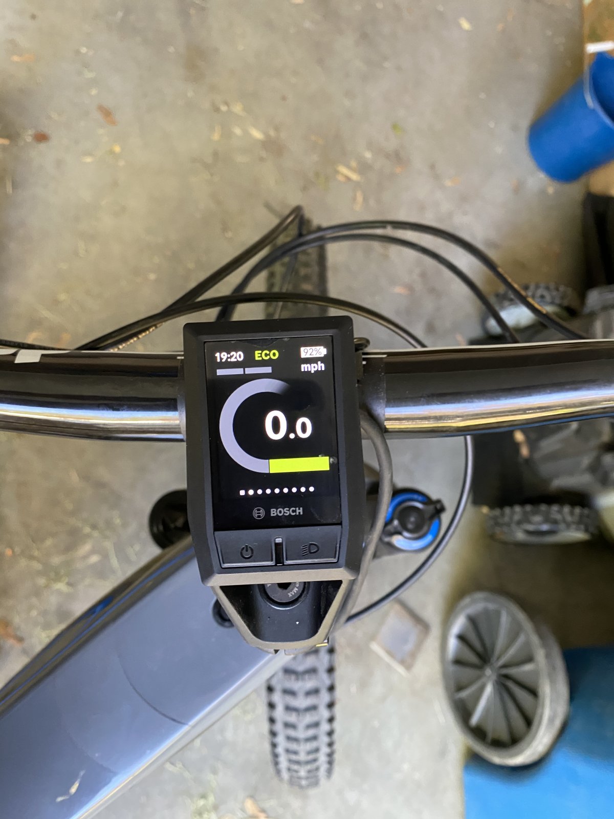

I like the kiox upgrade on my Rail 5. I just wish they had made the controller wireless/Bluetooth to the display.
LemonDrop
Jun 9, 2020
10
7

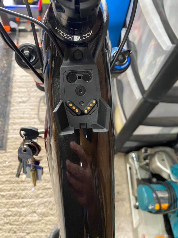

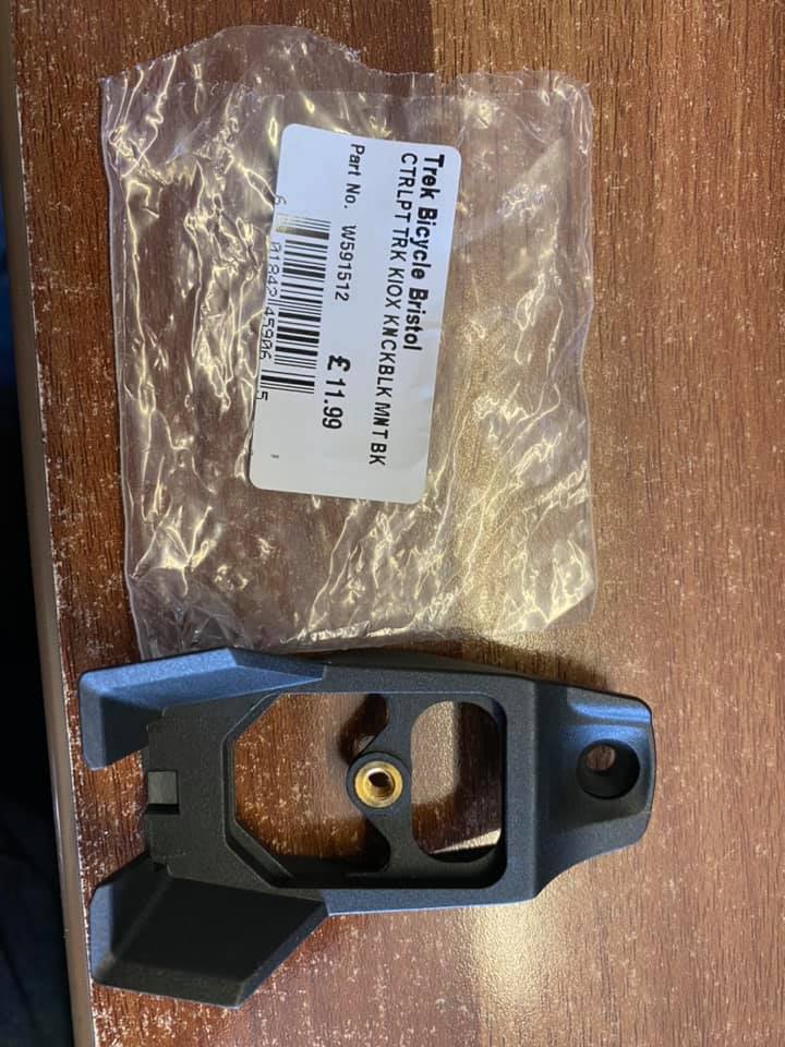

Nicely done, I’m thinking of doing the same.
Have you managed to find the top-top mount or will you be keeping it on the stem?
I could not find the mount anywhere. To my surprise, I find the stem to be the right position for it. If I had it on the tube, I would have to legit look down to even glance. Happy with it on the stem

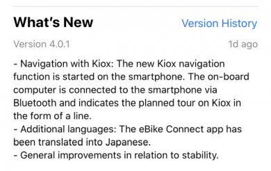

Added the kiox to my cube acid yesterday after getting the kit off amazon ,after seeing the navigation update coming. Seemed simple at first, but the end of the purions cable, unplugged end would not come out no matter how hard I tried, so I cut the cable instead and it was easy to pull it out , (butcher I know but I can solder cleanly later if I need it again) after that it only took me 20 mins, routed it around the brackets instead this time, didn’t take too long at all, and cheaper than dropping the motor as I didn’t have the tools, I noticed today that the ebike connect app updated on iOS, was hoping that would be the new firmware as it suggested.
