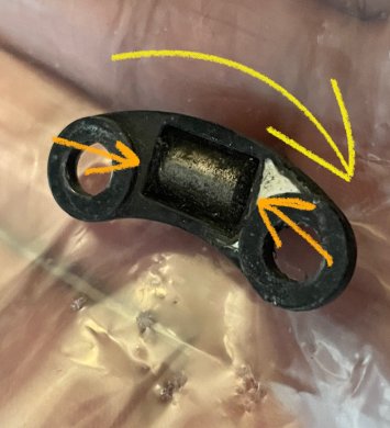

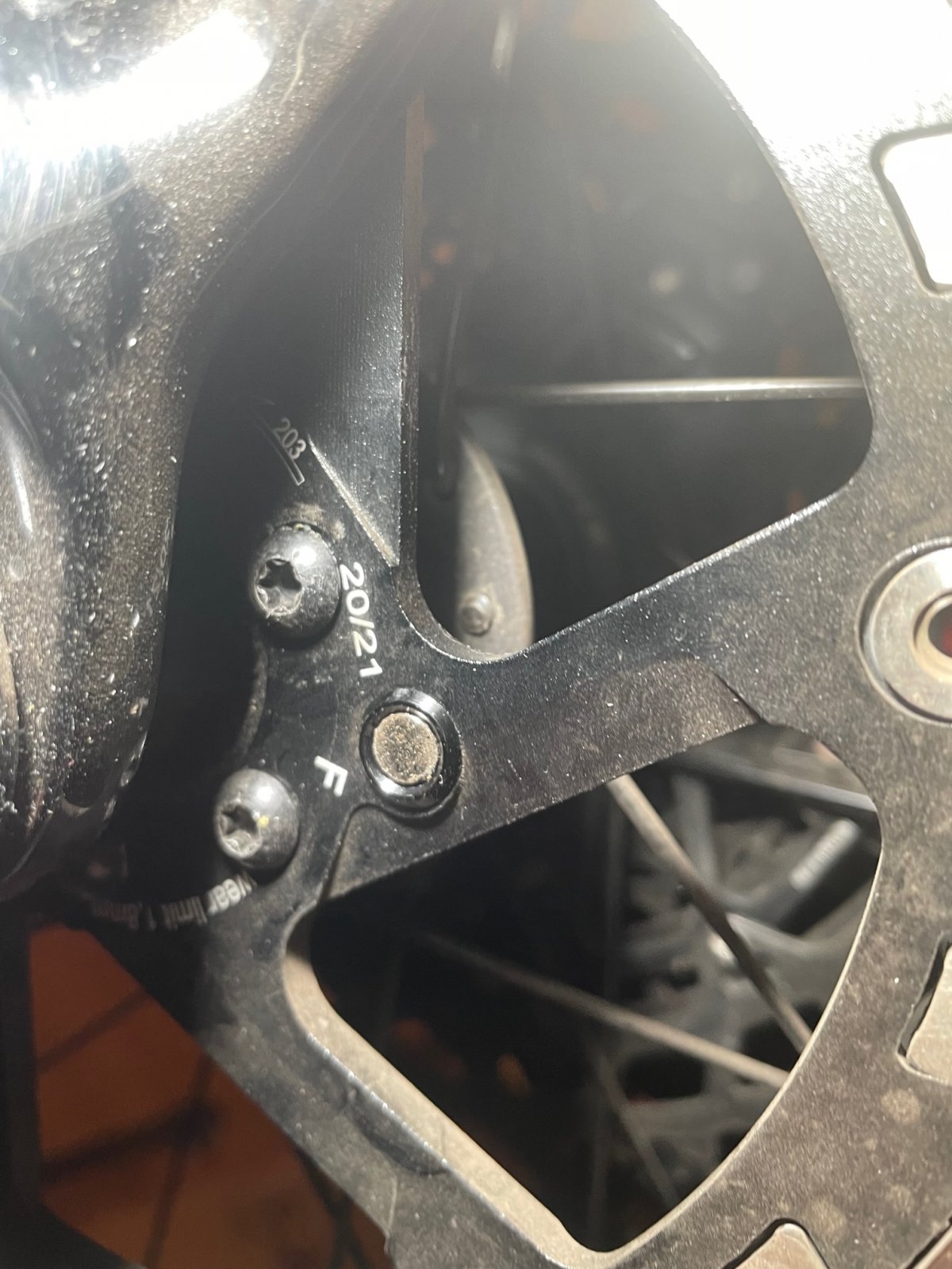

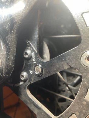

I'll prefaced this, by saying I took this measures as based as I could, so there could be some inaccuracies. If anybody has insight about magnets and how the possible positioning and direction plays a part in sensors, please jump in.
Wanted to share something, some readings I took about awhile ago, but haven't gotten around to post it. After months of waiting, I finally received Magura's Sensor Magnet that mount directly to the MDR-P rotor.
The few things I noticed, and thought about after mounting it was the magnet positioning and possible shield interference from the OEM magnet.
Looking at the back of the OEM sensor magnet you can see that its on it side (haven't tested to see which end is positive or negative **UPDATE** Both ends are Positivity charged). Either way, I wonder if this sideways mounting of the magnet with two positive ends could be causing false readings, since typical sensors are only picking up magnetic forces from one end of a magnet instead of two.
Just like most people, I have experienced the erratic speed readings, before getting the 510 error. Which I still believe is tied to EMF from some electrical lines covered by those steel plates (after rolling over them) during street construction.
I wonder if the housing has affect on this sideways mounted magnet.

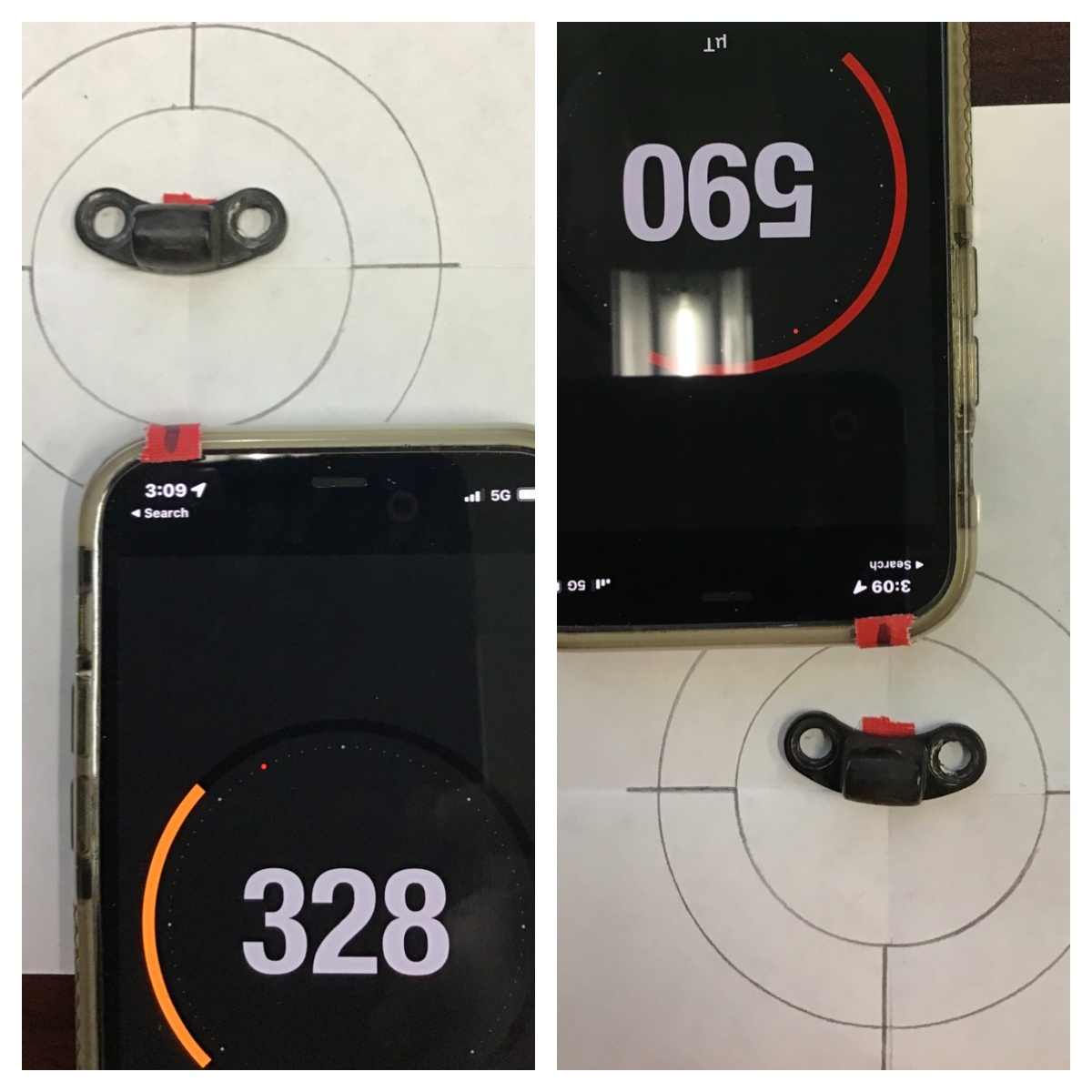

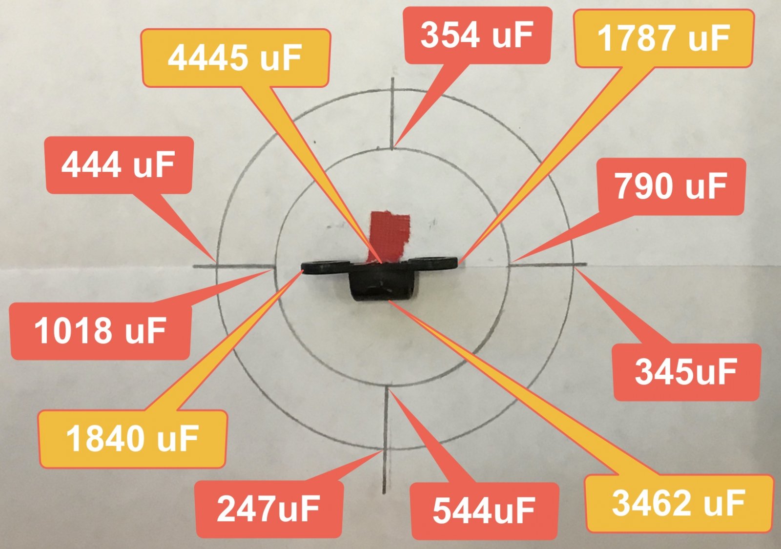

So I used am EMF reader from the app store, so readings are not 100% to the meter for this type investigation of a curious mind. Yes, I realize I missed a few readings and also a few readings from the Magura sensor magnet.
I basically took readings on a flat surface in 360° with OEM magnet positioned upright with the open back exposed. And the magnet placed in the middle. The reason for this was to see if the housing played any part of blocking magnetic forces.
As you can see from the readings how they changed depending on the position.
But most telling is when I took readings against the magnets on the covered (3462 uF) and uncovered (4445 uF) sections with a difference of almost 1000 uF.
I found this one to be interesting with the magnet laying flat and taking the reading from above and below, is how the numbers changed compared to (covered) front to (uncovered) back. Possible I took the reading too close?

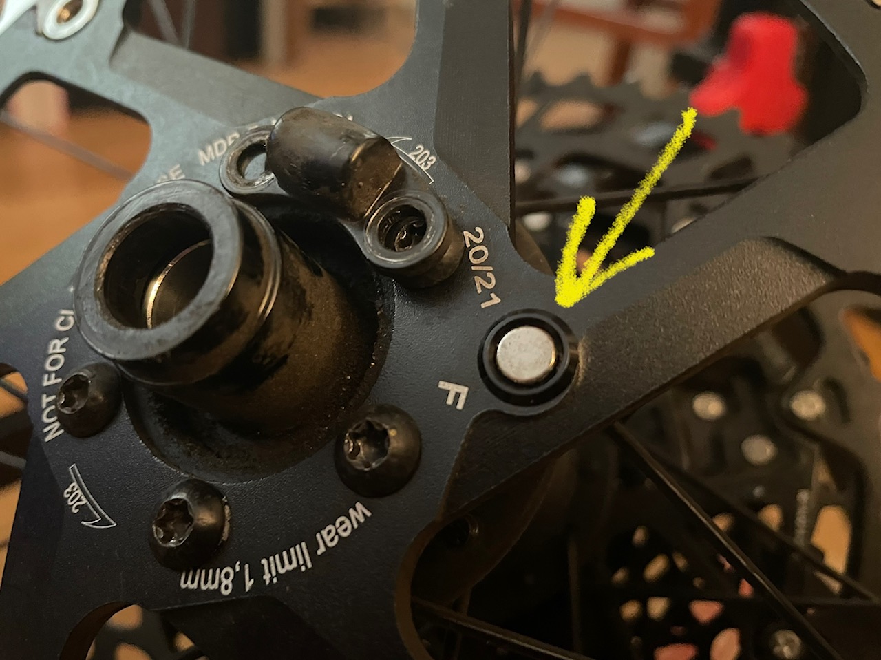

How it looks mounted.
So far I have ridden about 100 miles and the Magura sensor magnet does work, knocking on wood I dont have any 510 errors in the future.
