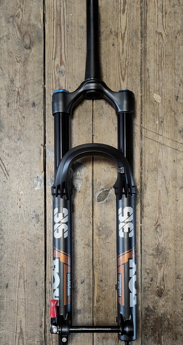

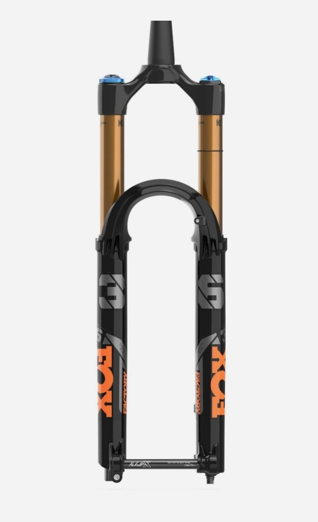

What do you mean?
Fox Performance Elite is Black:
Fox Factory is Gold:

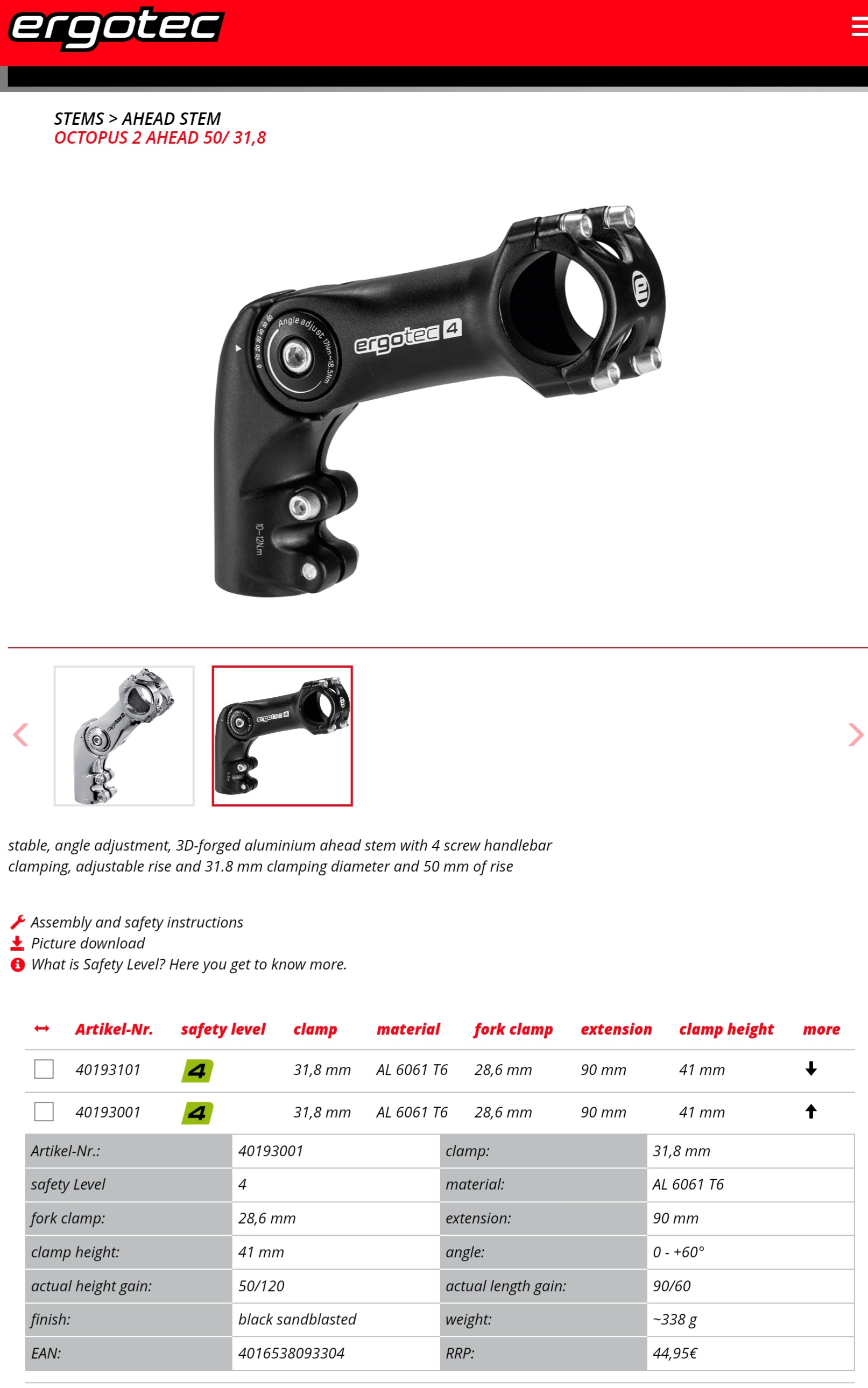

An adjustable stem can make a big difference to comfort where sore shoulders/arms/back are concerned, allowing the rider to adjust reach and sit more upright. They're best suited to bikes without headset cable routing: SATORI UP3 Bike Bicycle Riser Adjustable Handlebar Stem 1-1/8" x 31.8mm | eBay
I put an adjustable stem (Ergotec) on wife's bike to find out what she was most comfortable with. Then replaced it with a fixed stem and bars with ideal sweep and rise.

Keep in mind you can make pretty drastic changes to your posture on the bike with a riser stem/bar. I was having hand and shoulder issues with my stock Levo, but it's way better with a significant rise on the stem and bar. I can sit comfortably much more upright, while still being able to get into more of an attack posture where I need to.
The only real downside is needing to shift my weight more forward for steeper sections, but that hasn't proven an issue.
This is the way to do it. Never adjustable stems in mountain bikes for safety reasons.

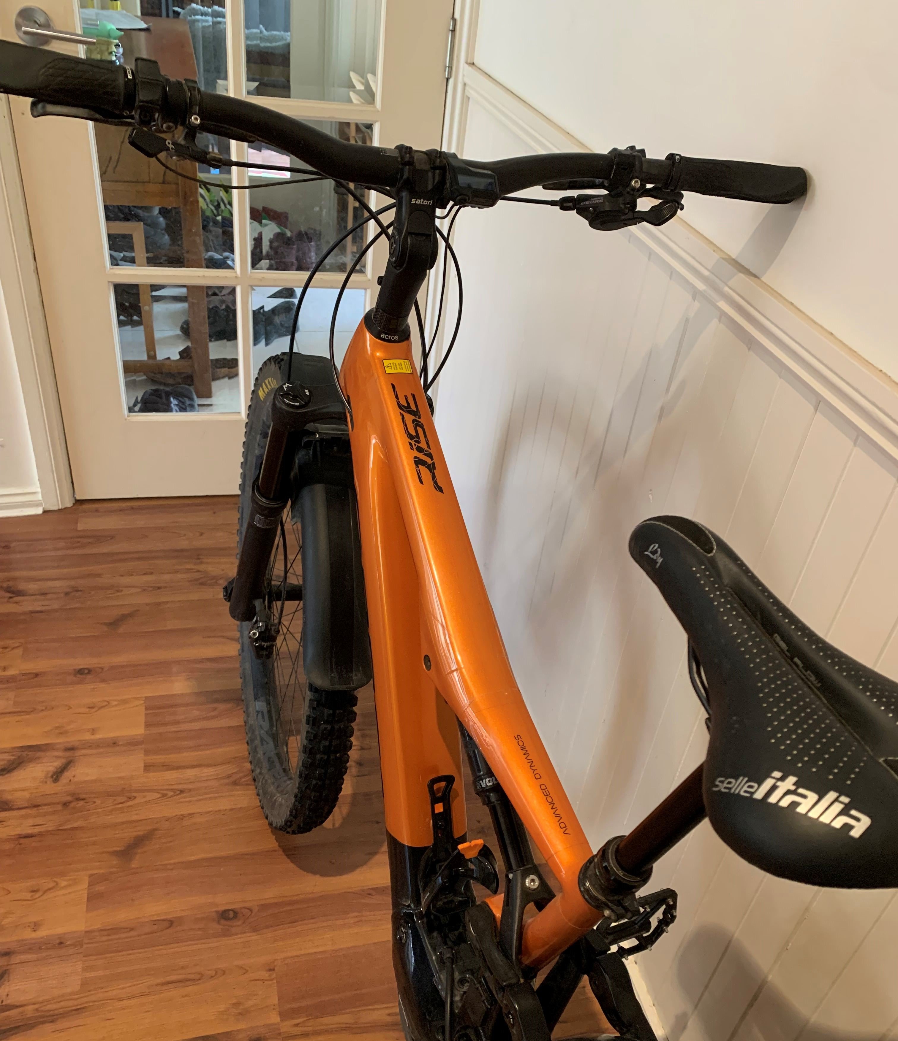

Here I bought a cool bike, some years ago.

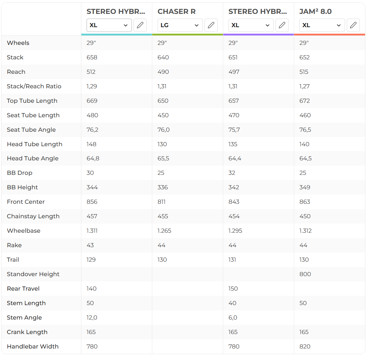

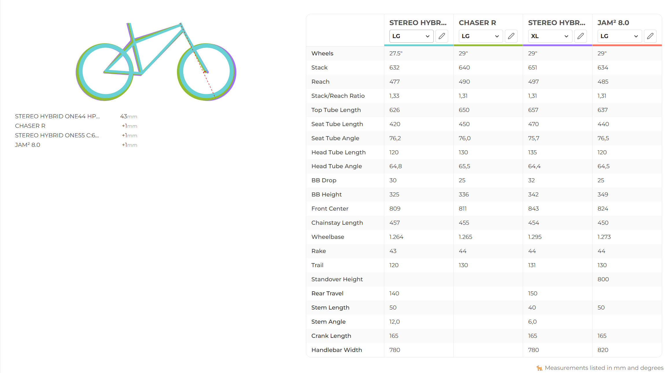

I have used 99spokes to compare geometry, but still it's not like I really understand what I'm seing...
your recommendations would be:
Cube Stereo Hybrid ONE55 C:68X SLX 750: L or XL (great weight)
Mondraker CHASER R : Only available in L
You didn't say anything about the Focus (8.8 or 8.0 if the fork is worth it, tre is even one with a CX race motor....for the same price), spec wise is good, found some Spanish reviews that really liked the bike, but I've hardly found any reviews besides the big comparisons, were someone deslikes the e-bike
I got here the several models with the closest reach?
XL
Cheers

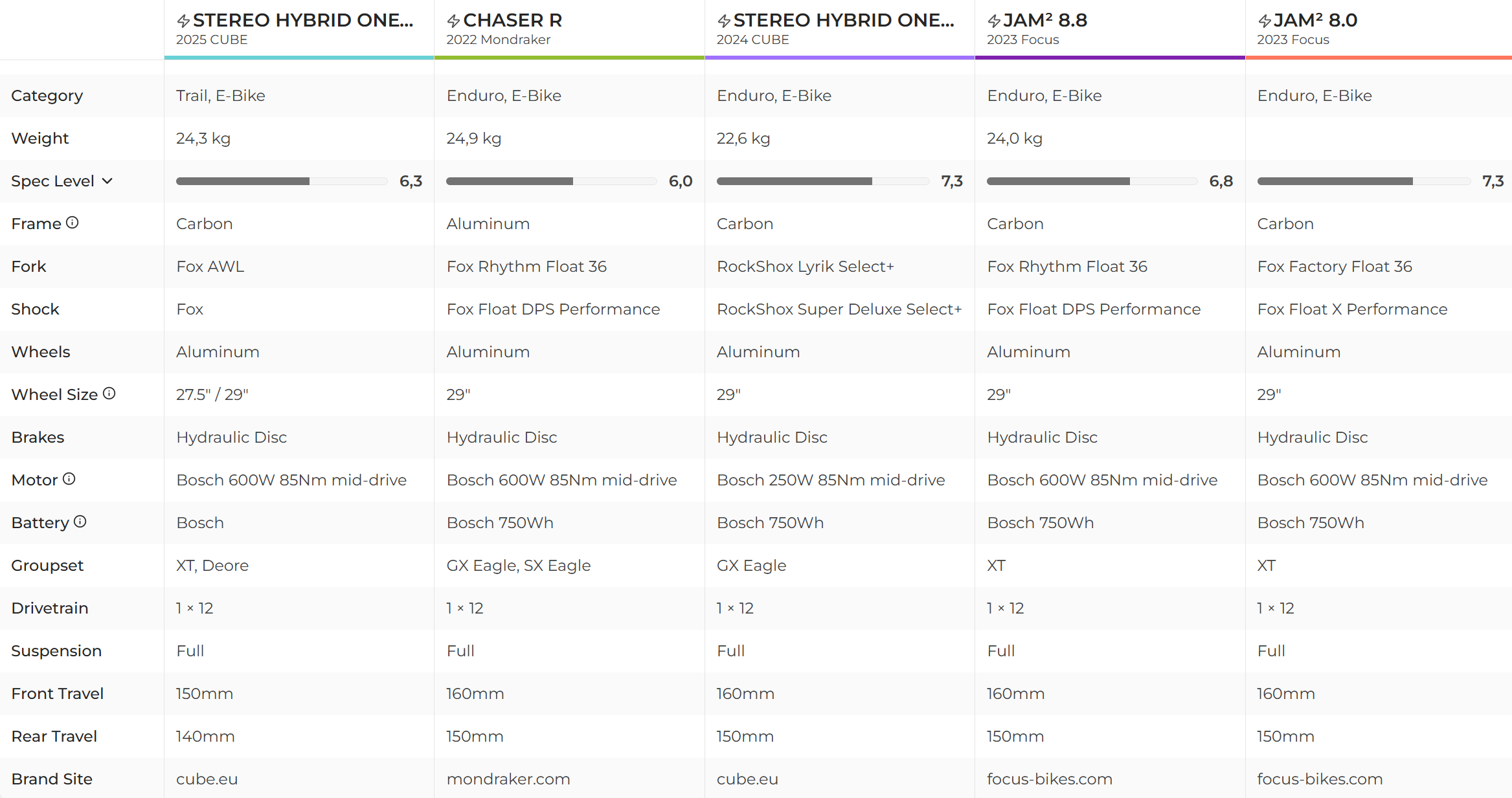

From my search this is what I've found for Black Friday Deals, any opinions?
THANK YOU!!🙏🙏🙏🙏
Budget up to 4k
150 minimum travel
Good suspension (comfort and less vibrations are mandatory)
Bosh Gen 4 Cx motor
Buying in EU, online no problem (I have a nice bike shop that services everything Bosh)
Size L or XL (He is 187 cm with 88 inseam and 105 Kg)
Black Friday Deals:
1. Cannondale Carbon Moterra LT 2 2023 - Size XL - price around 3800 €
It's more Enduro, but described as a very comfortable e-touring bike
Carbon but heavy 26-27Kg
Reach 511
170mm /165 mm
RockShox Zeb Select - RockShox Deluxe Coil Select+
Magura MT5
XT, SLX
2. Focus JAM2 8.8 - Size L - Around 4000 €
Carbon frame around 25 Kg
Reach 485 mm
160 mm / 150 mm
FOX 36 Float Rhythm + FOX Float DPS
Magura MT5
XT
3. Orbea Wild M20 23 - Size XL - around 4000 €
Carbon frame around 24 Kg
Reach 505 mm
160 mm / 160 mm
RockShox 35 Silver + Fox Float DPS Performance
XT, Deore
3. Mondraker Chaser R 2024 - Size L - around 3500 €
Aluminium frame around 25 kg
Reach 490 mm
160 mm / 150 mm
Fox 36 29 Float FIT GRIP - Fox Float EVOL Performance
SRAM DB8
GX Eagle, SX Eagle
4. Stereo Hybrid ONE44 race 2025 - size L/XL - 4200€
Reach 477 mm/ 512 mm
Carbon 25 Kg + 800w battery and Gen 5 Bosh motor
150 mm / 140 mm
Fox 36 Float AWL + Fox Float Rhythm R
Magura MT Thirty
XT, Deore
5. Focus JAM2 6.9 2024 - Size L - Around 3600 €
Reach 485 mm
160mm / 150mm
Sram DB8
XT
Thank you so much for your input, if anyone has experience with any this bikes, specially with confort with would help me immensely to make a decision.
Cheers!
Length in an eMTB is a big deal affecting maneuverability. The motor adds 8-10 mm. With the added weight and then length, it can feel like you are trying to throw around a school bus. My advice on sizing is look at the reach within 15 mm of your target from an analogue bike, With the shortest length compared to analogue, then adjust reach comfort with stem and seat. In my case, I went for a super light with Transition Relay in size XL and it was too large because of above. I had to swap to a size L and that took extra time and money. I am 6’2’’ 180 lbs. My analog ideal reach was 500 (fit perfect to an XL IBIS Ripmo) and my final Relay size L is 485 reach. If you could afford it, as per comments below, I recommend check out the SL bikes Relay, Orbea, Trek ExE, Santa Cruz or whatever the equivalents are in Europe. A forty something lb bike is really a different experience that a fifty something lb bike.

I think now everyone is overthinking this :)
aforementioned Focus, Mondraker and Cube are very good options,
485-495 reach should be good, however XL bikes have higher stack (handlebar is higher) - which makes them more comfortable
Mondraker Chaser R 2024 looks good too, 26kg. 160/150mm - at the end, a bit heavier, more travel.
Focus JAM2 8.8 - a bit lighter, weight around 24kg, 160/160mm - and just a few milimeters shorter, will be just a bit more manouverable, geometry quite similar to Mondraker
Stereo Hybrid ONE44 race 2025 - 24kg, new motor, 150/140mm, but suspension simplier (cheapest fork and shock - could work a bit worse), geometry looks quite close, just a few millimeters difference here and there.
all of them on 29x2.6 tires (more comfort).
difficult choice :)
you could read some reviews about Chaser and Jam2 8.8 and decide.
somehow Stereo looks least interesting to me, maybe becase of less travel or because simpliest suspension.
