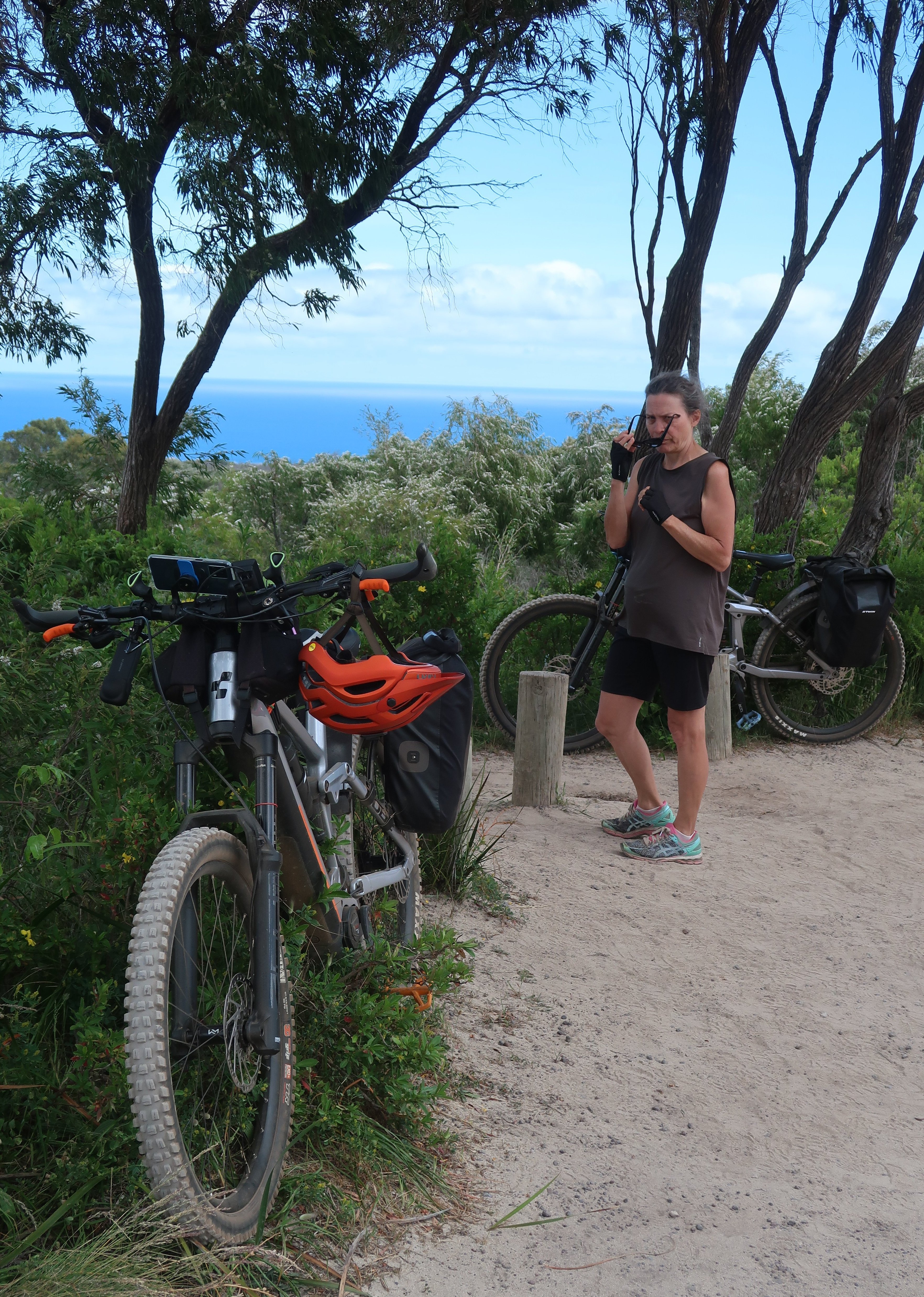

I have a Cube Stereo Hybrid 160 (w 750Wh batt) and me+luggage+bike=120-125kg so a practical day range with charging available is 90-100kms so in Holland you could probably stay on Eco and get closer to 120-140. Obviously, going where no charging available means you need to get inventive and visits towns for lunchtime charging etc.
Here in west oz its a great way to see quieter rural areas and we have lots of forests with gravel roads as well as trails.
I find that using an app like RideWithGPS is a great way to plan good routes (using Google maps to find charge locations & accommodation). Here's an overview of my setup... Cheers
