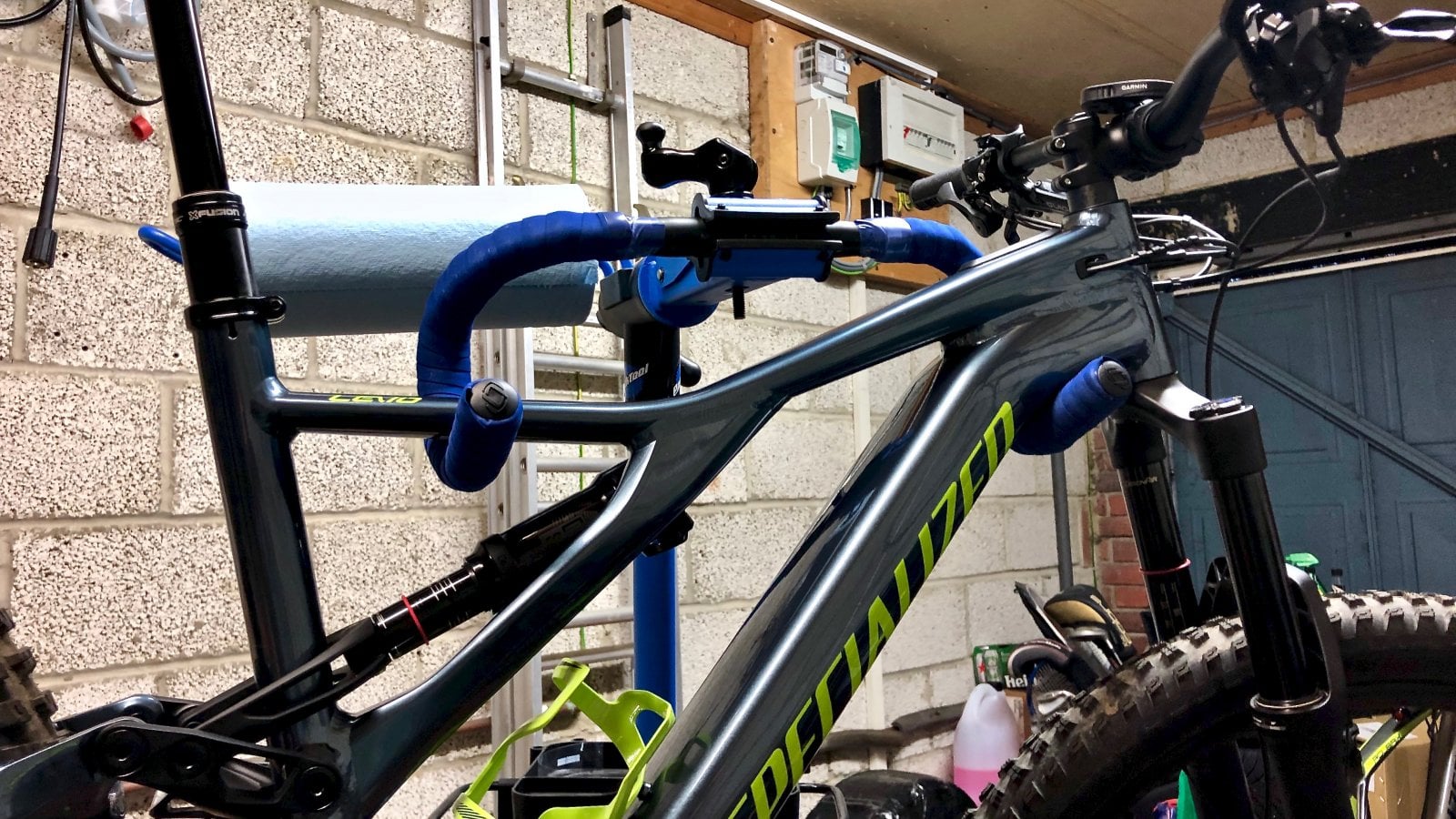

In the meantime, for a work stand, I'm have taken an old set of road bike bars and clamped them into my Park Tool PCS-10, seems to be stable enough.
