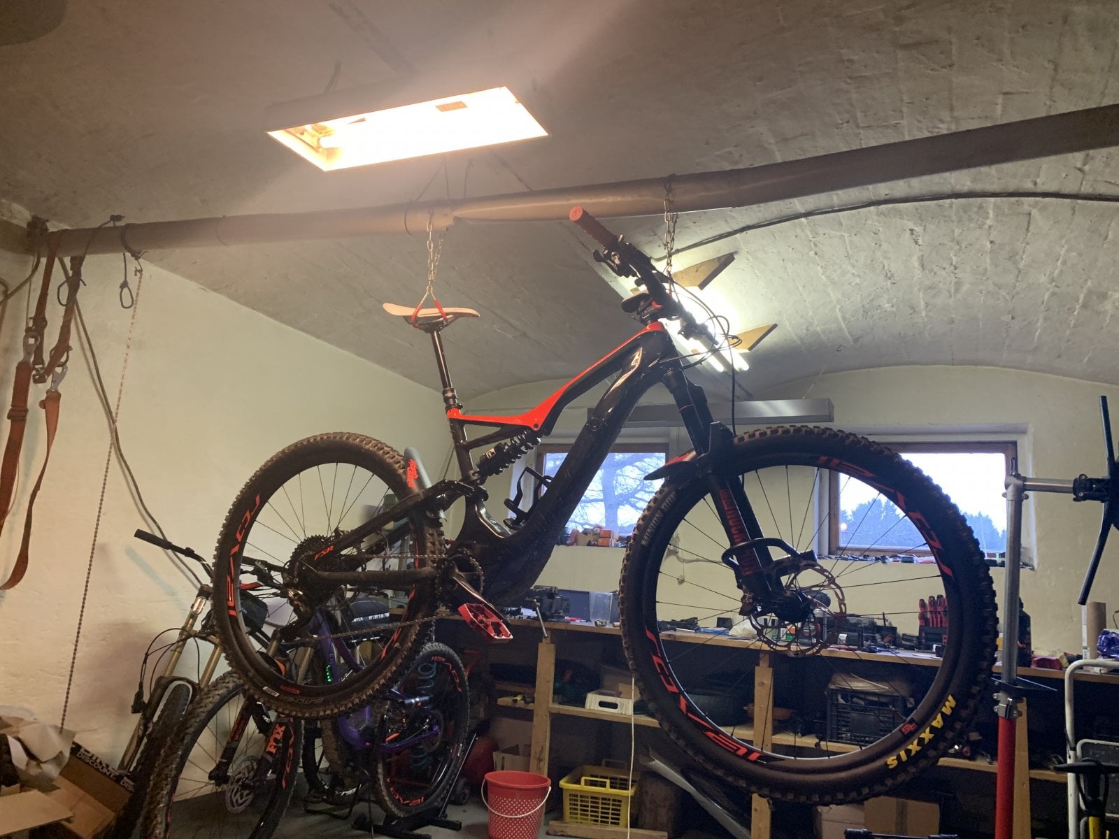

I simply have a water pipe running through my boiler room where I attached 2 cheap bike hooks(5€). They can easily hold an heavy EMTB an lifting it up is no big deal with 2 hands, hook the seat first and then attach the other end with 2 hands. You can also buy a more expensive version that you can attach to the ceiling if that is strong enough.

False crossbar. That's the best idea I've seen. Thank you. Although it does say 15kg max. weight? My bike comes in at 24.4 kg, a little less with the battery removed, but still in excess of 20kg I would have thought.

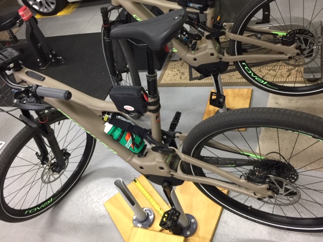

I know the conversation is around work stands but what stands are you guys using as just general storage at home?
I had the same problem Stringbean, always trying to get the bikes out of the way or place them so they would not fall over. I have a sturdy Park stand for chain servicing but many tasks such as adjusting bars/brakes/shifters, saddles, fork or simply airing up the tires do not require strong-arming it up onto the Park stand. A piece of plywood, PVC 80 schedule flange, 14" section of 1.5" diameter 40 schedule PVC electrical conduit & some bolts make for a sturdy bike support. It actually pinches onto the Praxis crankarm and makes relocating the bike easy. This is just a simple version of a known support system but works well for us.
