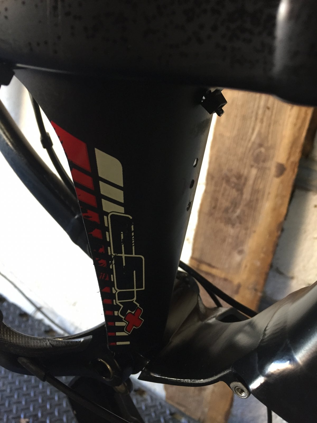

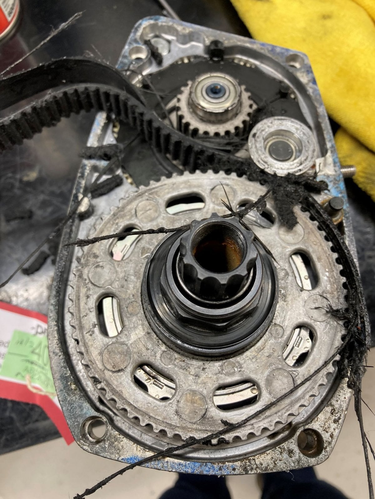

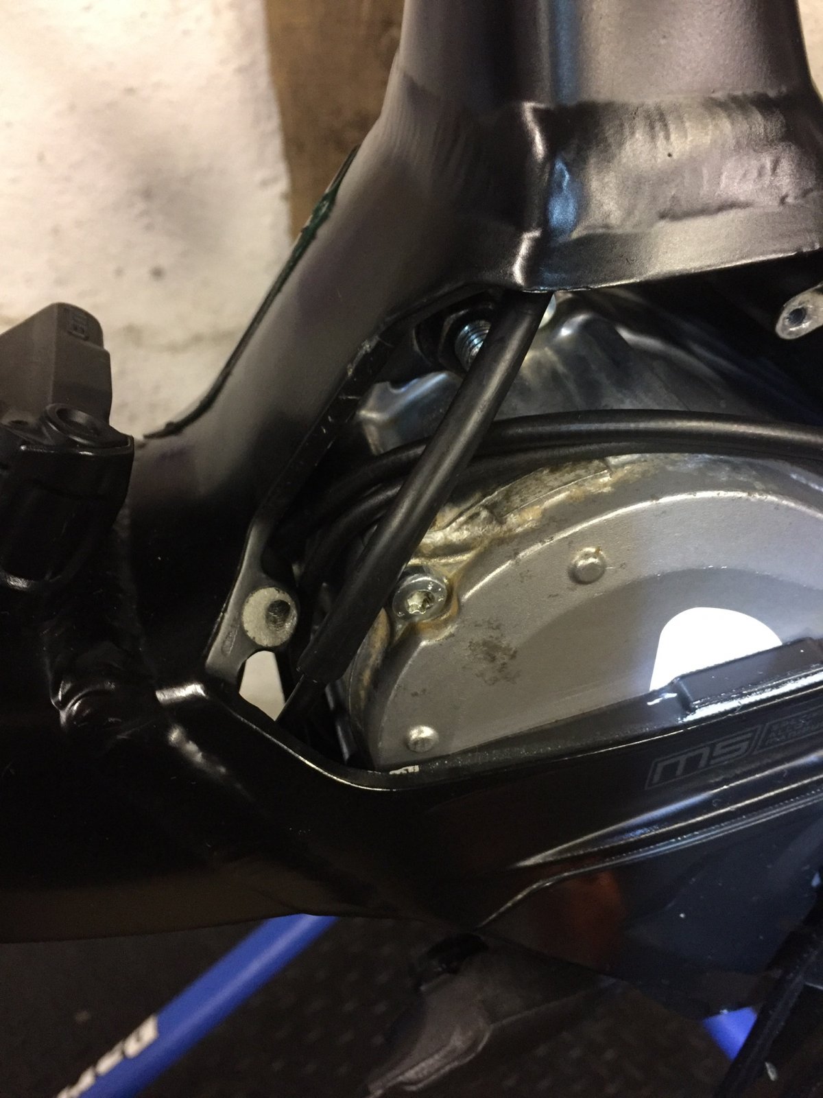

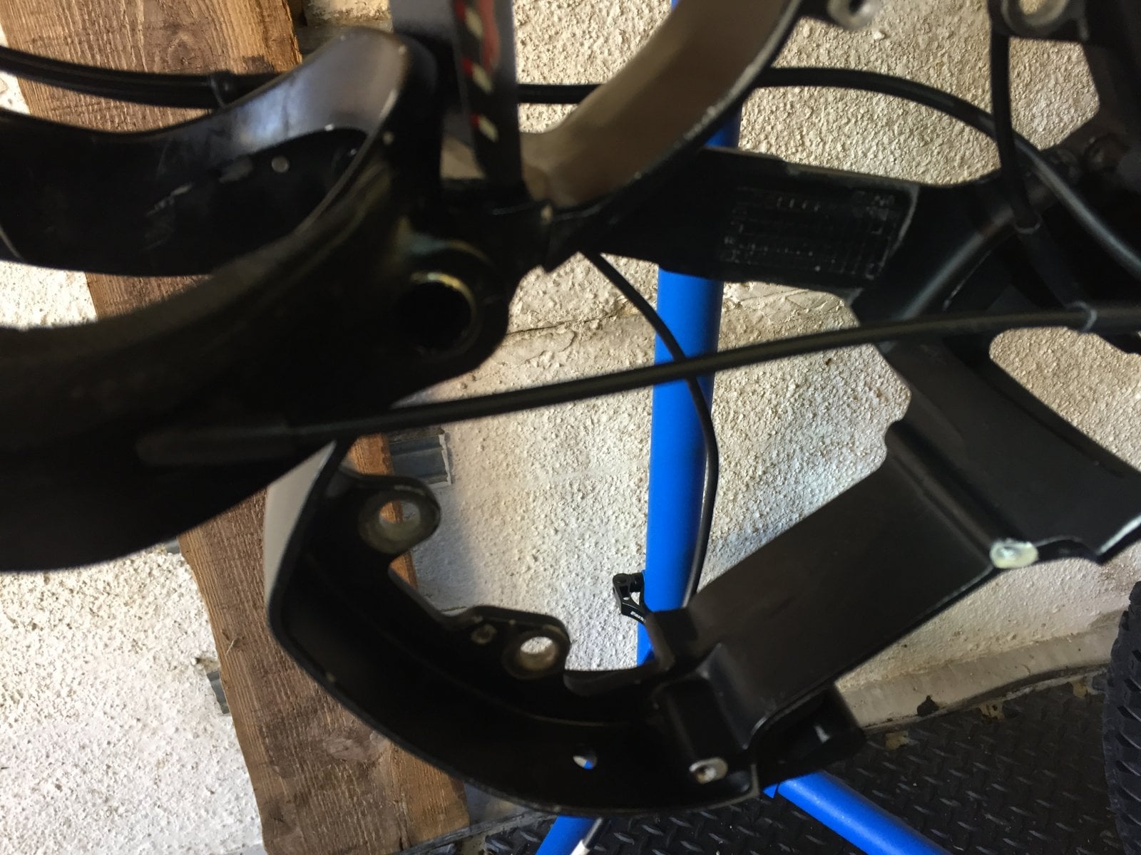

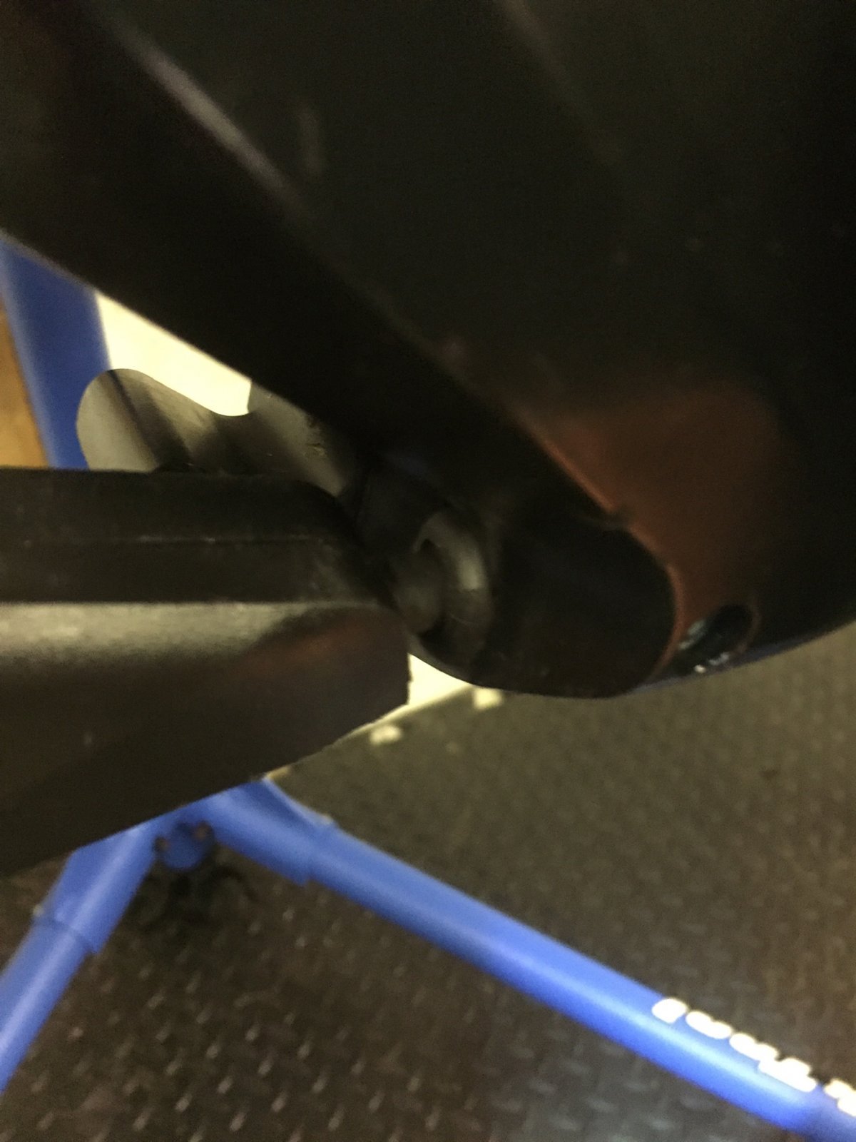

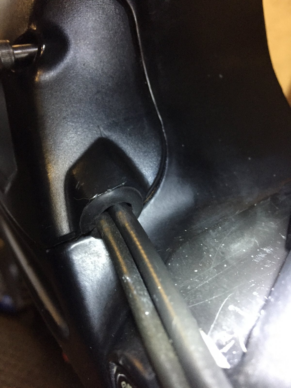

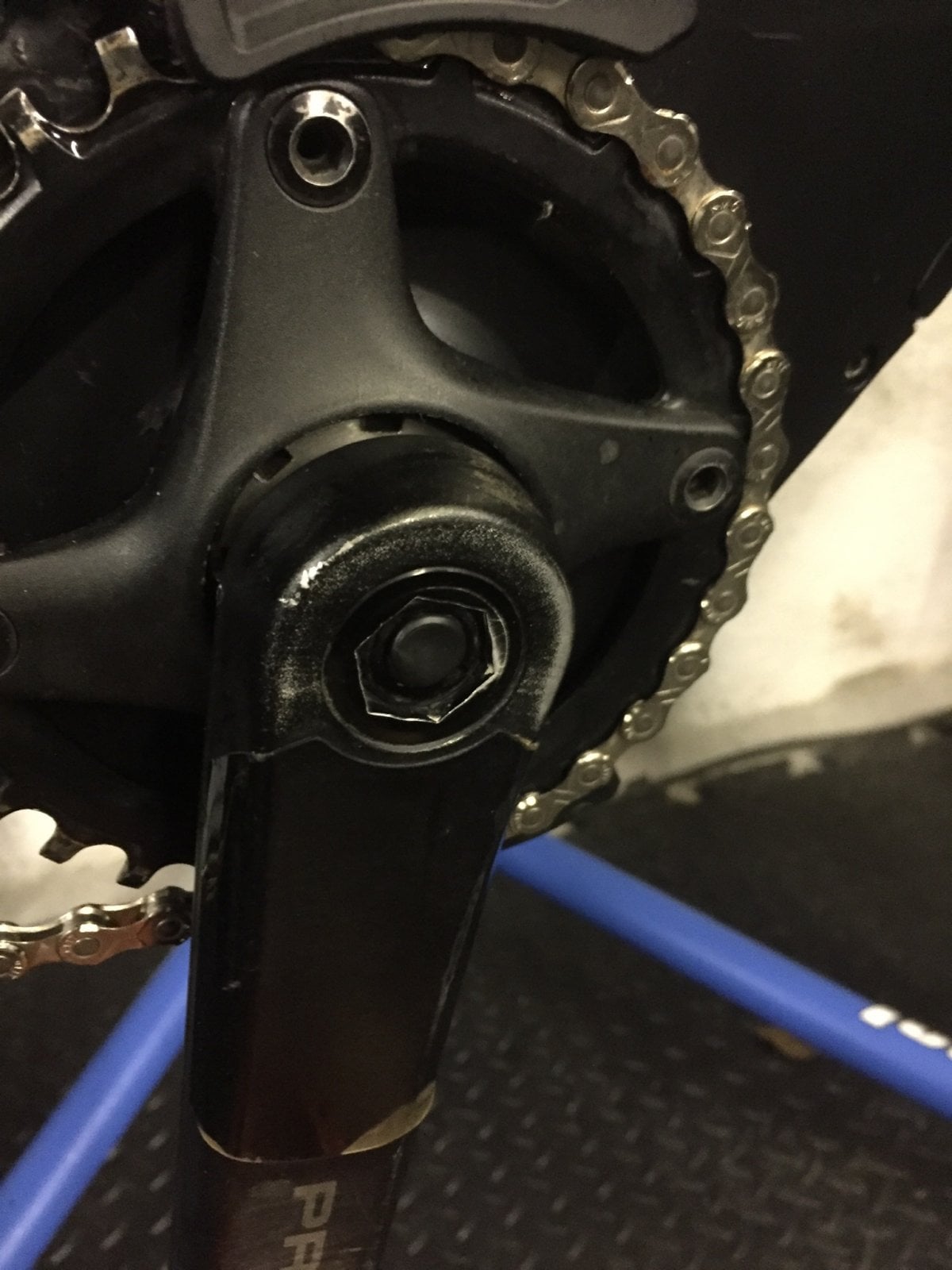

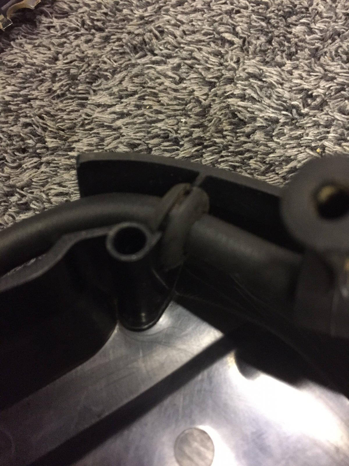

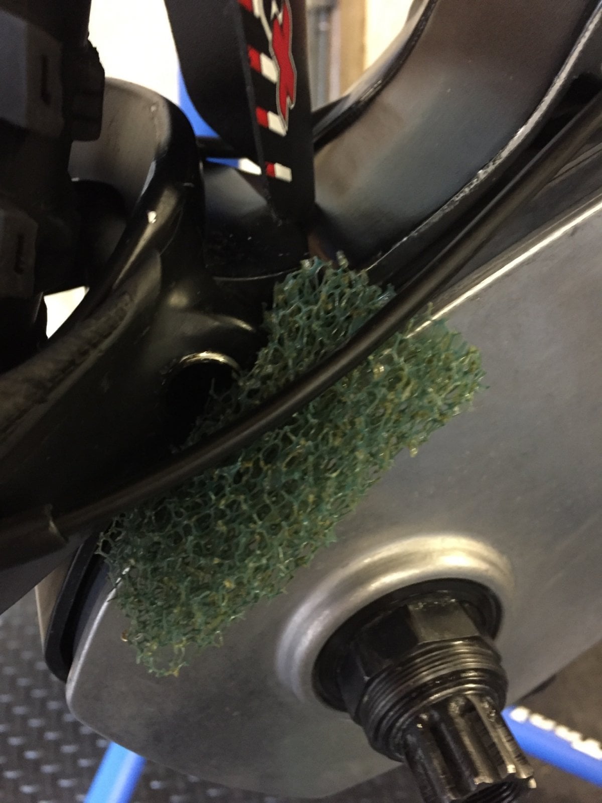

Just received my Brose motor back from being upgraded by Performance.
It failed due to belt disintegration and though Chris at Berkshire offered me a new motor at a greatly reduced cost after a chat with him and Peter at Performance I decided to upgrade.
I received the motor back today after a week turnaround.It had needed a couple of extra bearings as well as the upgrade at a cost of £273 including Post.
Whilst the motor was out I cleaned everything up and installed a new gear cable and dropper post cable with some extra protection over the outer cable where they had rubbed badly,Ialso took Chris’s advice and rerouted the gear cable over the top of the motor.
Although the motor is pretty well sealed now that Performance have worked their magic I have tried to add a little bit more to the covers.
Grommets where the charge lead enters and where the speed sensor n rear brake hose enter.Also the use of sump guard foam to seal the gap at the rear where the gear cable runs from the swing arm into the right side cover.Rubber bungs into the pedal arm allen bolts to stop water travelling along the inside of motor crank,after a squirt of ACF 50.I’ve also improved the rear mudguard to hopefully keep more mud off the back of the motor.I will keep an eye on motor temperature and will probably remove left side covers for an inspection periodically,easy job.
On the test ride it felt quicker.Long ride planned for tomorrow.Will feed back.
It’s a pleasure to deal with both Chris and Peter,and hopefully my motor has been future proofed.
Hope the pics make sense.
