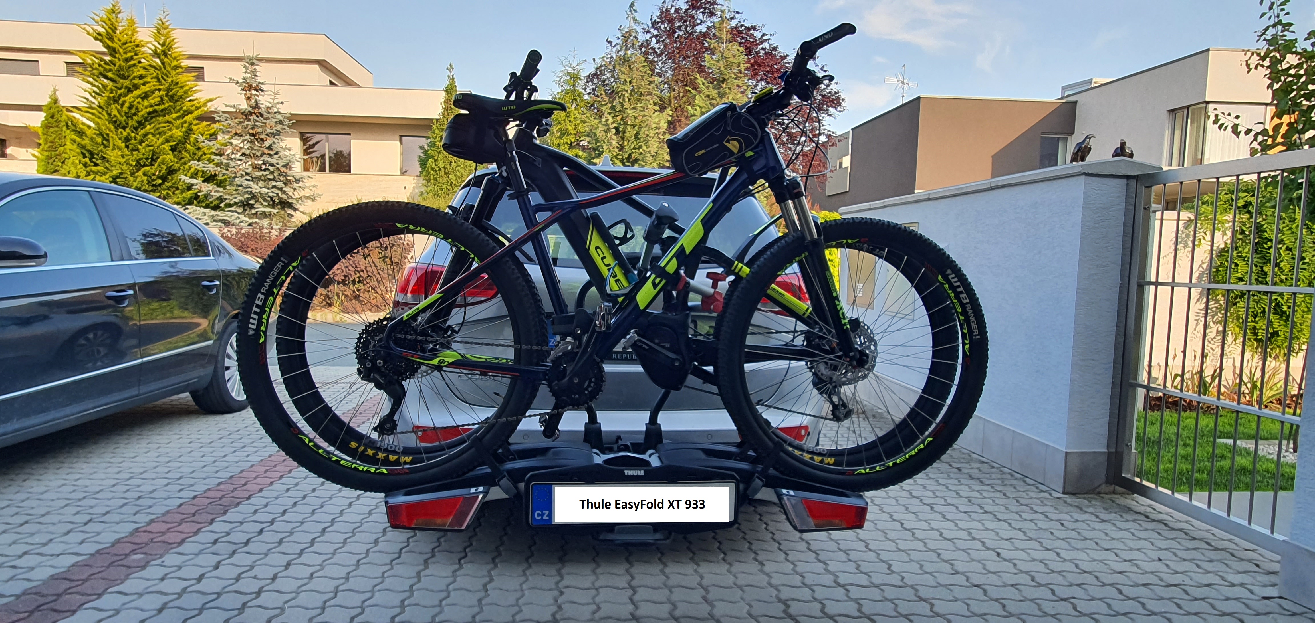

I have the velospace3+1, the easyfold xt2 and the easyfold xt3. The easyfold xt is a joy to use and even though it is slightly smaller it handles 3 big ebikes way better than the velospace, and it's way easier to store in the trunk when not in use. 3 ebikes without battery, remember that all thule racks have a max load of 60kg. The two is fantasticly compact and can easily handle two bikes without battery. For all of them I ditched the useless arms with a clam and replaced them with these: https://amzn.eu/d/fKwtOs3
Way more secure and easy to use.

I've had a Thule EasyFold for years and with my bikes it works quite well. However, if I were to buy a bike rack for the hook now, it would probably be the Thule Epos or the half-priced Spinder TX2. Both foldable (like EasyFold), definitely a better way to lock the bikes.
