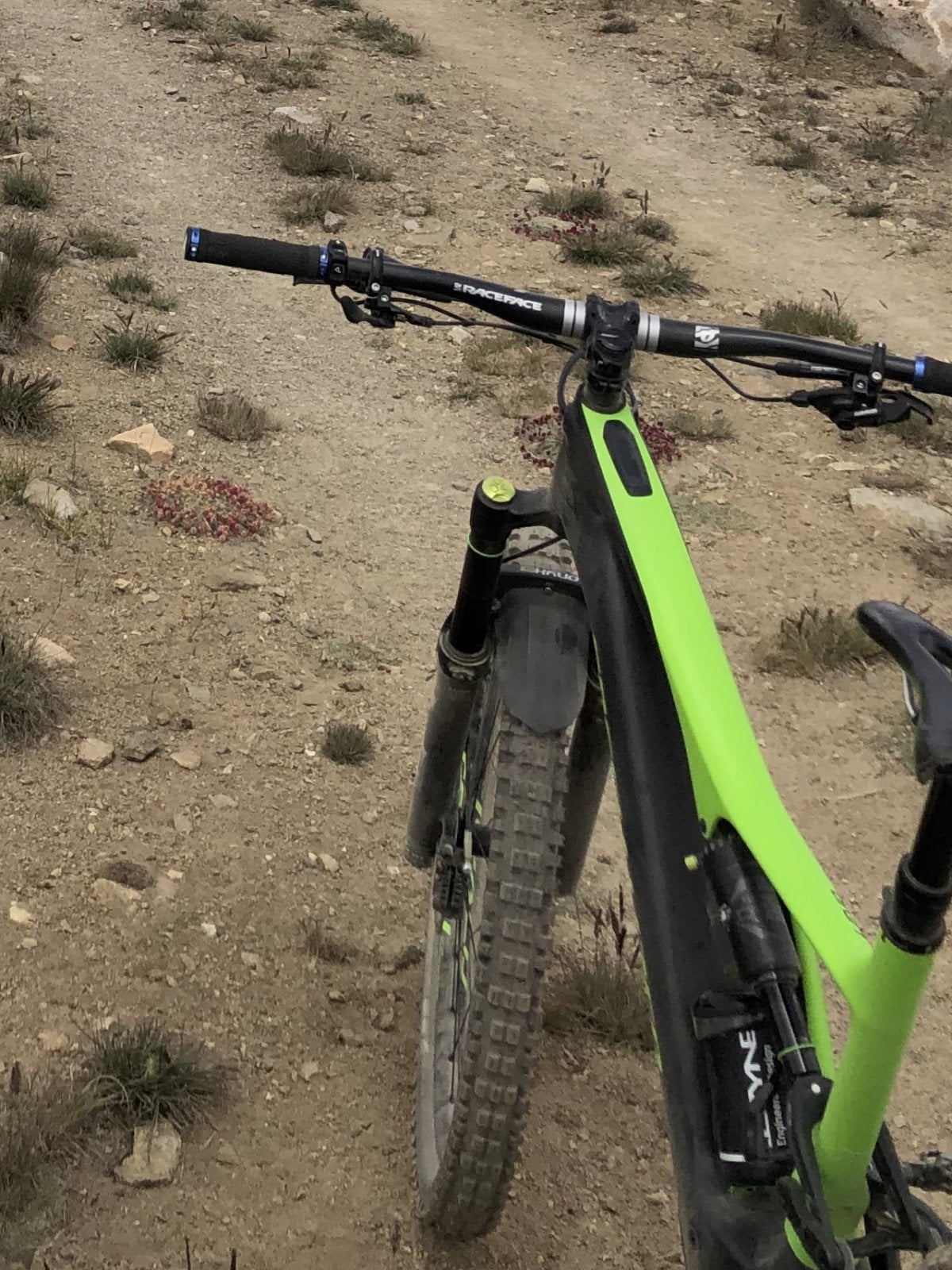

I upgraded to the E-Bike specific DVO Onyx SC E1. Wow, totally different bike. I also have the DVO Topaz T-3. I use it for everything. Kills it at Mammoth Mountain bike park and does just as well on any cruising trail.

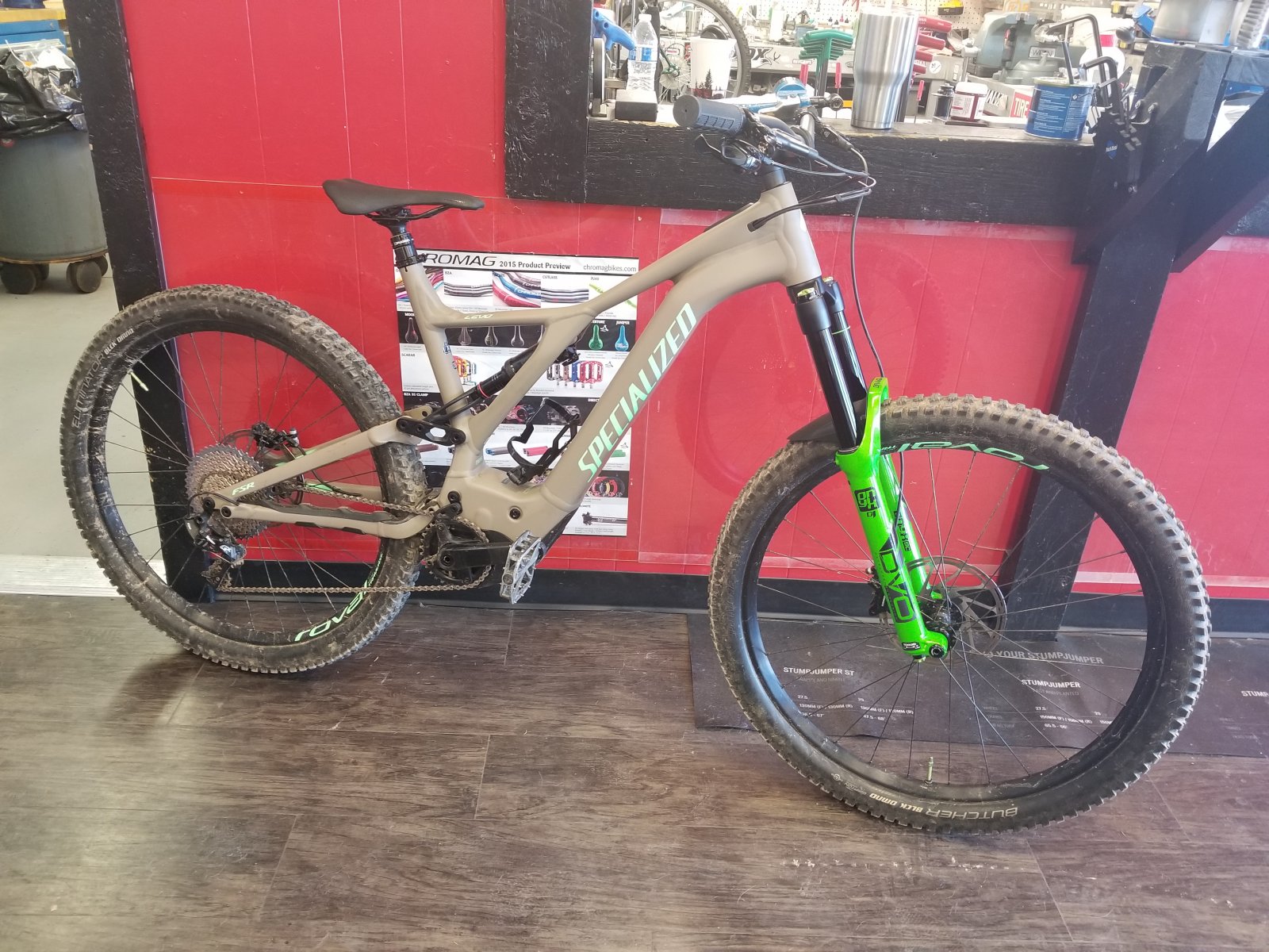

I still love this fork, Its beefy for a big guy like my but handles the down hill stuff like a champ. This is the only picture I have right now. I put something else up later.
Thanks , sounds like contender
I have the same bike/colour scheme
Hurry up already with those pictures ? I need to see how bling or it looks in the bike ?
