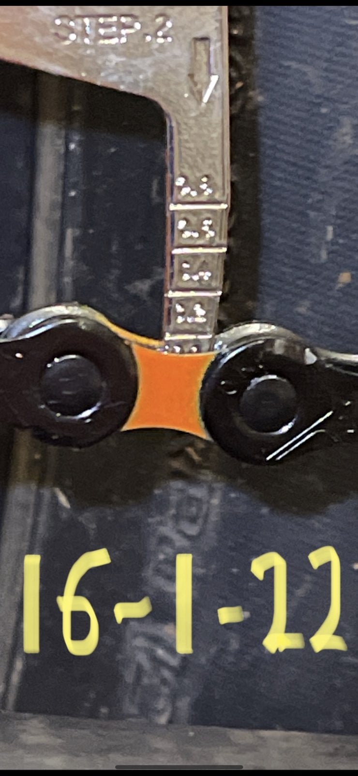

Approximately 250 miles per month.
Zaskar20
Aug 17, 2021
140
133
3 Months wear with approx 750 miles!
When do I change?

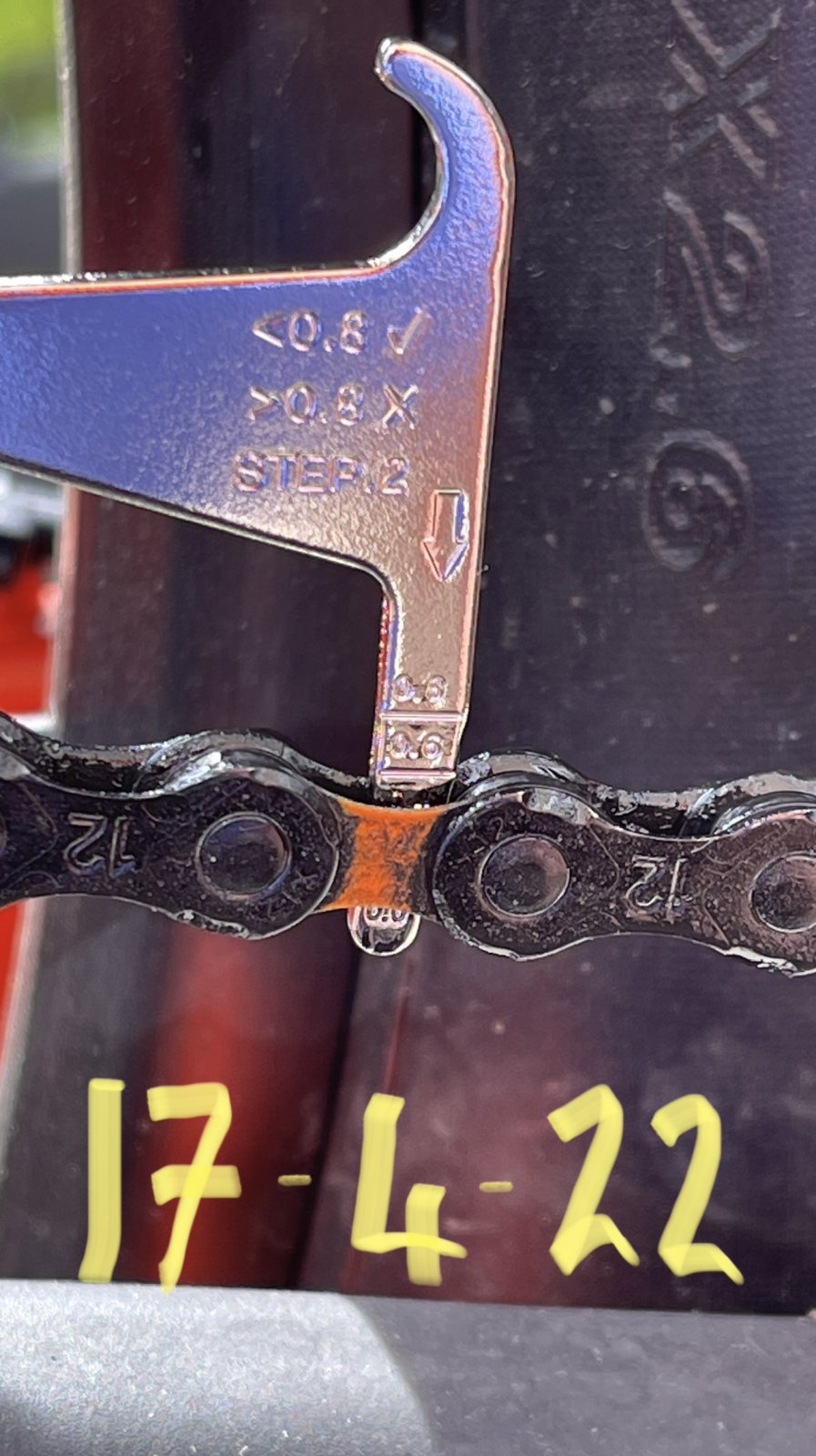

So, itā€™s been 4 months with this KMC DLC chain and I have been impressed. Shifting has been exemplary and, as you can see from the 1st photo above, the plates are still like new!
I have ridden the best part of 900 miles in those 4 months. The rollers have worn to 0.6.
Itā€™s now time to change.

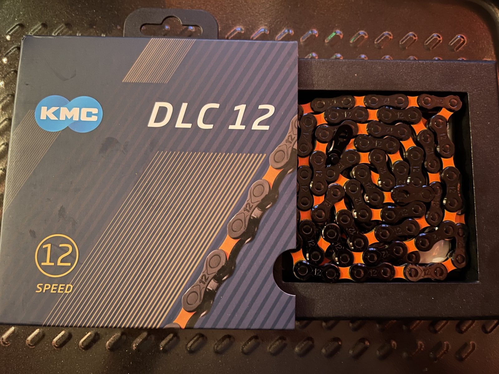

Well Iā€™ve opted for an expensive chain ā€œDiamond Like Coatingā€
I canā€™t lie, I liked the bling aspect as well as the hardness and durability claims.
Letā€™s see how long it lasts.
Anyone had any experience of this chain?
