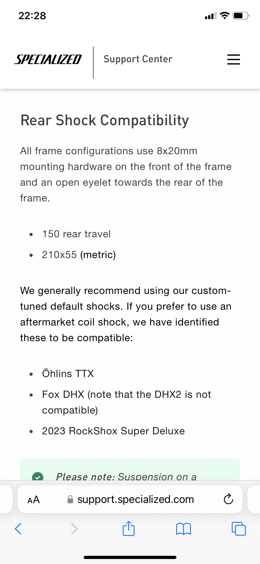

Is the RS now officially compatible? I recently checked the market for coil shocks and there was an official statement from Rockshox recommending against installing on a TL... There was a discusison in this forum too.
They had a specific part number to use with the Levo and Kenevo, it has a steel shaft. They’ve recently come back and said that the normal shock is compatible with the levo and you no longer need the one with the steel shaft.
From RS website:
2023 Super Deluxe Coil and Deluxe Coil rear shocks were designed from the ground up, in part due to the additional stress yoke/strut designs can put on coil shocks. As such, we have qualified 2023 coil rear shocks for use in these applications. There are 2 known bike model exceptions to this: Commencal Meta TR Power and Specialized Kenevo. These two bike models are only compatible with a Super Deluxe Air shock OR a MY23 Super Deluxe Coil shock WITH a steel shaft.
From RS website:
But this means, you dont need the version with the steel shaft for the Levo.

Got answer from Sram Rider Support with the same Text:
Hi Henrik, thank you for reaching out. I hope you had an excellent week!
