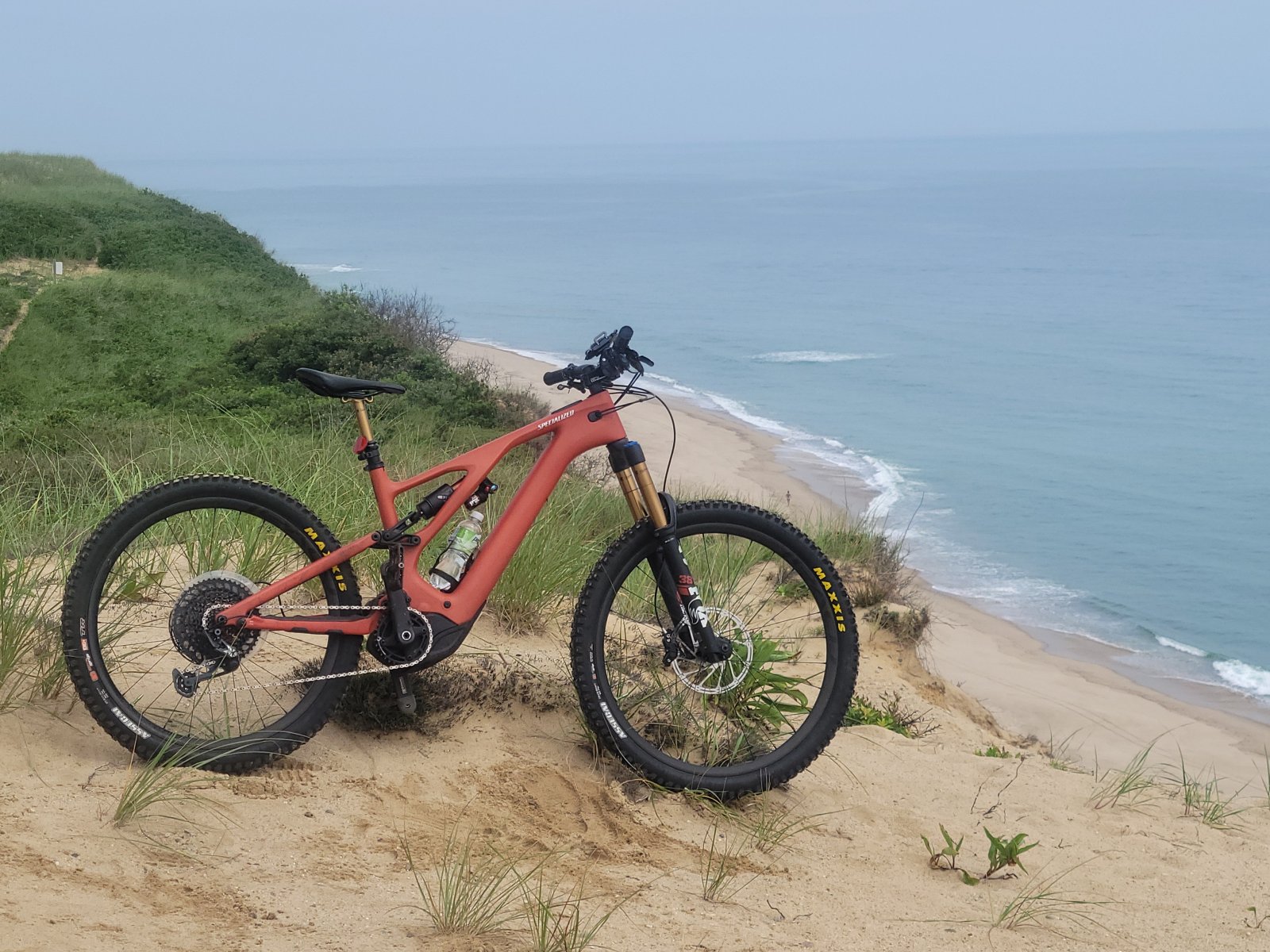

Brand new sub 800 miles Pro model belt failed yesterday, this is about 3 times more miles than my 2019 S Works, which lost 4 FOUR motors is less than 1000 miles thats 250 miles per motor. Let's calculate.....
The new belt is 300 % stronger good for maybe a thousand miles and it was ONLY $13,000 USD. It's the best riding ebike, I've ever ridden... for 600 miles!
Warmly Disappointed
Ruti

Hello Zimm
Yes back to shop for motor replacement. I've had 5 Brose motor failures now and the symptoms are exactly the same. It feels like the belt is skipping across the splines, like going across corduroy. I assume it's the belt but we're unable to see inside to verify. I will at same point open the motor myself to look. Massachusetts Has a very toothy implied warranty law along with a law called 93A a consumer protection law that provides triple damages for failing to make a reasonable offer within 30 days. My guess is that voiding the warranty for opening the motor is not legal, and that the reasoning is partially to prevent consumers from verifying the failure. What's abundantly clear is that gear drives are far more dependable that belt drives, quite yes, smooth yes, dependable no.
This is a case of being less expensive to replace some percentage motors and issue some smaller percentage of refunds, than abandoning Brose's drive which Specialized finds itself "in for a penny, in for a pound".
I think Specialized Is the best bike manufacturer in the world and they stand behind what they sell, which is why I bought another, but also why I have spare e-bikes I'm riding the Rail 9.8 now. I've hade three broken bikes at one time good thing I've got 4.
At 66 I have more money than years left to ride so I've just gotten over the fact they break and keep spares.
I'm in Provincetown Cape Cod (Covid is over played) the riding is fantastic and I'm just about to go riding, "life is good, don't die"
Warm Regards Ruti
