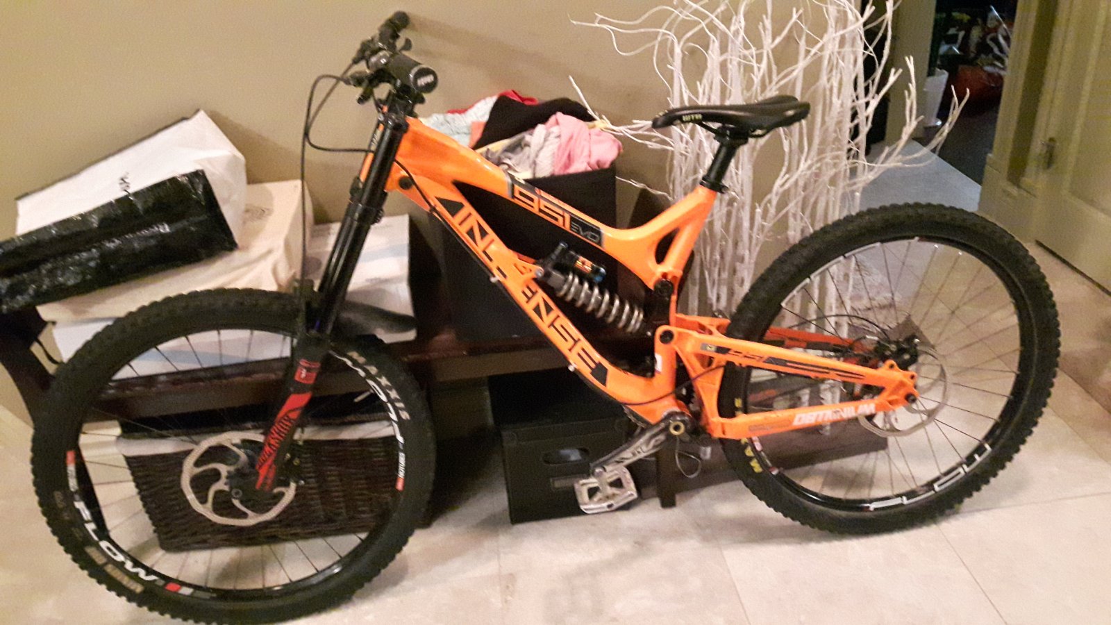

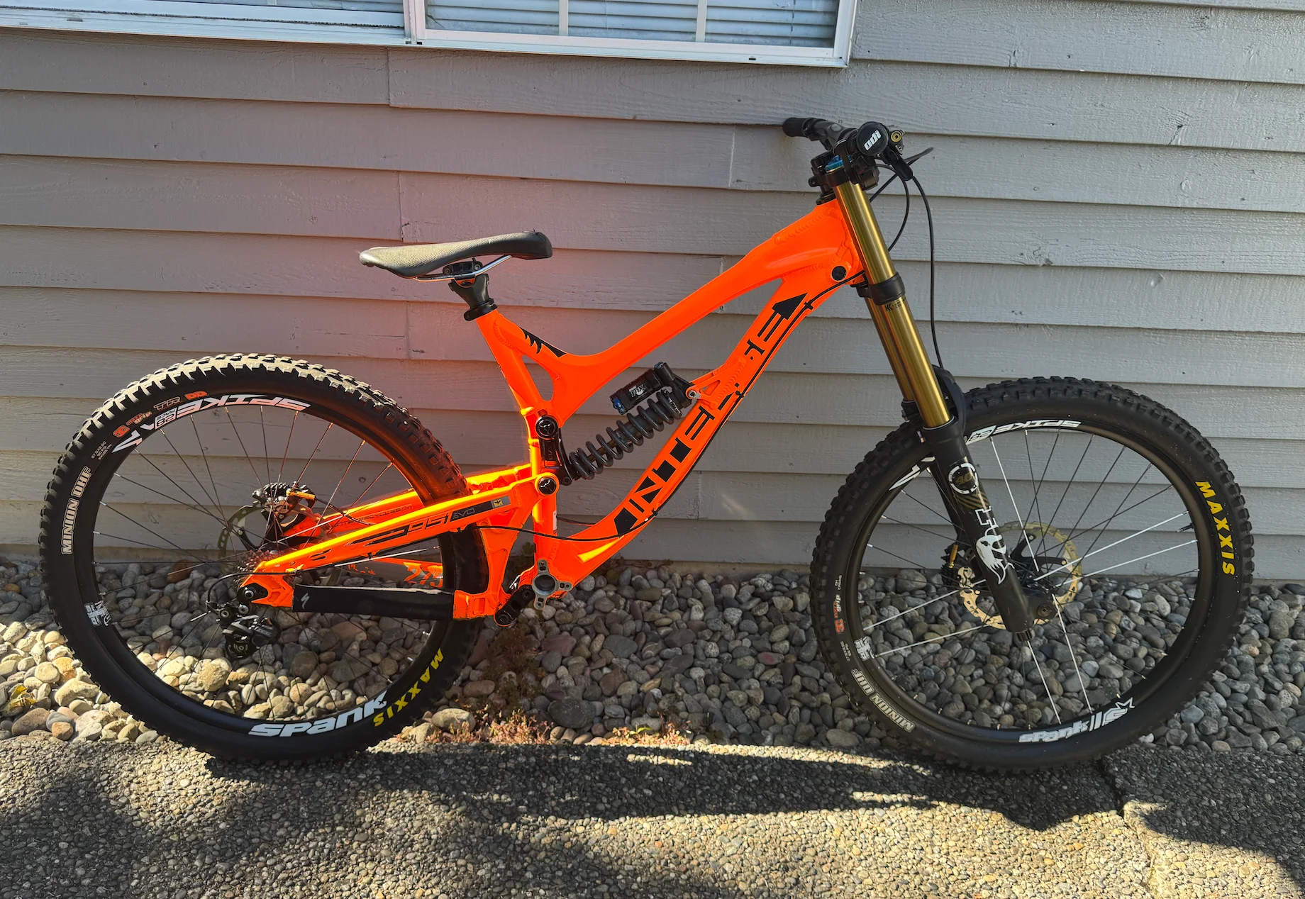

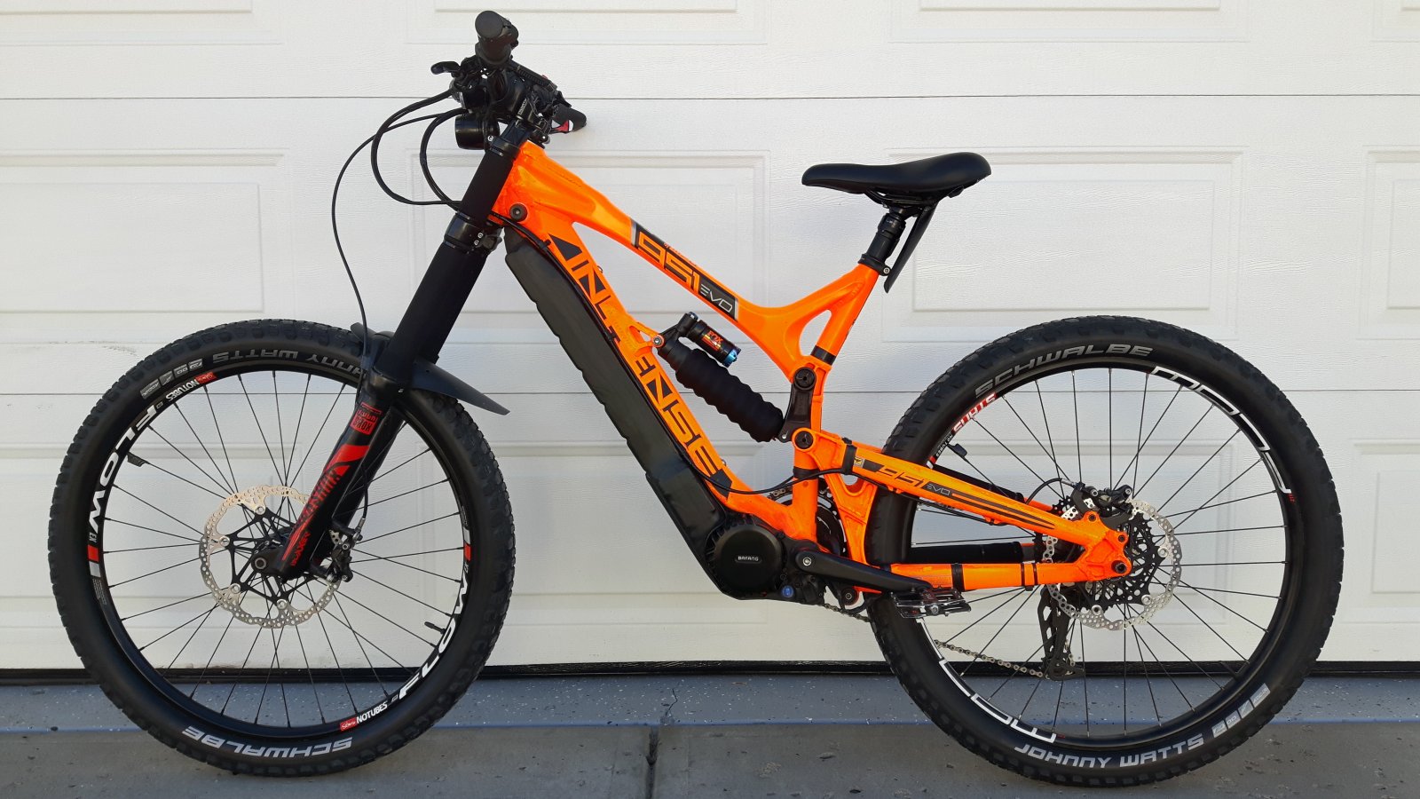

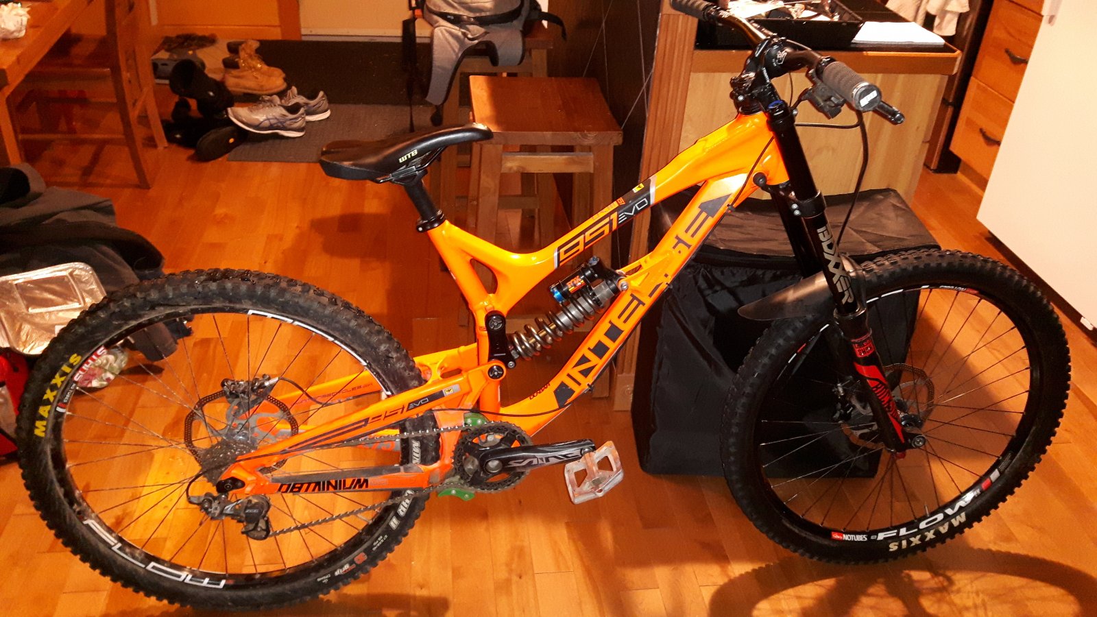

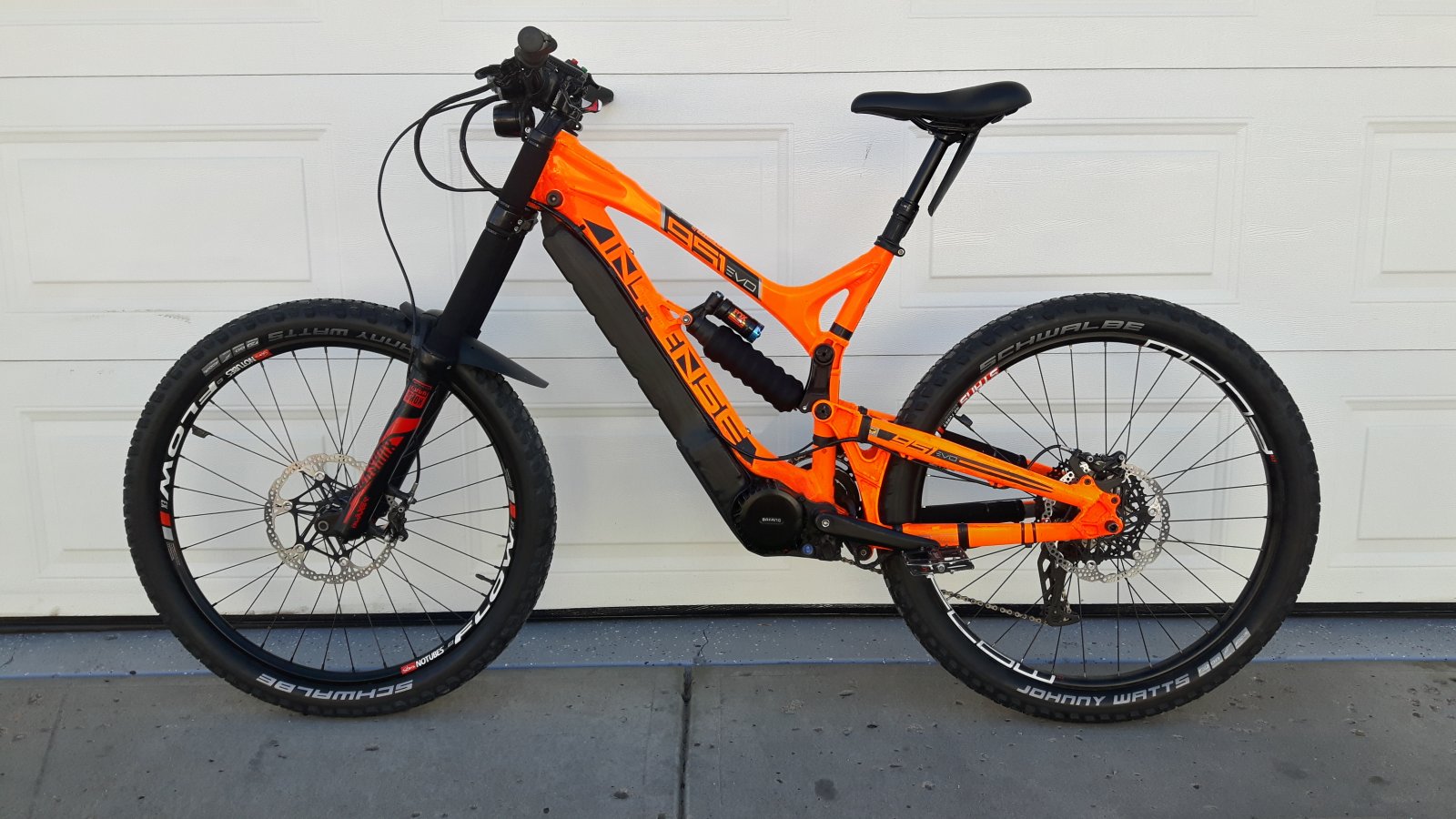

I have to say that for me it looks better than the official Intense offering, congratulations on a very well executed build.
intense makes this...... not a fan of the "bulbus " battery...... also , half the capacity , 3x less power, and not even close the the same GC and suspension travel.
This is mint. Surprisingly "light weight" given the specs. I was expecting 30kg++++
Can you crank it up to a full 40a on the controller?
controller is set to 26A, as i always run below the max 30A rating to increase reliability.

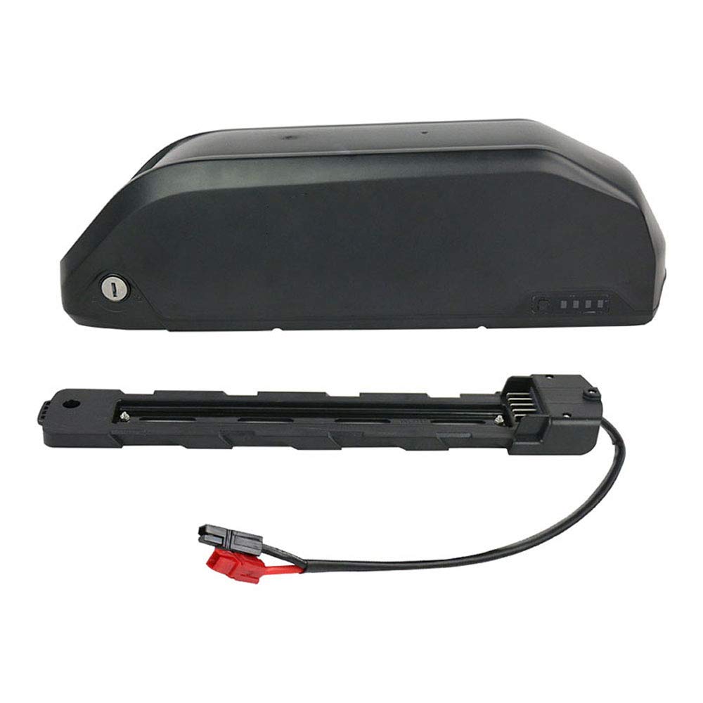

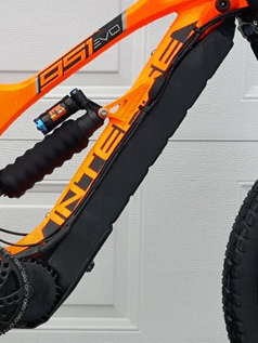

If I was you I would concentrate on the battery/enclosure as it is to me the most innovative part of that bike and would be relatively easy to fit to other like models rather than the Hailong style ones and way more stylish. I'd be your first customer!
i assume u mean this type of battery?
ive made abunch of bike with that style of battery. i actually really like it, its cheap, easy to use , and fits well on alot of bikes.

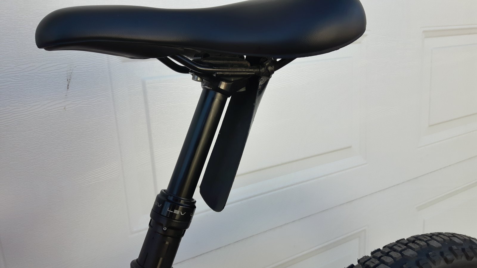

100mm dropper, I'm out.
100mm too much or too little? i assume its the fact there is a dropper on a DH bike lol?
Dave_h34
May 20, 2019
78
43
Warwick
100mm dropper is very little these days, but just a little joke that. What you've created is outstanding, it'd be brilliant from a manufacturer, as home build mind boggling good. ? Would love a go!!
michael.kozera
New Dad ! 👶
Feb 3, 2021
111
209
calgary
100mm is all i could fit.
100mm dropped has total length of 350mm and I had only 360mm to work with.
if i went to 125mm the smallest length I could find was 380mm. so bassically ,seat would be too high at that point.

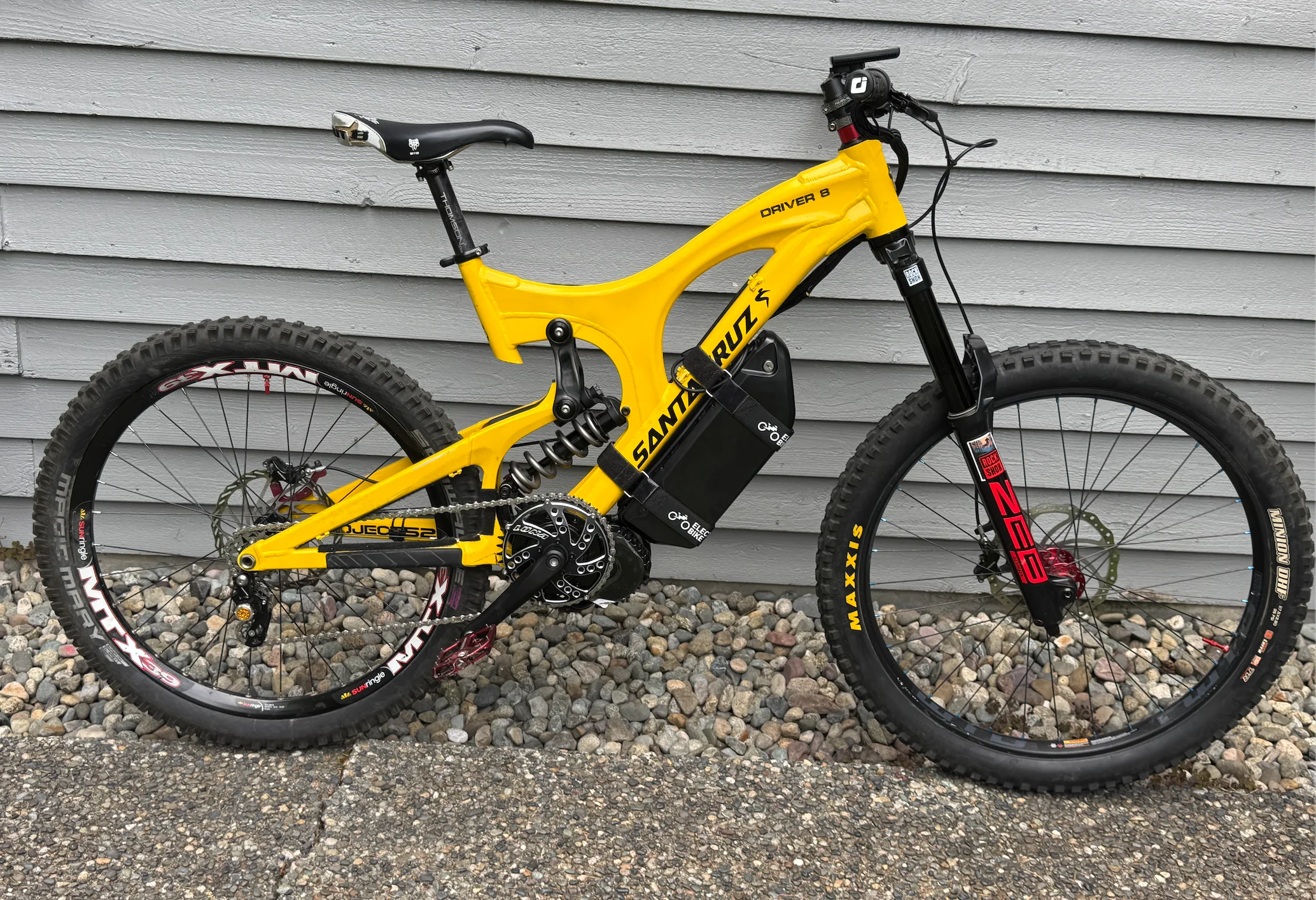

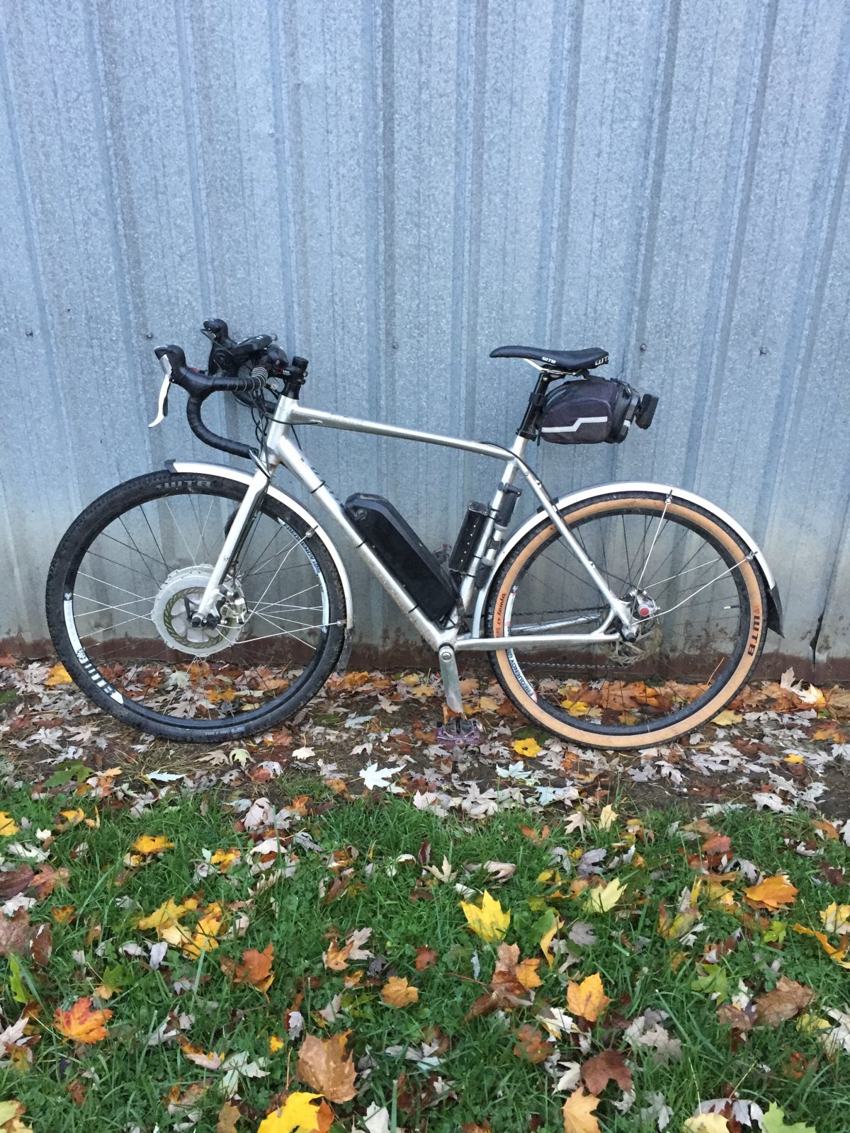

No, this type of battery
I've got 3 HL type 2170 batteries already in 12/15/18 but want to get rid of the bulbous look and think that placement and potential universal application of such a type as yours would be just what I need, On my FS bike I have to only use the bottom bolt so I can tilt the mount enough to get the battery, 12ah, out and use a strap to secure the front. Works but not at all optimal. (and as close as it looks the sus beam clears the battery)
For that bike and how and where I ride it locally a 12ah battery is sufficient for the two-three hr. under 25mile rides I do. That's about all the offroad I need for the day. For longer missions on logging roads I use a front hub drop bar bike and for that I want more reach and toggle between the 15/18ah ones but would still benefit from getting rid of the wart.
Not sure how you made your case because I'm no engineer and especially dumb about plastic things like 3D printing/moulding methods etc.. But am smart enough to seek out help from others that are I guess. My perfect experience at this point would be to get enclosures made that I could swap out the cells/BMS into from my existing batteries......

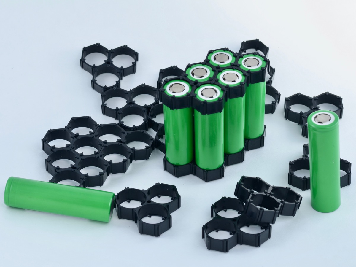

i dont remember the exact ones i used, but something like this:
once that was done, i then put several sheets of 2mm platic around em for protection, then finished it all off with a HD black shrink wrap over the entire pack.

1600wh is insane yes. but i mainly did it for battery pack life, not run time, but physical battery life.
the idea being that with 1600wh, each cell experienced half the wear/degradation as a 800wh pack, or 4 times less then 400wh pack.
but more importantly , it spreads the heat out amongst twice as many cells. so even with 1500w of power being pulled, each cell only pulls aprox 12w, which dramatically reduces heat build up. and heat is the #1 cause of cell degradation.
even when i climbed a mountain with this thing, averaging 1200w of power over 30 mins, the pack got to only 36C, impressive considering that my fathers bike which only drew 900w with a 800wh pack got to about 50c

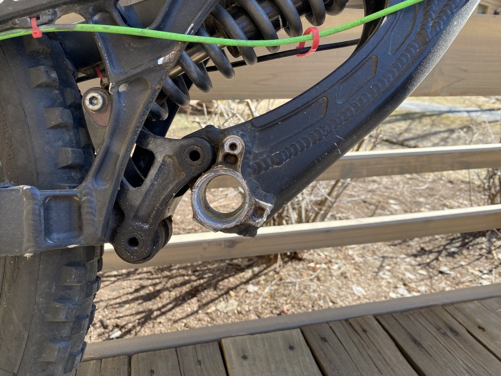

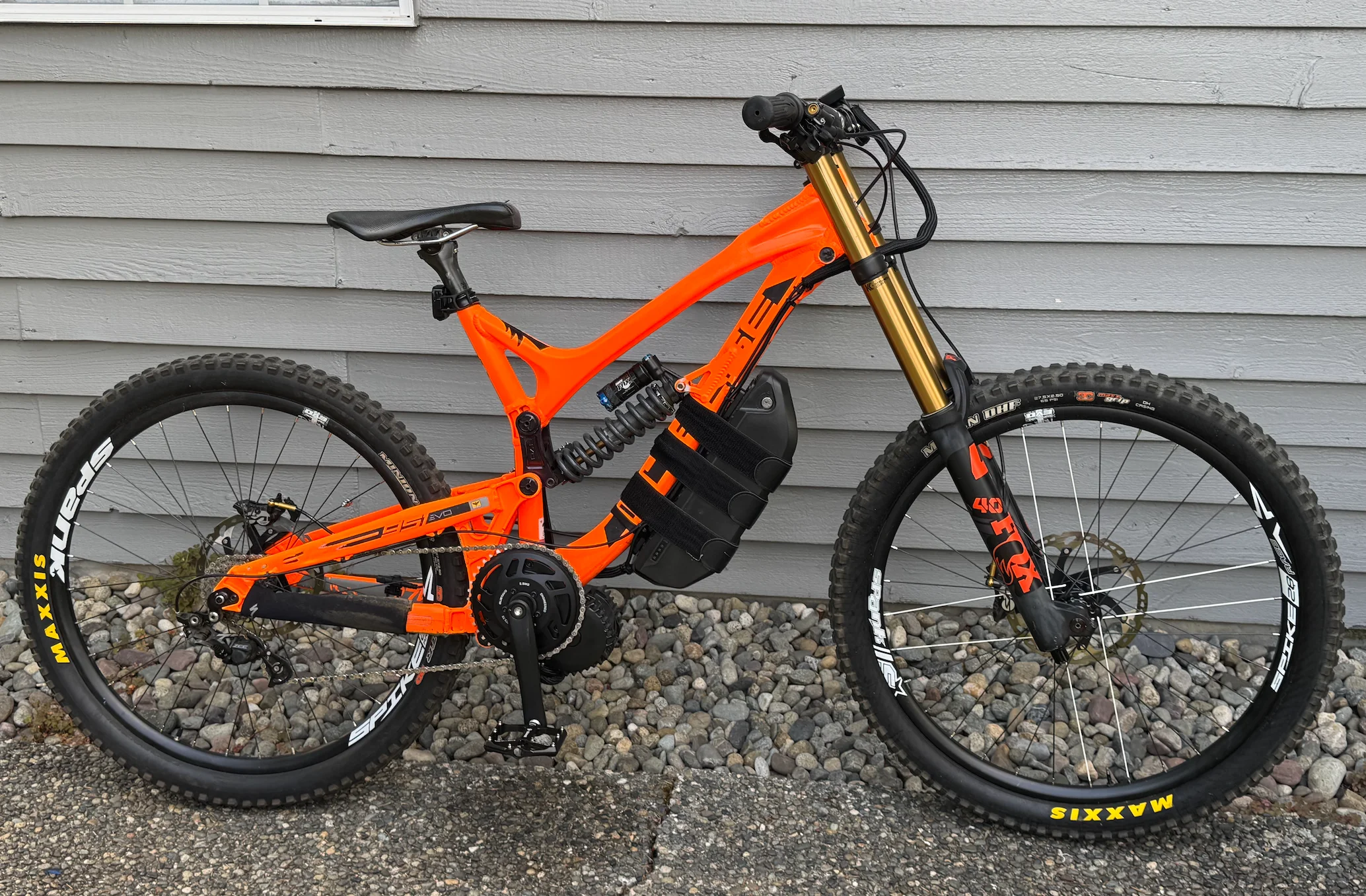

michael.kozera Your bike is amazing! I am putting a BBSHD onto an Intense M9 frame and it won't fit even with two chain guide tabs cut off, so I am about to try and do what you did to mount your motor. Without your post I probably would have moved onto a different frame, but with your inspiration I am about to start pounding away. Any advice, did you heat the aluminum or do anything to the frame before pounding and was there a best hammer shape or weight? I am a little apprehensive about ruining the frame. Thanks in advance image_50461953.JPG
michael.kozera
New Dad ! 👶
Feb 3, 2021
111
209
calgary

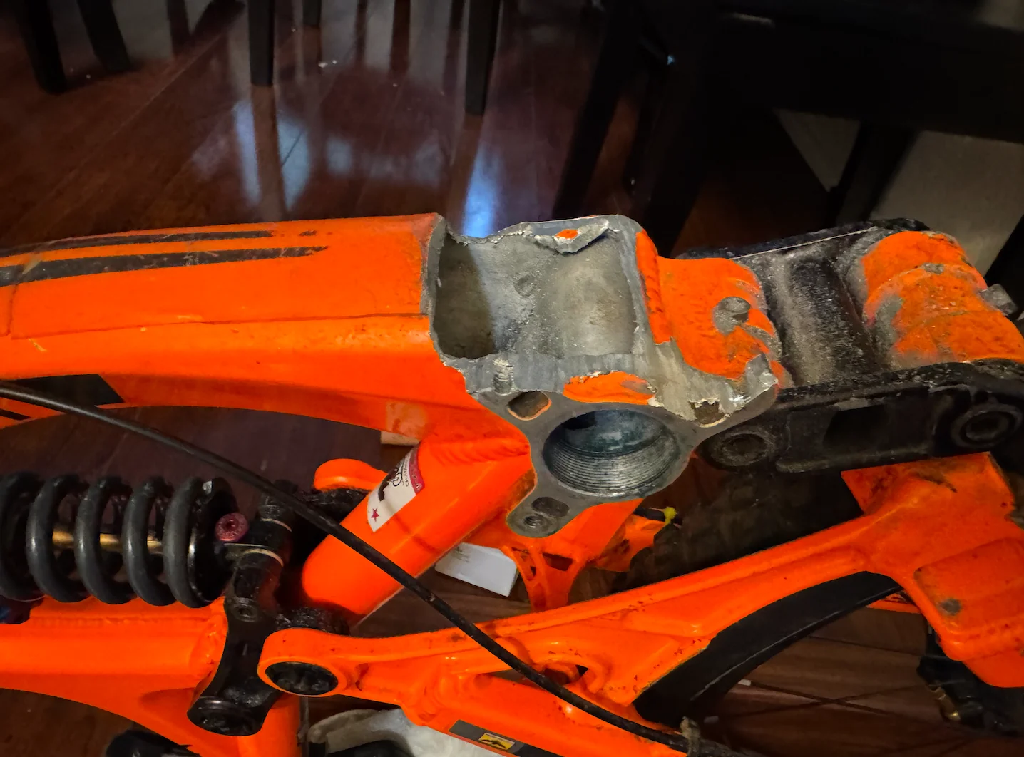

michael.kozera Your bike is amazing! I am putting a BBSHD onto an Intense M9 frame and it won't fit even with two chain guide tabs cut off, so I am about to try and do what you did to mount your motor. Without your post I probably would have moved onto a different frame, but with your inspiration I am about to start pounding away. Any advice, did you heat the aluminum or do anything to the frame before pounding and was there a best hammer shape or weight? I am a little apprehensive about ruining the frame. Thanks in advance View attachment 58013
not to discourage you. but the frame u have will require alot more then just bending/bashing the frame. it will require cutting and re-welding if you are to fit the motor up high without it "Uttering".
red circle is where the motor would go. and the 3 lines are where you would have to cut, and re-weld "reinforcement material". all doable by even a novice with general aluminum welding skills.
or, if you dont wanna weld. do this:
cut alone the yellow line, and bash/bend alone the purple line. motor will be hanging abit low, but it would not be uttering super low.

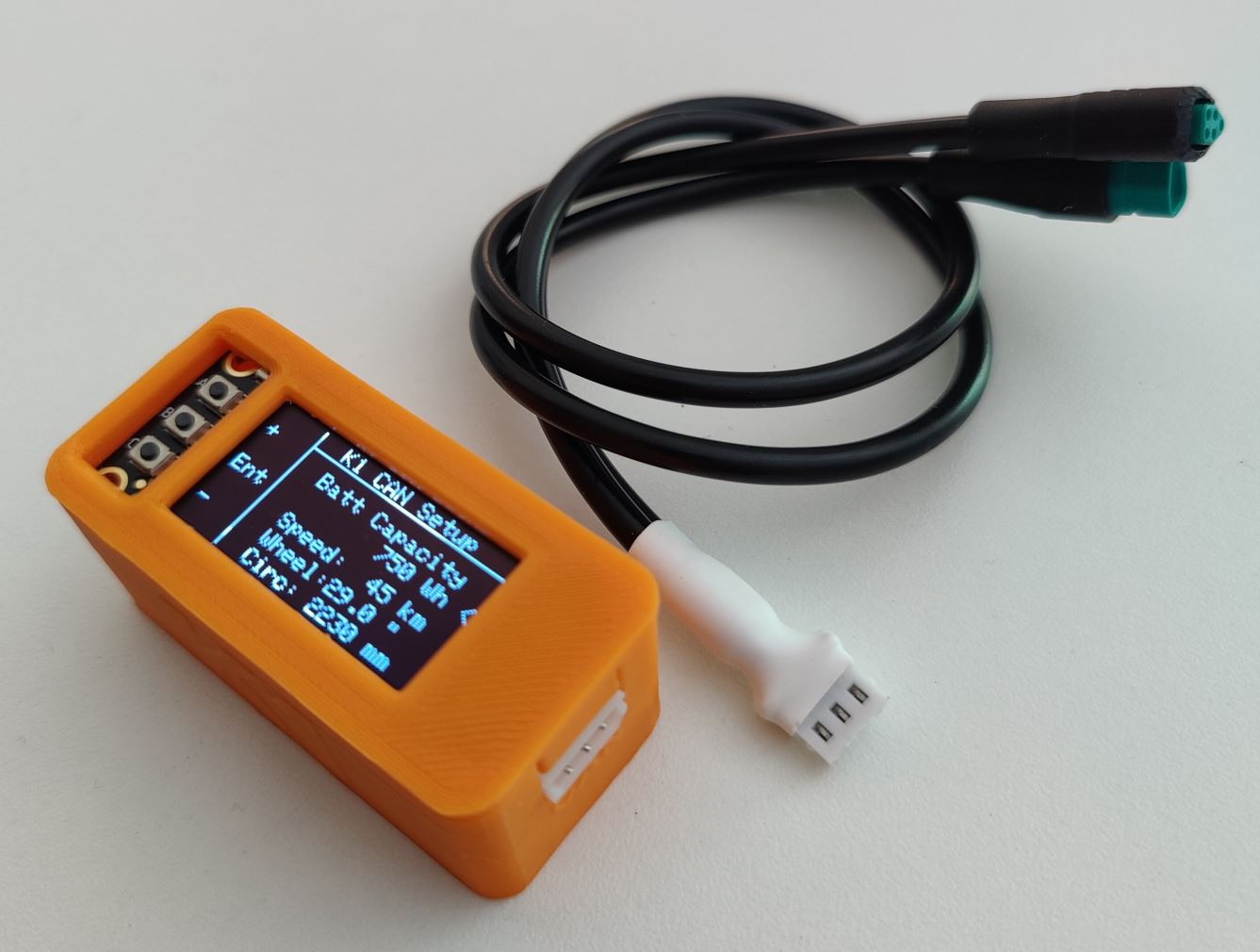

Hello ebikers.
K1 eBikes has designed small, portable and simple K1 CAN Monitor & Speed Unlocker - no need computer or mess with BESST. Works ONLY with Bafang motors with CAN bus (green connector to display with "house" shape 5 pin connector).
For more info check the following link:
https://endless-sphere.com/forums/viewtopic.php?f=31...
How to unlock speed:
https://youtu.be/6z3TzEqNWsQ
If you interested, send an email to [email protected], will answer any questions and will send user manual.
K1 CAN Monitor is determined for testing purpose only and is not waterproof.
