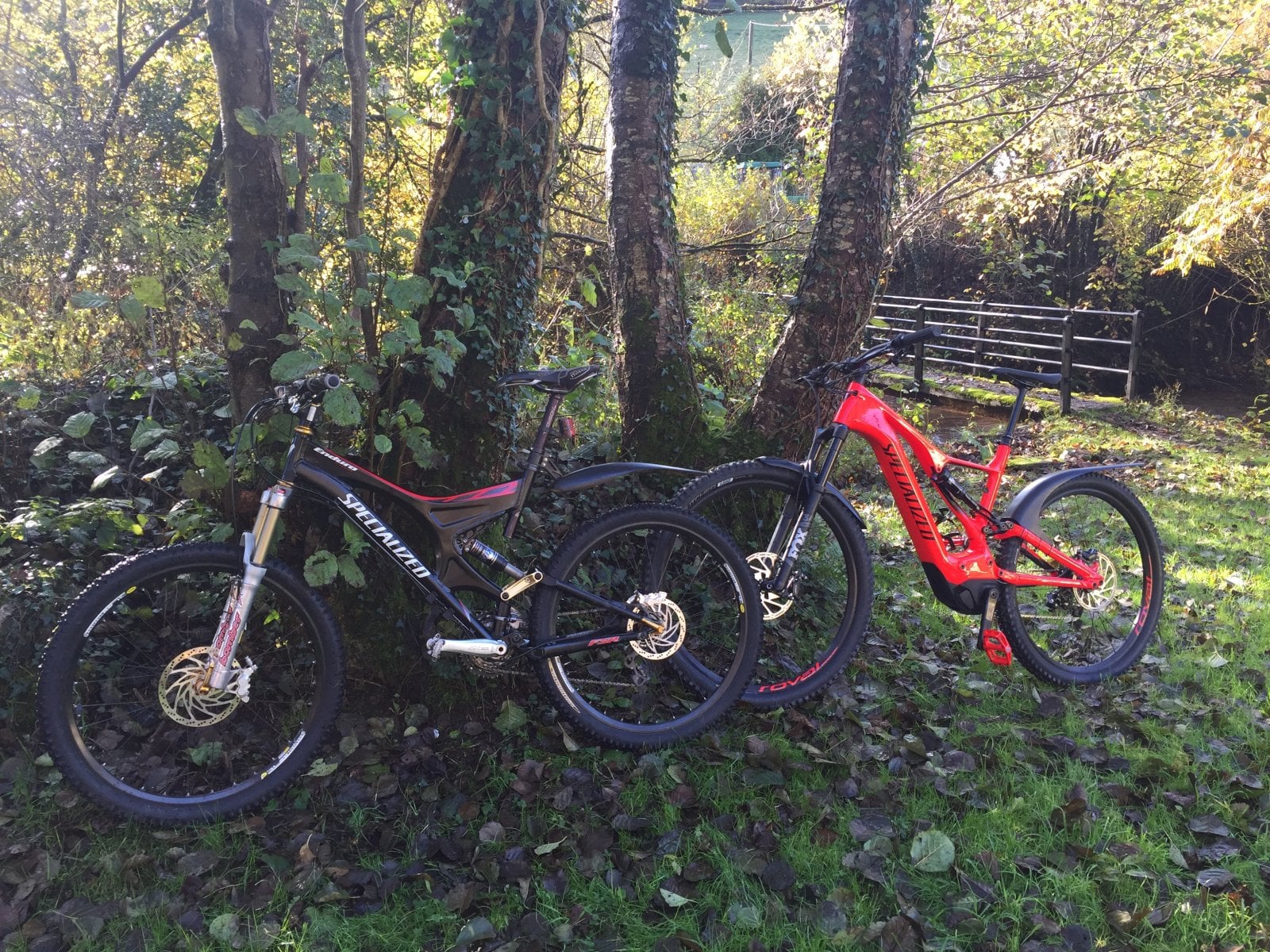

picked up my Levo yesterday and took it out today, its a 2019 carbon comp (500wh)
done 24 miles and 800m of climbing, used eco and trail only with a few road sections with the motor off.
the battery was completely gone when I got back. The beacons is quite rough though, lots of it was baby head long grass..
is this normal range? I was expecting more..
are my settings to blame?
all that aside, what an amazing bike ! I was still riding my old enduro until today but thats probably the last time it gets a turn of the wheel..
