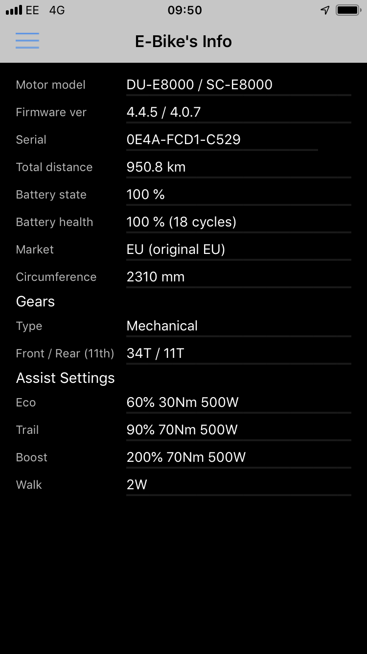

After 2 months of ownership. Mix of Surrey trails and a few bike parks - 70% trail and 30% eco. I’m averaging around 22 meters of ascending per KM.
Battery is stored at between 70% - 100%

From what i read Shimano and maybe others are not accurate. Thinking 2 lights out of 4 is 50 % is pure wishfull thinking. I think at about 70% is time to replace so you might not get that many recharges. Hopefully it last you many recharges and many years but in Quebec we are experimenting, too new to tell. Mine is a Yamaha 2017 500 Wh bought recently(it was an unsold) i have no clue how many recharges, 3,300 kms feels like new, many rides over 4 hrs, never empty.
Jamsxr
Mar 30, 2019
519
634
Mine seems fairly accurate, I’m getting circa 10km per bar for my riding - trail with a bit of eco.
I’m still to go out on a pure eco ride to get maximum range. I’m thinking I could get >70km with 1400 meters.

Had my merida e120 about 7 weeks, 12 cycles, approx 600km and health at 95%. My riding thus far has been a 50/50 mix on/off with around 500m of ascent and on average 27 miles a ride, approx 1-10km left on battery, 95%eco, 5% trail. Cadence usually 80+
Should I have lost 5% already??
50% with the motor off?
I don’t think you should have lost 5% in such a short amount of time, how do you store your battery - charge level and environment?
50% on road 50% off road, on bike every other day so it goes on charge after ride till I use it next. Charged and kept in house.
