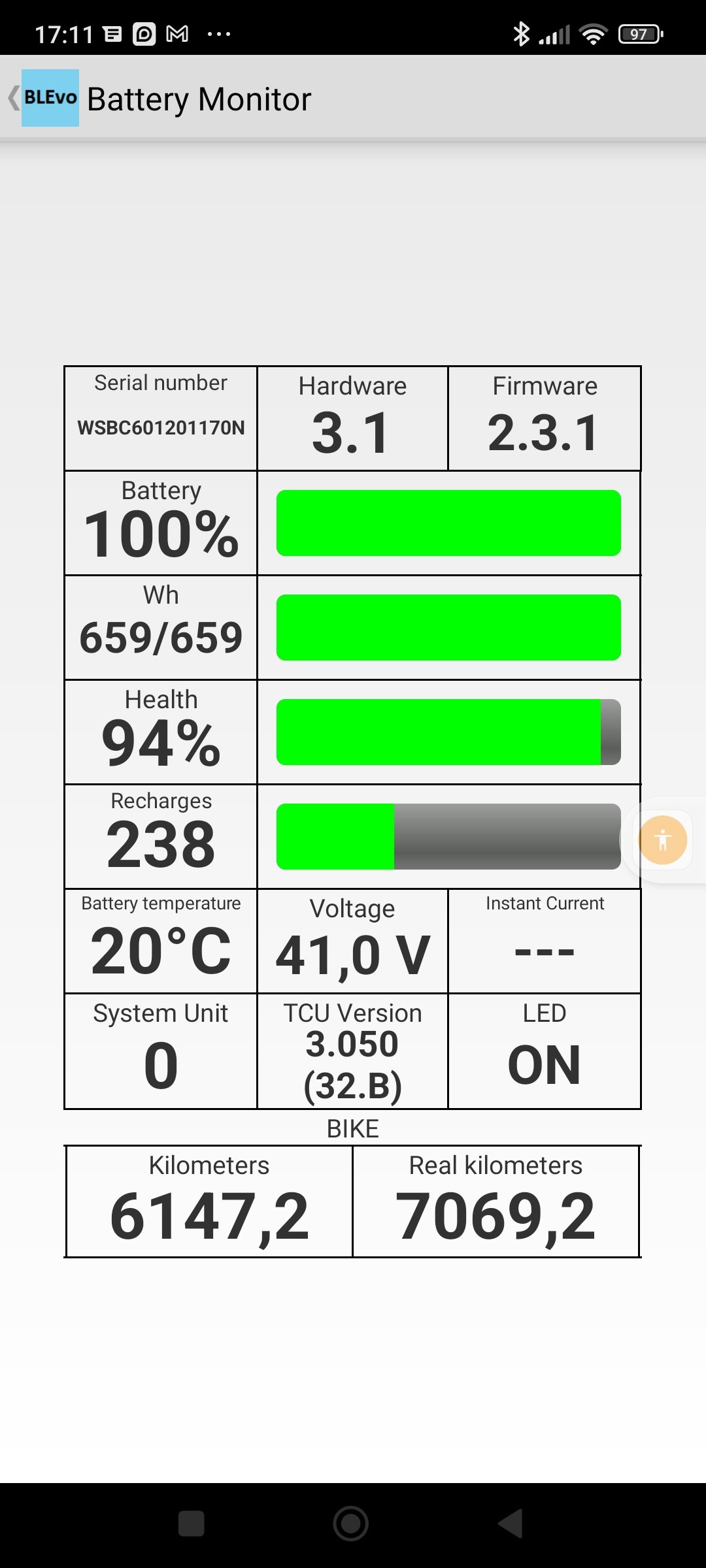

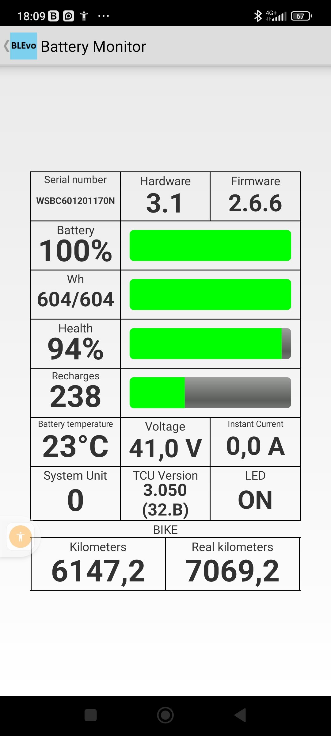

I think the displayed Wh values (659, 604) and the Health value (94%) are *estimates*, not measurements. Changing the estimate does not change the actual amount of energy stored in the battery. IOW, you didn't lose anything. You just have a new estimate for your battery energy storage. Spesh must think the new estimate is more accurate.

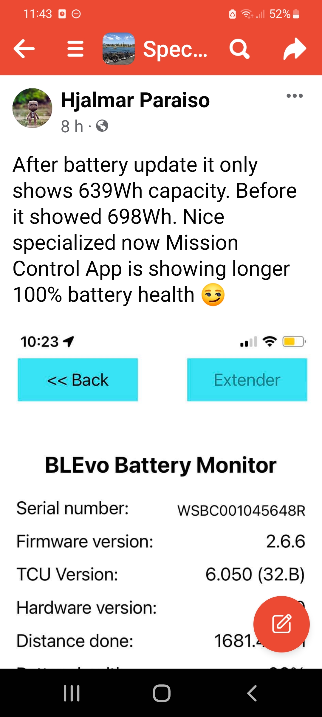

I did the update and haven’t noticed any big difference BUT I have had Mission Control lock up on me when starting a ride . It’s done that twice now. I have to restart the app AND restart the bike to get things to communicate. Anyone else noticing this lock-up problem?
I def noticed a decrease in battery life since the update now my ep8 on my sc bullit blows away the brose setup on my sworks levo 2022 with same spec settings on our local trail loop , ride mainly in eco with some trail 20 miles 2k elev , levo finished with 39% remaining and my ep8 on the bullit 70% remaining somthing is def not right with this update my local shop updated my levo 2 days ago photo of my firmware enclosed

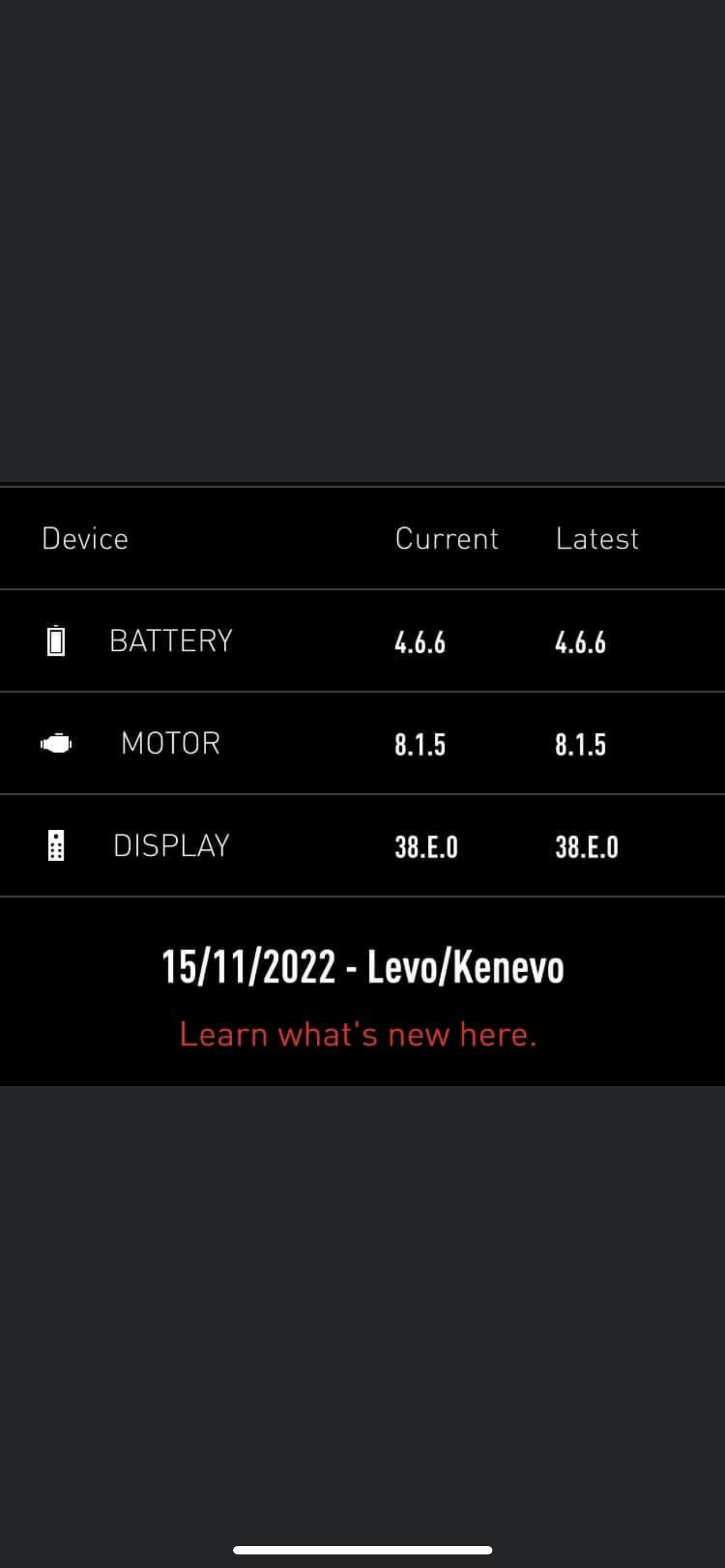

Now it‘s out, it’s also a prerequisite to enable the 80% battery charge limit, that can be enabled/disabled in the latest app version
BATTERY FIRMWARE RELEASES
Bike:
Levo MY19-22 / Kenevo MY20-21
Battery firmware x.6.6
Release date: 15/11/2022
Features:
  • Improved algorithm for battery state of charge calculation
  • Support for battery health optimization
    • Enables “Charge Limit” feature (released 14/02/2023 in Mission Control 3.11 onwards)
  • Improved battery diagnostic capabilities (retailer tools)
Fixes:
  • Bug Fix to battery health status shown in app
