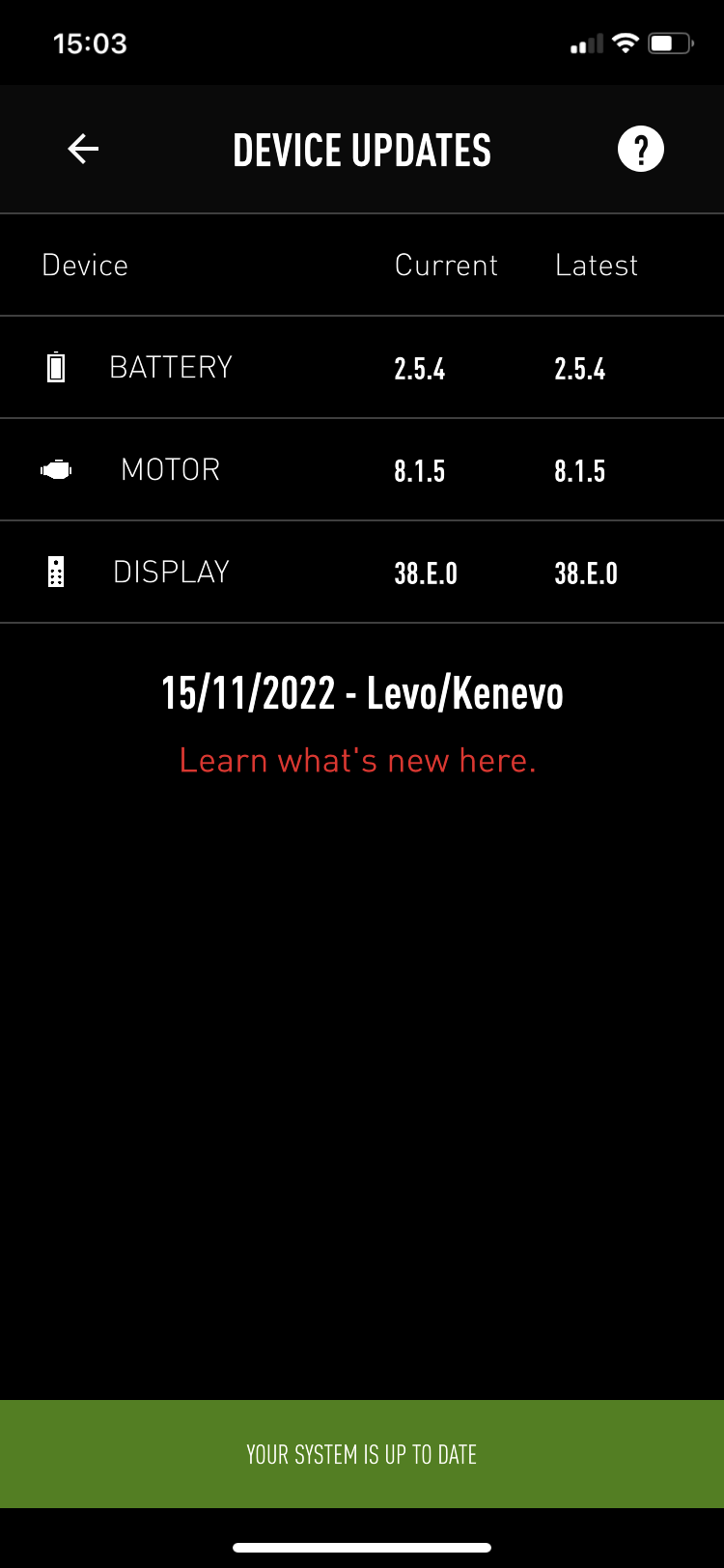

In the Mission Control App is no update available for the battery. Although i received the email from Spesh, i'm not convinced to visit the LBS. Should any mandatory update be visible in the app?
@Sheer Thrill : does your app mention an update to battery? If so, which firmware number is indicated?
Sheer Thrill
Mar 28, 2021
19
18
It does, the latest firmware update is 2.6.6 versus my current version which is 2.5.4 (700Wh for Gen2 Levo). I also have a spare 500Wh battery which I will connect later today and see if there is an update for it as well.
