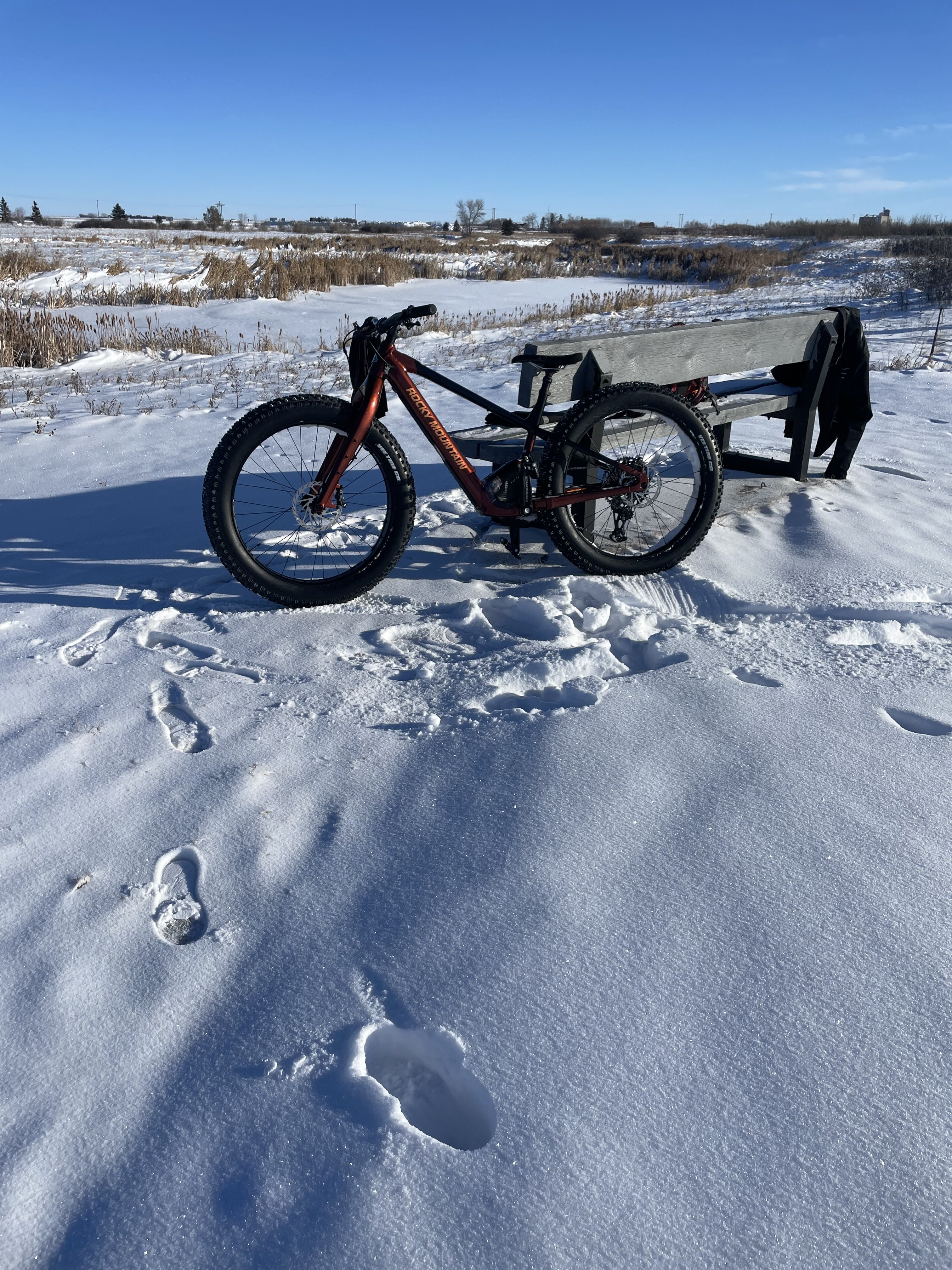

I just bought a Rocky Mountain blizzard power play. I was also wondering about battery in cold conditions. The nice thing with blizzard is you can look at battery temp on jumbtron. display. I warmed up my bike before going on a ride so battery said 18c. I went for 14kmride that took a little over a hour at -20c. That about as cold as anybody will ride. When I got back battery said 13c. Interesting motor was at 27c. So as long as battery is warm before you go you can ride in any temps battery will be fine. As long as you don't stop riding for to long and at colder temps you will not want to stop to long. Also if you charge battery right before leaving it will warm battery to 22c before leaving. It also takes a long time to warm up battery. Took like 4 hours at room temp of 20c for battery to go from 12c to 18c.
