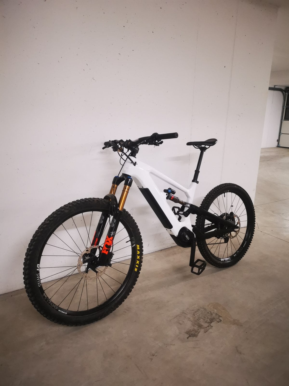

Does anyone have news regarding the release date of the m510? I am actually running the m500 on my DIY Dengfu e10 and would love to replace the motor with the new one.
Would like to know when and where it will be available and if it will work with the installed 840wh battery 🤷‍♂️?
