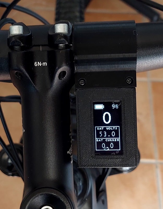

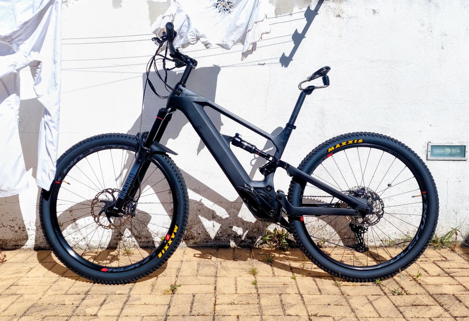

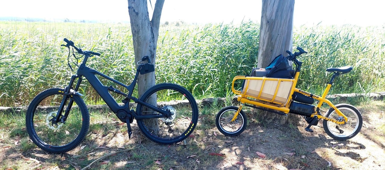

This is my build with Dengfu E10 frame and Bafang M500 motor -- very happy with final result!!. I did follow this build guide: https://www.emtbforums.com/.../my-dengfu-e10-build.24436/

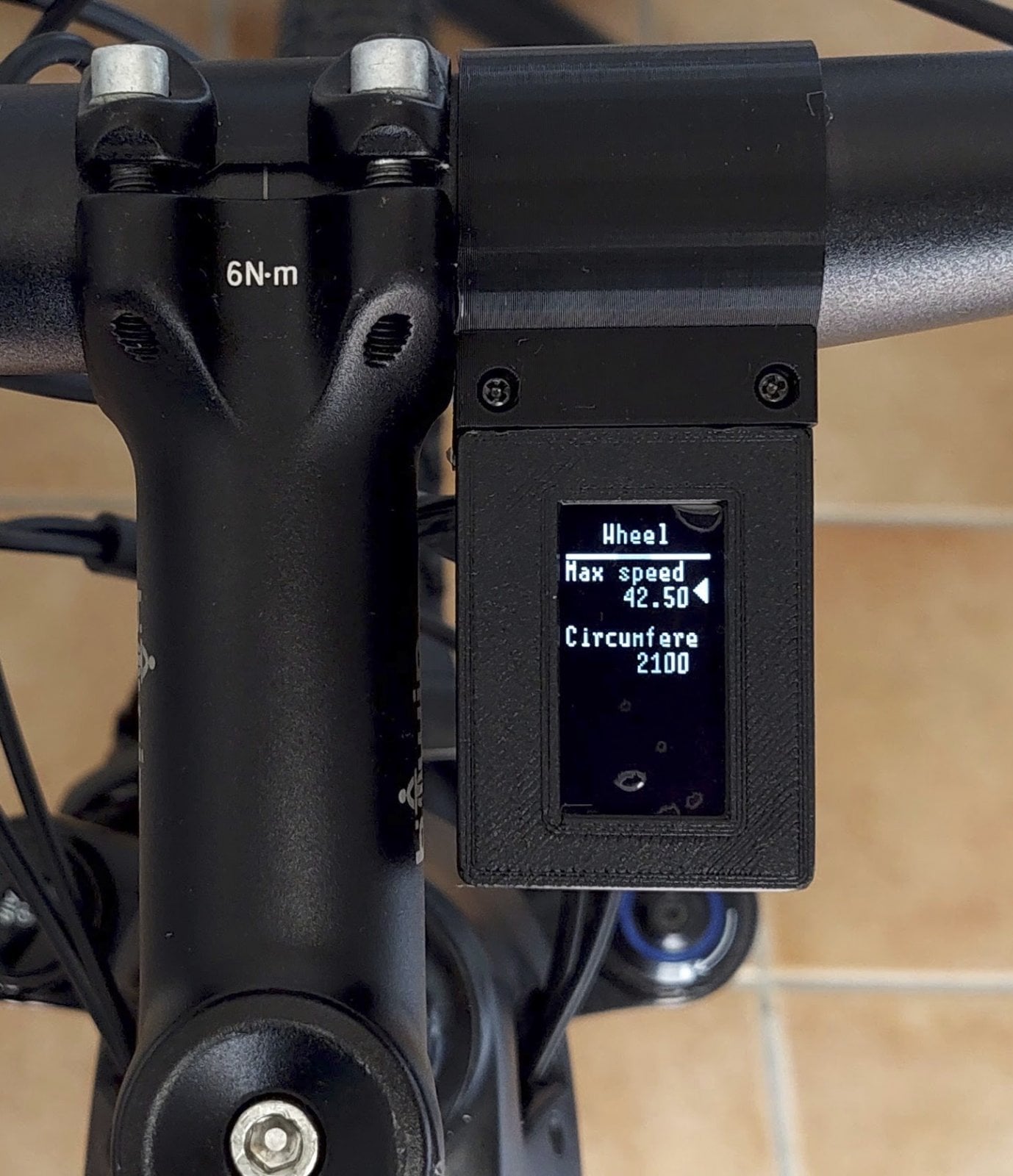

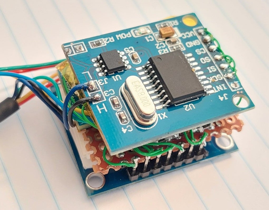

I developed and built our own OpenSource EasyDIY display for Bafang M500/M510/M600 motors, that is a substitute for the original display but show me extra data as battery voltage and motor power, and let me change every parameter of the motor while I am riding outside, including changing the max speed up to 60 km/h: https://opensourceebike.github.io/
Our EasyDIY display:

This display is a substitute of original display, you just connect it to the same connector and use the same 3 buttons as usual. It just show your more data and let make some configurations like the wheel perimeter and max speed.
I do not sell or plan to do it.

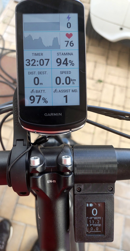

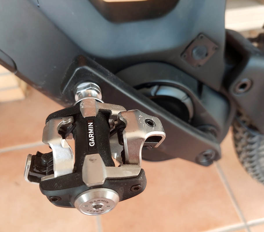

Some notes about using pedal power meter on EBike, something I did not found information of:
I did first test ride with the Garmin Rally XC200 power meter pedals + Garmin Edge 1040. On the EasyDIY display, I have the regular 3 buttons and I also have the 4th button specifically to change the Garmin Edge pages.
The EasyDIY display is very small, shows only motor data and is hard to see outdoors. But since this display is implementing ANT+LEV Ebike, I am seeing the motor assist level value and battery SOC directly on Garmin Edge, which is showing important data as seen on the image: my human pedal power; my heart rate; my stamina; etc. There are other pages that I am not showing, like the map navigation page, elevation graph page, etc.
The pedal power meter seems to work very well, no issue at all for being installed on an EBike. And I was also using my Garmin Fenix 7 watch, where I also paired the pedals power meter, meaning I was receiving and recording the same value both on my watch and on the GPS cycling computer. This is the advantage of ANT compared to Bluetooth.

it is not more useful to build only ant+ transmitter (located nside the frame) to displaying data on garmin and had only one screen ?
casainho
May 27, 2022
44
142
Portugal
No because there are specific functions to control the motor, see data and configurations from motor and battery, that can not be done on the Garmin but can be done on the display. Also, this way the Garmin is optional to use.

I would like to share information about my EBike that is more and more electric!!
I just installed the electronic gears from SRAM AXS 12 speed and they are perfect because now my gears work like a swiss watch!!
Recently I also installed Garmin Rally XC200 Power Meter Bike Pedals.
(I know there are other wireless electronics like to control the drop post, lock the suspension or see the tire pressure)
And the best is that everything is working with ANT+ so I get on the GPS cycling computer the following data:
- Bafang M500/M600 EBike motor assist level and battery SOC (thanks to our EasyDIY OpenSource display)
- derailleur gear number and optimally the battery level
- my pedal power graph (to get advanced fitness cycling metrics on Garmin)
- my heart rate graph
