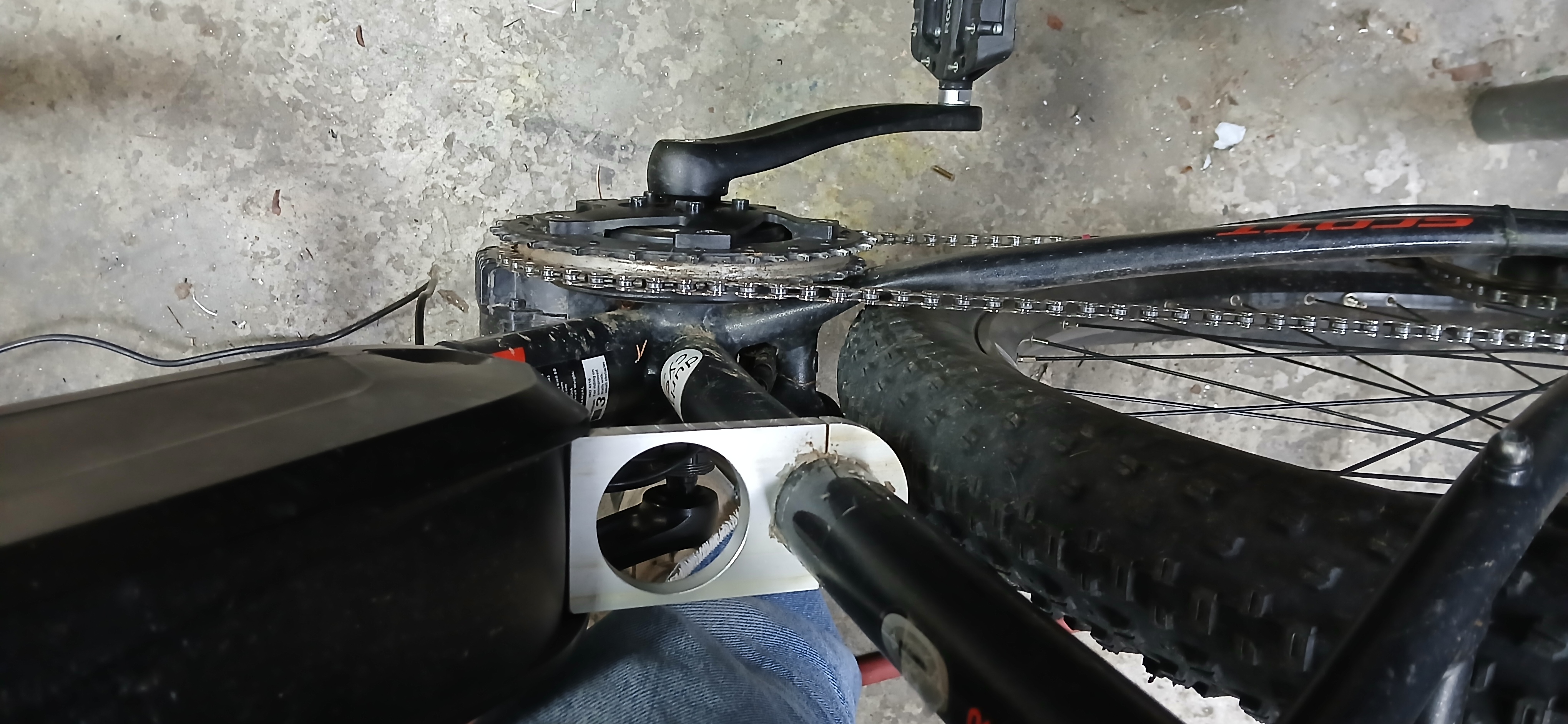

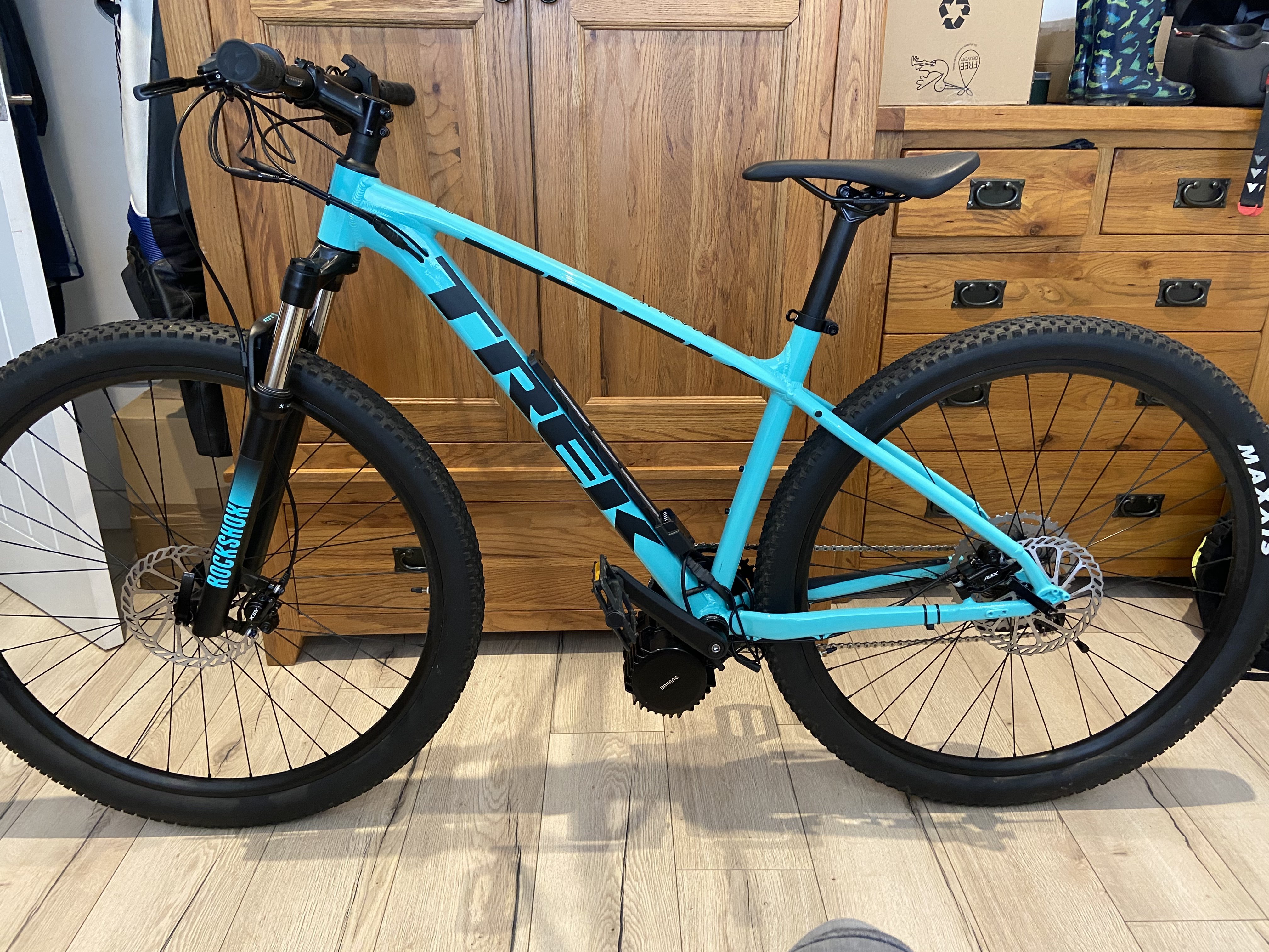

I’m slowly working it out! Got a 42t chainring with 24mm offset. Chainline is now 6mm further out so I’m looking to put 7/8 speed on to help with that. I did wonder if I could have a custom cassette made out of my 10 speed so I can retain the cog spacing of a 10 speed. But can I set my derailleur to work with an 8 speed shifter?
Had the bike out for a test at the weekend. Good for 35mph with the current 28a controller. Just got the shift sensor to fit, bigger rotors to go on and I want to run the main harness internally.

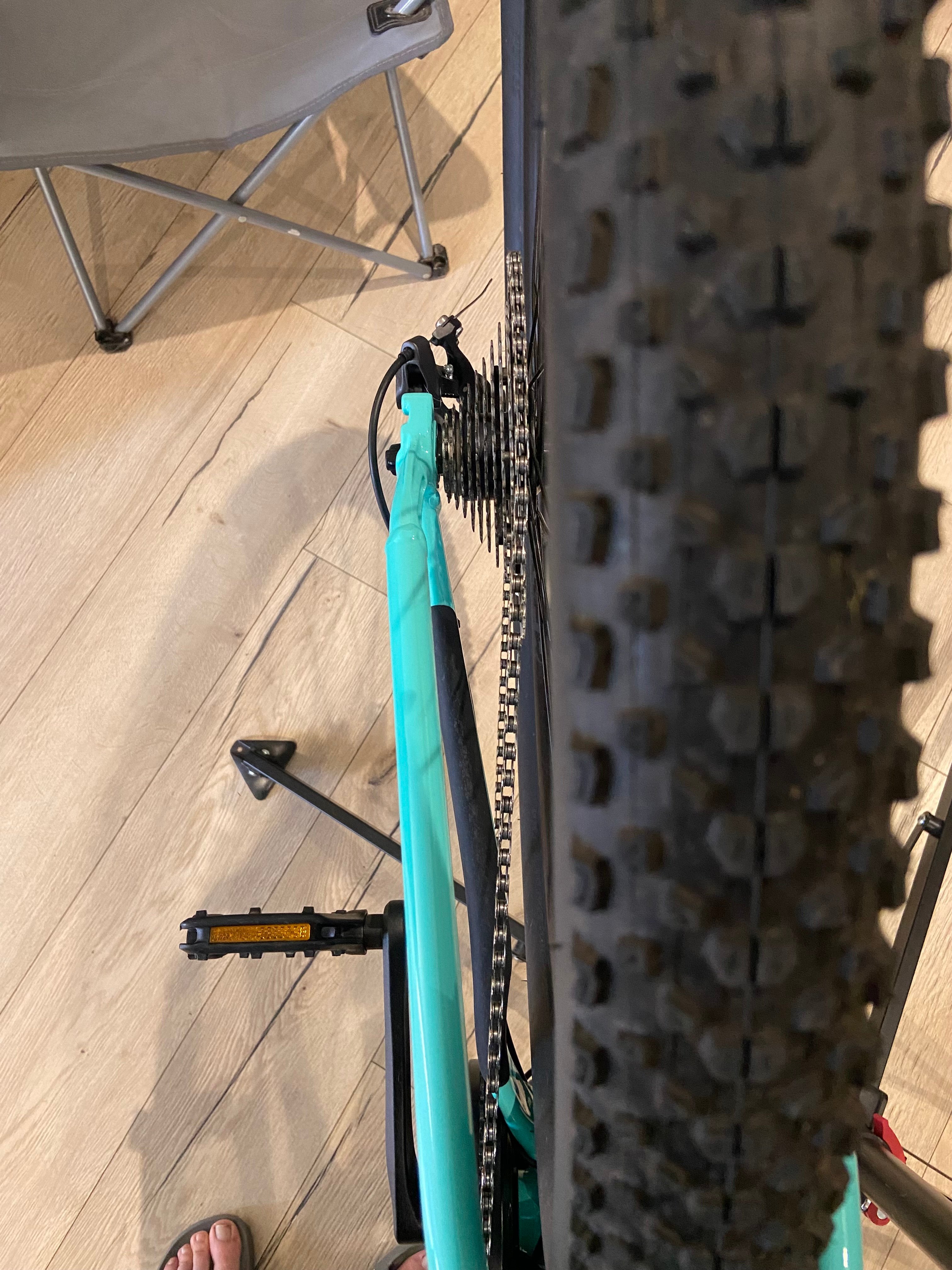

Out of interest do you know how much further out your chain line is compared to standard? I’d really like to keep the 10 speed set up but not sure it’s going to be ok.
Before I go on I will explain I don’t know a lot about bikes, just applying my own logic. Please correct me if I say something stupid!
The bike won’t shift into the two biggest gears since I put the motor and new longer chain on. I assumed that’s just down to the chainline and the derailleur needs adjusting. Although I haven’t bothered trying it yet I’ve gone ahead and ordered an 8 speed 11-40t cassette that I’m going to take the 11 and 13 off and put a 12 on to make a 7 speed that, using info I found here:
should bring that biggest gear out by 6.6mm. With the front chainline out by 6mm I’m thinking that should work fine?!?
Trouble I’m having is finding a decent 7 speed derailleur. Best I can find is the sram x5 but I’d have to pair with an x3 shifter?

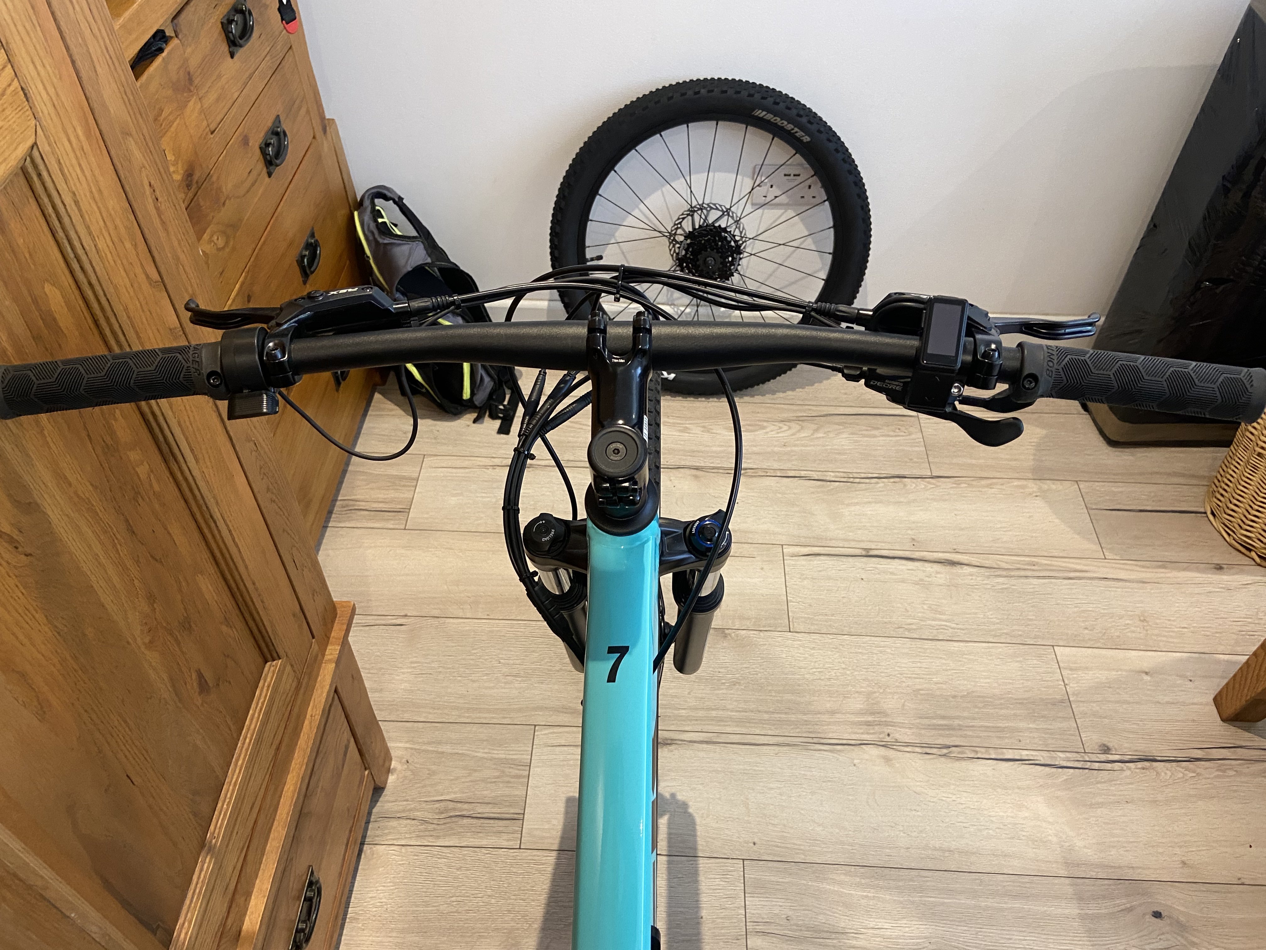

I’ve put on some shimate RSX brakes that have the cutouts built in. Cheap Chinese stuff but I couldn’t find any with the correct 3 pin plugs from a reputable brand. They work just as well as the tektro that was on there. I went for the small display too as I want it to look as clean as possible.

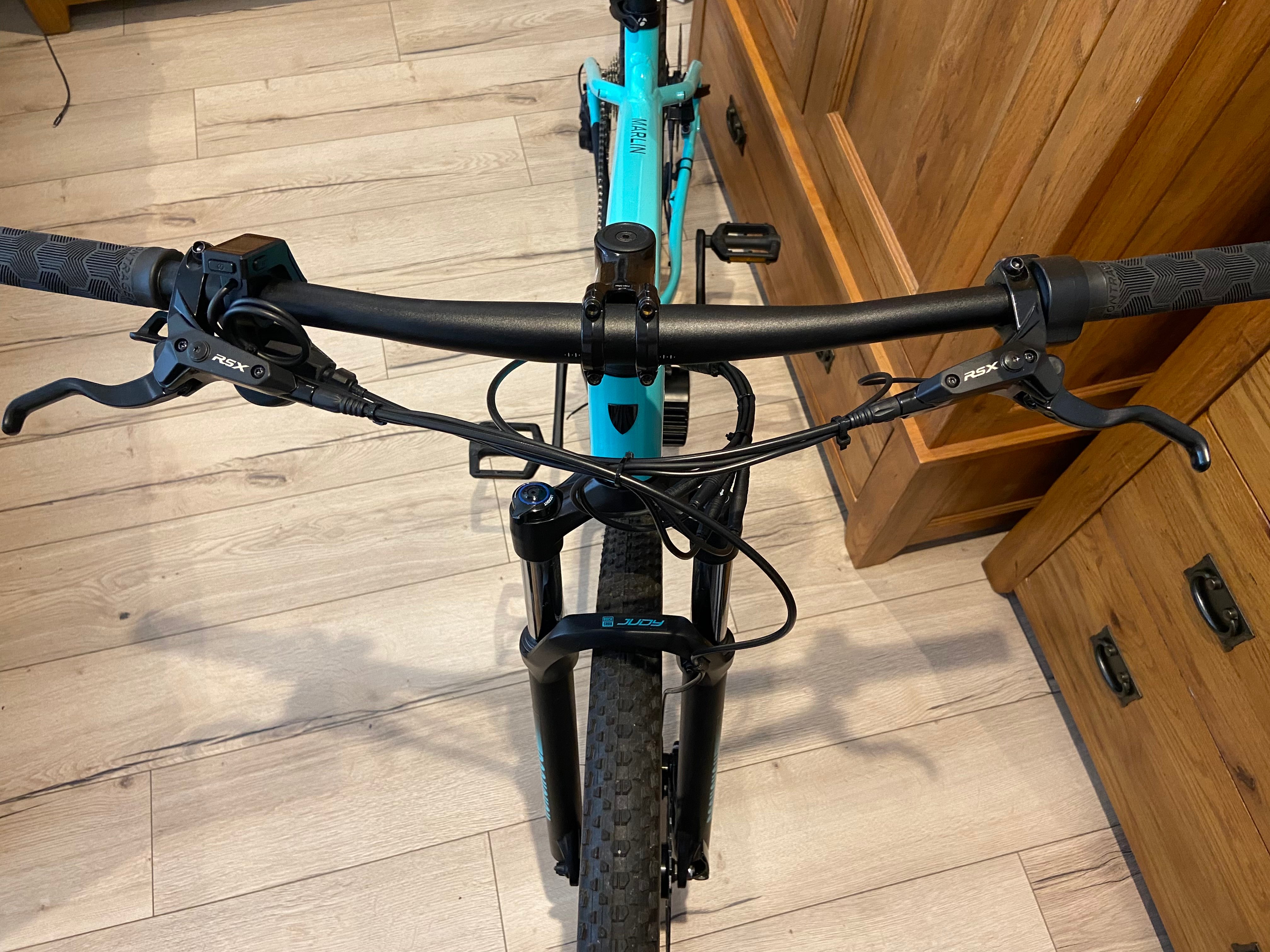

I’ve got the bigger rotors and internal routing done now. Just a bit more tidying up of the wiring and the drivetrain to sort and it’s finished. Some better forks would be nice but not really got the funds for them right now.

Remembering that I'm running a BBS02, not the BBHD. I'm using a 40t Lekkie Bling-Ring and because of this the low profile Lekkie Gear Cover. I run one spacer under the Bling-Ring so my offset is 9mm, the standard Bafang 46t chainring has an offset of 5.4mm. My chain runs straight about mid gears on the cassette and I have no problem getting all 11-46t on the 10 speed cassette. Lekkie says that there should be a 1.5mm gap between the ring and chain-stay to allow for flex, I'm running less than this but have not had a problem.

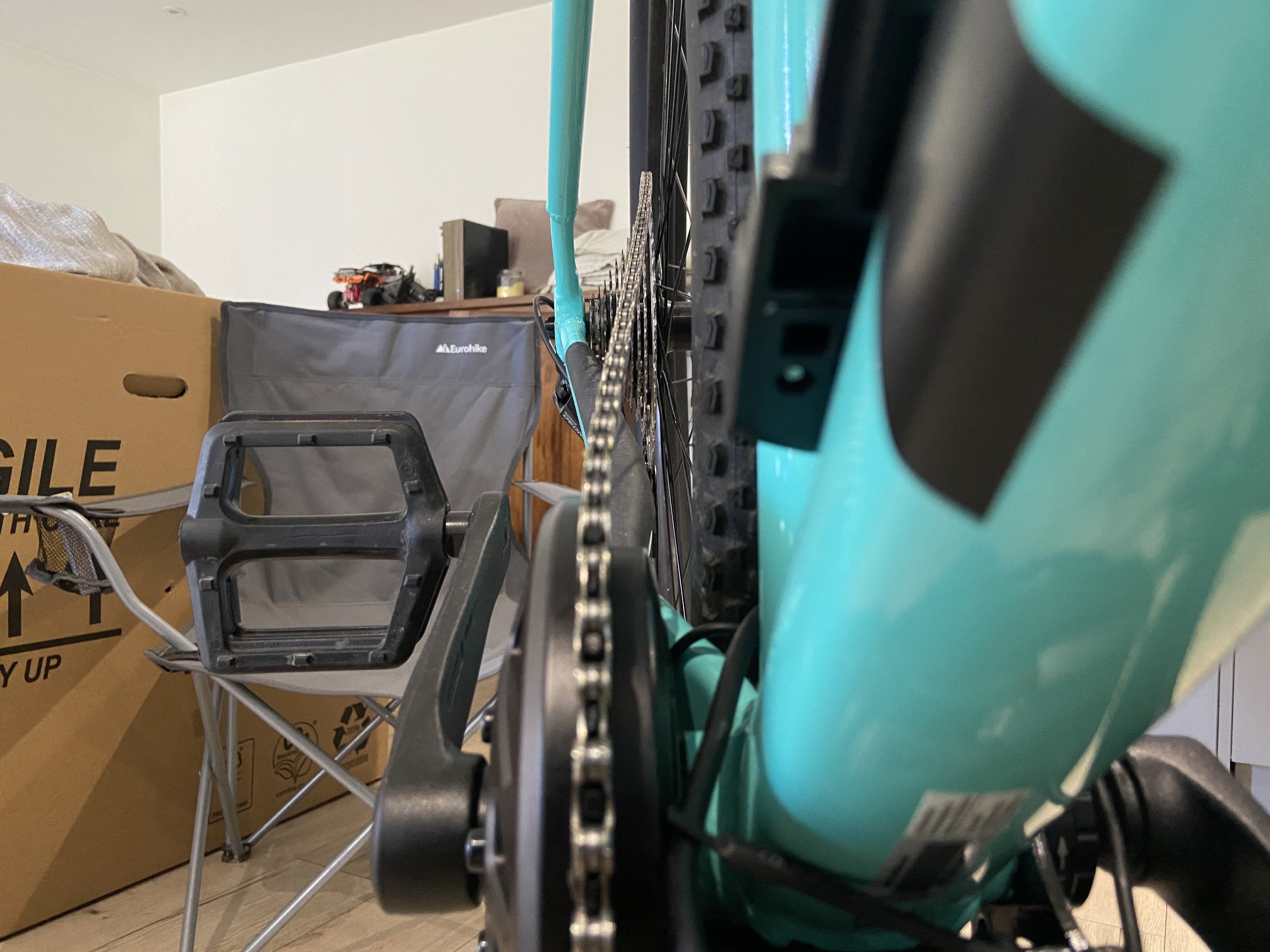

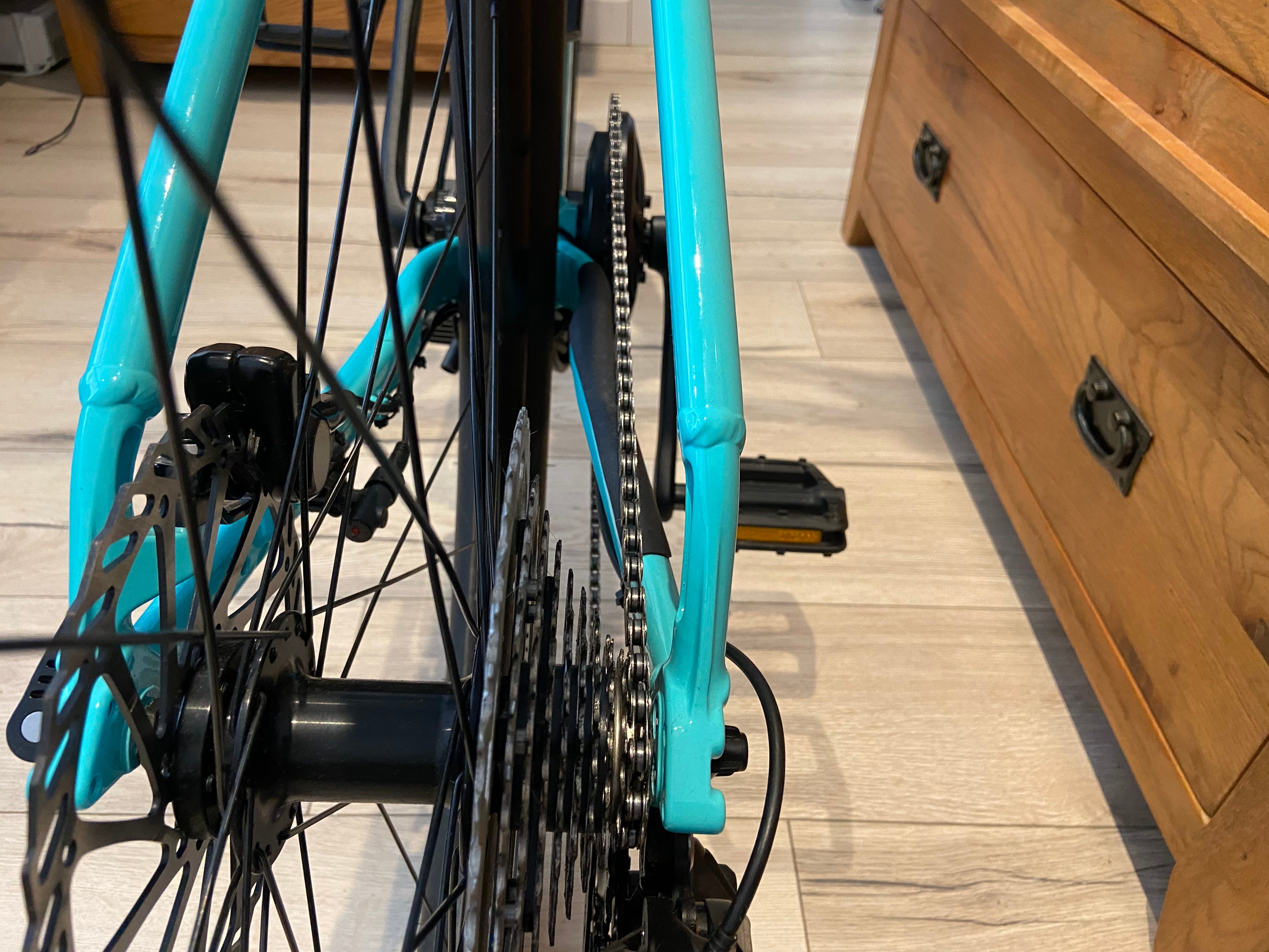

So I took a look at the gears today. Turns out I just hadn’t tightened the cable properly! So now shifts through all the gears nicely. Chain does look a bit askew on the lowest gear but drivetrain isn’t too noisy. Think I’ll just leave as is for now and see how it rides.
