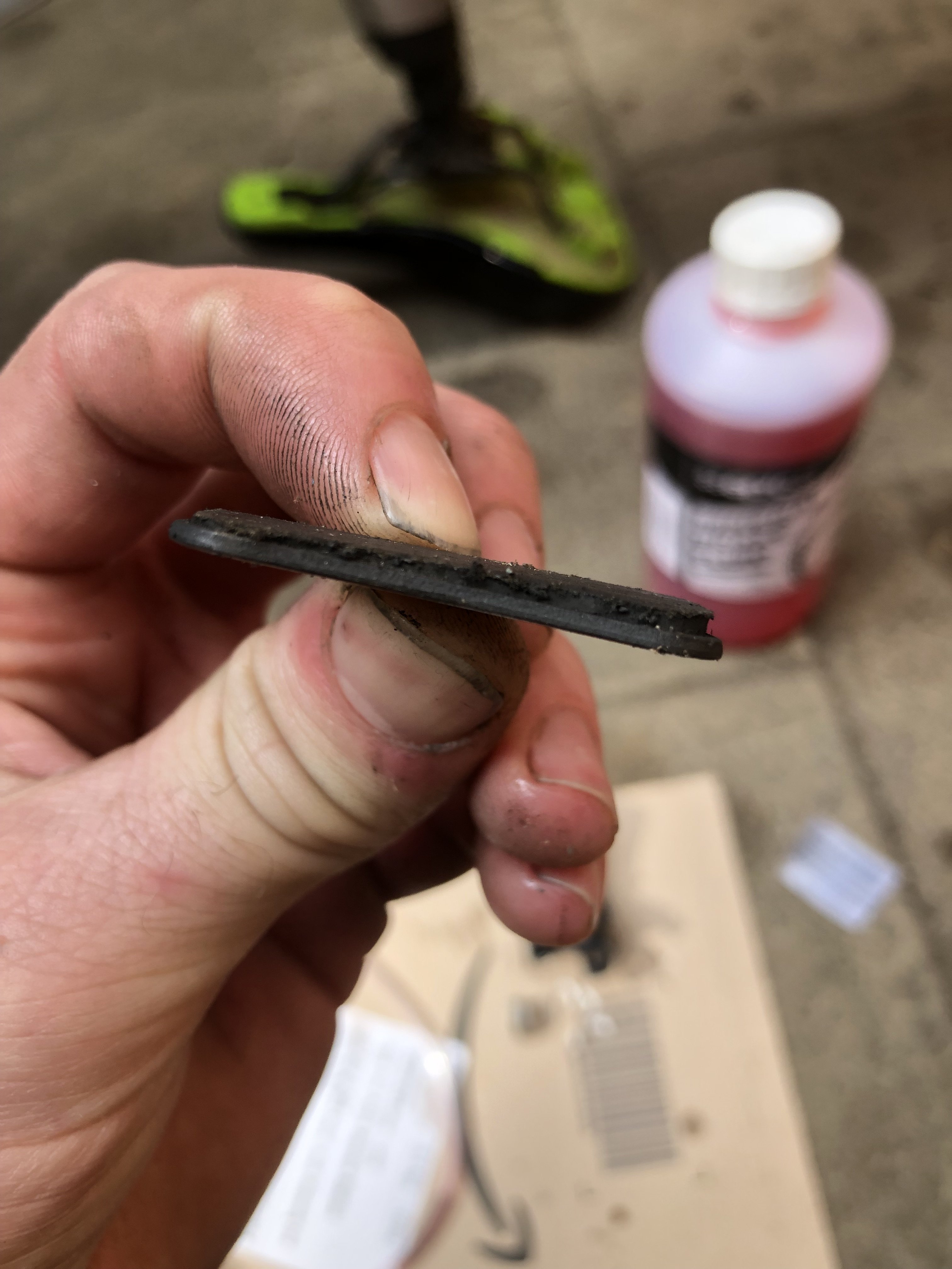

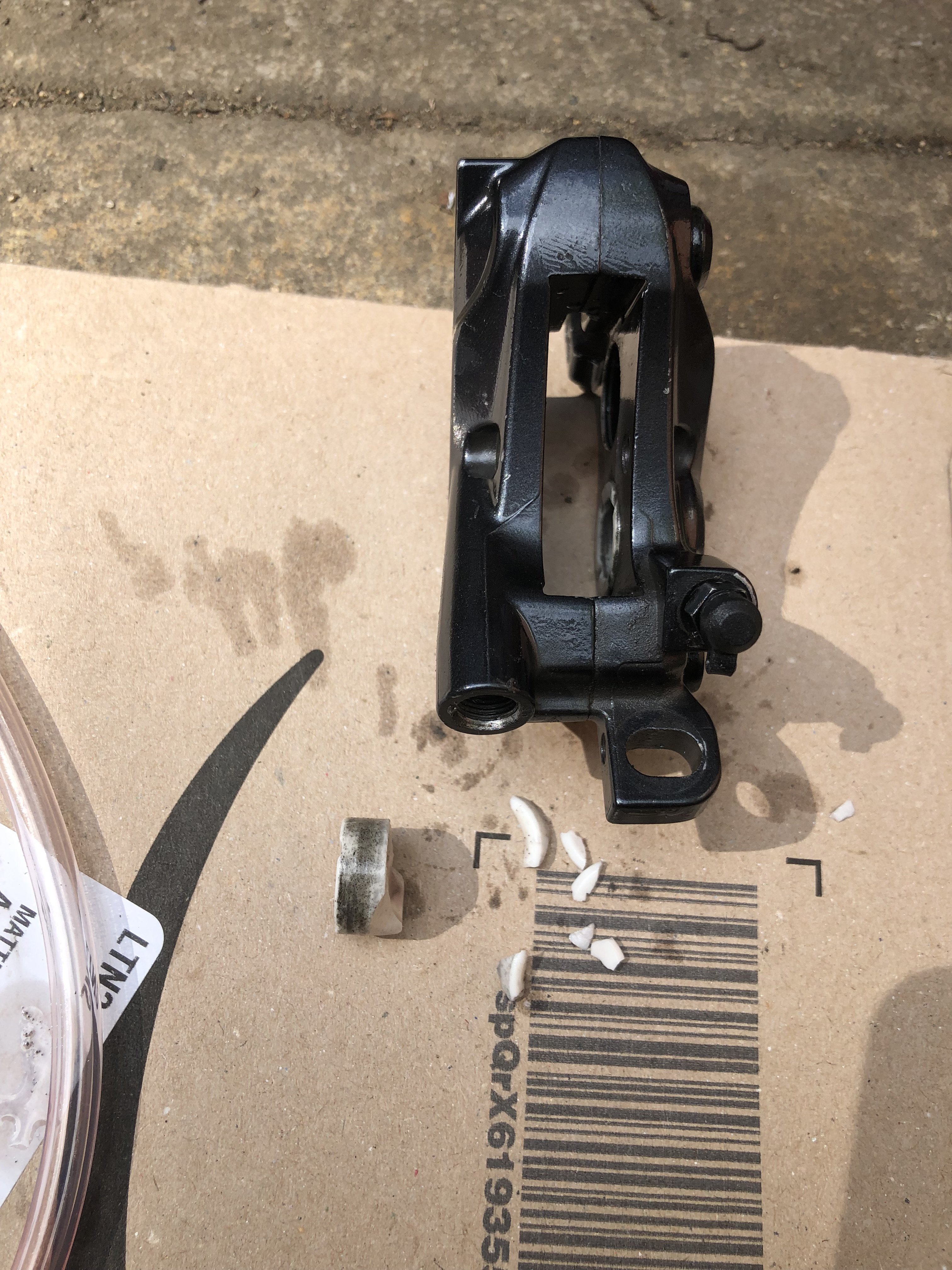

But the real black hole seemed to be my front brake (M6120) which decided to fail at 417 bike park today, pissing all the fluid out of the piston!! Not a good feeling while sending it down hill, squeeze the brake and nothing happens :eek:
Hoping its a case of my VERY worn pads caused the piston to over extend??

Well my front brake failure is not good news, just had things apart. Firstly noticed 1 piston would not retract, and wobbled a lot compared to the others, managed to get the piston out, and found the rear of the piston has crumbled! o_O
Going by the state of the brake pad wear, i suspect its been broken for a while....
Since Shimano appear to not sell spare pistons, have just ordered a new M6120 caliper for £60.
At least i will have some spare pistons incase it happens again!
I had a very similar failure mode on the piston (cracked edges). I attributed to my clumsy pushback of the pistons during a new set of pads and a bleeding. I did order replacement parts from Ali express. Takes a while to receive ( appx 3 weeks). I also bought a replacement caliper in the interim (save rebuild for a rainy day - Not common here in AZ). Is the broken piston a common problem? Comments?

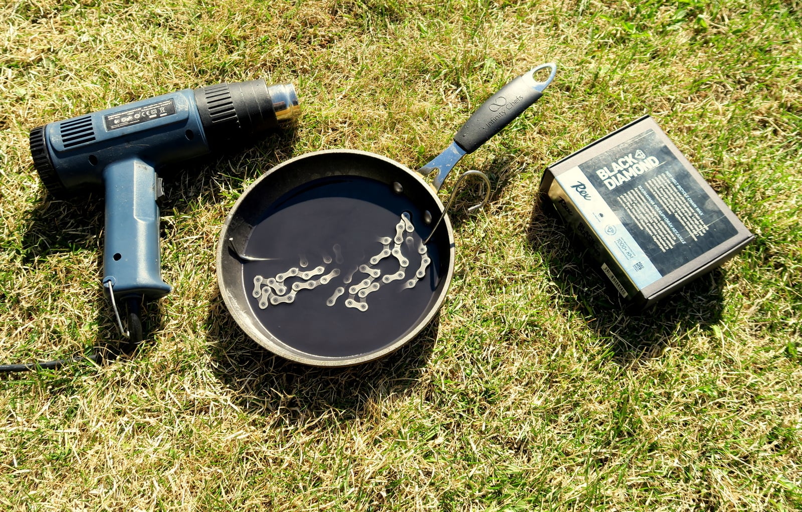

Lopettakaa öljynkäyttö joka paskaa ja likaa koko voimansiirtonne.Ketjuvahassa on tulevaisuus. Edut,ei kerää likaa ,käsittely aika 400km,MTB käytössä.Vaha on kirkas tuote voitelee hyvin.Käsittelin kahdet ketjut samalla ,uusin koko voimansiirron.Ensi ketjulla ajettu 250km, käsien koskematta. Koko voimansiirto puhdas ketjut takapakka vaihtajan rissat.Perustuu uusien ketjujen rasvanpoistoon,15 min,lämmitykseen 60-80 c ,ketjuja liikutellaan lanka pitimellä. Uusia kuvia asiasta 400 km, ilman mitään pesua,pyyhintää.
8,981
9,378
Stop using oil that craps and dirty your entire transmission. Chain wax has the future. Advantages, doesn't collect dirt, processing time 400km, MTB in use. The wax is a clear product that lubricates well. I treated two chains at the same time, renewed the entire transmission. The first chain was driven 250km, without touching it. The entire transmission is clean, the chains are on the back of the derailleur. It is based on the degreasing of new chains, 15 min, heating at 60-80 c, the chains are moved with a wire holder. New pictures about it 400 km, without any washing, wiping.
View attachment 115897 View attachment 115898
