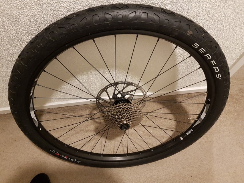

I have Serfas Drifters on my spare wheelset. No difference in speed as with either knobbies or slicks I always sit on the 32kph limit but certainly a lot cheaper than the knobbies I use and besides giving much better grip on ashphalt they also last way longer than knobbies on the hard stuff.

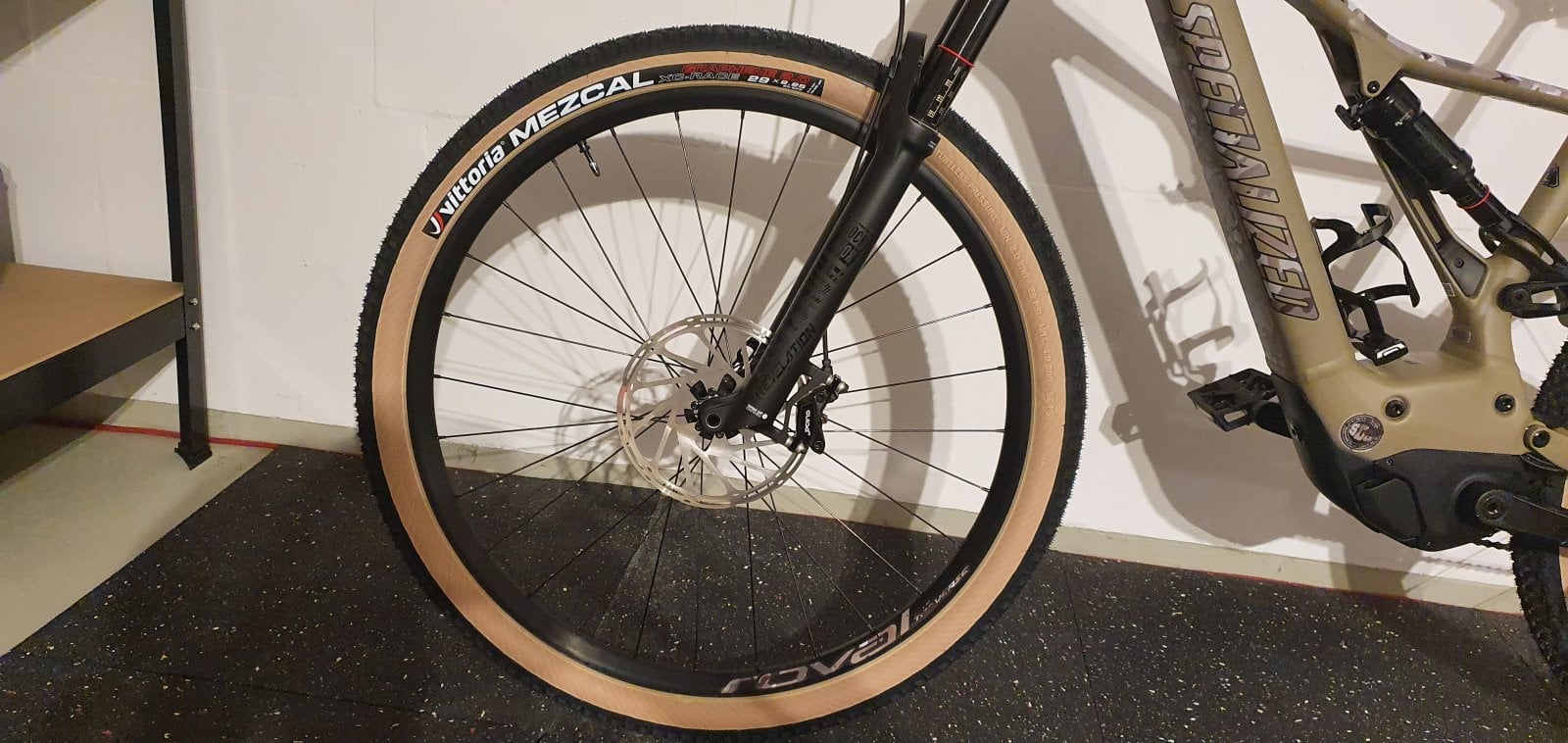

The Mezcal comes in 29 x 2.6 and this is the top of my list right now. MEZCAL

Just switched from stock tractor tires to Mezcals a few days ago and it has unlocked the ability to....coast without pedaling for more than a few yards lol. Also, cornering on asphalt/concrete no longer sketchy. Seems like a good mix of on/offroad capability.
