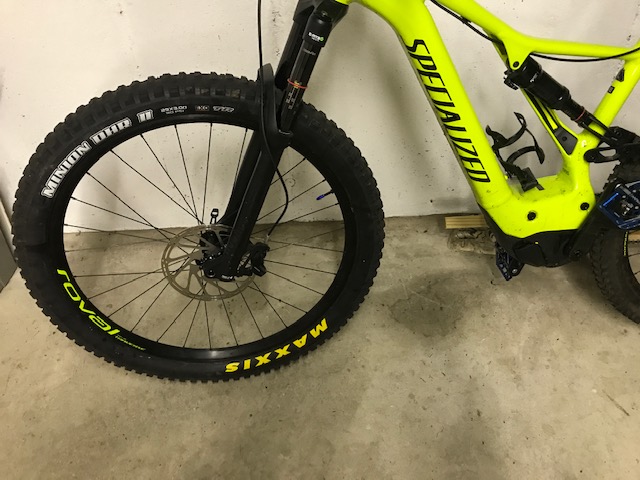

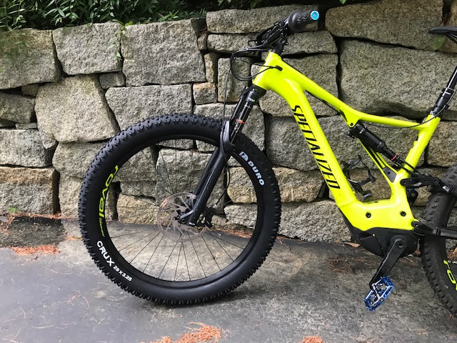

Just found this thread--thank you guys. Been riding a long time and ever since coming out of the 26" cave to Ebikes
2 years ago (But snaps to Gary who has the skill to ride that) have been looking for bigger and bigger tires now that I have the motor to power them. I'm definitely pushing the sense and safety envelope...Just tried a 3.25 front tire on my 2019 turbo levo.
But it rubs on the DebonAir fork. Can anyone suggest a better fork with more clearance?
So we're running a 3.0:
It's got clearance but it's pbly too wide in theory for the 35mm rims. Maybe it'll roll off if a do a cyclcross but so far it's been solid enough and letting me ride bigger rocks and roots

A RS Bluto has that sort of clearance
But. it only has 120mm travel
and you'll also need a new hub (or some sort of bodged adaptor) as the axle is 15x150mm
another option could be to run an older USD fork like a marzocchi Shiver
Why you'd want to run a 3.25 tyre unless your terrain is predominantly sand or snow I have no idea.
