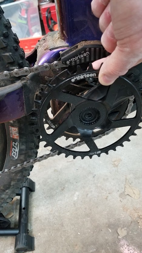

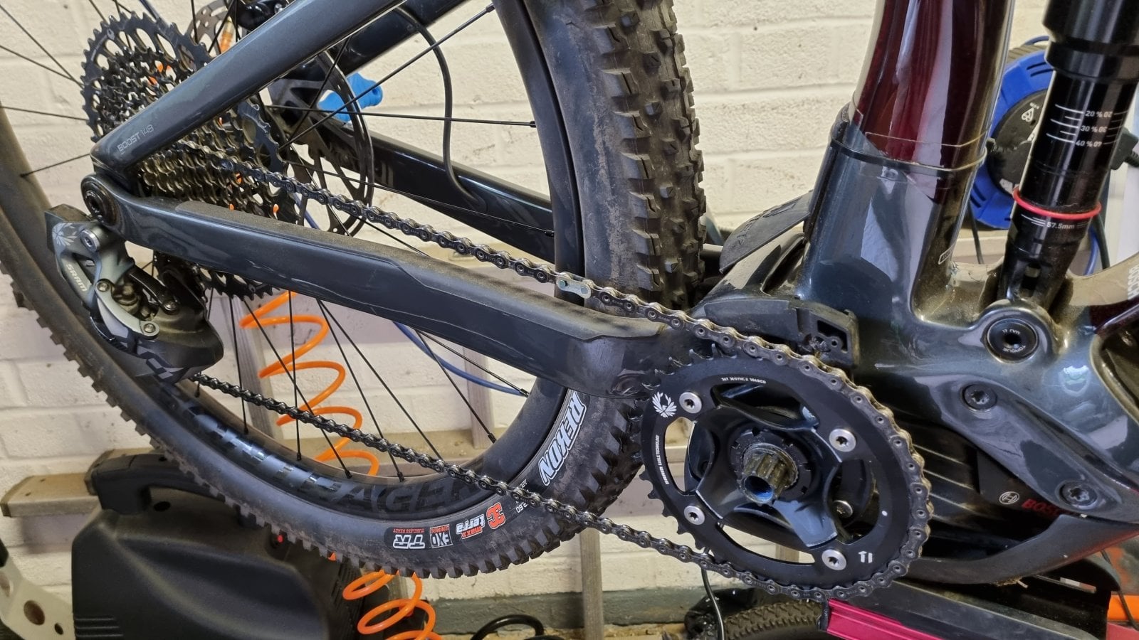

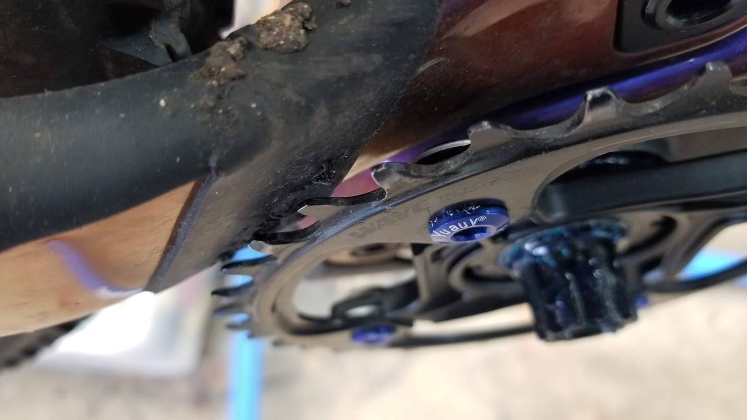

I love my rail 9.8XT but the one design flaw that pisses me off is how close the chain stay is to the stock 34T chainring. I know that the chain line is important but how much out of line can you go before it becomes a big deal?

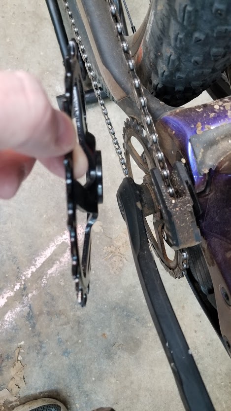

My bike is simply geared too low for the fast a flowly trails. I'm thinking of using spacers on the crank to try and fit the steel E13 36T chainring. From reading forums and complaints, it looks like some folks could benefit from installing spacers just for their 34T stock rings that rub the chain stay.
Can I go as far out of whack as 3mm on the chain line without problems? Not sure if there might be chainrings with custom offset to achieve the same goal?

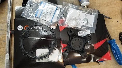

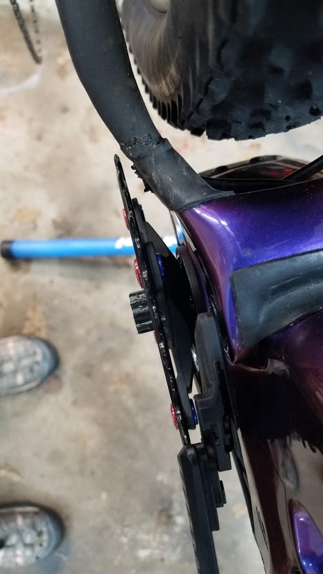

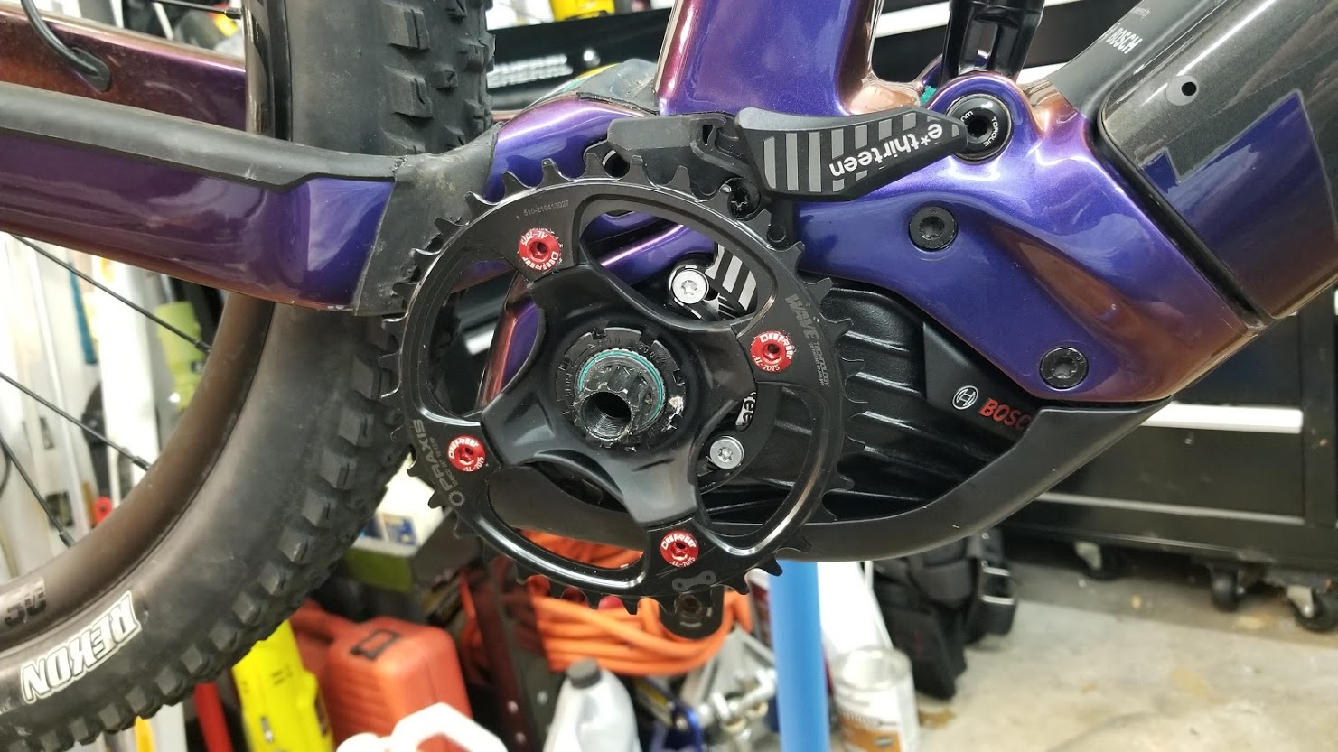

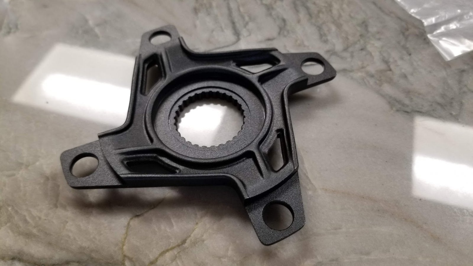

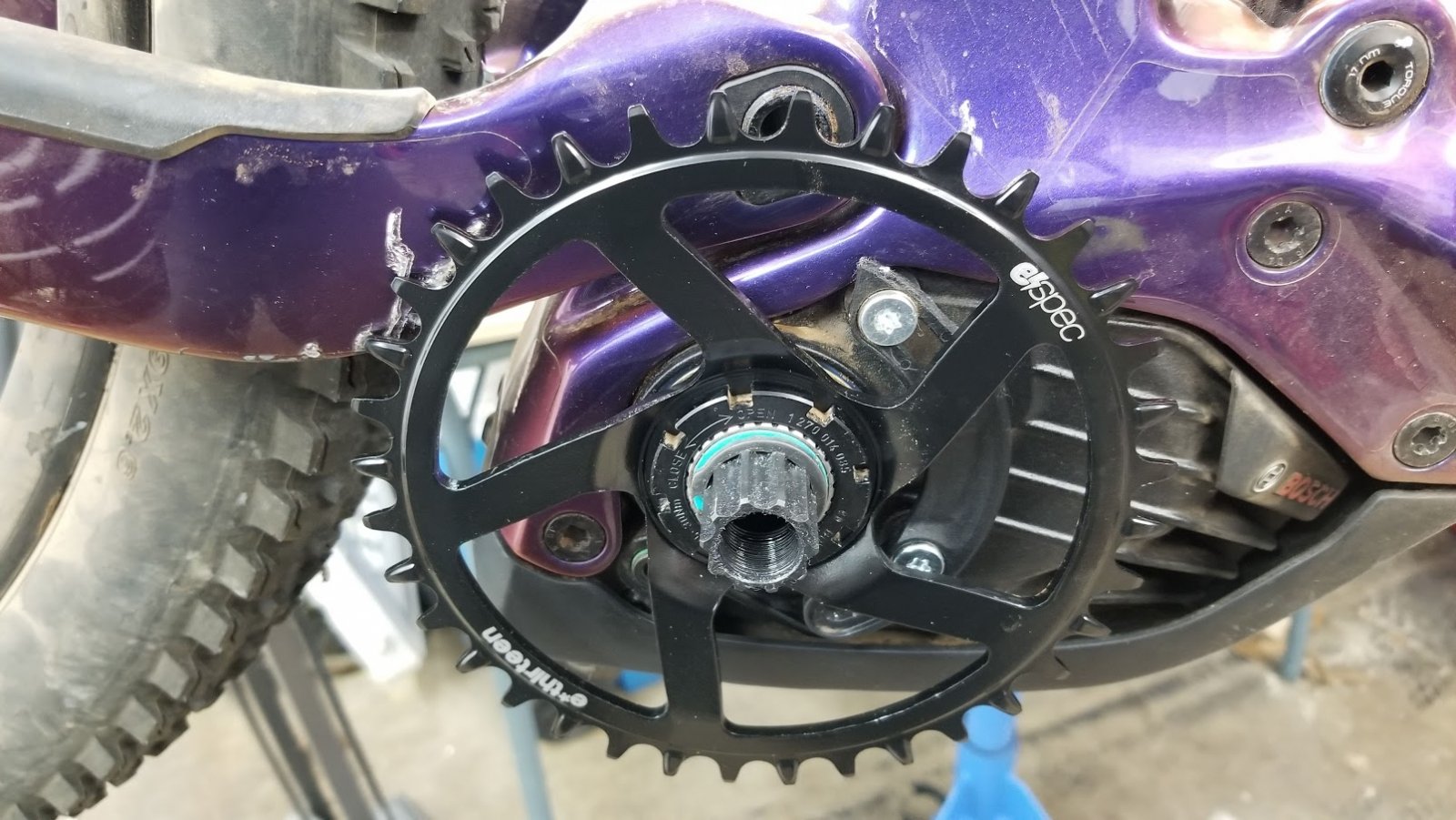

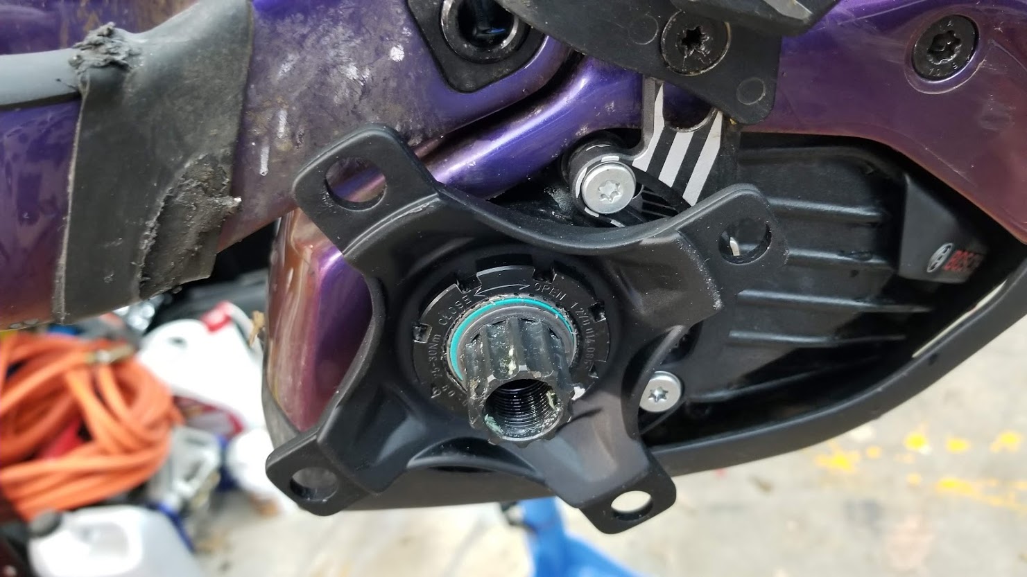

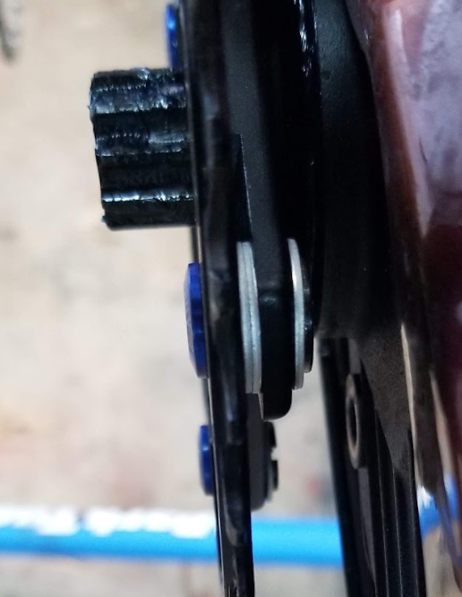

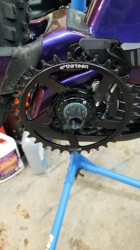

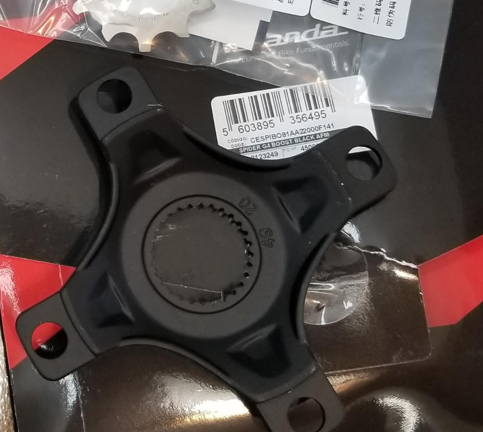

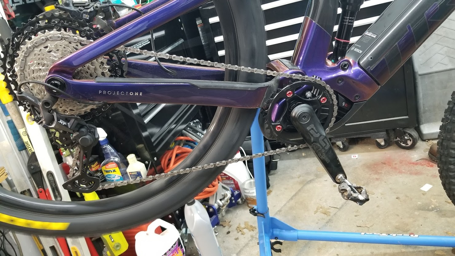

36T Chainring rocks!! I used the Miranda Bosch Gen4 spider and Praxis steel 104BCD.
Install wasn't quite straightforward. The Miranda is designed for the chainring on the inside of the spider to get the 53mm chain line but as we know a 36T won't fit. I mounted it on the outside of the spider. It's about 4mm further out or about one gear off center relative to the cassette.
The praxis chainring comes pre chainring bolt threaded and has directional teeth. The problem is that its designed to mount on the inside so you can't flip it and simply mount it reversed. I had to drill out the threads on the chainring to 10mm and use regular 8.5mm long chainring nuts/bolts to mount it to the spider. I will mention that a standard HSS drill bit wouldn't even scratch the ring. I had to order a cobalt bit then drilling was no problem. It made me glad I went with this chain ring seeing how tough it was to drill.
It's been torrential rain here in Austin, TX for two weeks so trails are all closed. I did give it a spin round the neighborhood and it shifts like butter. I won't know the improvement until I hit my usual trials in a few days.
My chain guide is ready to go back on. I just had to find a longer mount bolt and washers to line it up with the new chain line.

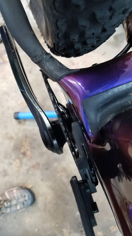

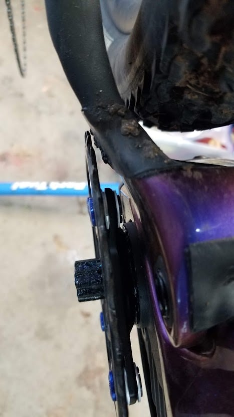

original 34T
34T rub (disgrace)
new goodies
new chainline

Just a quick update. Although the new chain line is about 5mm further out from the frame, the bike shifts flawless into and out of all gears. I also replaced the worn 10T and 12T cassette sprockets and the bike feels like new. No skipping. Wish it came with 36T from the factory. The 104 BCD will let me swap out to any cheap front chainring now. Very pleased with the mod.

Yeah the Praxxis chainring has no offset. Any straight 104BCD chainring will fit on the outside if it's designed for standard 10mm diameter chainring nuts/bolts.
The Praxxis is super strong steel but turned out not to be ideal since it comes pre-threaded for standard chainring bolts. However, since it's directional and has a collar around the threads to lock into the spider, the collars are on the wrong side when you try to mount it on the outside of the spider. Probably too much detail, but that's why I had to drill out the chainring to 10mm and use standard chainring nuts/bolts. It let me keep the directional praxxis rotating the correct way after drilling out the alignment collars in the chainring.
I used 8.5mm long chainring bolts to get the length just right. Any 104BCD chainring should work with the miranda spider.

I went with the Miranda 53mm spider. With the 36T mounted on the outside it is a good 4 to 5mm outside the 53mm chain line. 36T is too big to mount on the inside since it would have the same chainline as the original 34T.
I'm going to order the 50mm FSA W0134 Bosch Gen 4 Spider to compare to the Miranda. The Miranda is great but I want to try to get my final chain line as close to 53mm with the bigger 36T.

Aviserated, I've tried three spiders so far and the best one for the 36T is the FSA 1X Spider Boost 104mm BCD for Bosch Drive Unit Gen4 - W0138. With the FSA W0138, I added two thin washers and now the chain line is as close to stock as I can make it. The 36T is almost rubbing like the 34T was. The washers are thin enough that the chain ring still rests in the spider alignment grooves.
My trick to finding parts is get the part number and spend a while googling. It usually works but I've been looking for a smith mainline helmet in stock now for over 8 months! I feel your pain.
