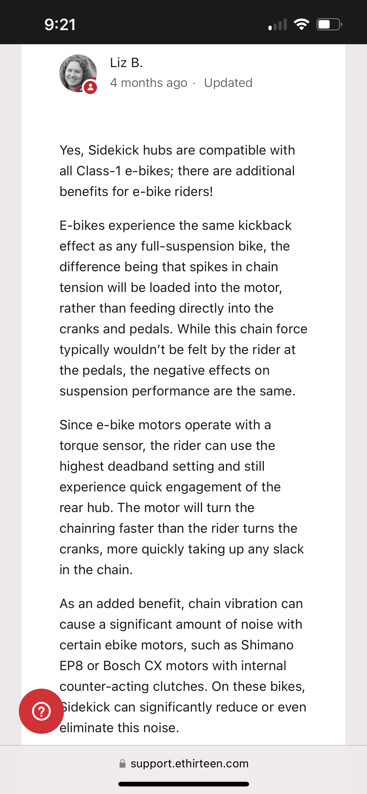

It's an interesting topic but I'm not sure how much is actually PK (obviously varies by bike) and how much is just a 400-gram chain whipping around.
Here is what E-13 says about their hubs when on an e-bike: https://support.ethirteen.com/hc/en...-Are-Sidekick-s-benefits-the-same-for-e-bikes
"Yes, Sidekick hubs are compatible with all Class-1 e-bikes; there are additional benefits for e-bike riders!
E-bikes experience the same kickback effect as any full-suspension bike, the difference being that spikes in chain tension will be loaded into the motor, rather than feeding directly into the cranks and pedals. While this chain force typically wouldn’t be felt by the rider at the pedals, the negative effects on suspension performance are the same.
Since e-bike motors operate with a torque sensor, the rider can use the highest deadband setting and still experience quick engagement of the rear hub. The motor will turn the chainring faster than the rider turns the cranks, more quickly taking up any slack in the chain.
As an added benefit, chain vibration can cause a significant amount of noise with certain ebike motors, such as Shimano EP8 or Bosch CX motors with internal counter-acting clutches. On these bikes, Sidekick can significantly reduce or even eliminate this noise."

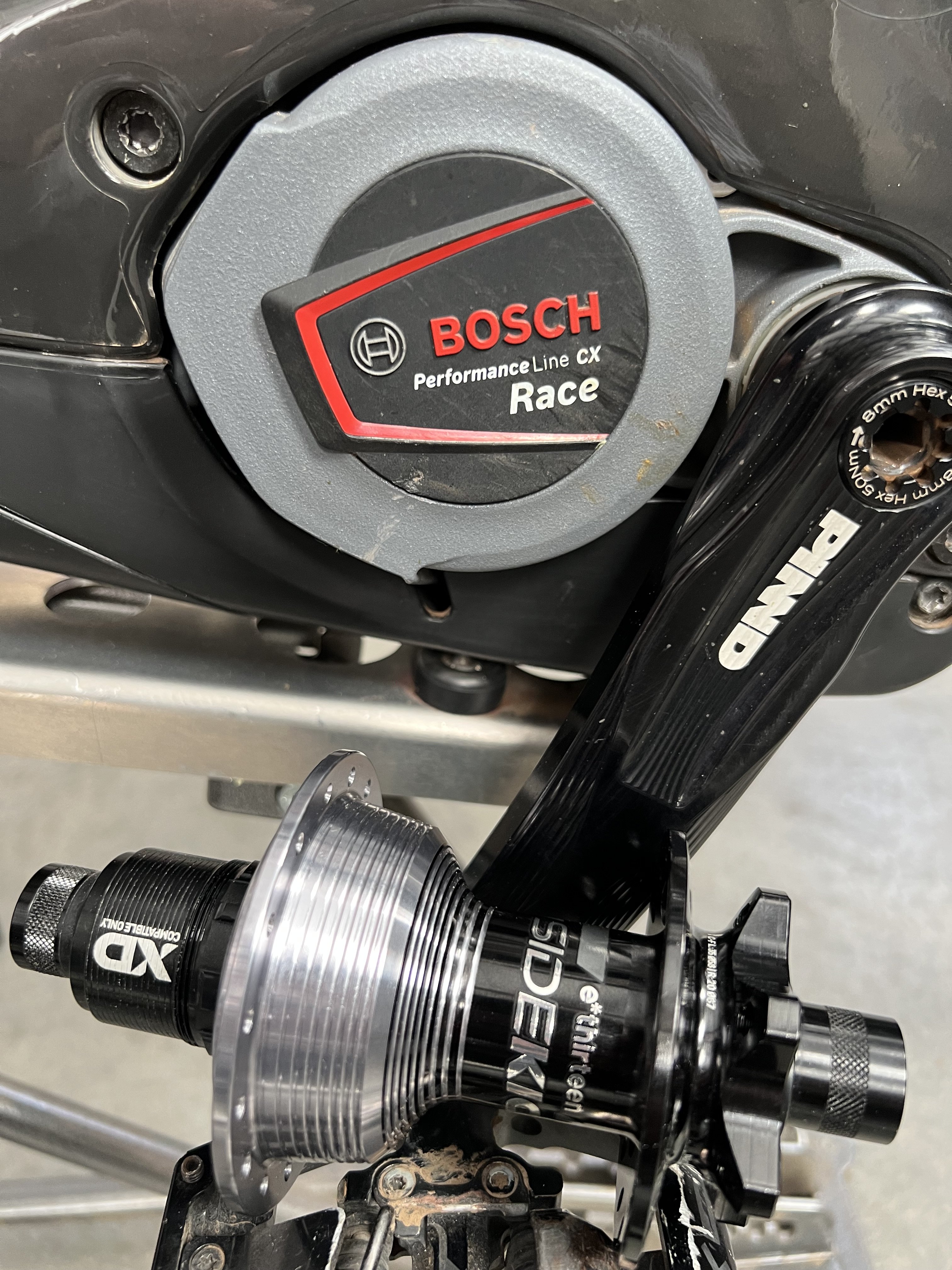

This support info is posted on the E13 site.(see below screenshot)
I just ordered a Sidekick which will be laced to my Crank Brother Synthesis carbon wheel mounted to my Crestline. I’ll update if it does indeed help remove the descending rattle of the Bosch CX Race motor.
E13 is 3hrs away from me, so it shouldn’t take long to get.
I’m super interested to hear how you get on with the e13 hub and also if you have any reliability issues. How many miles do you expect to do in the next ~6 months, and what sort of riding will it be used for? Would you consider starting a thread when it arrives please? 😊

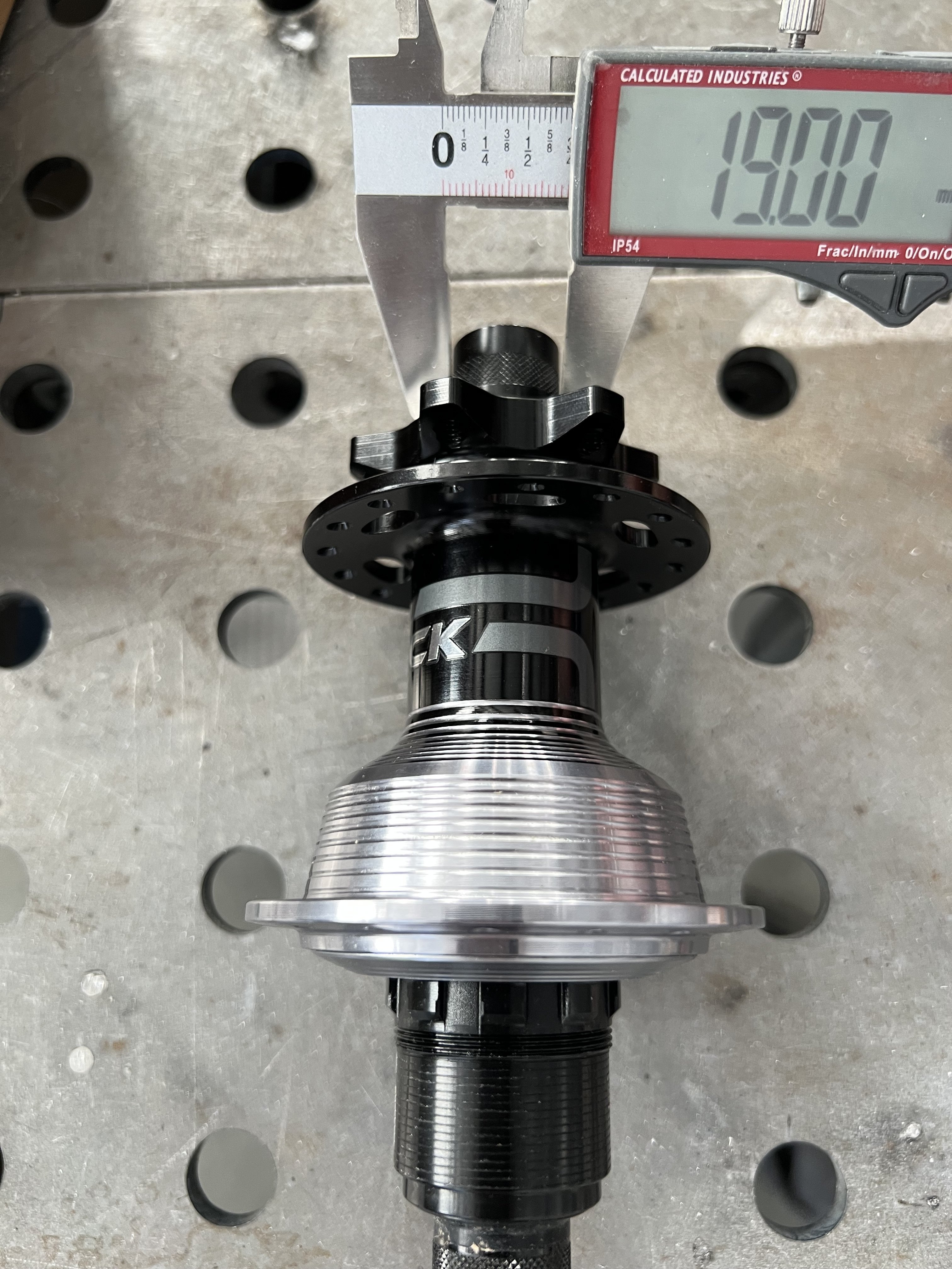

After contacting ochain it seems they do not and will not support TQ motor …
So I hope mid/long term of e13 sidekick will be good and reliable.
@AlumiPro do you know the diameter of the unit cylinder on the brake size?
Eg DT Swiss it is 19mm, Bontrager 21.1
Thxs.
