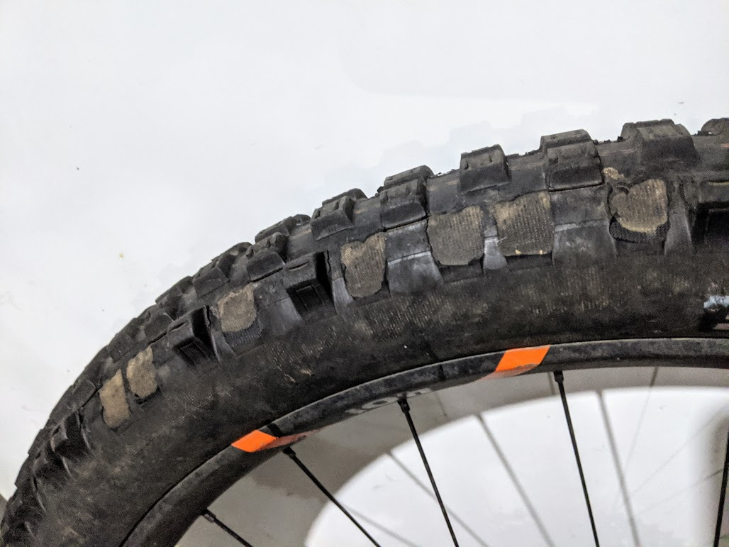

I had 27.5 x 2.8s on my Haibike Allmtn's rear for several months. I liked them just fine, VERY hard to install but super-stiff sidewalls and rip/puncture-proof. The edge knobs' inners rounded quickly though, within a few trail hours, and a bunch came off all at once after a couple hundred miles (pic below). I think the knobs are too chunky for narrower than 2.6 - they'd either be too close together or there'd be too few per sq in...

Damn man. Is that the old compound or new? I haven’t ripped any off.
Got it for like $48 in 2018 from bike-discount.de, back when they shipped to the USofA. Now we seem to be the ONLY country they don't ship to, which bums me out because they sell a lot of stuff for less than US wholesale... which is likely why they stopped! Distributor and retailer complaints... "squeaky wheels."
How many hours/miles on yours? Hopefully this new compound you speak of wears and adheres better! Meanwhile, I've gone Maxxis...

Waiting on an Eddy current rear(backorder) and I am putting a set on some new carbon wheels. They look ok to me and I think the knobbies ripping off has been fixed on the newer tires......
You must have been watching a re-run of Nigella over Xmas to rip that many off! :eek:
The day I first noticed missing knobs, only three had come off but a few others were hanging by a... thread? I yanked all the totally loose ones before I shot that pic.
My guess is that they started peeling off a couple-few rides prior, I just didn't notice right away...
