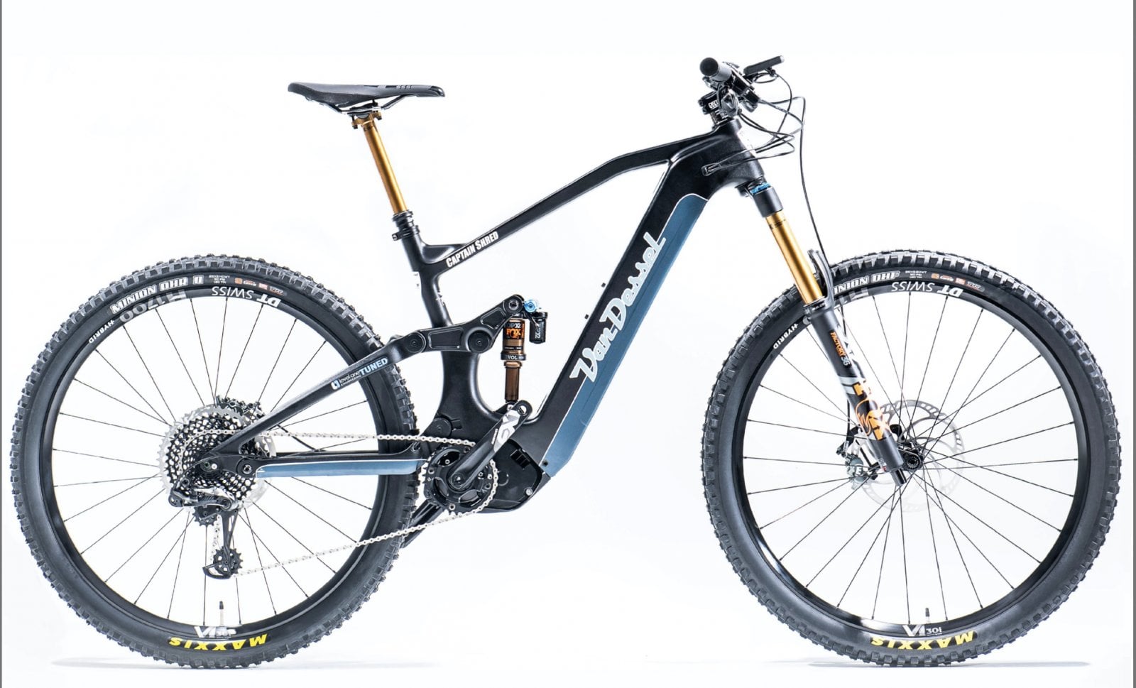

csm_FLYER_E-Bikes_Uproc7_650_Fullsuspension_AnthraciteMagmaRedMatt_6768x4230_5d53984dfb.jpg
I wonder if you can get away without the tensioner.
For full suspension, a tensioner is somewhere between highly advisable and essential.
For example, Flyer have a E-14 Panasonic GX bike without a tensioner.

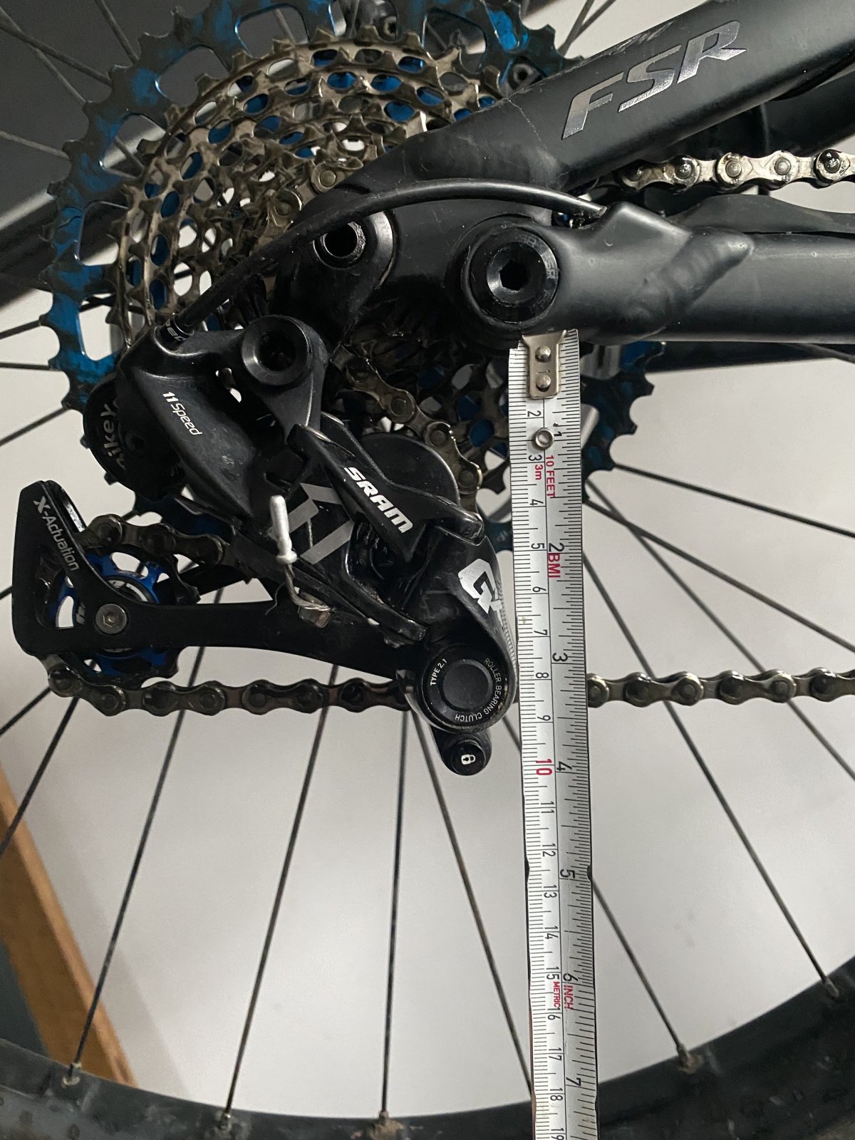

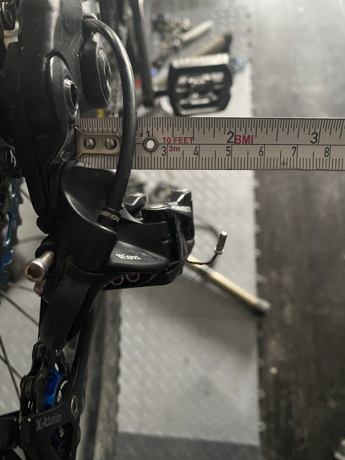

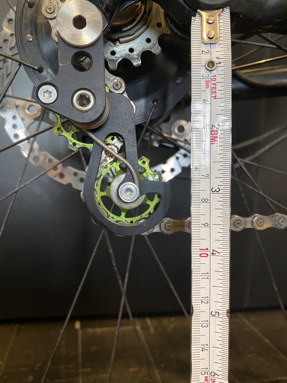

On the specialised the chain grows a fair bit, on mine as I’m running 200mm rear. I think it was almost 90mm.
I have looked into different tensioner types but in the end the current Rohloff one suits best without hacking up the bike.
The Rohloff DH tensioner hangs down the same as a standard gx derailleur on top gear. On the biggest cog there’s 90mm extra drop, so yeah massive difference. From the side as you can see the tensioner sits inside the chainstay.

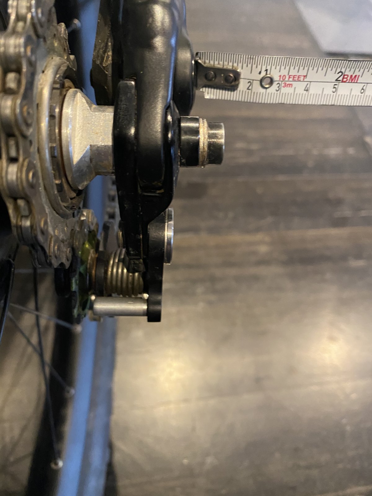

I tried to purchase a rolhoff to self install on my Trance e+, but after several weeks, I gave up.
The Trance is apparently .5 mm too thin at the axle insert, according to the measurements sent to rohloff (through a third party) for consideration.
The Rohloff is not a through axle, and requires a special mounting kit.
Rohloff would not sell me a hub for a Gaint Trance e+, even with a reputable dealer handling the order?
I can imagine that you aren't happy with that, as I can imagine you would have made it work somehow. I'm actually impressed with Rohloff's response though. Many businesses would sell you something knowing it wouldn't work for you - without knowing that you could make it work. This suggests some pride and that they want to see success stories with their product, and that they are also trying to avoid trouble. I think that is pretty unique in this era. Most things have their limitations.
So the dropout is 0.5 mm - a bee's dick - too thin? If the axle diameter is the culprit, I think that could be easily solved. Everything required is here:
https://www.rohloff.de/fileadmin/user_upload/Rohloff-A12-beide_Messmethoden-EN-27102017.pdf
If it's a no-go then maybe have a look at the new Kindernay XIV for 12mm Thru-axle.
Yes. It's the drop-out that's too thin. I was drawing a blank when I typed that up.
I may still try a kindernay one day, but seriously since I found that 10 speeds are pretty durable, my quest for a better drivetrain ran out of reason.
I might wait for gearbox bike, or save my allowances and get one that ships with a rohloff.

After destroying one derailleur system too many on the Levo early this year, I decided to go back to the Rohloff, and infact sized it all up with their measuring kit and went through that process, but then found the Kindernay, and its 12mm through axle seemed the simpler system, despite my fondness for the Rohloff.
Either way, Rohloff or Kindernay, they are both very durable systems, and while the Kindernay has yet to prove itself as well as the Rohloff in terms of durability, due to being a new product, my feeling after a winter of hard use is that it is strong and bombproof.
The point I mainly want to make is regarding unsprung weight that many IGH critics raise. Yes, it was an issue when on a standard bike and the weight was felt in some circumstances. However the advantages of the IGH outweighted the those handling issues for me at that time.
With an ebike and its extra mass, cush core inserts, 3" tyres and coil suspension, the extra unsprung weight of the Kindernay is not felt. At all.
I ride with a group of five Kenevos and it is a rare ride where one or more don't have drivetrain issues.
Some of these riders do exhibit a lack of mechanical sympathy it has to be said, but to be fair, it is hard to be kind to the equipment once the blood is pumping and the red mist descends....
The Kindernay on the other hand, has performed faultlessly thus far. It never throws a chain, twists a chain, breaks a chain, derailleur, gets bogged/clogged up with mud etc.
It is easy to get hung up on weight, especially unsprung weight, but that is no longer an issue in the era of ebikes, imo.
To be fair, it is a lot of money, either way, Rohloff or Kindernay. But everytime one of our group has to repair something, I feel that could have just as easily been me having the problem and I mentally credit that cost against the Kindernay.
It will pay for itself, in time. But until that day, the confidence that I'll never have drivetrain issues again is worth any expense.

How much does the kindernay weight ? Looks like a nice system
Yes it looks very nice & also easily swappable.
When you include all the components on a derailleur setup, including the last century hub especially a durable one, the weight penalty is very marginal or non-existent.
The Kindernay XIV is the lightest full-range internal gear system on the market.
XIV gearhub raw weight (approx): 1400 grams
HYSEQ shifter raw weight (approx): 365 grams (actuator, cables, right and left operators)
SWAP wheel shell weight (approx): 101 grams
+ some peripheral components depending on frame setup
Total system weight for the standard (135/142/148mm) version is approx. 1960g.
In order to compare that with a derailleur setup, one must add the weights of the following parts:
Derailleur(s), shifters(s), shifter cables and housing, cassette and rear hub.
