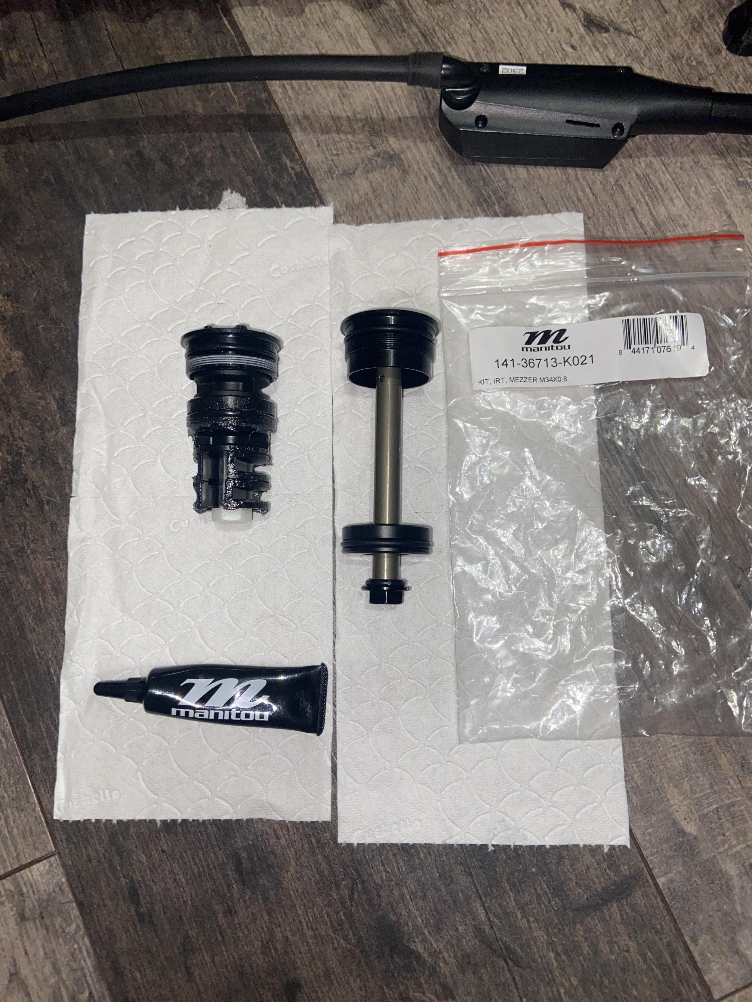

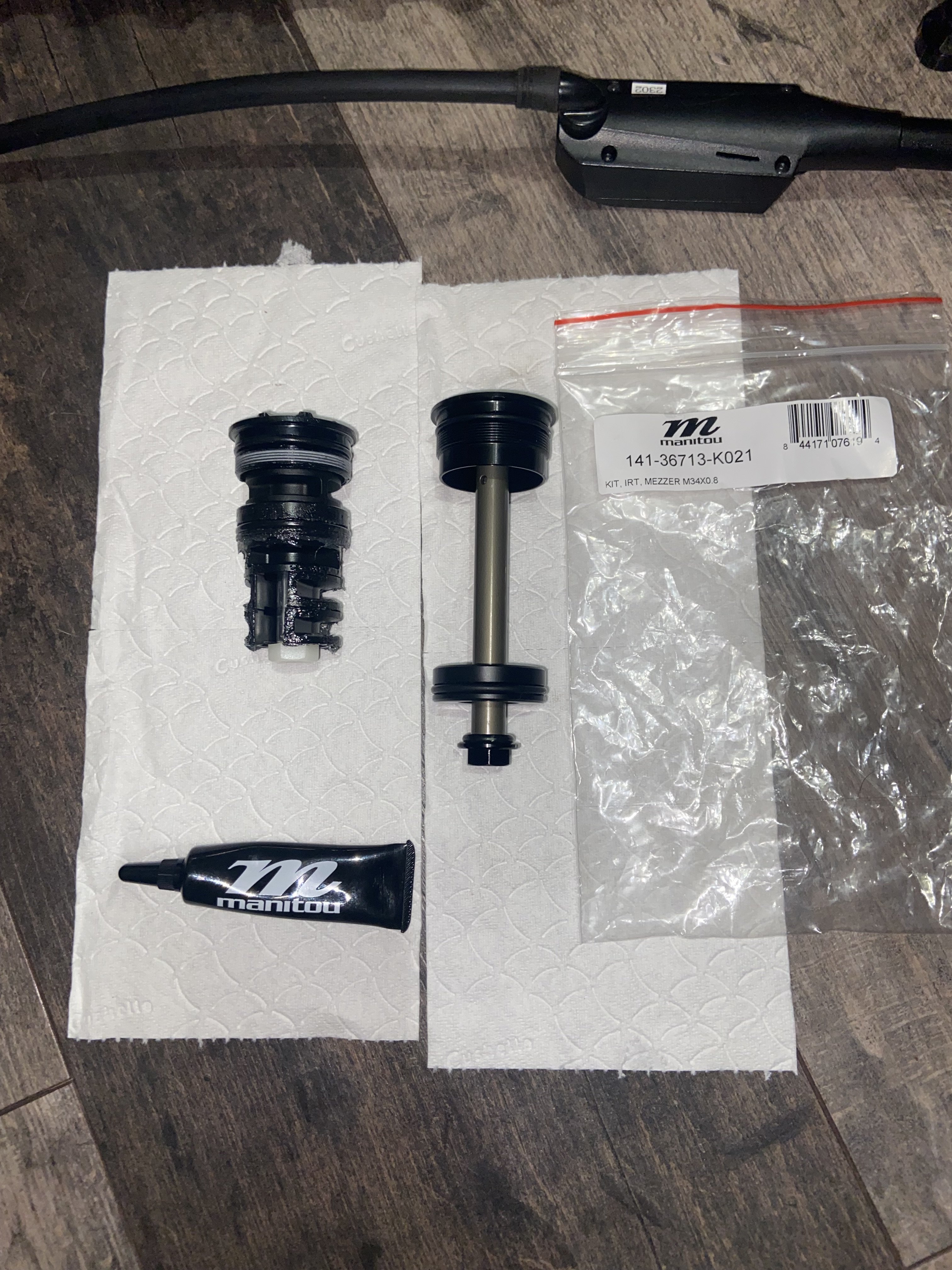

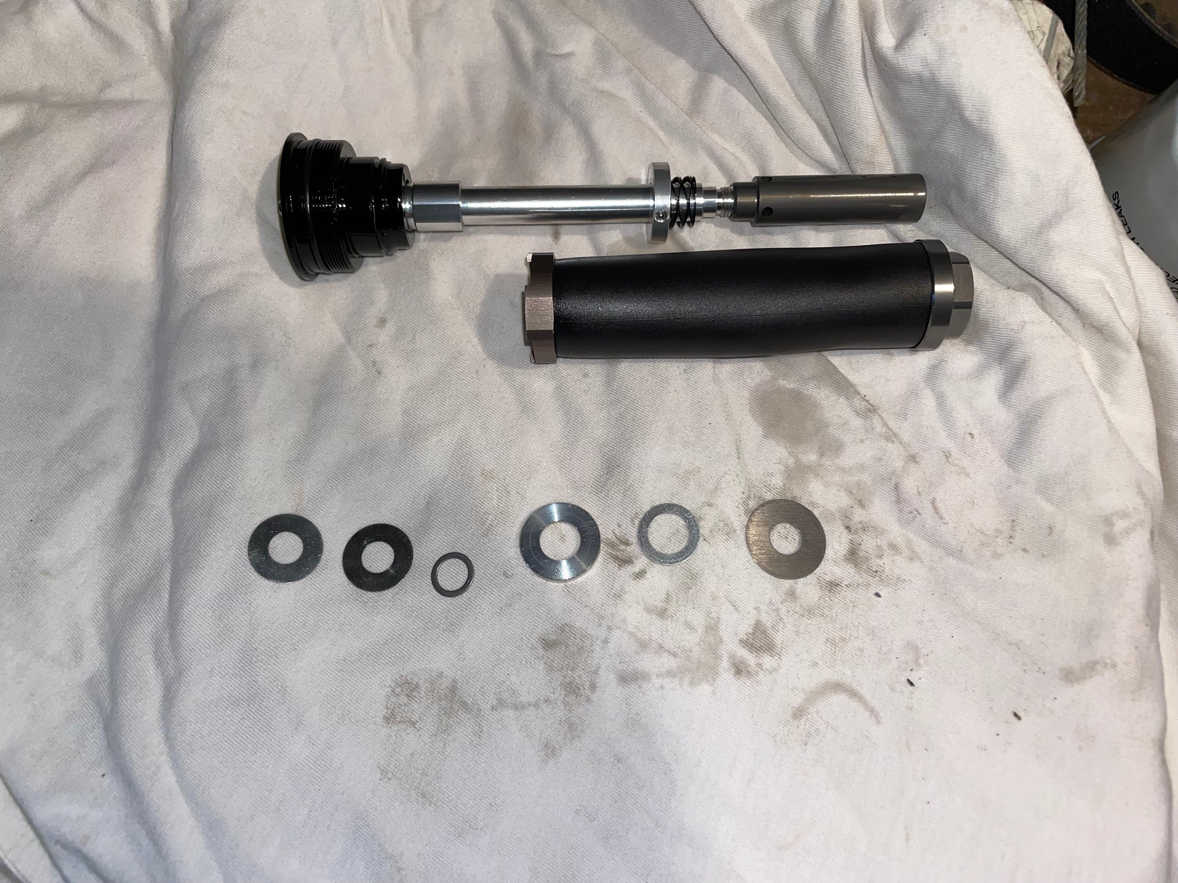

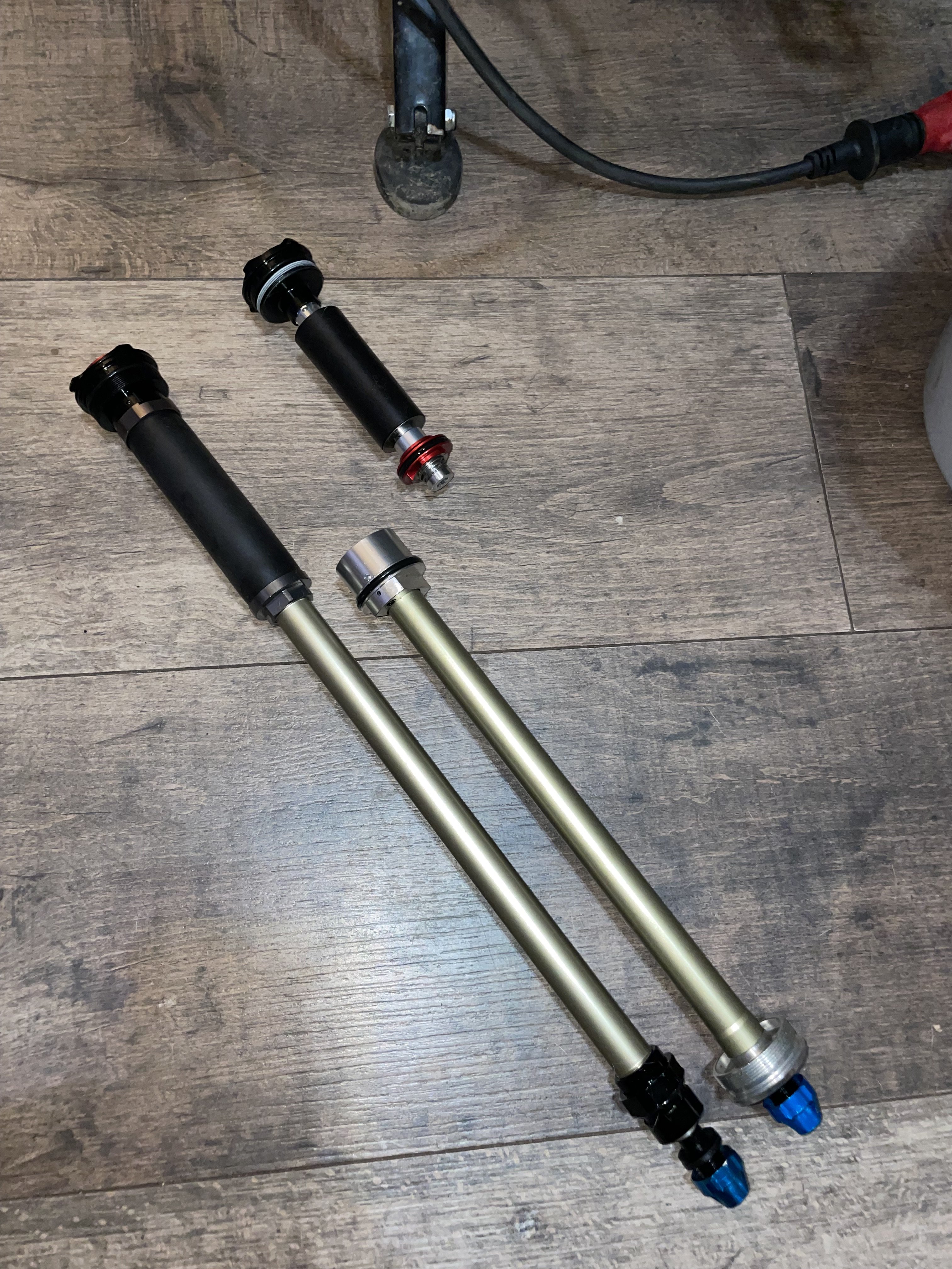

I’ve stripped the compression damper from the secondhand ’pro’ fork to play with the shimstack, on dismantling the shims appear to be in a different order compared with ‘standard’ :-0
Has this damper been played with previously or just badly assembled?
I’ve ridden this damper and it felt good - similar to a new standard damper (that I’d bought to fit in the ‘expert’ forks but not used) I fitted to continue riding the forks :-?
Dismantling was easy and only needed some thought, a few tools & a driptray to collect the oil :cool:

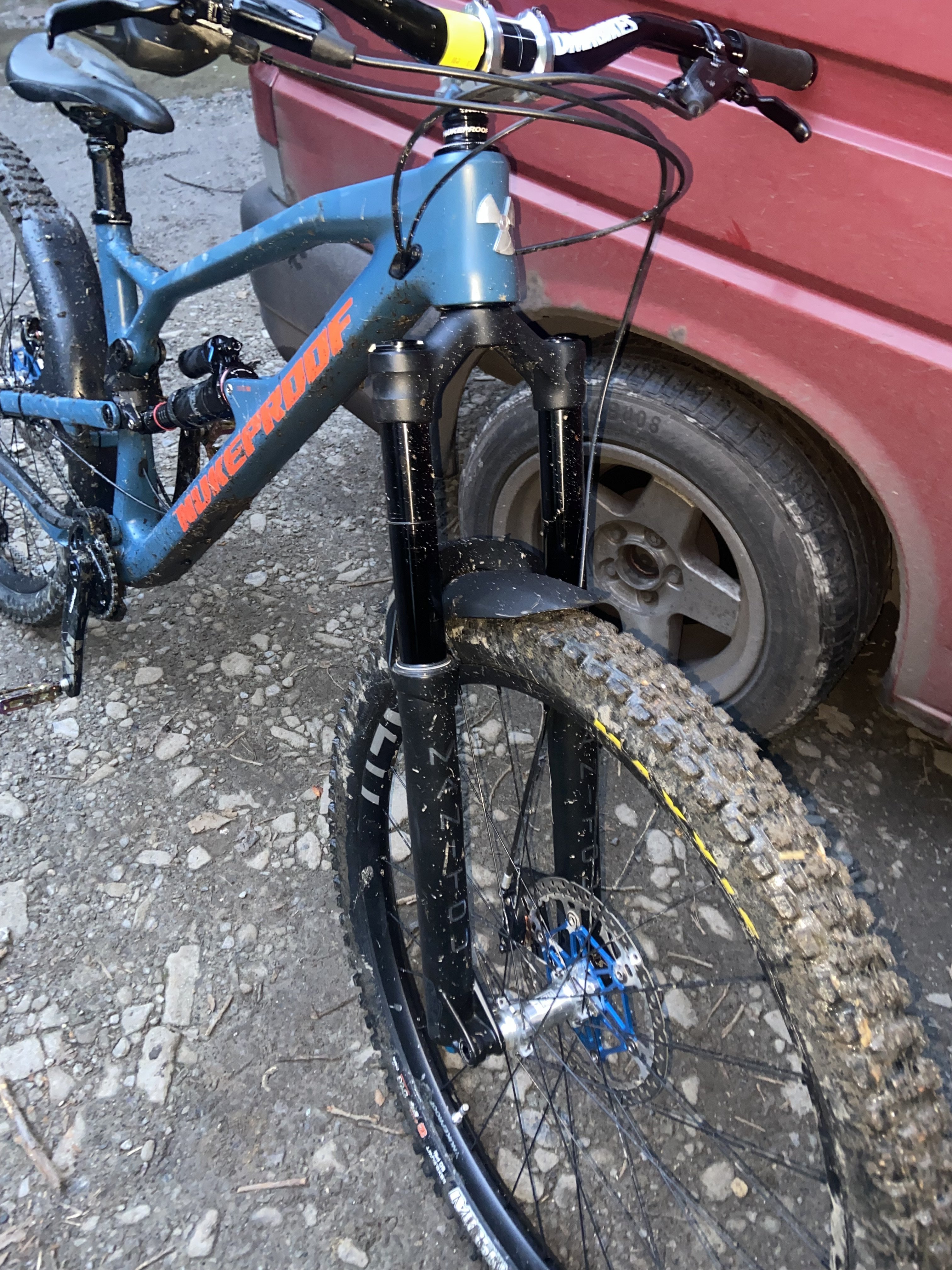

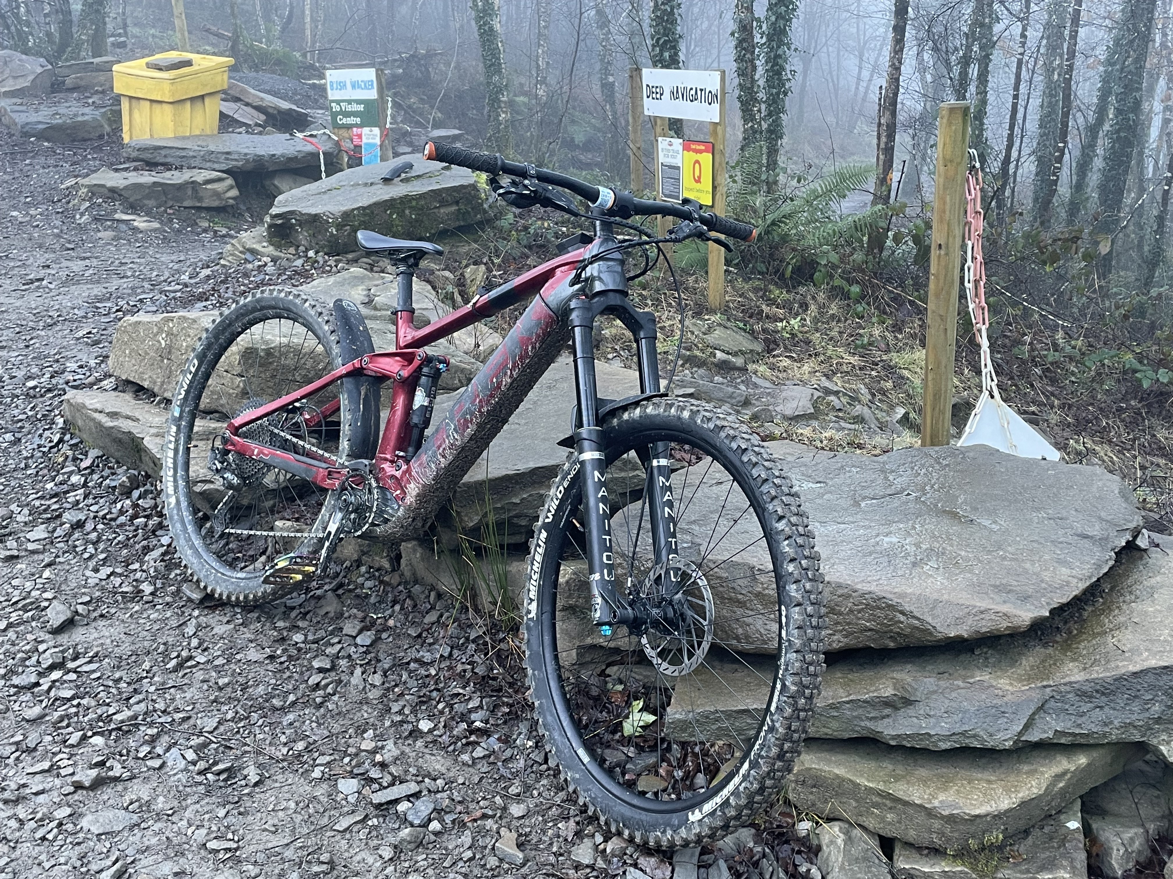

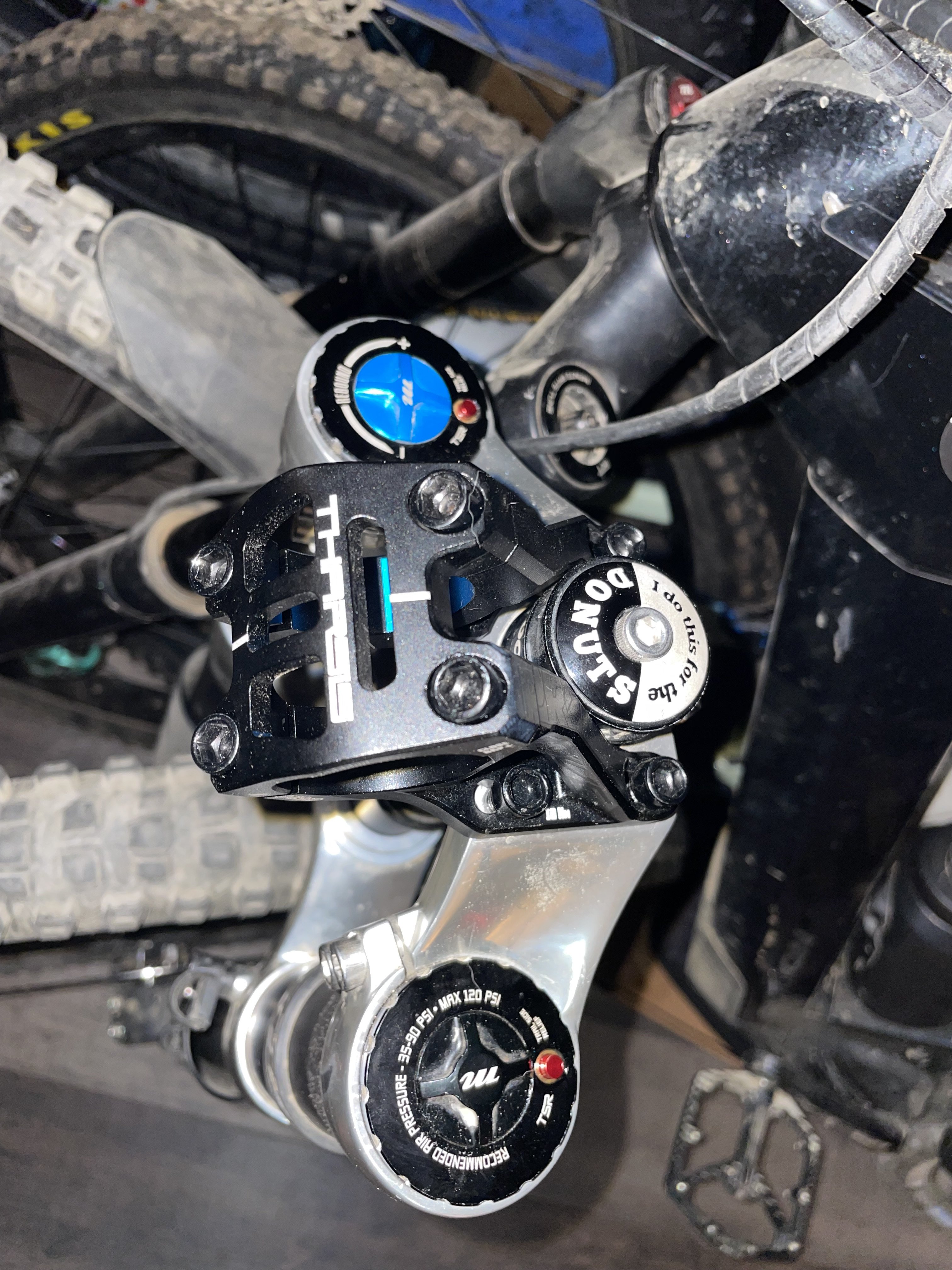

So, Mezzers going back on the rail, the Ohlins don’t feel as nice (they definitely work but have an unknown ’tune’ and need a service - booked in for end of month)
The Ohlins rxf38’s seem to have a very narrow pressure setting window for a comfortable ride and also seem to rely on damping for support, not like the Manitou design 🧐
I’m getting an RS Zeb ultimate somethingorother with 180mm travel as part of a deal next week so can compare against them soon🤔
Ok, I admit I’ve spent a frightening amount of money lately so time to get on the overtime grind….
But the mezzers are definitely staying 😎
Also, I’ve been busy so not rebuilt the ‘spare’ mc2 damper yet, looking forward to seeing if it’s any different but that’s sorta on the back burner as I’ve got to sort the clutch on our LLandrovah as a priority 😮
Bpw again tomorrow for a pedalfest….
Rich.

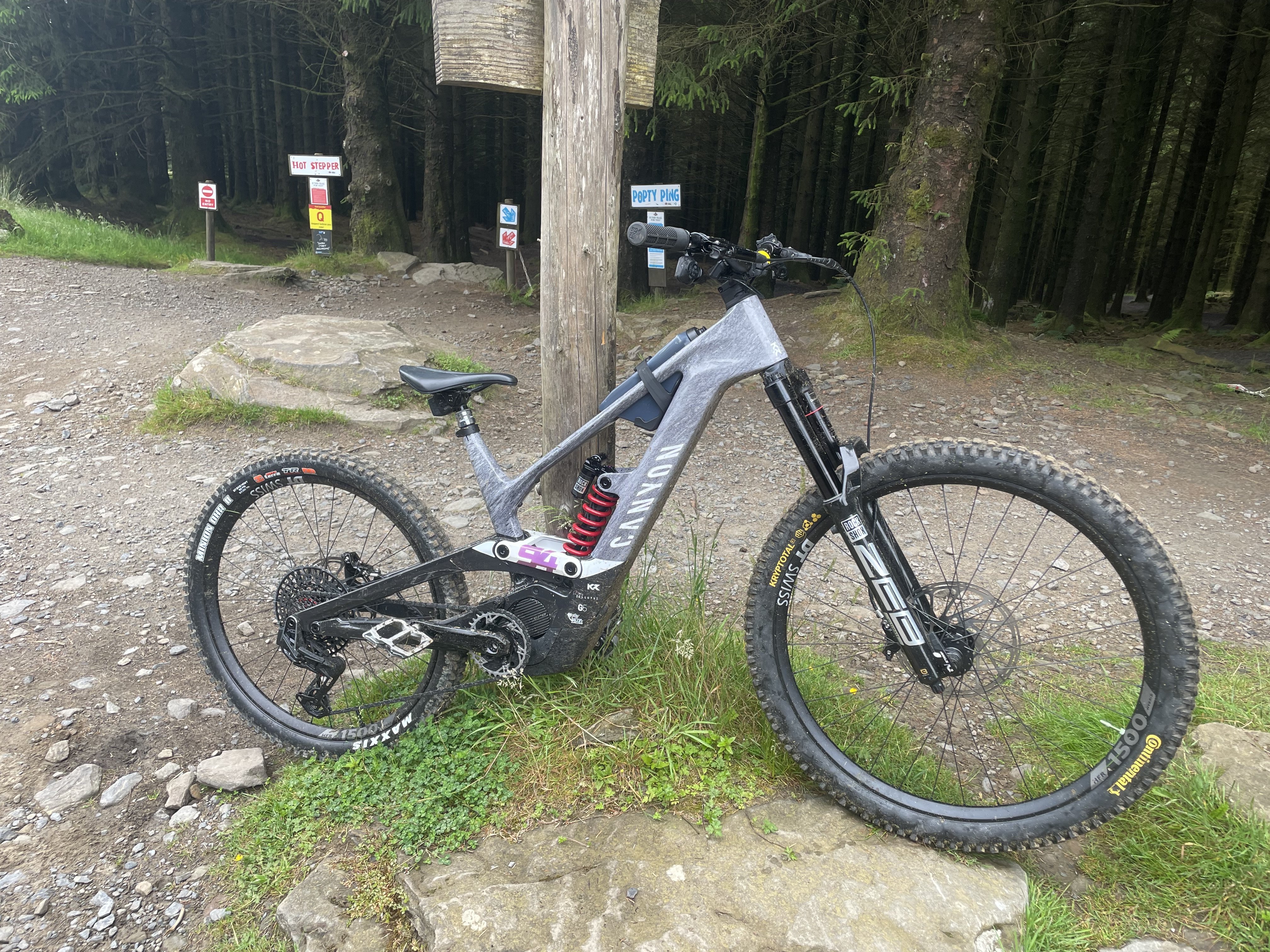

It's back(y)

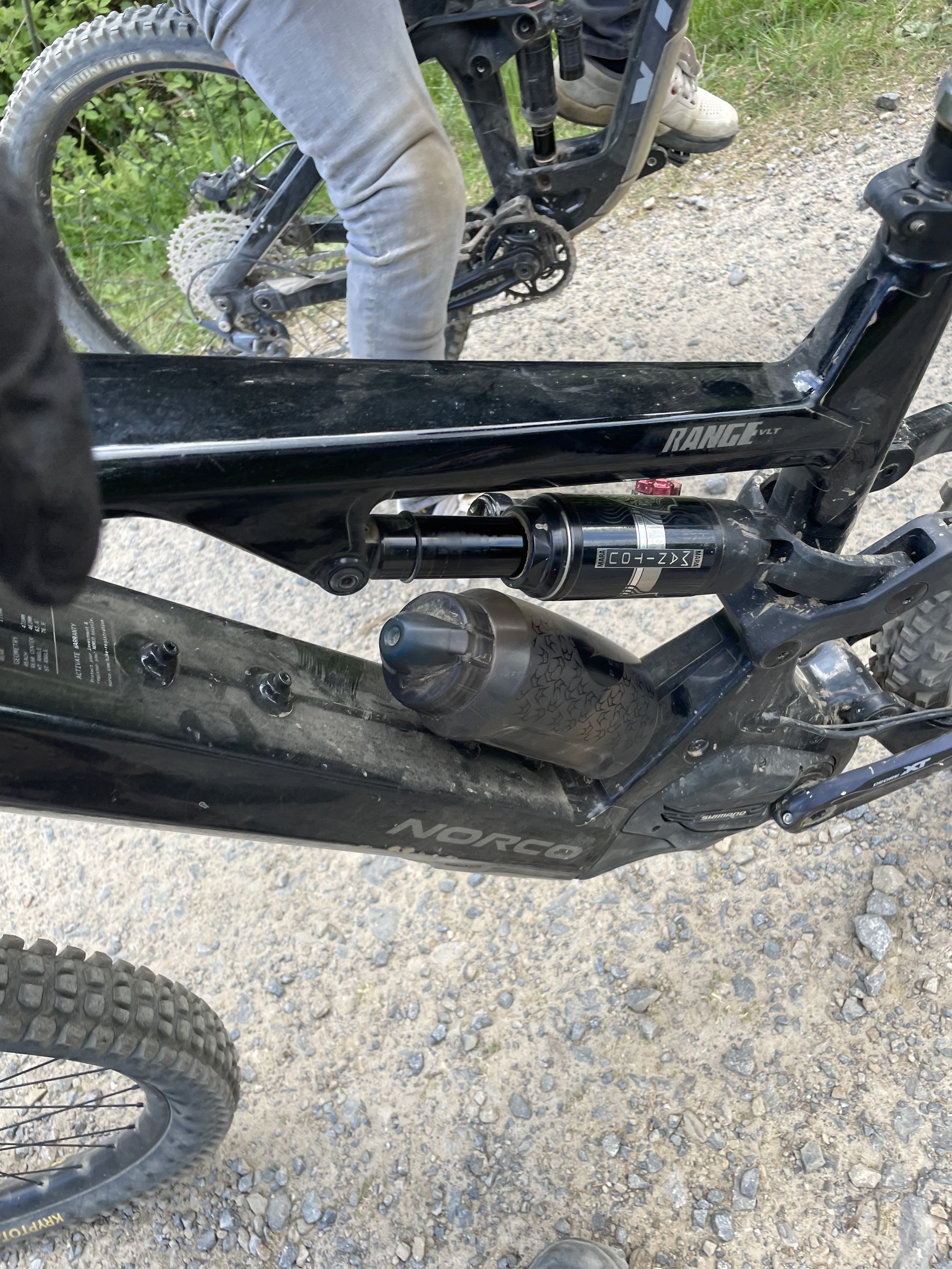

this was this morning, after the 1st battery swap (~11.30hrs, used 2x500wh and a 625wh, about 40 miles across Bpw pedalup & down) I removed the Ohlins ttxair rear damper and refitted the Manitou Mara inline rear damper and was much happier:cool:
I'm somewhat upset that I've not gelled with the Ohlins, Mrs Zed has them on her dentist bike and loves them (also has a bundle of strava QOM's in Bpw!) but maybe I'm too heavy for Ohlins🐷
anyway, maybe I'd better finish the 'spare' mc2 damper rebuild.....

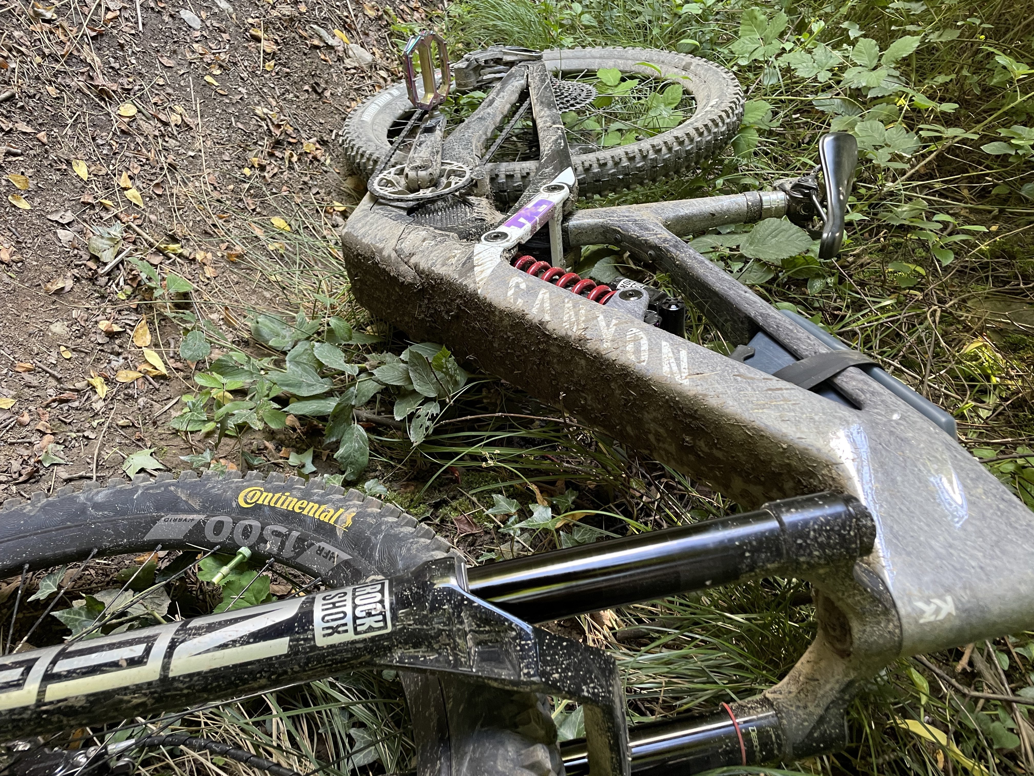

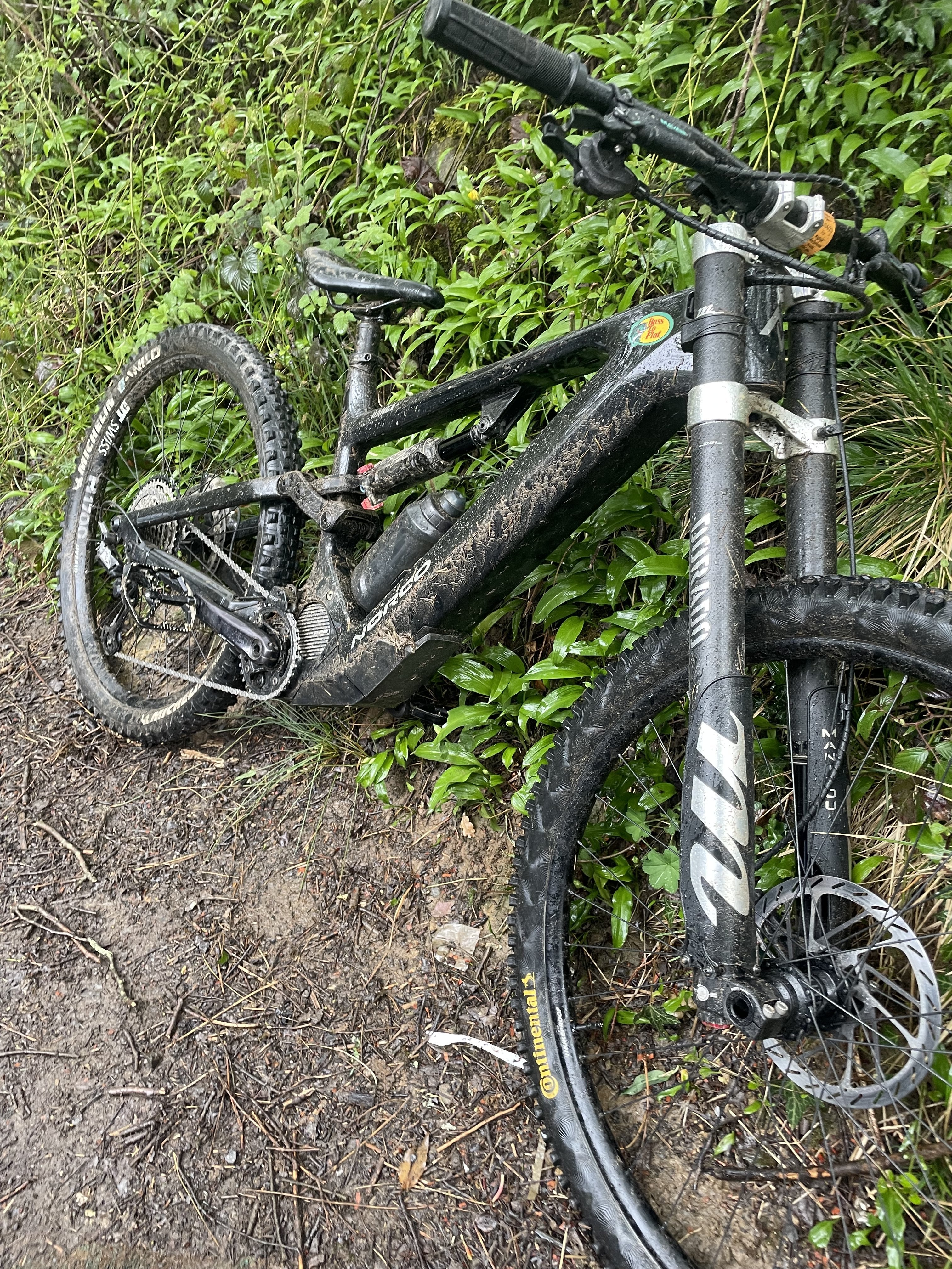

Okay, thoughts on the Zeb ultimate fork….
Ride Bpw Saturday & Sunday with 25 miles Saturday and 20 miles Sunday (blues & reds, jumps & drops / tech)
Still not dialed-in but getting there….
Air pressure 94psi - not using full travel ~160 of 180 available) and springing felt hard but stable…
This is compared to 69 psi main/neg on the Mezzer, next ride I’ll drop the Zen down to 90psi and see how that goes.
Damper is good but needs some fiddling to improve, first day was nice on bigger hits but small chunk it was a bit busy - I actually lost hand contact with the handlebar grips at one point and that was an extremely interesting experience 😮 - I take credit / blame for that as I was fiddling with settings!
More rebound added and it’s improved…
Interestingly, these Zeb forks have ‘buttercups’ - basically rubber insulation between the damper / air spring and the lowers so mechanically softened connections between wheel movement and the suspension 🤔
How much this does affect spring and damper activity I’m wondering 🤔
Initial thoughts are a good fork but not as easy to dial compared with the Mezzer…
I’ve also gone to a RockShox coil damper on the rear and again this is taking a bit of getting used to - spring rate has a painful adjustment dye to needing a different spring but this is coming from an Ohlins ttxair2 (good but hard springing) and Manitou Mara inline damper (softer springing and easier setup as ended up running basically open, same with the Mezzer forks!)
I’m going to continue playing with the Zeb but already missing the Mezzer 🤭
As to the different fork an damper setup, they were standard-fit on my new bike hence my ‘experiment’😎
More fiddling to come next weekend….

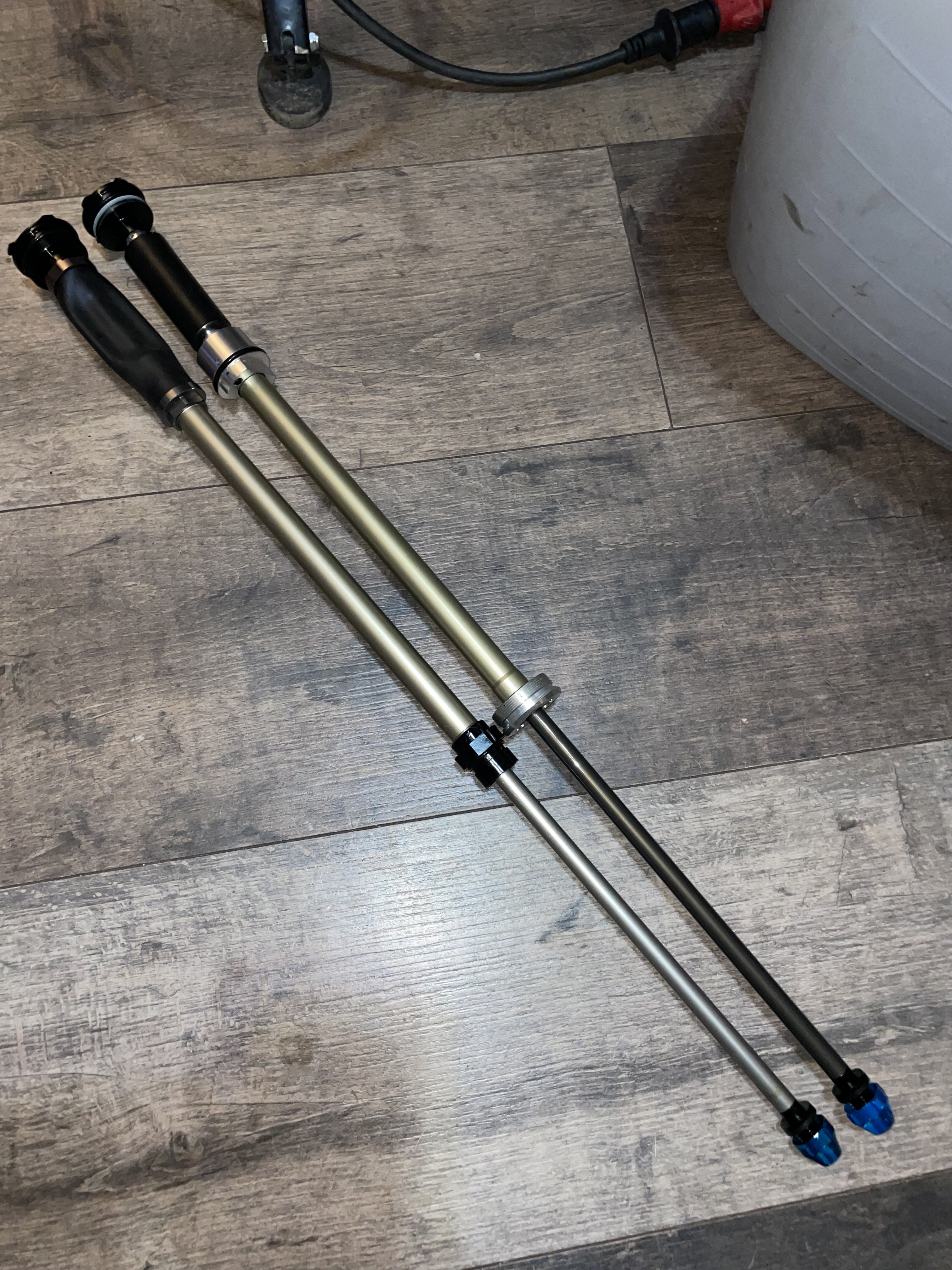

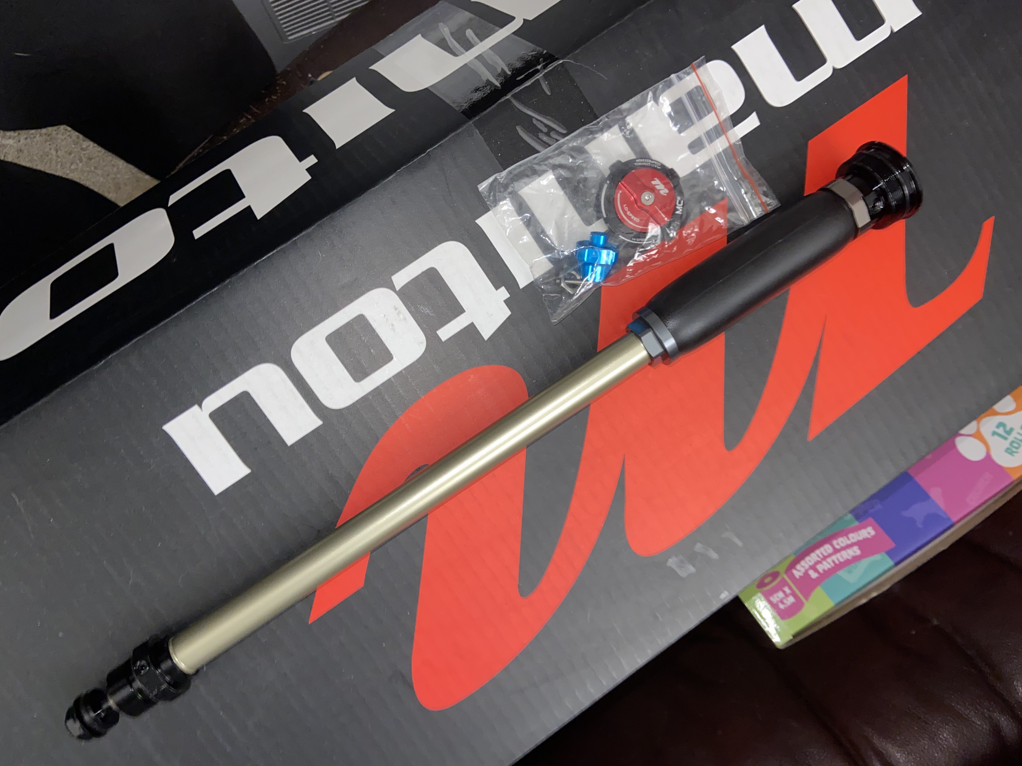

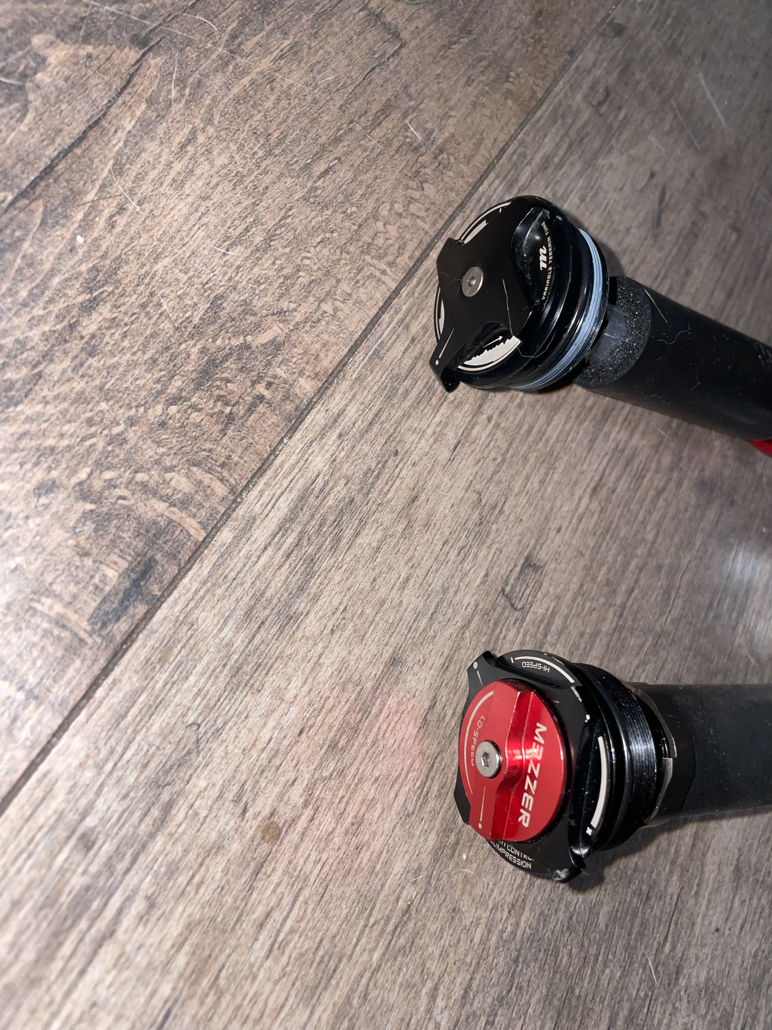

Is the main air chamber the same between Expert and Pro? Just remove the IVA and screw in the IRT? Damper is a direct swap?
the basic chassis is identical between Expert & Pro, the only actual differences are for wheelsize (swap lowers to jump from one to other) and I blieve the csu / stantions hold the difference for offset :unsure:
as to internals interchangability, the iva & irt are a 'one-out / one-in' replacement and as are the dampers (although different designs with the 'expert' being 'open bath' compared to the 'pro' having a sealed cartridge...)
one difference I've read about (BUT not personally compared) is the airspring main piston-shafts being steel for the expert and alloy for the pro🤷‍♂️
guess that would be slightly lighter (y)
Rich.

I've taken both apart, except for the air shaft on the Pro model. I can't push the shaft all the way in to get the cassette tool on the internal cap. For some reason the shaft hard stops about 1/2" from the end of the stroke. The Expert shaft went down all the way flush. This one doesn't. I don't understand what stops it. If I force it, it barely slides 1mm and binds up. Then it's quite hard to dislodge it and pull back out.

Swapped the internals between Expert and Pro. Everything is perfect. Pro air shaft is definitely nicer and lighter. And the Expert's open bath damper is more work to maintain than the Pro cartridge.

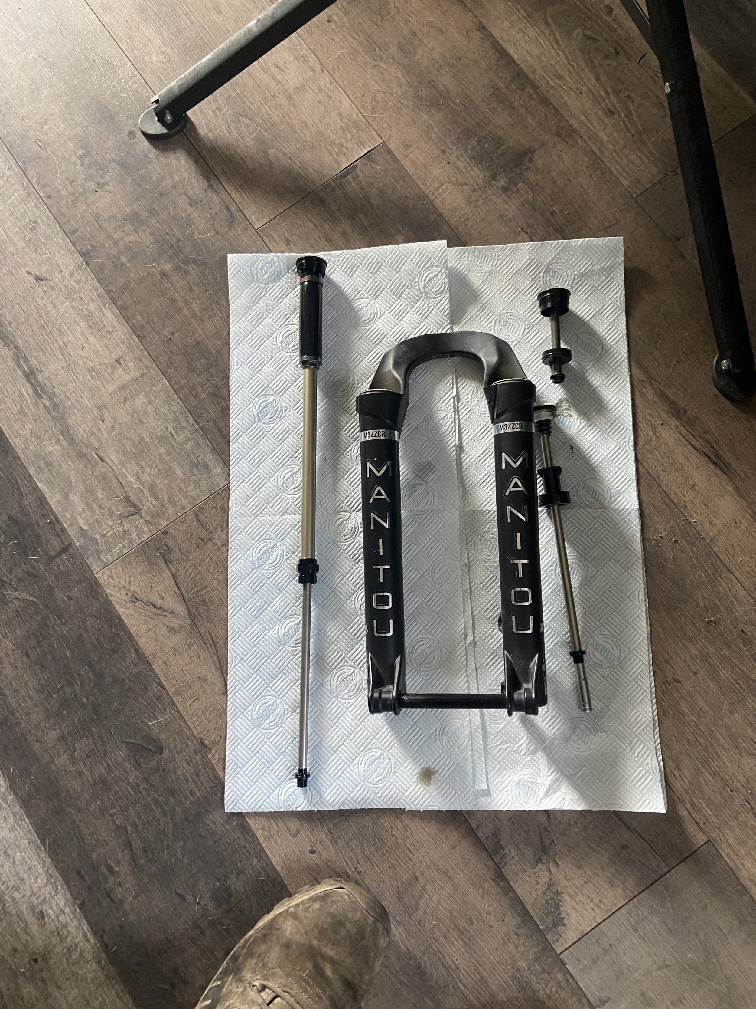

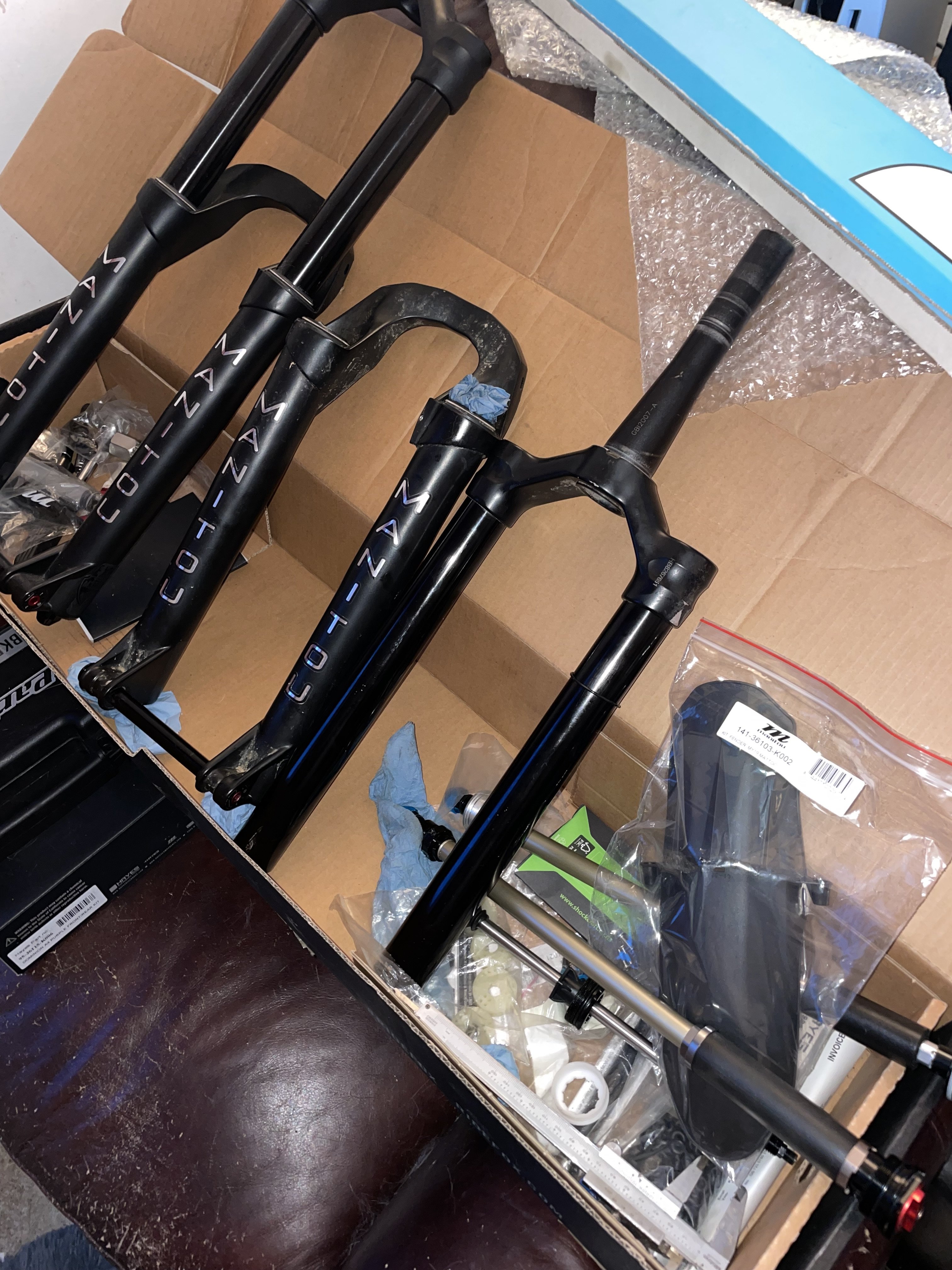

img_6469-jpeg.150933
img_6468-jpeg.150932

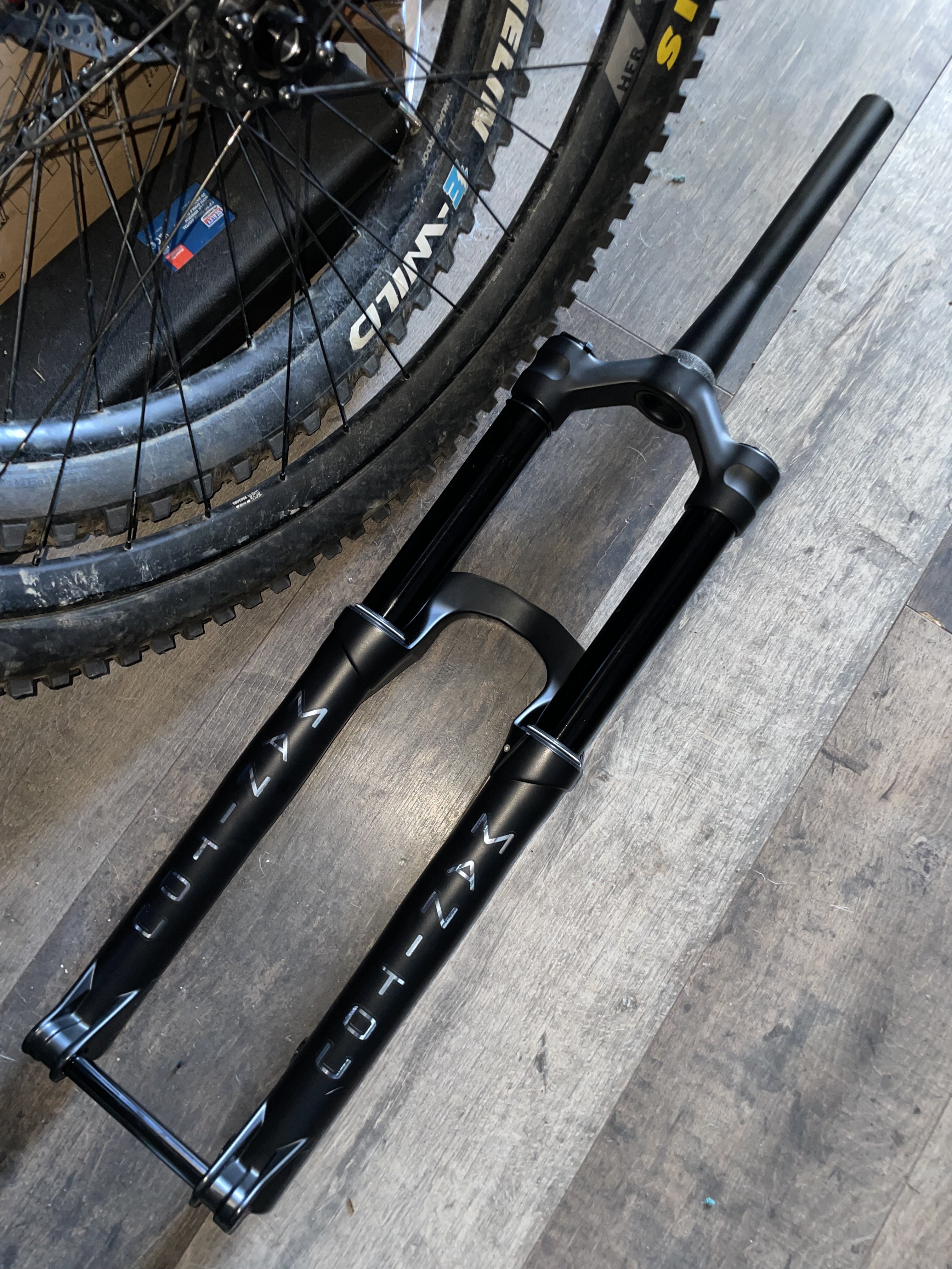

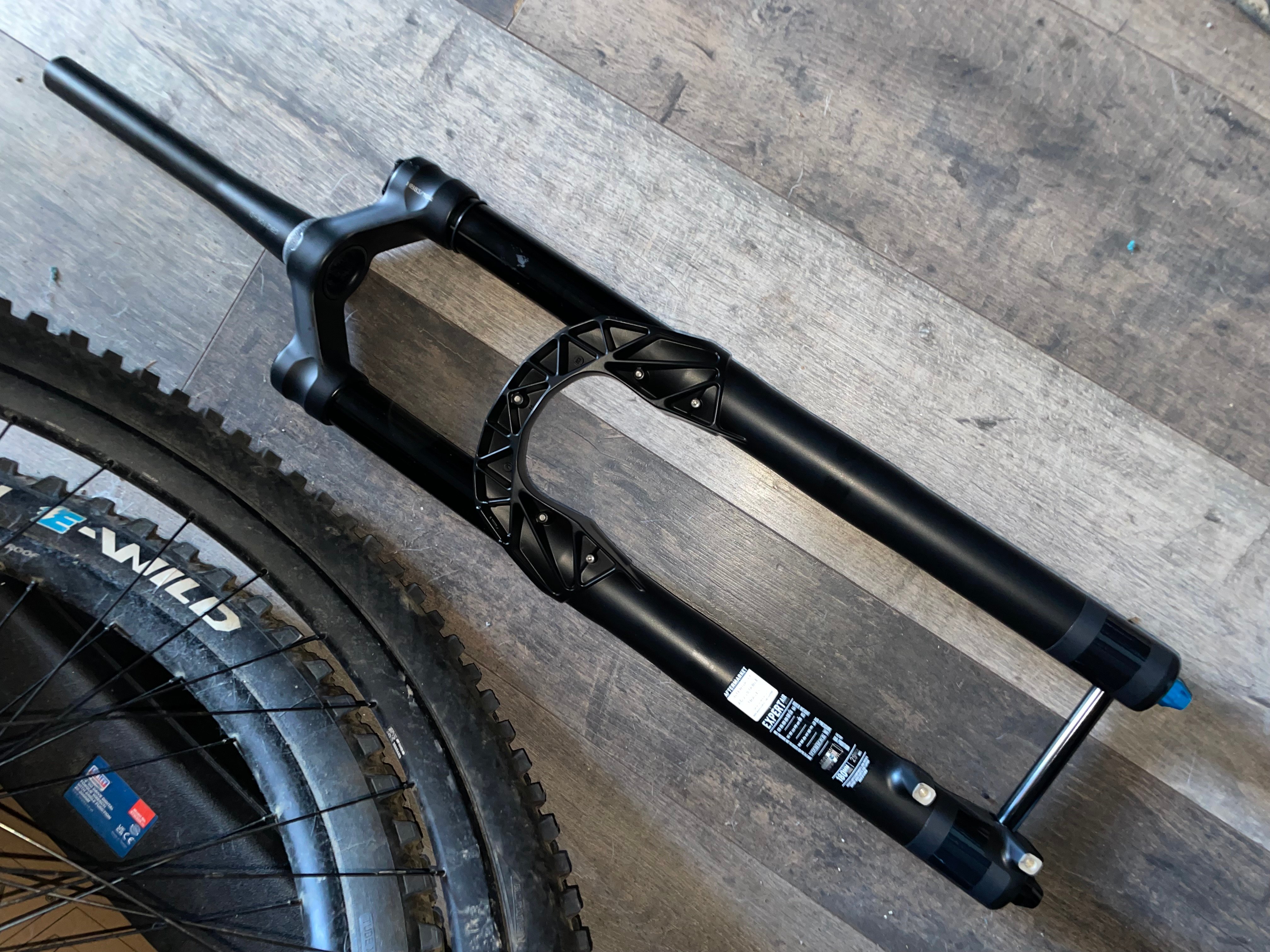

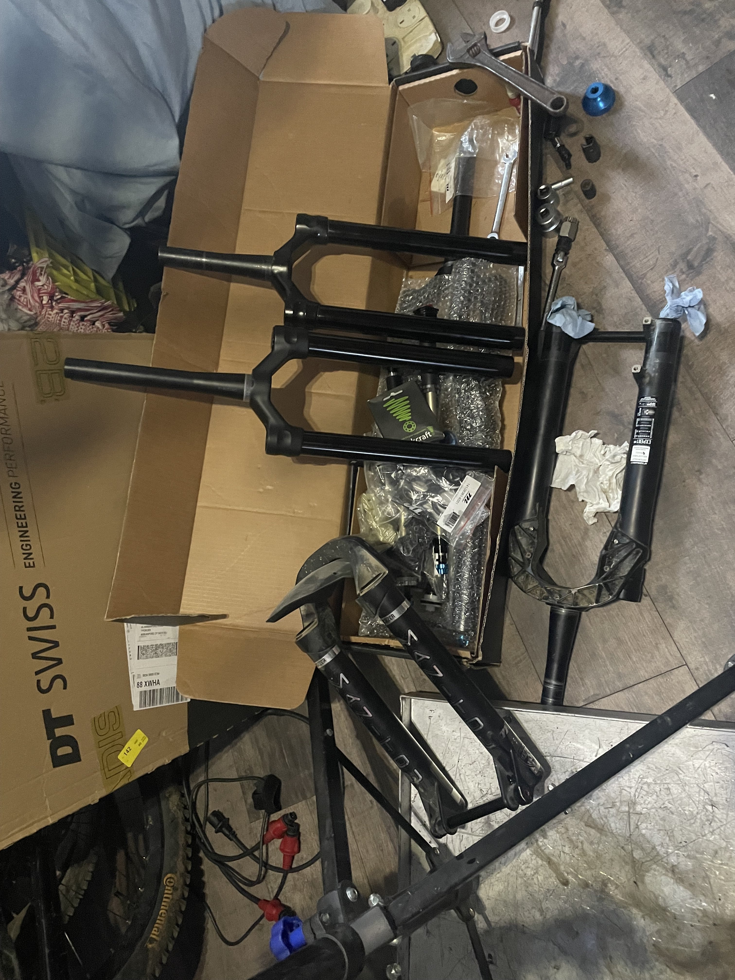

so, collected 'new' Mezzer expert forks from delivery depot (they tried to deliver friday when Me & Al were @ Bpw) and they are as new if not new :cool:
I'll swap out the guts for 'Pro' damper & airside then have an uncut full-length pair for when I eventually need to fit them on the Canyon (battery issues not withstanding🤷‍♂️ )
will then be advertising a pair of Mezzer's with new guts in used lowers & stantions if anyone's interested?
I've also taken delivery of a Manitou Mara 'Pro' rear damper to play with, going to replace the Rockshox coil on the Canyon and see how these are compared to my experiences with the basic Mara on the Trek:unsure:
Rich.

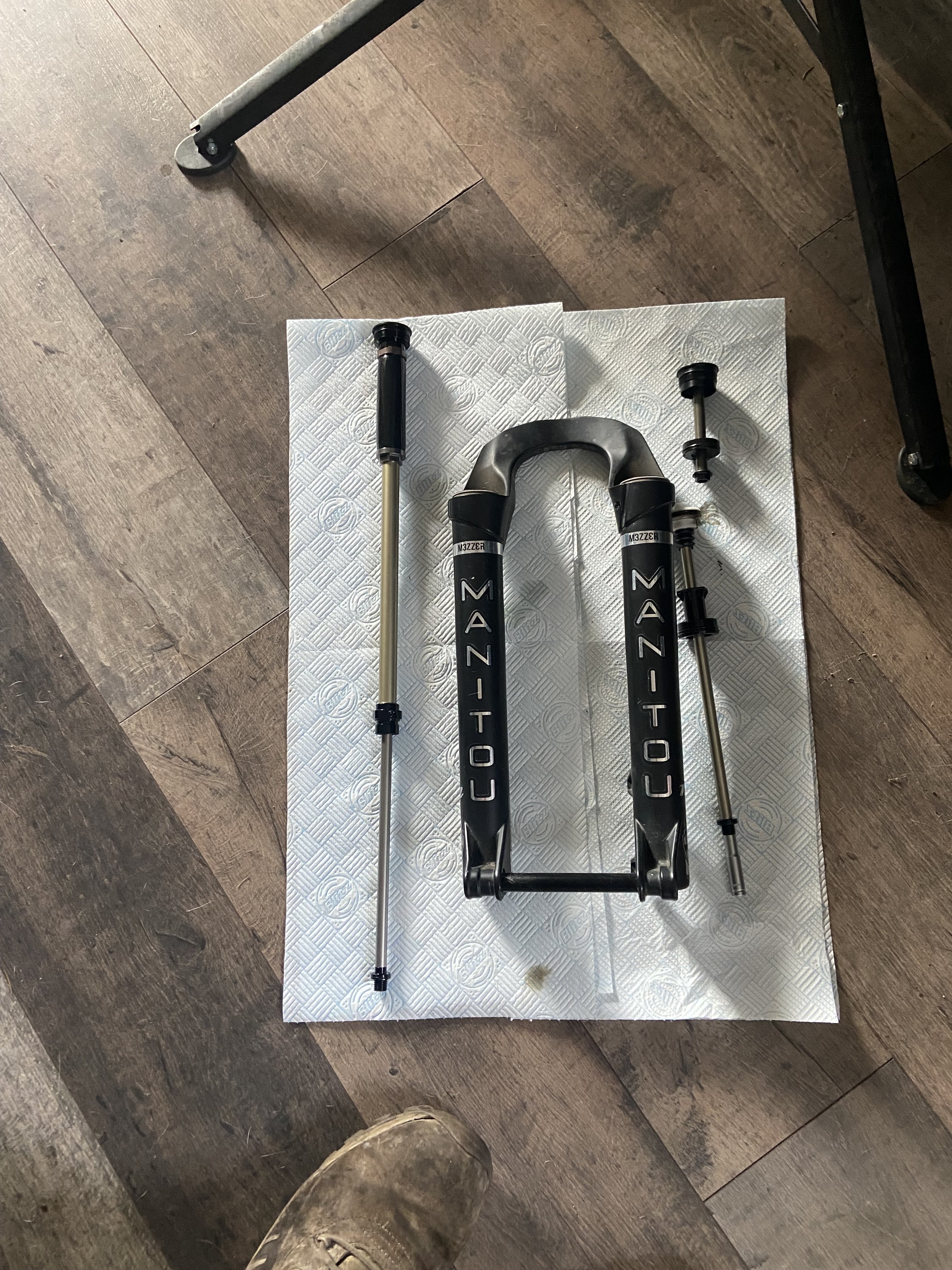

Rich.
