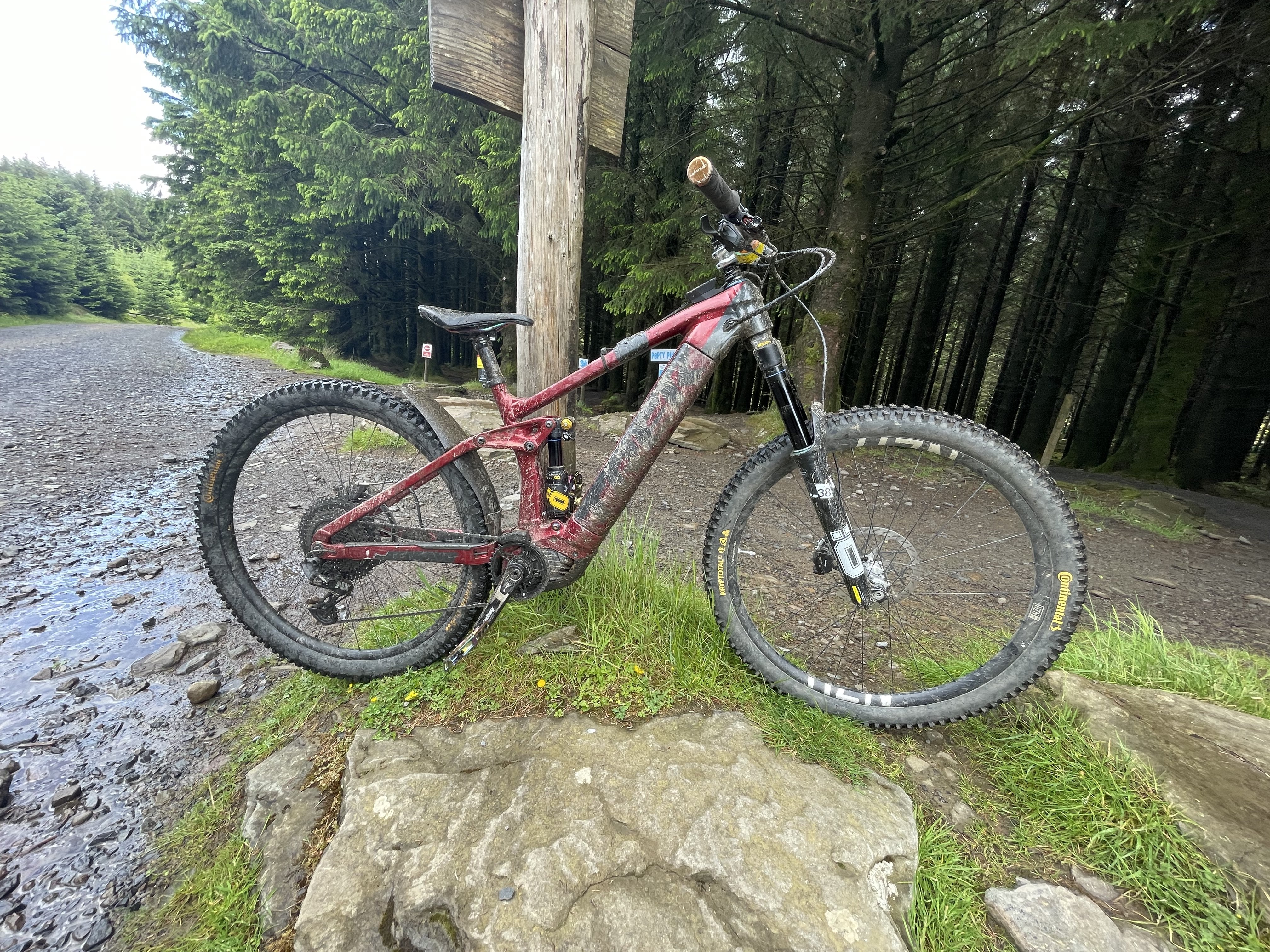

Two days riding this weekend @ Bpw and the jury’s out, admittedly I’ve spent a year riding Mezzers so know what pressures and damper settings work for me - as to the Ohlins rfx38’s I’m still experimenting 🤔
The mezzers were possibly bettered by the Ohlins over small rocks (on fire road pedal up) when the Ohlins air pressures were low on the first day - unfortunately low pressures also had the forks living in their mid stroke so I increased the main air pressure for Sunday but obviously too high, more experiments this weekend…..
I’m expecting there to be nothing if not a minor difference between the forks and possibly manitou having the better air spring 🤷‍♂️
Definitely lower pressure in the manitou for same sag - 65-70psi main / negative / 110 irt compared with 130psi main and 220psi rampup……
As to the damper, more fiddling needed.

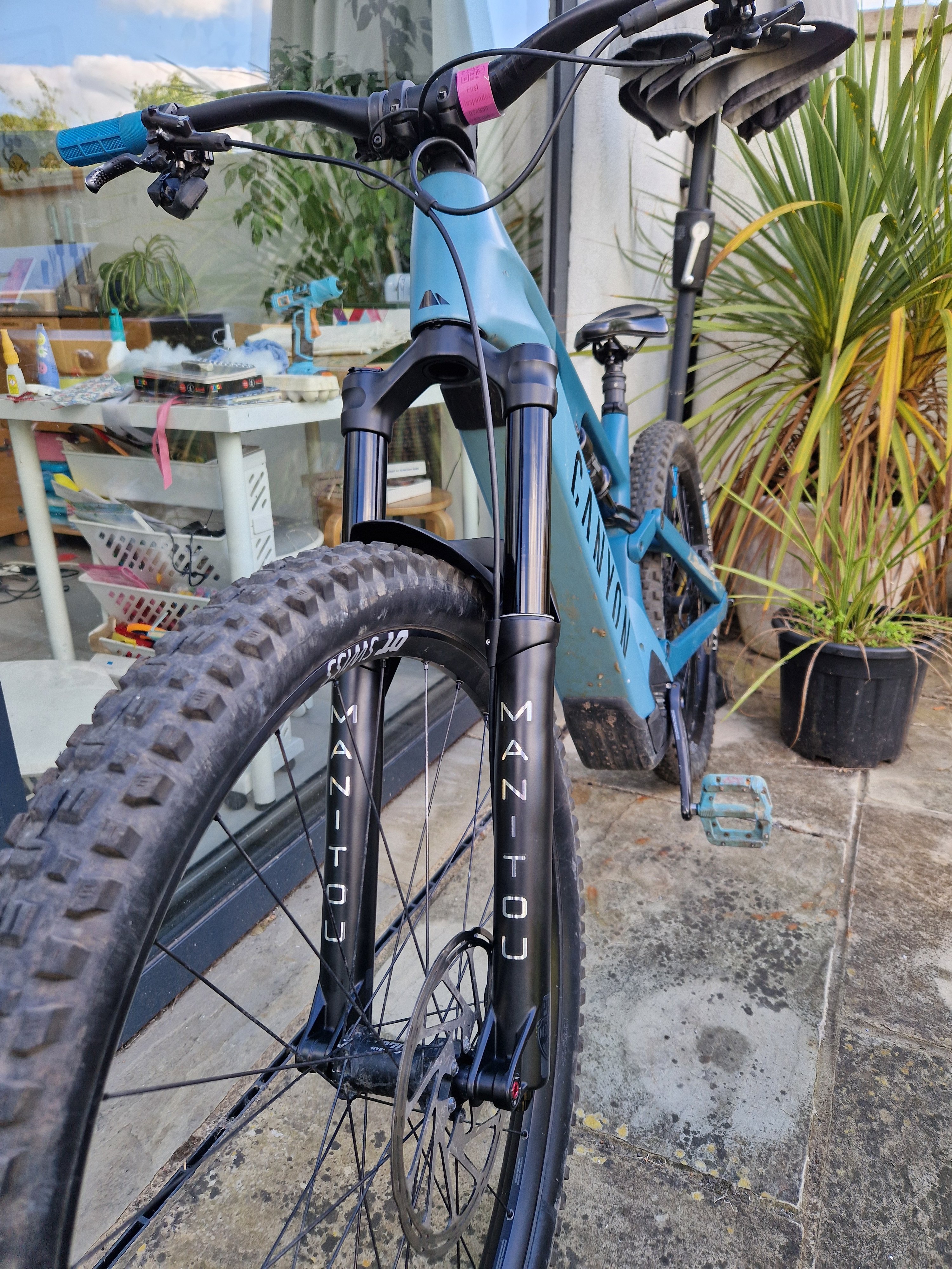

So, these little beauties turned up Saturday morning (after I paid the customs charges o_O). Set them up using the using the CCS86 guide on the google sheet doc and went out yesterday for a bracketing session :ROFLMAO:.
All I did was open high speed fully and had a blast - absolutely love them. Oh I forgot, I reduced to 160 before I went out
Thanks for all the advise @Zed. @Hattori-Hanzo (y)
