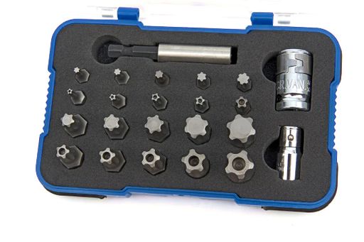

I noticed about 12 months ago about these plus drive torx then realised that was what bosch were using
I will be honest thou before that i thought they were ribe drives which i found was a better fit than standard torx and couldnt find anything better at the time
Now i have a set of plus torx bits £14 for the box and they contain 5 sided ones too that fit the motor bracket plates too so a bonus .
