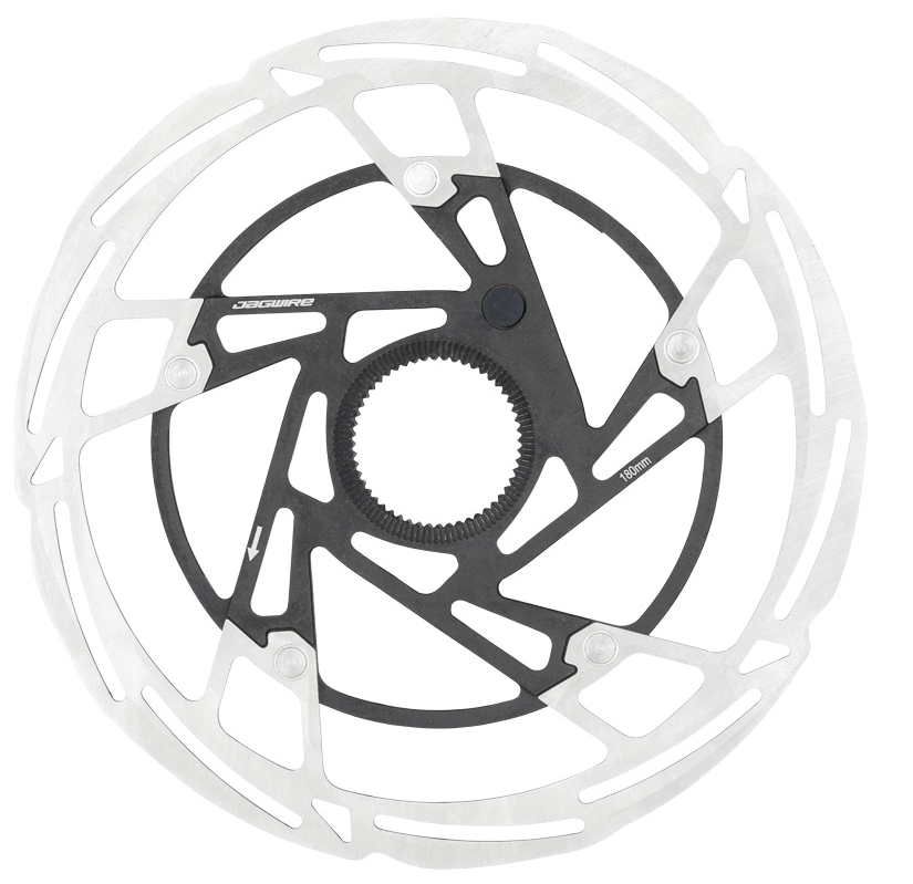

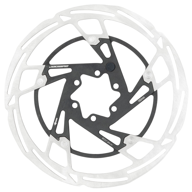

I use these Rotors on the rear and they work just fine - JagWire LR2-E. I use the 203mm version which has a part number of (DCR093) center lock. Available in 6-bolt as well (DCR083) - Usually costs around 85$ USD and are in stock in most places.
If one is gonna upgrade the rear rotor, be a good idea to pick up a SHIMANO SM-MA-F203-P/PM adapter as well (180mm -> 203mm)

Thank you all, I am still awaiting my H30 that's still somewhere in the build assembly... not too sure if the rotor is a 6-bolt or centerlock setup but it sounds like that I can just either buy a rotor with an integrated magnet like the Jagwire LR2-E (6-Bolt / CL) or Shimano RT-EM900 (CL).

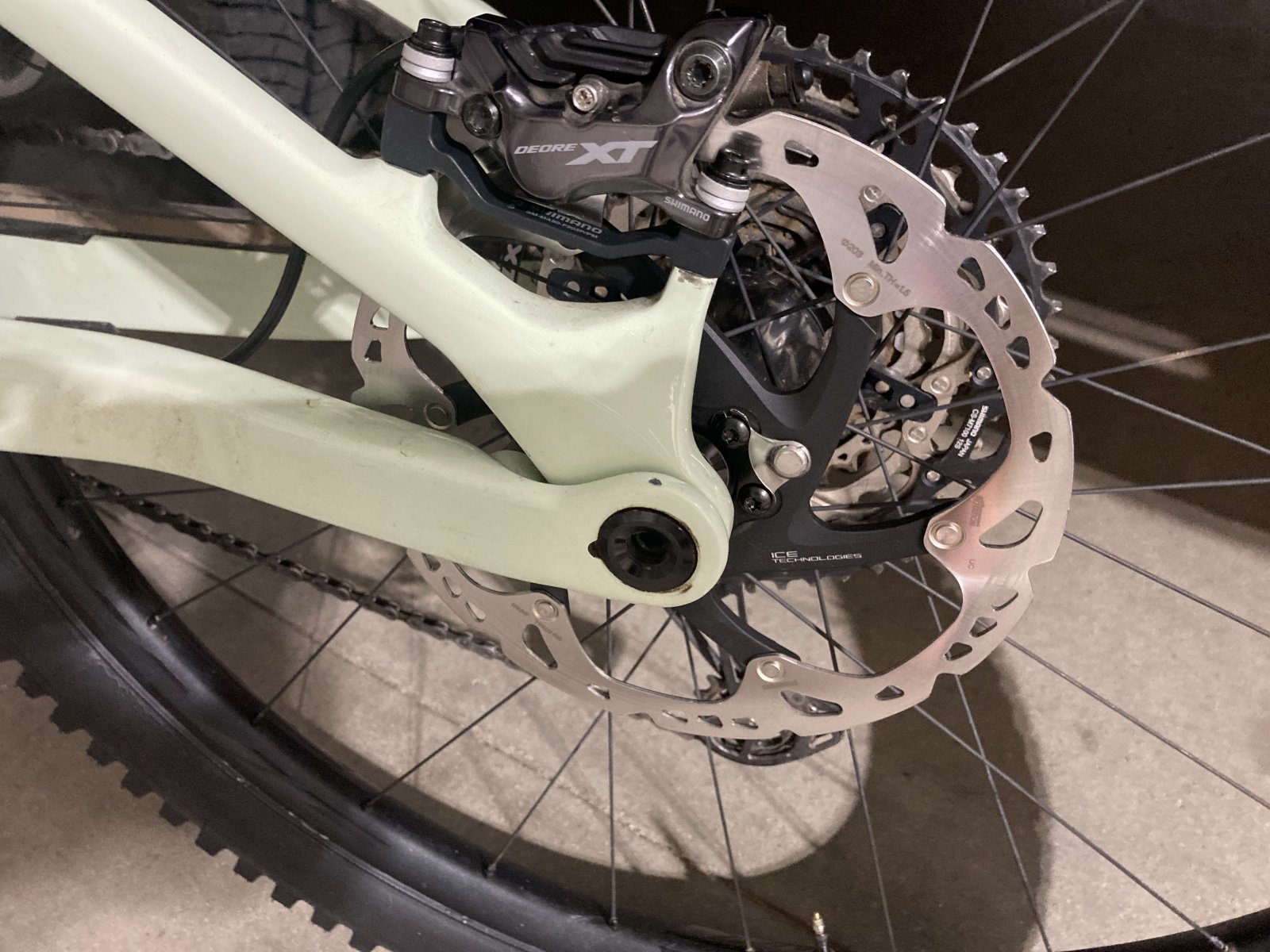

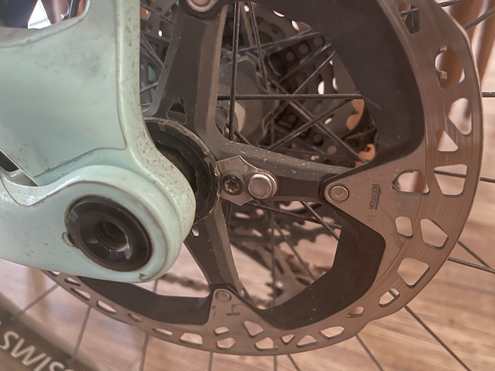

I uprated my M team to shimano ice 203 rotors 6 bolt
I just used the stock orbea magnet and works fine with the shimano rotors
I’m planning to do the exact same thing on my M10. Any chance you can post a picture of your rear rotor and the magnet? My only concern is because the stock Galfer rotor is completely flat, but the RT-86 Icetech rotors are contoured around the bolt mounting surface. Just want to see how the stock magnet sits on the rotor. Thanks in advance!

I answered my own question today. It works perfectly. I put one of those bolt lock tab things underneath the magnet to raise it up a little bit and it sits just right on the RT-86 rotor.
