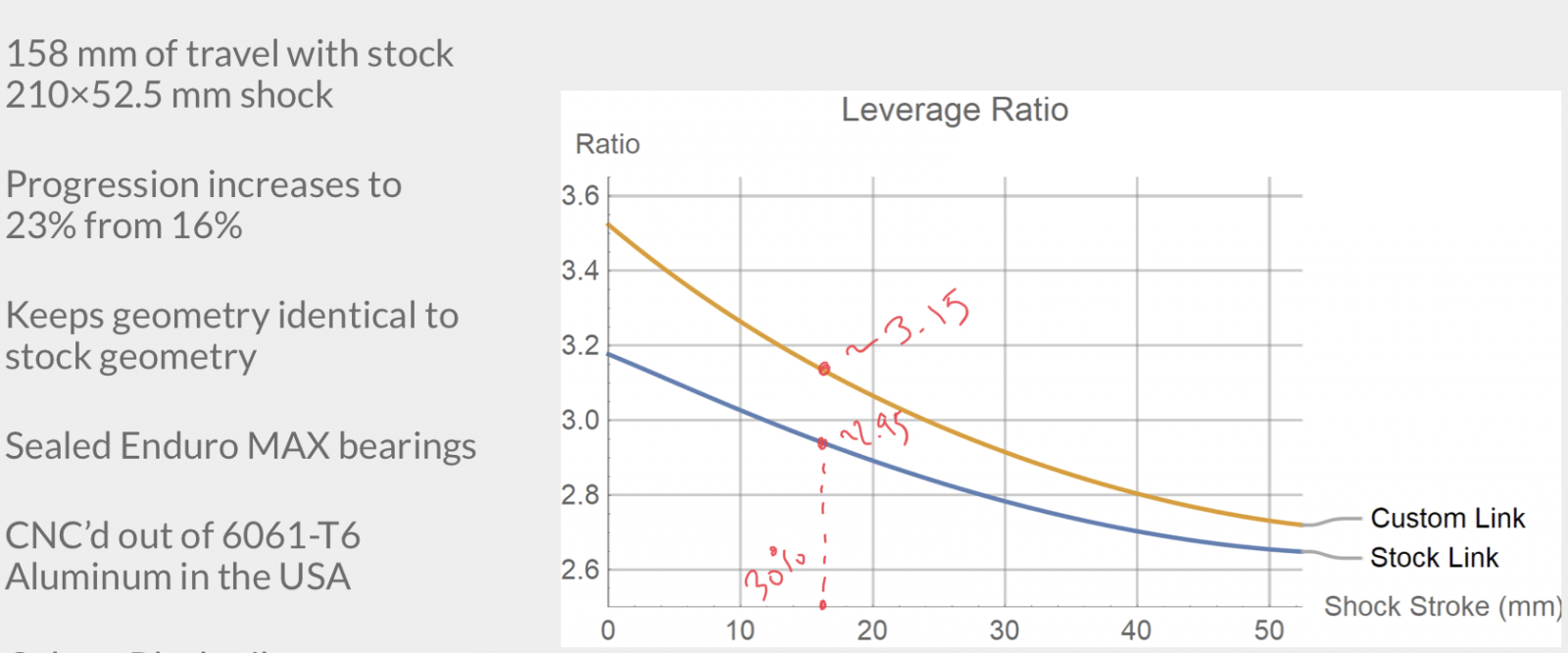

So the CC link is more progressive (23% vs. 16% stock link), but it has a higher overall leverage rate, biased to the beginning of the curve:
At the 30% sag (~ 16.5mm for your 55mm stroke), the leverage rate of the CC link is about 6% higher leverage ratio. Meaning - you will need more force at the shock to hold the same sag position. CC recommends 5% more spring rate on their site.
That being said, if you are thinking that the 600lb spring was a bit firmer than you would like on the Levo, this link could definitely help with that. It will be plusher off the top and not give too much on the bottom out or midstroke, especially if you feel you are oversprung.

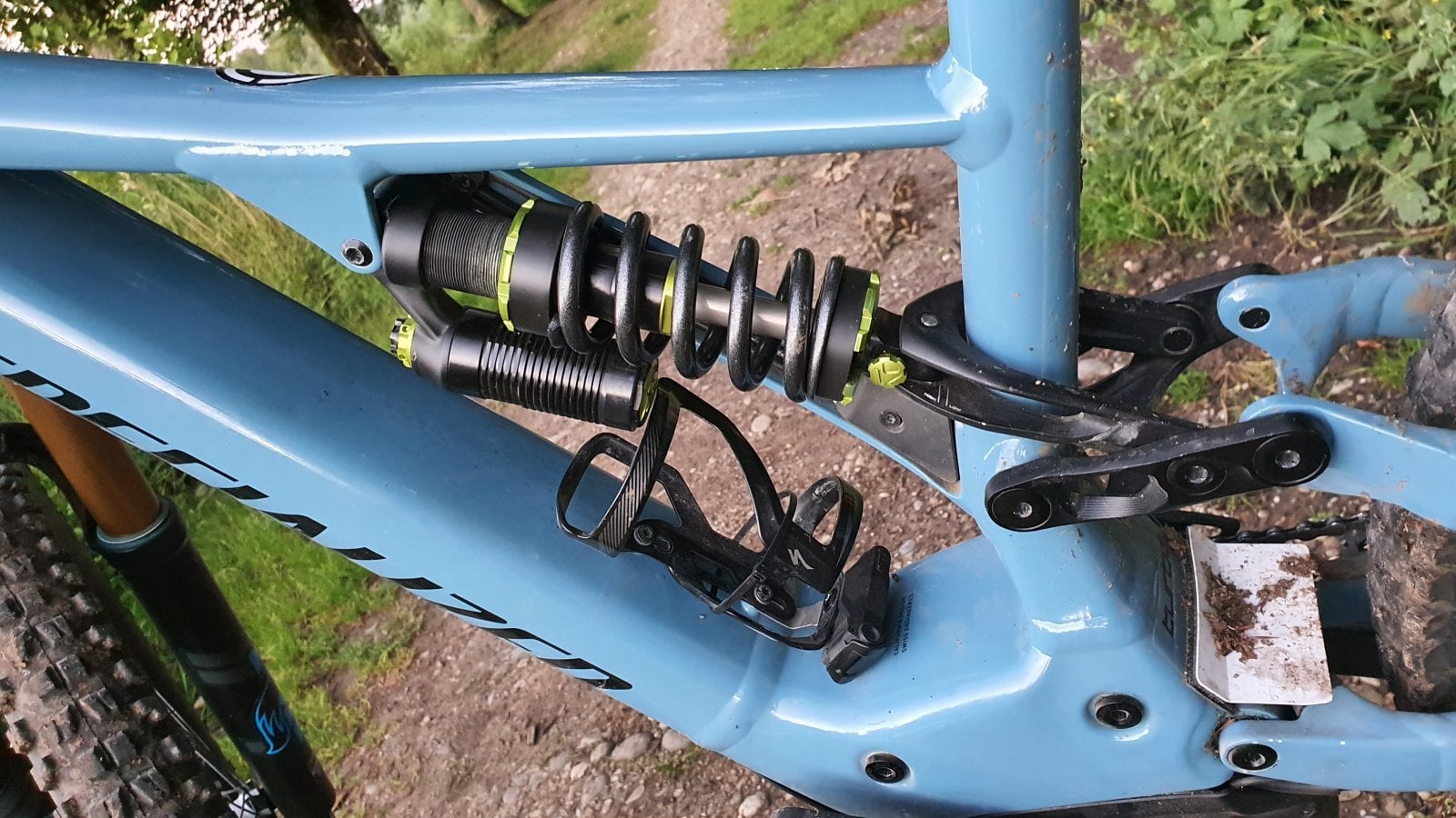

Yes the math makes sense so if the 575 lb spring feels fantastic on the Levo using the stock linkage moving to the Cascade link with a 600 lb spring should work out pretty well. I just want to be sure that with the 55 mm travel shock using the new Cascade linkage I don't damage the frame in any way. I would hope that cascade engineering took that into account when they did the machining on the linkage?
Is it possible to run the flip chip, in high and low setting, with a 55 mm stroke shock and cascade linkage setup without damaging the carbon frame?
You may want to email them to ask. I am not sure what they tested for the Levo. They have limited space to work with the packing, but I would expect it to be ok.
But yes, if it does "touch" the seatstay at 55mm, flip chip going to "high" would help eliminate any touching. Geo becomes a bit less aggressive though, not my preference. Keep in mind too that you have a tad less than a 1mm of shock stroke that is "blocked' from the EXT Storia's fully compressed bottom out bumper (info from Andrew when I was asking about the shock prior to purchase)
