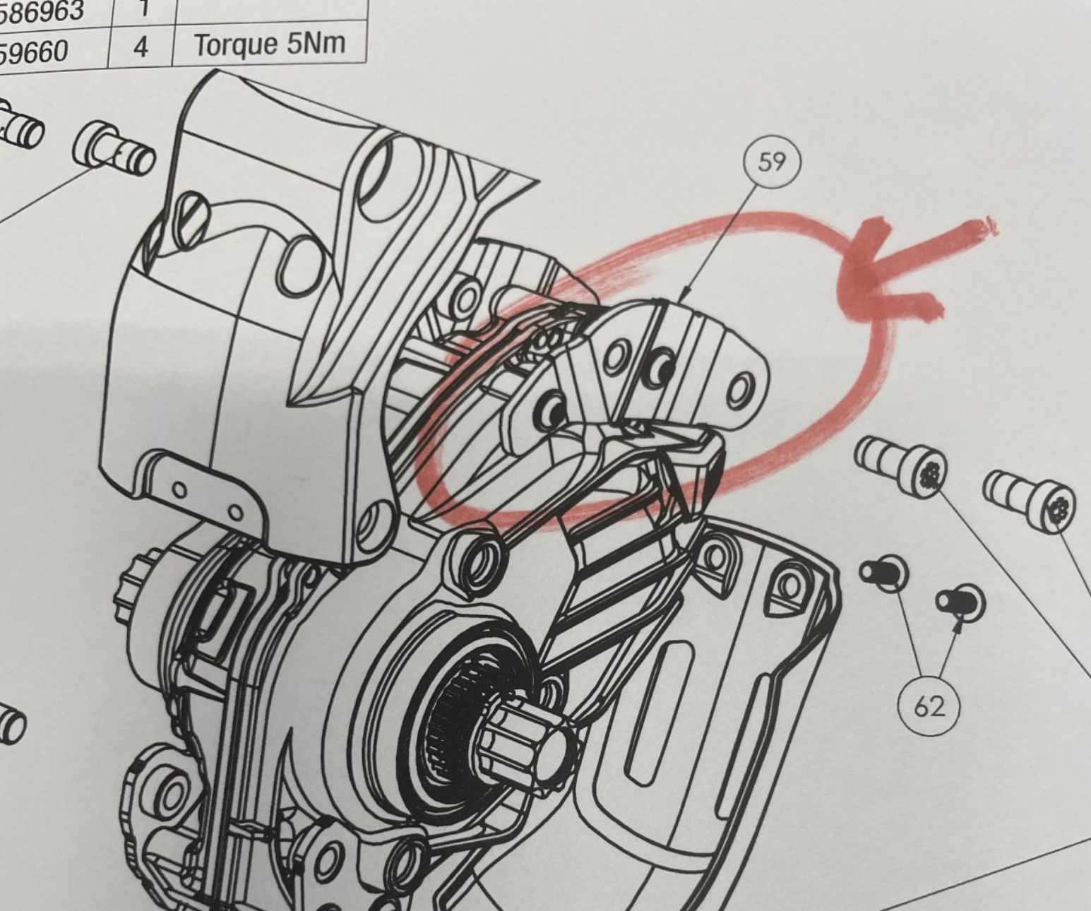

JUst swapped out carbon wheels, and whilst test riding in backyard notice the chianstay was moving a bit while pedaling, then I notice the entire bosch motor was too. not massively but not rock solid. Not sure if its always done this but I dont believe so.
Richiefromboston
Mar 15, 2021
228
121
Boston, Ma. USA
Ok I found the issue, and Im glad I noticed it. the 4 small tamper proof bolts tow simply sheared off. So I was able to remove them But now I have to figure out the exact size or find the trek part number. Its simply amazing I literally just posted here today how I havent had and reliability issues with my not even a year old 500 miles on it rail and this happens same day. strange right. anyone know either part number for mounting bolts or the size pitch of bolts?

I hit trek up on instagram( had good luck there b4) But now I cant ride it. I just want to figure out size get put them in and roll. Im looking up any TS25 5 point star tamper proof button heads I can get here fast. Im just not sure on the size.

No worries Im on it( I think) just sucks was on road for 4.5months been home almost 2 weeks need to get myslef physically ready to roll out again and that what the rail is for, and sadly shes down for now. Luckily I noticed the prob or it would have been bad out in the forest at night, alone, scared and hungry( no pies) you get the point lol all I need is bolt size and Ill be fine. Im not abig bring it to the dealer guy.

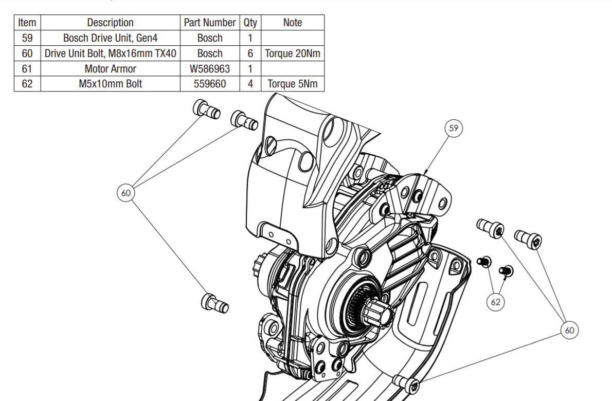

I had a creak I couldn't get rid of. Found out it was those bolts. I can't remember the exact size, but it's a standard metric thread probably M5 it wasn't anything special because I replaced them with some off the shelf ones I already had in the shed.
The torque value is very low for these fixings and my motor mount plates were really badly aligned, I shimmed the plates with a washer or two to get the whole assembly to drop into the frame nicely and torqued the fixings up to something I deemed more appropriate. You can't access them with the motor in the frame, so you have to gently nip them up and do trial and error fitment before cranking them up properly.
Since doing this I haven't had any creaks or clicks from the bike, it's been silent. Utterly appalling QC from trek. The screws are supplied with the motor, I have a hunch trek receive the assembly from Bosch and should line up the mounts before removing again and torquing properly, but they don't.

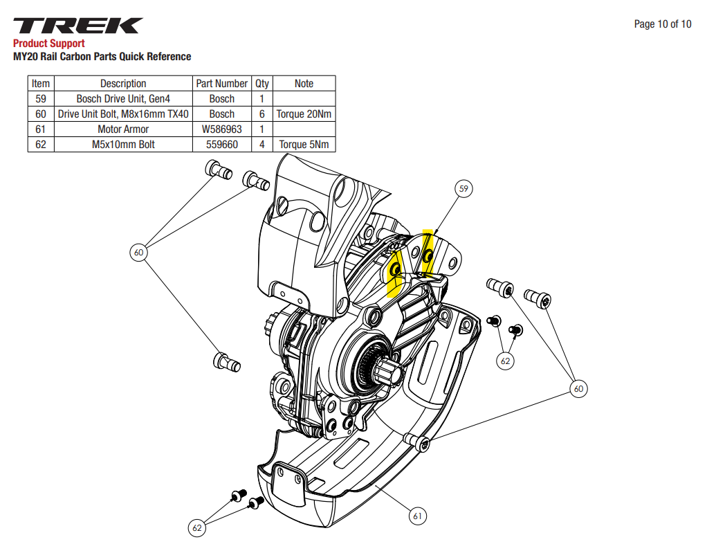

Hey Richie, I have bad news. I'm chatting with our internal Bosch expert to see if we can find part specs for those fasteners. Unfortunately, Bosch has that information under wraps and these are not even listed as a serviceable part for the plates/fasteners*. They supply them already installed on the drive unit. Bosch suggests not to remove/replace them since they are self-tapping and if cross-threaded, you'd need a new drive unit.
I would recommend submitting a warranty claim to Bosch as they will likely send you a new drive unit to replace this one. You can submit a claim through any Trek dealer, not just the one you purchased the bike through.
*Also, just for any onlooker reference, the fasteners in discussion (highlighted) have a torque spec of 8 Nm and Bosch suggests using Loctite 290 on them - but again, not to fully remove due to being self-tapping screws.

Remove the motor and check everything's aligned properly. If it is, remove one screw from each plate at a time, apply blue loctite, and torque up nice and tight.
This is what I did and I haven't had a problem since.

The problem is, it's not just the bolts coming loose.
They actually wear the alloy brackets holes oval, so that no matter how tight the bolts are the motor still moves.
