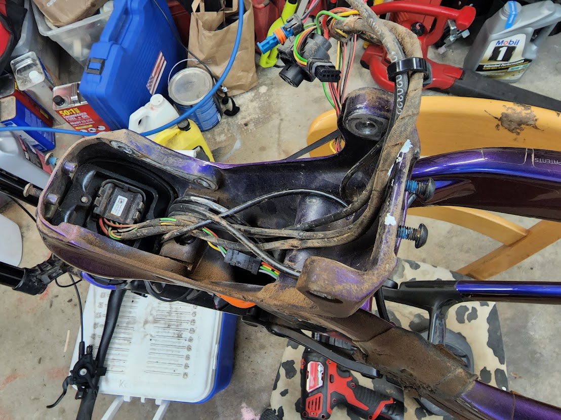

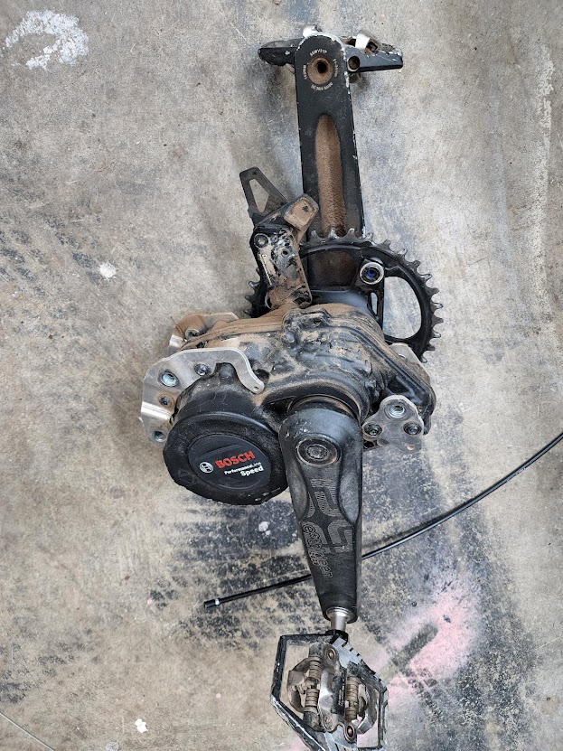

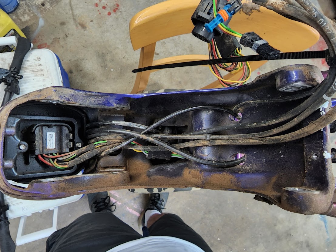

My derailleur cable just started binding right at the cross over exit at the chainstay. Sticking shifts and super stiff to override the internal snag. I guess I'm dropping the motor this weekend, installing a new cable and doing a re-route to try to get rid of some bends.
dixie600mhz
Oct 13, 2020
174
159
Austin, Texas
Just in case it helps anyone else. I installed a new Jagwire Elite sealed derailleur cable and rerouted to avoid the cross over at the chainstay. The shift pressure required to switch gears is about 10x lighter than it was compared to when the bike was new. The shift pressure with the XT setup feels as light now as the SRAMs feel, but the Shimano actually never misses a shift. Really happy I spent the time installing the better cable.
