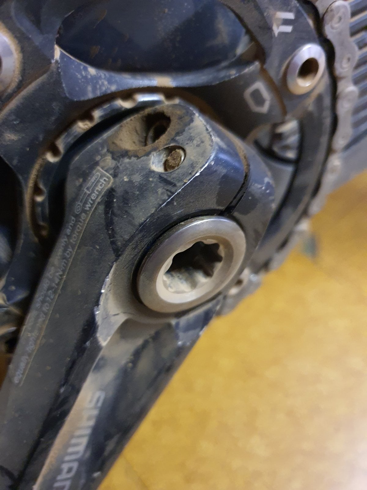

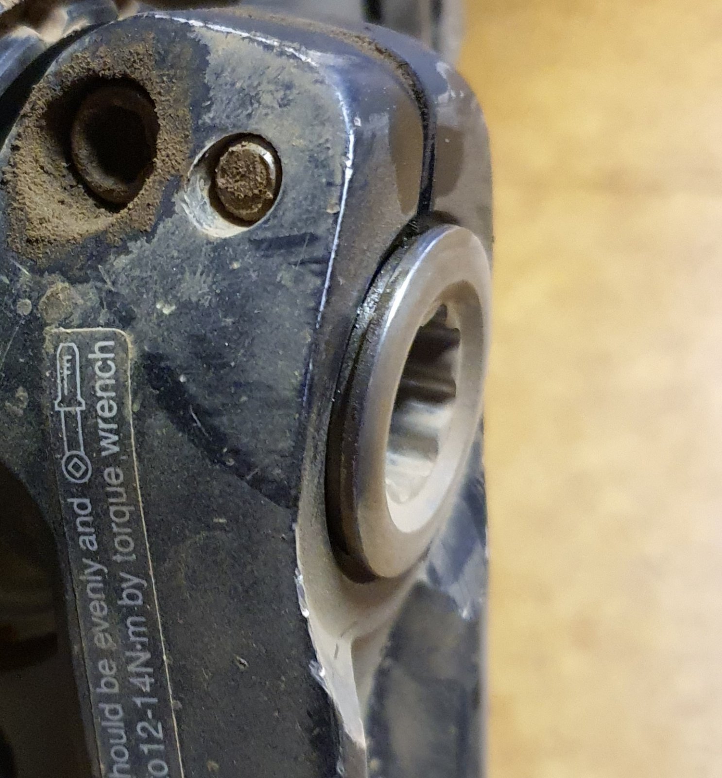

So I got alu cap and it sits proud, anyone else get this? It says tighten to 1.5nm but if I did that it would sit a fair distance out, so I've tightened it down a bit more. What's the worse case scenario here?

Which cap did you buy?
And what crank do you have?
and did you undo the crank pinchbolts to fit the cap?
The cheap chinese Alu caps are very slightly oversized so when you torque down the pinchbolts the crank grips the cap. But don't worry about it as this actually helps secure them even more
If for some reason you need caps sized exactly to the same dimensions as the plastic shimano caps Shimano SAINT caps are Alu and Burgtec also make slightly higher quality Alu caps. (I haven't used the burgtecs personally)

I bought a TITO Titaniium Crank Cover M20. It's about 0.5mm bigger.
I have shimano cranks. I did take the pinch bolts out before tightening down.
I've attach a pic of how far out they are. Took it for a quick 12k ride yesterday and so far so good. Just looks odd.

I can tighten it down more so it sits more flush, not perfect but better than that but I'm worried what will happen if I over tighten it. Any chance it can destroy the thread inside the spline?
