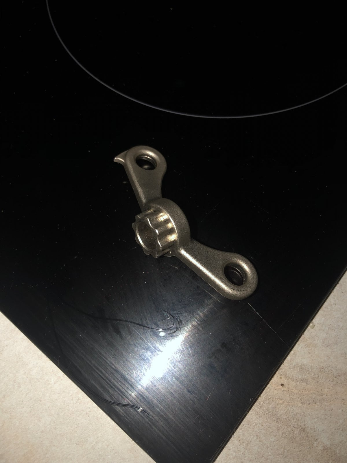

Yeah that’s what I’m doing but it’s driving me insane ! & I also got little metal end cap bolts today instead of the plastic! It held up today fingers crossed ?

Carrying this at all times now

Ah.. you got shimano Alu caps.
Using most multitools and a little ingenuity you can also tighten/undo those. Eg. using the flat blade screwdriver/bottle opener/spoke key or even an allen key jammed into the spline at an angle ;)
I just have super cheap 10mm allen key ones from ebay
