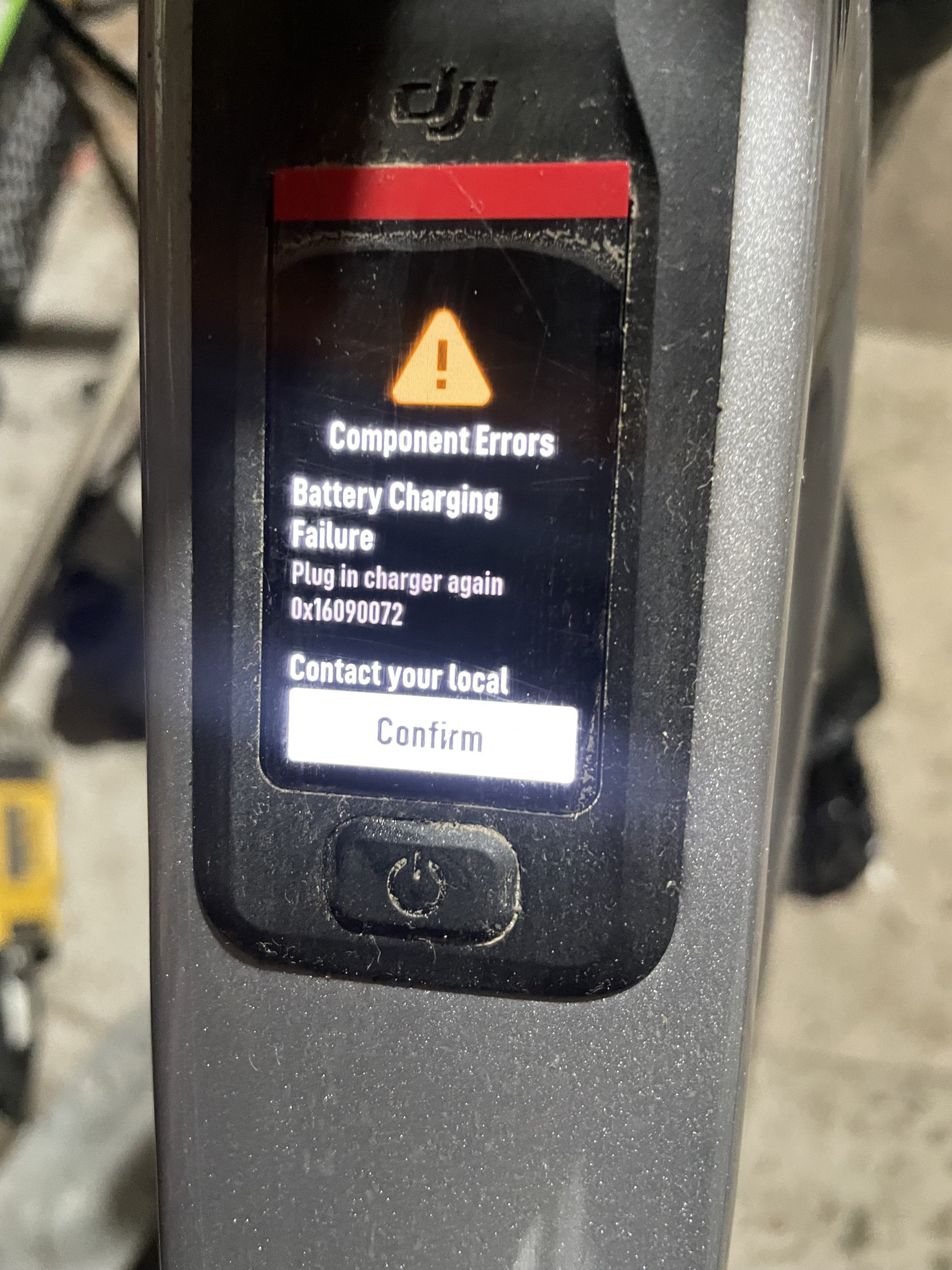

Hi I’ve got amflow ebb the battery wont charge can you help please .

Don't know anything about the Amflow's, but if you check out the Android SDK code for the drones, the same error code is used for :
"%battery_index Battery overcurrent when charging" then it notes "Check charging device"
On some bikes you can do things like hold down the power for 10 or 20 seconds and it will reset the battery, not sure if you can do this on the Amflow's or not.
The other thing to try would be disconnecting the charger then trying different combinations.
Like Plug charger into the mains first then the bike.
Plug it into the bike, then the mains.
Try it plugged into a different wall socket on a different circuit in case there's something else weird going on.
Obviously check the connections are all clean/dry/not contaminated and connected properly.

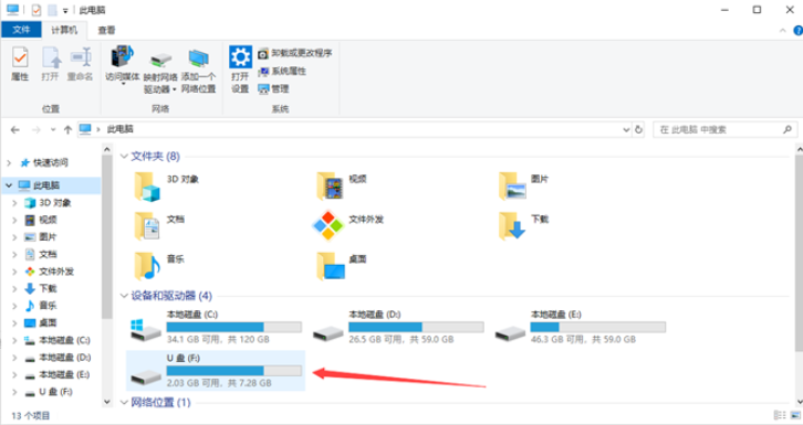

You can export the log files by following the steps below:
1. Press and hold the power button in the lower part of the control display for 2 seconds to power on the bike.
2. Connect the USB-C port on the control display to a computer via a USB-C to USB-A cable.
3. The computer will display a USB drive notification.
4. Open the USB drive folder, package all files in the folder, and export the package.
Note:
1. Whether the log files are the latest can be identified based on their sequence numbers. The larger the sequence number, the later the log file.
2. Before you can export the log files of the electric drive system, you must power on the control display (unlocking is not required). Otherwise, the computer will not display the USB drive folder.
3. Log files can be exported only by using a USB-C to USB-A cable. USB-C to USB-C cables are not supported now.
4. For Mac users, you’ll need to use a docking station first (to go from C to A port) and then connect with an A-C cable.
5.Normally, data exports at 20 Mb/s. If it’s running slow, try a different cable or computer.
6.Usually, valid data is over 1 GB. If the data is only a few hundred KB, please check if anything was missed.
