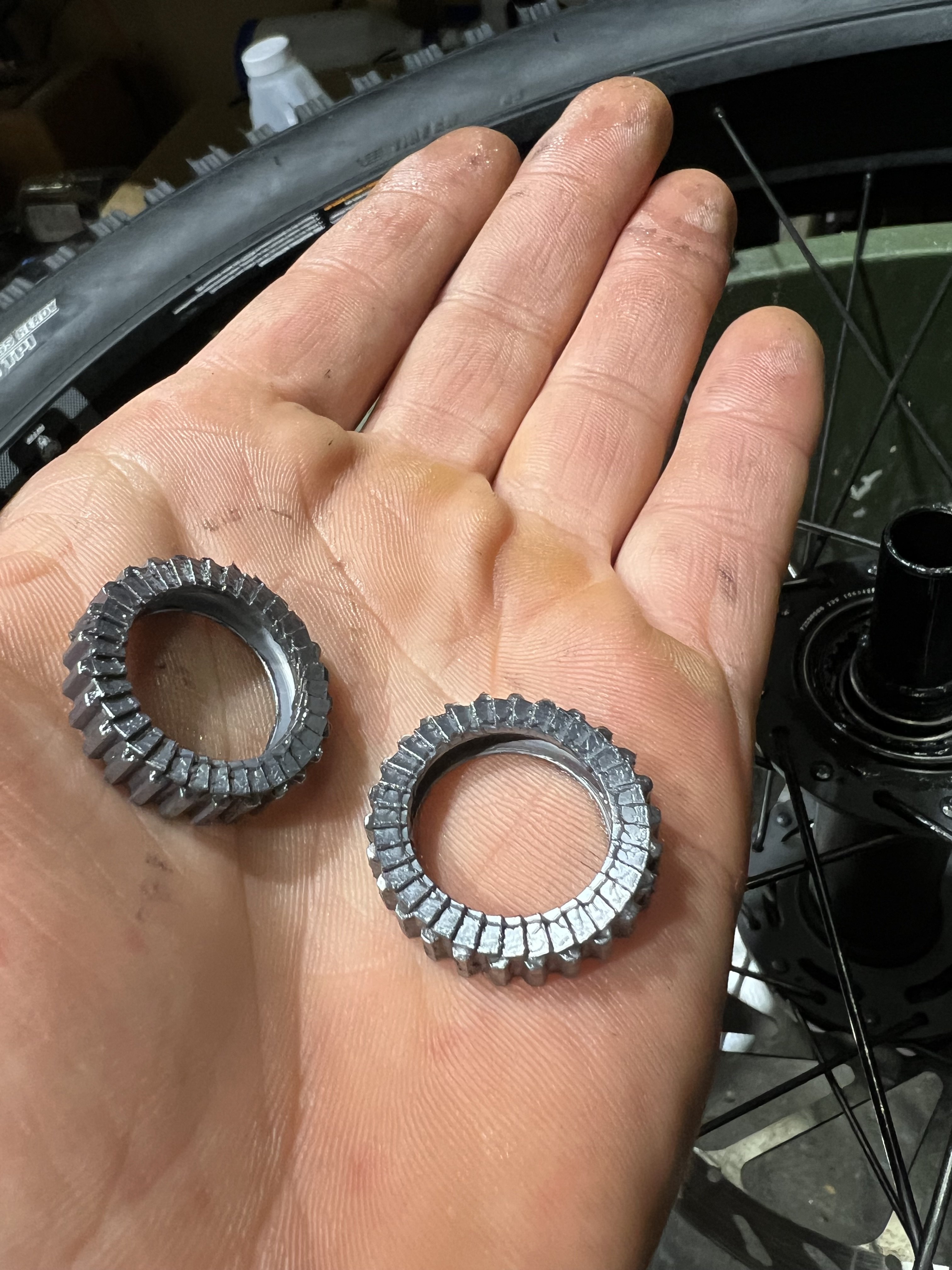

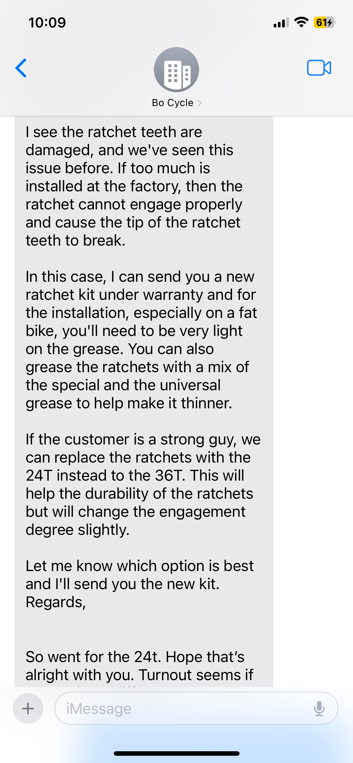

Whelp.. I blew the rear hub on my spare wheelset on Saturday (stock bitix... bitrex Norco vlt 1 hub) so I'm out a fat bike now.... That's 2 i9 hydras and a stock norco hub so far, in every case the ratchet ring has spun in the hub body.
Gonna try a dt hub this time and see if it lasts, waiting on an i9 warranty for the other wheelset.
Any of you other fat e's killing hubs like this???

They replaced the last one with a new hub body/ratchet ring, fingers crossed they do the same this time.
I have 2 hydra wheelsets for my summer bike, a full power sc bullit, that are still going strong... knock on wood.
Planning to replace the noname norco hub with a dt to see how it fares.

The steel ratchet rings are spinning in the hub shell. Same failure for all 3 hubs, there is no maintenance for that.
My buddy has spun 2 rings in 2 different hope hubs as well, so I don't think any hub is immune.
Imop it's the 27.5 x 4.5 wheels and tires that put too much stress on the hub.

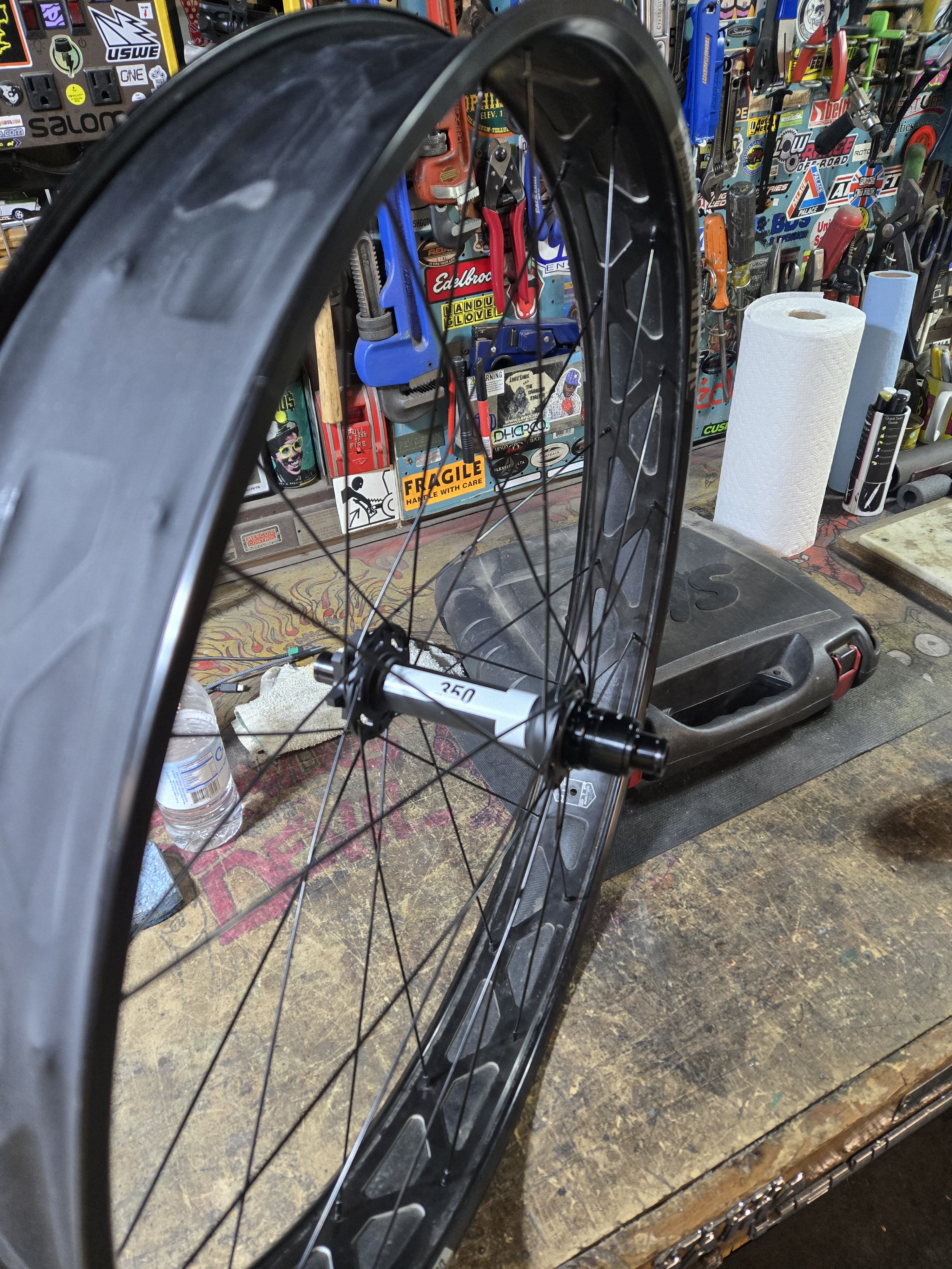

Soooo let's try this dt 350....
