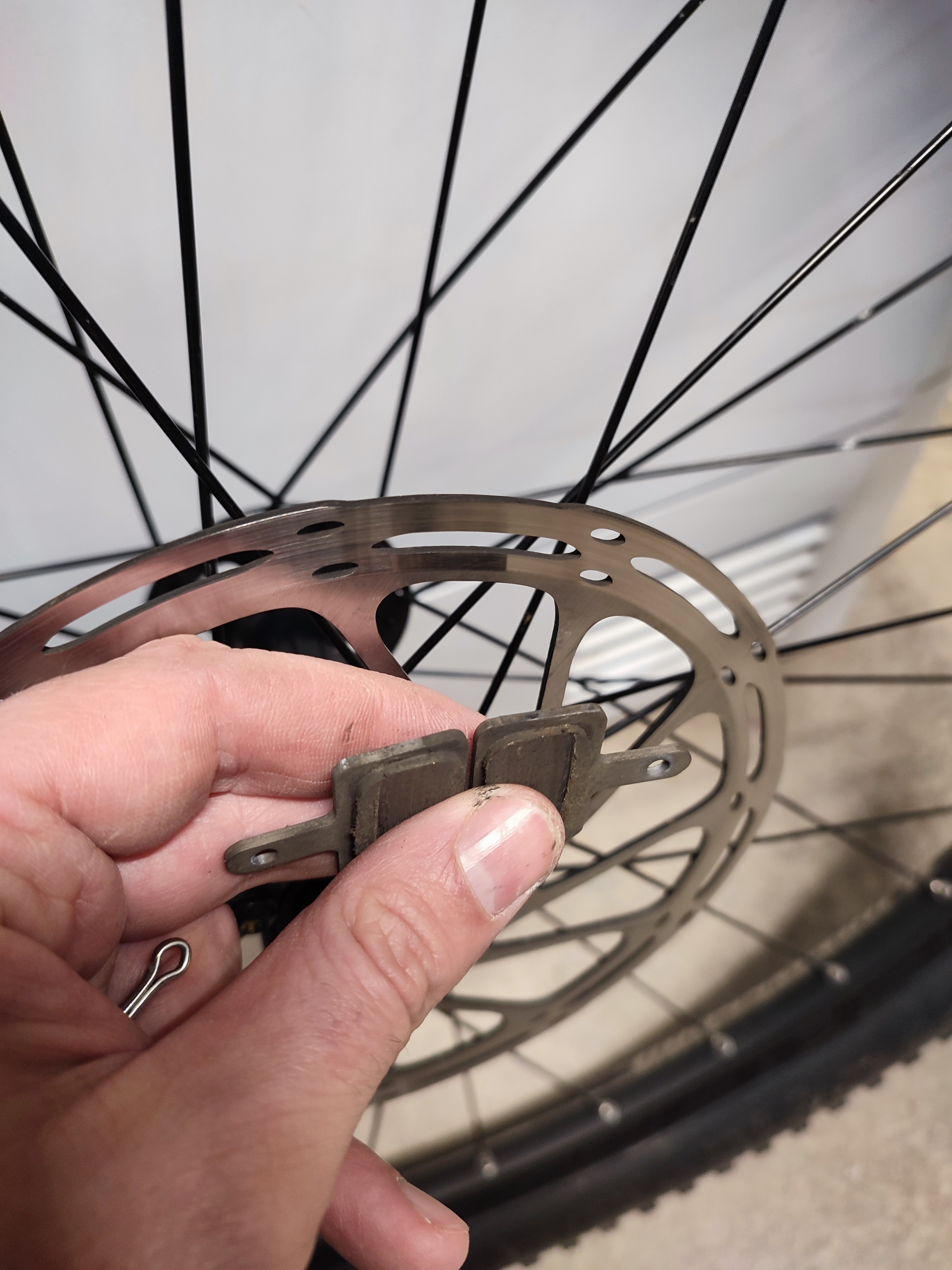

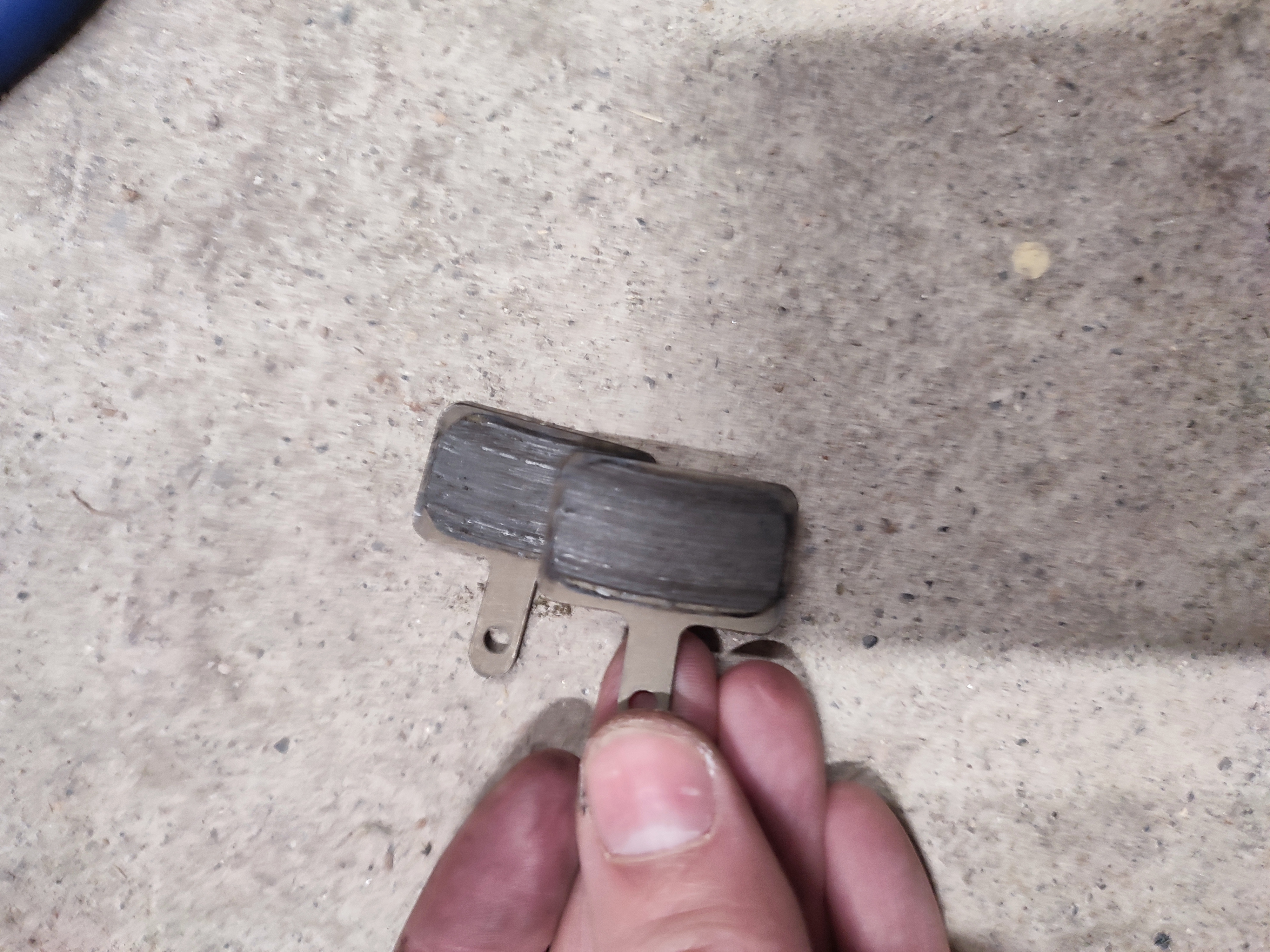

@temon10 I have some problems with bike. Did you have same issues as I have.
The wearing on brake pads it's not even. This is very dangerous. This problem is present on frond and rear brake. How can I solve this issue?

@atlet I am assuming you built this bike yourself or did you buy it complete?
You have the wrong caliper spacer for the brake rotor size.
Looks like your derailleur needs limit screws adjusting. Which derailleur and cassette are you running?

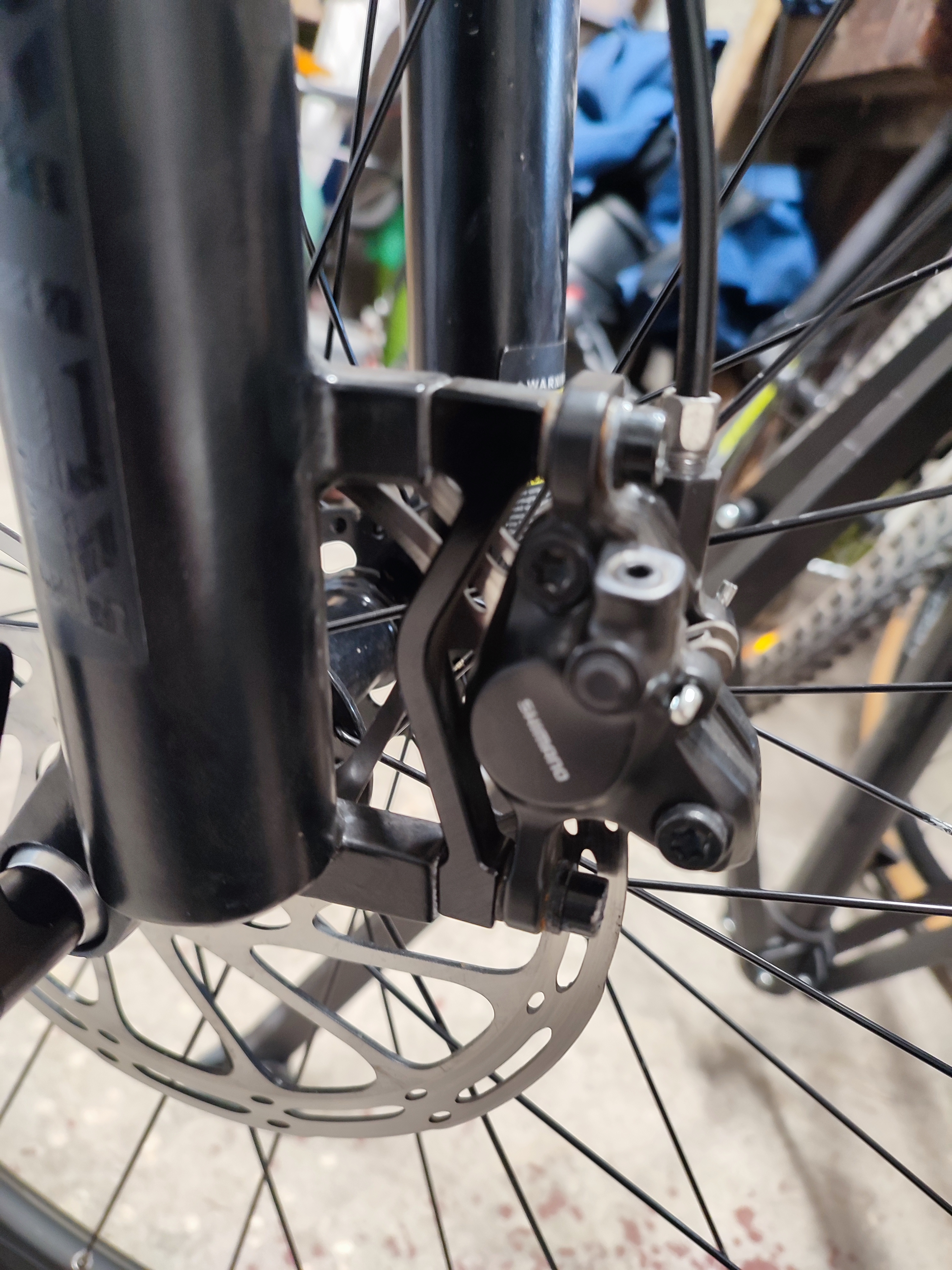

@irie and how can I fix this? I can't lower the adapter.
Remove any washers to lower the adapters. If this does not work then either buy the correct adapters or very carefully grind the adapters down so that the calipers sits in the right position, but be very careful with bolt lengths.
Edit: just a thought, although they look correct are the adapters upside down?
No, I buy already assembled. This are photos of back, but I' can't remove anything.

Start with taking the washers out from under the calliper adapter, they shouldn't be there, and look at the part number.

From the spec sheet your brakes are Shimano MT200. MT200 brake pads friction pad height is (I think) 16mm. From your pad photo it looks like about 2.5-3mm of pad is not in contact with the rotor (which the rotor also shows). So I guess you need an adapter about 3mm lower. Or as said before perhaps simply remove the extra washers between the caliper and the adapter and also between the adapter and the fork.
I'll try. Where can I find this kind of adapter, that are a few mm lower?
What is the part number of the adapter?
What thickness are the 4 washers?
Edit: in your photo there is a washer between the caliper and adapter. I think it should not be there.
